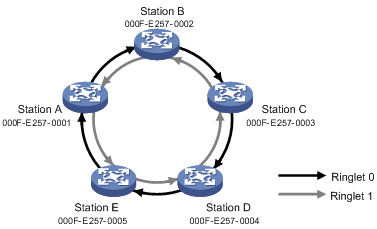

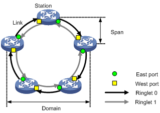

RPR consists of dual unidirectional counter-rotating ringlets identified as Ringlet 0 and Ringlet 1, as shown in Figure 1. Ringlet 0 is the outer ring that carries clockwise data traffic. Ringlet 1 is the inner ring that carries counterclockwise data traffic.
Figure 1 RPR ring structure
On Ringlet 0, stations send data frames out of east ports and receive data frames from west ports. On Ringlet 1, stations send data frames out of west ports and receive data frames from east ports.
Any two adjacent stations are connected by a pair of unidirectional links transmitting data in opposite directions. These two links form a span. Multiple continuous spans and their stations form a domain. A span on which data frames are not allowed to pass is called an edge. If a ring contains at least one detected edge, it is called an open ring. If the ring does not contain any detected edges, it is called a closed ring.
For the LSUM1SPMAEC0 base card, the west port is located on the subcard in slot 1, and the east port is located on the subcard in slot 2. The east and west ports on the local device must be connected to the west and east ports on the peer device, respectively.

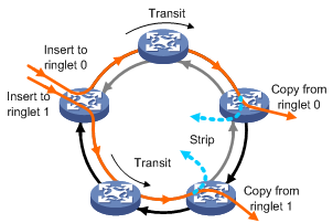

Unicast transmission
Figure 2 Unicast transmission on an RPR ring
As shown in Figure 2, a unicast data frame is transmitted on an RPR ringlet using the following process:
1.     The source station inserts the unicast frame into the data stream on Ringlet 0 or Ringlet 1.
2.     Transit stations transit the frame.
3.     The frame is copied and stripped when it reaches the destination station or when its time to live (TTL) expires.
RPR removes unicast frames from the ring at the destination station. This increases bandwidth utilization and spatial bandwidth reuse efficiency.

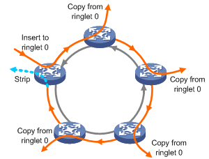

Broadcast, multicast, and unknown unicast transmission
Figure 3 Broadcast, multicast, and unknown unicast transmission on an RPR ring
As shown in Figure 3, a broadcast, multicast, or unknown unicast frame is transmitted on an RPR ringlet using the following process:
1.     The source station inserts the frame into the data stream on Ringlet 0 or Ringlet 1.
2.     Transit and destination stations copy and transit the frame if the TTL of the frame has not expired.
3.     The frame is stripped when it returns to the source station or when its TTL expires.

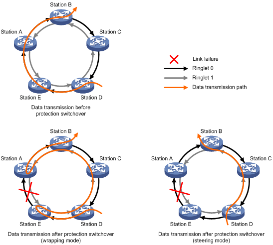

RPR provides event detection and self-recovery. When an optical fiber or station failure occurs, sevices can be recovered within 50 ms.
If a station is unable to forward traffic, it enters one of the following protection modes:
·     Wrapping—Ringlet 0 and Ringlet 1 form a closed single ring at the point of the failure. The wrapping mode provides quick switchover to minimize frame loss, but it wastes bandwidth. The switch does not support the wrapping mode.
·     Steering—The two stations at the two sides of a point of failure update their topology databases, and then broadcast TP frames at fast intervals. The source station sends frames after the new topology database is stabilized. The steering mode reduces bandwidth waste, but requires topology reconvergence that might cause frame loss and service interruption.
Figure 4 Wrapping and steering modes
As shown in Figure 4, traffic travels from station D to station B along Ringlet 0. The transmission path is station D—station E—station A—station B. After the span between station A and station E fails, a protection switchover occurs.
·     In wrapping mode, traffic that should have traveled from station E to A along Ringlet 0 is directed to Ringlet 1 to reach station A. The new transmission path is station D—station E—station D—station C—station B—station A—station B.
·     In steering mode, traffic that should have traveled from station D to station B along Ringlet 0 is steered to Ringlet 1 for transmission. The new transmission path is Station D—Station C—Station B.

RPR static ringlet selection entry configuration example
Network requirements
As shown in Figure 5, configure Ringlet 1 as the sending ringlet for frames destined from Station A to Station B when no edge occurs on the RPR ring.
Figure 5 Network diagram
Configuration procedure
# Create RPR logical interface RPR 4/0/1 on Station A.
<StationA> system-view
[StationA] interface rpr 4/0/1
# Create a static ringlet selection entry on RPR 4/0/1 by specifying Ringlet 1 for sending data frames destined to 000f-e257-0002.
[StationA-RPR4/0/1] rpr static-rs 000f-e257-0002 ringlet1
[StationA-RPR4/0/1] quit
# Display ring topology information for Station A.
[StationA] display rpr topology ring
Ring-level topology information on interface RPR4/0/1:
  Number of stations on Ringlet0: 4
  Number of stations on Ringlet1: 4
  Total number of stations on the ring: 5
  Jumbo preference: Jumbo
  Ring topology type: Closed ring
# Display static ringlet selection table information for Station A.
[StationA] display rpr rs-table static
Static ringlet selection table on interface RPR4/0/1:
 MAC address    Ringlet ID   Status
 000f-e257-0002 1            Valid
 ---   Entries in total: 1   ---
# Display overall ringlet selection table information for Station A.
[StationA] display rpr rs-table overall
Overall ringlet selection table on interface RPR4/0/1:
 MAC address    Ringlet ID   TTL   Type    IP address       Station name
 000f-e257-0002 1            4     Static  -
 000f-e257-0003 0            2     Dynamic -
 000f-e257-0004 1            2     Dynamic -
 000f-e257-0005 1            1     Dynamic -
 ---   Entries in total: 4   ---
