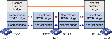

LLDP agent
An LLDP agent is a mapping of an entity where LLDP runs. Multiple LLDP agents can run on the same interface.
LLDP agents are divided into the following types:
·     Nearest bridge agent.
·     Nearest customer bridge agent.
·     Nearest non-TPMR bridge agent.
A Two-port MAC Relay (TPMR) is a type of bridge that has only two externally-accessible bridge ports. It supports a subset of the functions of a MAC bridge. A TPMR is transparent to all frame-based media-independent protocols except for the following:
·     Protocols destined to it.
·     Protocols destined to reserved MAC addresses that the relay function of the TPMR is configured not to forward.
LLDP exchanges packets between neighbor agents and creates and maintains neighbor information for them. Figure 1 shows the neighbor relationships for these LLDP agents. LLDP has two bridge modes: customer bridge (CB) and service bridge (SB).
Figure 1 LLDP neighbor relationships

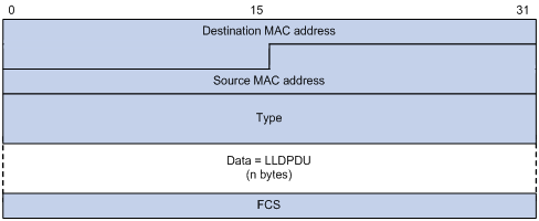

LLDP frame formats
LLDP sends device information in LLDP frames. LLDP frames are encapsulated in Ethernet II or SNAP frames.
·     LLDP frame encapsulated in Ethernet II
Figure 2 Ethernet II-encapsulated LLDP frame
Table 1 Fields in an Ethernet II-encapsulated LLDP frame
Field
Description
Destination MAC address
MAC address to which the LLDP frame is advertised. LLDP specifies different multicast MAC addresses as destination MAC addresses for LLDP frames destined for agents of different types. This helps distinguish between LLDP frames sent and received by different agent types on the same interface. The destination MAC address is fixed to one of the following multicast MAC addresses:
·     0x0180-C200-000E for LLDP frames destined for nearest bridge agents.
·     0x0180-C200-0000 for LLDP frames destined for nearest customer bridge agents.
·     0x0180-C200-0003 for LLDP frames destined for nearest non-TPMR bridge agents.
Source MAC address
MAC address of the sending port.
Type
Ethernet type for the upper-layer protocol. This field is 0x88CC for LLDP.
Data
LLDPDU.
FCS
Frame check sequence, a 32-bit CRC value used to determine the validity of the received Ethernet frame.

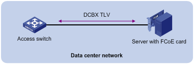

Figure 5 DCBX application scenario
DCBX enables lossless packet transmission on DCE networks.
As shown in Figure 5, DCBX applies to an FCoE-based data center network, and operates on an access switch. DCBX enables the switch to control the server or storage adapter, and simplifies the configuration and guarantees configuration consistency. DCBX extends LLDP by using the IEEE 802.1 organizationally specific TLVs (DCBX TLVs) to transmit DCBX data, including:
·     In DCBX Rev 1.00 and DCBX Rev 1.01:
¡     Application Protocol (APP).
¡     Enhanced Transmission Selection (ETS).
¡     Priority-based Flow Control (PFC).
·     In IEEE Std 802.1Qaz-2011:
¡     ETS Configuration.
¡     ETS Recommendation.
¡     PFC.
¡     APP.
H3C devices can send these types of DCBX information to a server or storage adapter supporting FCoE. However, H3C devices cannot accept these types of DCBX information.

LLDP configuration examples
Basic LLDP configuration example
Network requirements
As shown in Figure 6, enable LLDP globally on Switch A and Switch B to perform the following tasks:
·     Monitor the link between Switch A and Switch B on the NMS.
·     Monitor the link between Switch A and the MED device on the NMS.
Figure 6 Network diagram

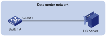

CDP-compatible LLDP configuration example
As shown in Figure 7, GigabitEthernet 1/0/1 and GigabitEthernet 1/0/2 of Switch A are each connected to a Cisco IP phone, which sends tagged voice traffic.
Configure voice VLAN 2 on Switch A. Enable CDP compatibility of LLDP on Switch A to allow the Cisco IP phones to automatically configure the voice VLAN. The voice VLAN feature performs the following actions:
·     Confines the voice traffic to the voice VLAN.
·     Isolates the voice traffic from other types of traffic.
Figure 7 Network diagram
Configuration procedure
1.     Configure a voice VLAN on Switch A:
# Create VLAN 2.
<SwitchA> system-view
[SwitchA] vlan 2
[SwitchA-vlan2] quit
# Set the link type of GigabitEthernet 1/0/1 and GigabitEthernet 1/0/2 to trunk, and enable voice VLAN on them.
[SwitchA] interface gigabitethernet 1/0/1
[SwitchA-GigabitEthernet1/0/1] port link-type trunk
[SwitchA-GigabitEthernet1/0/1] voice vlan 2 enable
[SwitchA-GigabitEthernet1/0/1] quit
[SwitchA] interface gigabitethernet 1/0/2
[SwitchA-GigabitEthernet1/0/2] port link-type trunk
[SwitchA-GigabitEthernet1/0/2] voice vlan 2 enable
[SwitchA-GigabitEthernet1/0/2] quit
2.     Configure CDP-compatible LLDP on Switch A:
# Enable LLDP globally, and enable CDP compatibility globally.
[SwitchA] lldp global enable
[SwitchA] lldp compliance cdp
# Enable LLDP on GigabitEthernet 1/0/1. By default, LLDP is enabled on ports.
[SwitchA-GigabitEthernet1/0/1] lldp enable
# Configure LLDP to operate in TxRx mode on GigabitEthernet 1/0/1.
[SwitchA-GigabitEthernet1/0/1] lldp admin-status txrx
# Configure CDP-compatible LLDP to operate in TxRx mode on GigabitEthernet 1/0/1.
[SwitchA-GigabitEthernet1/0/1] lldp compliance admin-status cdp txrx
# Enable LLDP on GigabitEthernet 1/0/2. By default, LLDP is enabled on ports.
[SwitchA-GigabitEthernet1/0/2] lldp enable
# Configure LLDP to operate in TxRx mode on GigabitEthernet 1/0/2.
[SwitchA-GigabitEthernet1/0/2] lldp admin-status txrx
# Configure CDP-compatible LLDP to operate in TxRx mode on GigabitEthernet 1/0/2.
[SwitchA-GigabitEthernet1/0/2] lldp compliance admin-status cdp txrx
# Verify that Switch A has completed the following tasks:
·     Discovering the IP phones connected to GigabitEthernet 1/0/1 and GigabitEthernet 1/0/2.
·     Obtaining IP phone information.
[SwitchA] display lldp neighbor-information
CDP neighbor-information of port 1[GigabitEthernet1/0/1]:
 CDP neighbor index  : 1
 Chassis ID          : SEP00141CBCDBFE
 Port ID             : Port 1
 Software version    : P0030301MFG2
 Platform            : Cisco IP Phone 7960
 Duplex              : Full
CDP neighbor-information of port 2[GigabitEthernet1/0/2]:
 CDP neighbor index  : 2
 Chassis ID          : SEP00141CBCDBFF
 Port ID             : Port 1
 Duplex              : Full
DCBX configuration example
As shown in Figure 8, interface GigabitEthernet 1/0/1 of the access switch (Switch A) connects to the FCoE adapter of the data center server (DC server).
Configure Switch A to implement lossless FCoE and FIP frame transmission to DC server.
In this example, both Switch A and the DC server support DCBX Rev 1.01.
Figure 8 Network diagram
1.     Enable LLDP and DCBX TLV advertising:
# Enable LLDP globally.
# Enable LLDP and DCBX TLV advertising on interface GigabitEthernet 1/0/1.
[SwitchA-GigabitEthernet1/0/1] lldp tlv-enable dot1-tlv dcbx
2.     Set the DCBX version to Rev. 1.01 on interface GigabitEthernet 1/0/1.
[SwitchA-GigabitEthernet1/0/1] dcbx version rev101
3.     Configure APP parameters:
# Create Ethernet frame header ACL 4000.
[SwitchA] acl number 4000
# Configure ACL 4000 to permit FCoE frames (frame type is 0x8906) and FIP frames (frame type is 0x8914) to pass through.
[SwitchA-acl-ethernetframe-4000] rule permit type 8906 ffff
[SwitchA-acl-ethernetframe-4000] rule permit type 8914 ffff
[SwitchA-acl-ethernetframe-4000] quit
# Create a class named app_c, specify the operator of the class as OR, and use ACL 4000 as the match criterion of the class.
[SwitchA] traffic classifier app_c operator or
[SwitchA-classifier-app_c] if-match acl 4000
[SwitchA-classifier-app_c] quit
# Create a traffic behavior named app_b, and configure the traffic behavior to mark packets with 802.1p priority value 3.
[SwitchA] traffic behavior app_b
[SwitchA-behavior-app_b] remark dot1p 3
[SwitchA-behavior-app_b] quit
# Create a QoS policy named plcy, associate class app_c with traffic behavior app_b in the QoS policy, and apply the association to DCBX.
[SwitchA] qos policy plcy
[SwitchA-qospolicy-plcy] classifier app_c behavior app_b mode dcbx
[SwitchA-qospolicy-plcy] quit
# Apply the policy named plcy to the outgoing traffic of interface GigabitEthernet 1/0/1.
[SwitchA-GigabitEthernet1/0/1] qos apply policy plcy outbound
4.     Configure ETS parameters:
# Configure the 802.1p-to-local priority mapping table to map 802.1p priority value 3 to local precedence 3. (This is the default mapping table. You can modify this configuration as needed.)
[SwitchA] qos map-table outbound dot1p-lp
[SwitchA-maptbl-out-dot1p-lp] import 3 export 3
[SwitchA-maptbl-out-dot1p-lp] quit
# Enable byte-count WRR queuing on interface GigabitEthernet 1/0/1, and configure queue 3 on the interface to use SP queuing.
[SwitchA-GigabitEthernet1/0/1] qos wrr byte-count
[SwitchA-GigabitEthernet1/0/1] qos wrr 3 group sp
5.     Configure PFC:
# Enable PFC in auto mode on interface GigabitEthernet 1/0/1.
[SwitchA-GigabitEthernet1/0/1] priority-flow-control auto
# Enable PFC for 802.1 priority 3.
[SwitchA-GigabitEthernet1/0/1] priority-flow-control no-drop dot1p 3
# Display the data exchange result on the DC server through the software interface. This example uses the data exchange result for a QLogic adapter on the DC server.
DCBX Parameters Details for CNA Instance 0 - QLE8142
Mon May 17 10:00:50 2010
DCBX TLV (Type-Length-Value) Data
DCBX Parameter Type and Length
        DCBX Parameter Length: 13
        DCBX Parameter Type: 2
DCBX Parameter Information
        Parameter Type: Current
        Pad Byte Present: Yes
        DCBX Parameter Valid: Yes
        Reserved: 0
DCBX Parameter Data
        Priority Group ID of Priority 1: 0
        Priority Group ID of Priority 0: 2
        Priority Group ID of Priority 3: 15
        Priority Group ID of Priority 2: 1
        Priority Group ID of Priority 5: 5
        Priority Group ID of Priority 4: 4
        Priority Group ID of Priority 7: 7
        Priority Group ID of Priority 6: 6
        Priority Group 0 Percentage: 2
        Priority Group 1 Percentage: 4
        Priority Group 2 Percentage: 6
        Priority Group 3 Percentage: 0
        Priority Group 4 Percentage: 10
        Priority Group 5 Percentage: 18
        Priority Group 6 Percentage: 27
        Priority Group 7 Percentage: 31
        Number of Traffic Classes Supported: 8
        Parameter Type: Remote
        Reserved: 0
DCBX Parameter Data
        Parameter Type: Local
        Reserved: 0
DCBX Parameter Data
        Priority Group ID of Priority 0: 0
        Priority Group ID of Priority 2: 0
        Priority Group ID of Priority 5: 0
        Priority Group ID of Priority 4: 0
        Priority Group ID of Priority 7: 0
        Priority Group ID of Priority 6: 0
        Priority Group 0 Percentage: 50
        Priority Group 1 Percentage: 50
        Priority Group 2 Percentage: 0
        Priority Group 4 Percentage: 0
        Priority Group 5 Percentage: 0
        Priority Group 6 Percentage: 0
        Priority Group 7 Percentage: 0
        Number of Traffic Classes Supported: 2
The output shows that the DC server will use SP queuing (priority group ID 15) for 802.1p priority 3.
        DCBX Parameter Length: 2
        DCBX Parameter Type: 3
        Pad Byte Present: No
        Reserved: 0
DCBX Parameter Data
        PFC Enabled on Priority 0: No
        PFC Enabled on Priority 1: No
        PFC Enabled on Priority 2: No
        PFC Enabled on Priority 3: Yes
        PFC Enabled on Priority 4: No
        PFC Enabled on Priority 5: No
        PFC Enabled on Priority 6: No
        PFC Enabled on Priority 7: No
        Number of Traffic Classes Supported: 6
        Reserved: 0
DCBX Parameter Data
        Reserved: 0
DCBX Parameter Data
        Number of Traffic Classes Supported: 1
The output shows that the DC server will use PFC for 802.1p priority 3.
