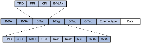

SPBM data packets use the IEEE 802.1ah MAC-in-MAC frame format, as shown in Figure 2.
Figure 2 IEEE 802.1ah-compliant MAC-in-MAC frame format
Table 1 IEEE 802.1ah encapsulated frame header fields
Field
Description
B-DA
Destination B-MAC that identifies the destination BEB.
B-SA
Source B-MAC. It is a known MAC address of the BEB that encapsulates the MAC-in-MAC frame.
B-Tag
B-VLAN tag identifies the VLAN ID and priority of the frame in the SPBM network. The TPID in the tag is fixed at 0x8100.
I-Tag
Backbone service instance tag contains the following subfields:
·     TPID—A value fixed at 0x88E7 to identify the frame as an 802.1ah encapsulated frame.
·     I-PCPTransmission priority of the frame on the BEB.
·     I-DEI—Drop priority of the frame on the BEB.
·     I-SID—Backbone service instance identifier.
·     C-DA—Customer destination MAC address.
·     C-SA—Customer source MAC address.
S-Tag
This field contains the outer customer VLAN ID and priority.
C-Tag
This field contains the inner customer VLAN ID and priority.

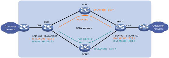

ISIS-SPB only supports point-to-point links within an IS-IS level 1. It sends P2P hellos between directly connected nodes to form and maintain adjacencies. To forward traffic on an adjacency, two SPBM neighbors must meet the following requirements:
·     The neighbors have the same configuration digest for MSTI 4092.
·     The neighbors have the same B-VLAN to ECT algorithm mapping.
·     The neighbors have valid link metric values.

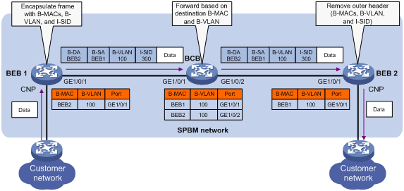

For an intra-site known unicast frame, the ingress BEB performs typical MAC address table lookup.
For a known inter-site unicast frame, the following forwarding process takes place, as shown in Figure 3:
1.     The ingress BEB performs the following tasks:
a.     Assigns the frame to the correct Ethernet service instance based on the outer VLAN.
b.     Learns the source MAC address.
c.     Looks up the destination MAC address in the Ethernet service instance's Ethernet address table.
2.     If the outgoing interface is a provider network port, the ingress BEB performs the following tasks:
a.     Encapsulates the frame in IEEE 802.1ah format.
b.     Sends the frame out of the unicast PW to the egress BEB.
The B-DA field in the outer frame header is the B-MAC of the egress BEB.
3.     Each BCB on the unicast PW forwards the frame based on the B-MAC and B-VLAN in the outer frame header until it reaches the egress BEB.
4.     The egress BEB removes the outer frame header and forwards the frame to the destination customer MAC address.
Figure 3 MAC-in-MAC unicast traffic over an SPBM network

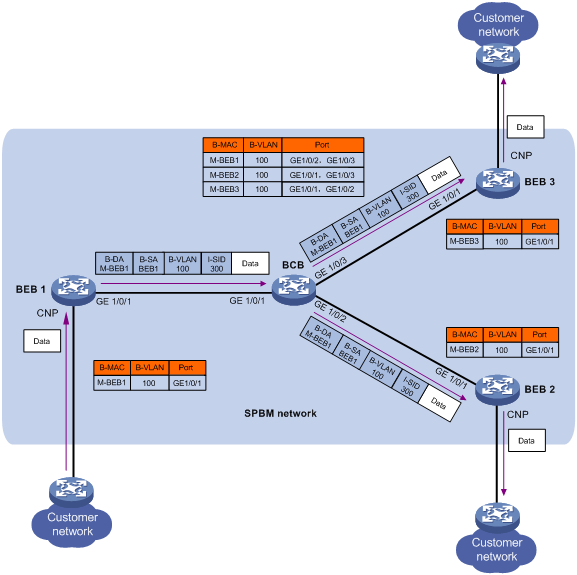

SPBM floods unknown customer unicast, unknown customer multicast, and broadcast as multicast traffic.
SPBM supports the following replication methods for multicast:
·     Head-end replication—Replicates frames at the ingress BEB for frames to enter the SPBM network. This method is suitable for SPB VSIs that have sparse multicast traffic. It does not require BCBs to maintain multicast FDB entries.
·     Tandem replication—Replicates frames only at the node where the shortest path tree forks. This method is suitable for SPB VSIs that have dense multicast traffic. It requires BCBs to maintain multicast FDB entries.
In head-end replication, the ingress BEB performs the following tasks, as shown in Figure 4:
1.     Replicates the customer frame for each destination BEB.
2.     Encapsulates each replica in one unicast frame.
3.     Sends the unicast frames to the destination BEBs.
Figure 4 Head-end replication
In tandem replication, the source BEB encapsulates a frame with a B-DA multicast address that uniquely identifies itself and the SPBM service. When this frame arrives at the BCB where the shortest path tree forks, the BCB replicates one frame for each destination BEB, as shown in Figure 5.
Figure 5 Tandem replication

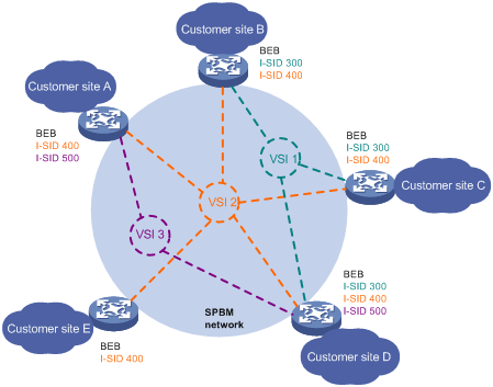

You can use multiple SPB VSIs to transmit traffic for different Ethernet services that span different customer sites. Each SPB VSI is identified by a unique I-SID.
For example, the network in Figure 7 has the following SPB VSIs:
·     I-SID 300 extends traffic to customer sites B, C, and D.
·     I-SID 400 extends traffic to all customer sites.
·     I-SID 500 extends traffic to customer sites A and D.
All traffic in one SPB VSI is transmitted in one B-VLAN. Different SPB VSIs can use the same B-VLAN to transmit traffic. Traffic of different SPB VSIs is isolated by I-SID.
Figure 7 Multiple SPB VSIs

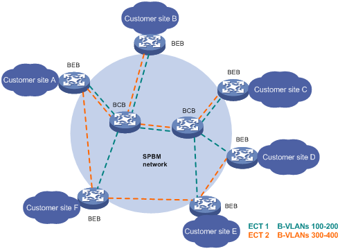

To balance traffic between forwarding paths, you can map B-VLANs to different ECT algorithms. When a path is approaching congestion, you can move part of traffic on one path to another by moving an I-SID from one ECT algorithm to another.
For balanced traffic distribution, SPBM supports calculating one SPT for a set of B-VLANs by using different ECT algorithms. IEEE 802.1aq SPB provides 16 ECT algorithms. Each algorithm represents a set of tie-break rules. As a result, you can have up to 16 forwarding paths in an SPBM network.
Figure 8 shows two SPTs that are calculated by using two ECT algorithms.
Figure 8 Multiple SPTs in an SPBM network
ECT migration
ECT migration enables an I-SID to migrate from one ECT algorithm to another with minimum traffic loss.
To prevent traffic loss, ECT migration was designed based on the idea of make-before-break. All nodes in the SPBM network maintain the old path for the I-SID before a new path is set up. The SPBM nodes remove the old path only after all affected traffic has been moved from the old path to the new path for the I-SID.
As shown in Figure 9, two paths (path A and path B) are available between BEB 1 and BEB 2. B-VLAN 300 has been using path A. As path A is getting congested, you can perform ECT migration to move part of B-VLAN traffic (for example, traffic in I-SID 400) to path B.
Figure 9 ECT migration

Mapping B-VLANs to an ECT algorithm
An ECT algorithm represents a set of tie-breakers for calculating SPTs.
To improve link efficiency in an SPBM network, you can distribute B-VLAN traffic along different paths by mapping B-VLANs to different ECT algorithms.
To ensure correct SPT calculation for a B-VLAN, the B-VLAN to ECT algorithm mappings must be the same across the SPBM network for B-VLANs.
For more information about the ECT algorithms, see IEEE 802.1aq SPB.
To map a list of B-VLANs to an ECT algorithm:
Step
Remarks
N/A
2.     Enter SPBM view.
spbm
N/A
3.     Map B-VLANs to an ECT algorithm.
ect ect-index b-vlan vlan-id-list
By default, all B-VLANs are mapped to ECT algorithm 1.
Performing ECT migration for an SPB VSI
To move traffic from an overloaded path to a path that has less traffic, you can change B-VLAN to ECT algorithm mappings by using the ect command or by performing ECT migration. ECT migration provides more granular traffic control than the ect command.
·     Using the ect command, you can move all traffic of a B-VLAN from one path to another. The B-VLAN's traffic is disrupted before you complete B-VLAN to ECT algorithm remapping across the SPBM network.
·     Using ECT migration, you can move traffic by I-SID without traffic loss.
