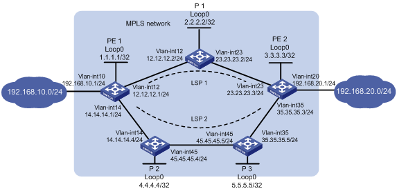

Example: Configuring LDP LSPs
Network requirements
As shown in Figure 2, two paths are available for PE 1 and PE 2 to communicate with each other.
·     Configure LDP to establish LSPs between PE 1 and PE 2 to allow communication between subnets 192.168.10.0/24 and 192.168.20.0/24 over the MPLS network.
?     Use LSP 1 as the primary path.
?     Use LSP 2 as the backup path, which takes over LSP 1 when LSP 1 fails.
·     Configure LDP to establish LSPs only for destinations 1.1.1.1/32, 2.2.2.2/32, 3.3.3.3/32, 4.4.4.4/32, 5.5.5.5/32, 192.168.10.0/24, and 192.168.20.0/24.
Figure 2 Network diagram
Requirements analysis
To establish LDP LSPs, configure a routing protocol to ensure IP connectivity among the devices. This example uses OSPF.
To use LSP 1 as the primary path and LSP 2 as the backup, configure the routes for LSP 1 and LSP 2 as the primary and backup routes, respectively. This example uses OSPF to achieve this purpose. The OSPF cost of the route for LSP 1 is smaller than that for LSP 2. Therefore, LSP 1 is used when it is available.
To control LSP establishment, configure LSP generation policies on each LSR.
Software version used
This configuration example was created and verified on S12500-CMW710-R7328P02.
Configuration procedures
Before configuration, disable the spanning tree feature or map each VLAN to an MSTI.

3.     Configure basic MPLS and MPLS LDP:
# Configure PE 1.
[PE1] mpls lsr-id 1.1.1.1
[PE1] mpls ldp
[PE1-ldp] quit
[PE1] interface vlan-interface 12
[PE1-Vlan-interface12] mpls enable
[PE1-Vlan-interface12] mpls ldp enable
[PE1-Vlan-interface12] quit
[PE1] interface vlan-interface 14
[PE1-Vlan-interface14] mpls enable
[PE1-Vlan-interface14] mpls ldp enable
[PE1-Vlan-interface14] quit
# Configure P 1.
[P1] mpls lsr-id 2.2.2.2
[P1] mpls ldp
[P1-ldp] quit
[P1] interface vlan-interface 12
[P1-Vlan-interface12] mpls enable
[P1-Vlan-interface12] mpls ldp enable
[P1-Vlan-interface12] quit
[P1] interface vlan-interface 23
[P1-Vlan-interface23] mpls enable
[P1-Vlan-interface23] mpls ldp enable
[P1-Vlan-interface23] quit
# Configure P 2.
[P2] mpls lsr-id 4.4.4.4
[P2] mpls ldp
[P2-ldp] quit
[P2] interface vlan-interface 14
[P2-Vlan-interface14] mpls enable
[P2-Vlan-interface14] mpls ldp enable
[P2-Vlan-interface14] quit
[P2] interface vlan-interface 45
[P2-Vlan-interface45] mpls enable
[P2-Vlan-interface45] mpls ldp enable
[P2-Vlan-interface45] quit
# Configure P 3.
[P3] mpls lsr-id 5.5.5.5
[P3] mpls ldp
[P3-ldp] quit
[P3] interface vlan-interface 45
[P3-Vlan-interface45] mpls enable
[P3-Vlan-interface45] mpls ldp enable
[P3-Vlan-interface45] quit
[P3] interface vlan-interface 35
[P3-Vlan-interface35] mpls enable
[P3-Vlan-interface35] mpls ldp enable
[P3-Vlan-interface35] quit
# Configure PE 2.
[PE2] mpls lsr-id 3.3.3.3
[PE2] mpls ldp
[PE2-ldp] quit
[PE2] interface vlan-interface 23
[PE2-Vlan-interface23] mpls enable
[PE2-Vlan-interface23] mpls ldp enable
[PE2-Vlan-interface23] quit
[PE2] interface vlan-interface 35
[PE2-Vlan-interface35] mpls enable
[PE2-Vlan-interface35] mpls ldp enable
[PE2-Vlan-interface35] quit
# On each switch, for example, on PE 1, verify that LDP sessions in Operational state have been established between PE 1, P devices, and PE 2.
[PE1 display mpls ldp peer
Total number of peers: 2
Peer LDP ID             State         Role     GR   MD5  KA Sent/Rcvd
2.2.2.2:0               Operational   Passive  Off  Off  55/55
4.4.4.4:0               Operational   Passive  Off  Off  6/6
4.     Configure LSP generation policies:

# Display LDP LSP information on PE 1. The output shows that the next hop is P 1 for the LSP associated with FEC 192.168.20.0/24.
[PE1] display mpls ldp lsp
Status Flags: * - stale, L - liberal
Statistics:
  FECs: 7      Ingress LSPs: 5     Transit LSPs: 5     Egress LSPs: 2
FEC                In/Out Label    Nexthop         OutInterface
1.1.1.1/32         3/-
                   -/1151(L)
                   -/1151(L)
2.2.2.2/32         -/3             12.12.12.2      Vlan12
                   1151/3          12.12.12.2      Vlan12
                   -/1150(L)
3.3.3.3/32         -/1150          12.12.12.2      Vlan12
                   1150/1150       12.12.12.2      Vlan12
                   -/1148(L)
4.4.4.4/32         -/1149(L)
                   -/3             14.14.14.4      Vlan14
                   1149/3          14.14.14.4      Vlan14
5.5.5.5/32         -/1148(L)
                   -/1149          14.14.14.4      Vlan14
                   1148/1149       14.14.14.4      Vlan14
192.168.10.0/24    1147/-
192.168.20.0/24    -/1147          12.12.12.2      Vlan12
                   1146/1147       12.12.12.2      Vlan12
                   -/1147(L)
# Power down P 1 and execute the display mpls ldp lsp command on PE 1. The output shows that the next hop becomes P 2 for the LSP associated with FEC 192.168.20.0/24.
Statistics:
1.1.1.1/32         3/-
                   -/1150(L)
2.2.2.2/32         -/1149          14.14.14.4      Vlan14
                   1150/1149       14.14.14.4      Vlan14
3.3.3.3/32         -/1148          14.14.14.4      Vlan14
                   1147/1148       14.14.14.4      Vlan14
4.4.4.4/32         -/3             14.14.14.4      Vlan14
5.5.5.5/32         -/1151          14.14.14.4      Vlan14
                   1148/1151       14.14.14.4      Vlan14
192.168.10.0/24    1151/-
                   -/1146(L)
192.168.20.0/24    -/1147          14.14.14.4      Vlan14
                   1146/1147       14.14.14.4      Vlan14
# Use the following command on PE 1 to verify its connectivity to PE 2.
[PE1] ping mpls -a 192.168.10.1 ipv4 192.168.20.0 24
MPLS ping FEC 192.168.20.0/24 with 100 bytes of data:
100 bytes from 23.23.23.3: Sequence=1 time=2 ms
100 bytes from 23.23.23.3: Sequence=2 time=2 ms
100 bytes from 23.23.23.3: Sequence=3 time=2 ms
100 bytes from 23.23.23.3: Sequence=4 time=2 ms
100 bytes from 23.23.23.3: Sequence=5 time=2 ms
--- Ping statistics for FEC 192.168.20.0/24 ---
5 packets transmitted, 5 packets received, 0.0% packet loss
Round-trip min/avg/max = 2/2/2 ms

 ip prefix-list P1 index 70 permit 192.168.20.0 24
·     PE 2:
ospf 1
 area 0.0.0.0
  network 3.3.3.3 0.0.0.0
  network 23.23.23.0 0.0.0.255
  network 35.35.35.0 0.0.0.255
  network 192.168.20.0 0.0.0.255
 mpls lsr-id 3.3.3.3
vlan 20
vlan 23
vlan 35
mpls ldp
 lsp-trigger prefix-list PE2
interface LoopBack0
 ip address 3.3.3.3 255.255.255.255
interface Vlan-interface20
 ip address 192.168.20.1 255.255.255.0
interface Vlan-interface23
 ip address 23.23.23.3 255.255.255.0
 mpls enable
 mpls ldp enable
interface Vlan-interface35
 ip address 35.35.35.3 255.255.255.0
mpls enable
 mpls ldp enable
 ip prefix-list P1 index 10 permit 1.1.1.1 32
 ip prefix-list P1 index 20 permit 2.2.2.2 32
 ip prefix-list P1 index 30 permit 3.3.3.3 32
 ip prefix-list P1 index 40 permit 4.4.4.4 32
 ip prefix-list P1 index 50 permit 5.5.5.5 32
 ip prefix-list P1 index 60 permit 192.168.10.0 24
