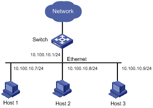

As shown in Figure 1-1, the following occasions may occur in a stable network:
l          All the hosts in a network set the same gateway as their next hop, whose IP address is also known as the next hop address of the default route (for example, the next hop address of the default route is 10.100.10.1 in Figure 1-1).
l          The Switch in the figure acts as the gateway of all the hosts in the network, and forwards the hosts’ packets destined for other network segments, so as to realize the communication between the hosts and the external network.
l          If Switch fails, all the hosts on this segment taking Switch as the default gateway are cut off from the external network.
Figure 1-1 LAN networking
The networking illustrated in Figure 1-1 requires high stability of the default gateway. Normally, adding egress gateways is used to improve the system reliability. In this case, how to route between multiple egresses needs to be solved.

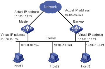

Introduction to VRRP Group
VRRP allows you to combine a group of LAN switches (including a master and several backups) into a VRRP group. The VRRP group functions as a virtual router, forwarding packets as a gateway.
Figure 1-2 VRRP network diagram
As shown in Figure 1-2, a VRRP group has the following features:
l          The virtual router (the VRRP group) has its own IP address (10.100.10.1 in the above figure).
l          The switches within the VRRP group must have their own IP addresses (such as 10.100.10.2 for the master and 10.100.10.3 for the backup).
l          Hosts in the LAN use the IP address of the virtual router (that is, 10.100.10.1) as their default gateway.
l          Hosts in the LAN only know the IP address of this virtual router, that is, 10.100.10.1, but not the specific IP addresses 10.100.10.2 of the master and 10.100.10.3 of the backup.
If the master in the VRRP group goes down, the backups in the VRRP group will reelect a master by priority. The backup with the highest priority functions as the new master to guarantee normal communication between the hosts and the external networks.

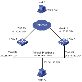

VRRP group and virtual router IP address configuration
To create a VRRP group, you need to configure an IP address for the VRRP group virtual router. The VRRP group is automatically created after you configure the first IP address for the VRRP group virtual router. Other IP addresses configured for the virtual router after this one are just added to the IP address list of the virtual router.
The virtual router IP address has the following features:
l          The IP address of the virtual router can be an unassigned IP address in the network segment where a member switch of the VRRP group resides.
l          You can specify the virtual router IP address as the IP address used by a member switch in the VRRP group. In this case, the member switch is called an IP address owner.
l          The virtual router IP address and the IP addresses used by the member switches in the VRRP group must belong to the same network segment. If not, the VRRP group will be in the initial state (the state before you configure the VRRP on the switches of the group). In this case, VRRP does not take effect.
l          A VRRP group is removed after all its virtual router IP addresses are removed. In this case, all the configurations performed for the VRRP group are disabled.
Do not configure a host IP address as the IP address of the virtual router. If your host IP address is the same as the virtual router IP address of the VRRP group, all the packets sent to the current network segment will be sent to your host. As a result, packets in the network segment cannot be forwarded properly.

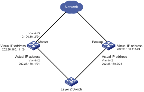

Mapping relationship between virtual router IP addresses and MAC addresses
You can set the mapping between the IP address of the virtual router and the MAC addresses of the member switches of a VRRP group, so that packets sent from the hosts in the network can be forwarded to the correct gateway according to the saved MAC address forwarding table.
There are two types of mapping between the virtual router IP address and the MAC addresses:
l          Virtual router IP address-to-virtual MAC address mapping. By default, a virtual MAC address is automatically created after a virtual router IP address is configured. Hosts send packets to gateways for layer 3 forwarding according to this virtual MAC address. For S3600 series Ethernet switches, you can map multiple virtual router IP addresses of the VRRP group to one virtual MAC address.
l          Virtual router IP address-to-real MAC address mapping. When there is an IP address owner in the VRRP group, a virtual router IP address may correspond to two MAC addresses, a real MAC address of the IP address owner and a virtual MAC address created by default. In this case, you can map virtual router IP addresses to the real MAC address. Then hosts send packets to the IP address owner for layer 3 forwarding according to the real MAC address.
l          You need to configure the mapping between the IP addresses of the VRRP group and the MAC address before enabling VRRP feature on an S3600 Ethernet switch. If VRRP is already enabled, the system does not support this configuration.
l          The number of virtual router IP addresses that can be mapped with the virtual router MAC address is determined by the chips of the switches in the VRRP group.
l          A switch can belong to multiple VRRP groups. However, the number of VRRP groups supported by a switch is determined by the chip it uses. Refer to device specification for details.

Periodical sending of ARP packets in a VRRP Group
If a VRRP group exists on a network, the master sends gratuitous ARP packets periodically to hosts on the network, which then update their local ARP tables, ensuring that no device on this network uses the same IP address with the VRRP virtual router.
As you can create mappings between the IP address and MAC address of the VRRP virtual router, there are two cases:
l          If the IP address of the virtual router corresponds to a virtual MAC address, the source MAC address in the gratuitous ARP packet will be the virtual MAC address.
l          If the IP address of the virtual router corresponds to an actual MAC address, the source MAC address in the gratuitous ARP packet will be the VLAN interface’s MAC address of the master in the VRRP group.

Single-VRRP Group Configuration
Network requirements
Host A uses the VRRP virtual router comprising switch A and switch B as its default gateway to visit host B on the Internet.
The information about the VRRP group is as follows:
l          VRRP group ID: 1
l          Virtual router IP address: 202.38.160.111/24
l          Master: Switch A
l          Backup: Switch B
l          Preemptive mode: enabled
Table 1-1 Network description
Switch
Ethernet port connecting to Host A
IP address of the VLAN interface
Switch priority in the VRRP group
Preemptive mode
LSW-A
Ethernet 1/0/6
202.38.160.1/24
110
Enabled
LSW-B
Ethernet 1/0/5
202.38.160.2/24
100 (default)
Enabled
Network diagram
Figure 1-3 Network diagram for single-VRRP group configuration

VRRP Tracking Interface Configuration
Even when Switch A is still functioning, Switch B (with another link to connect with the outside) can function as a gateway when the interface on Switch A and connecting to Internet does not function properly. This can be implemented by enabling the VLAN interface tracking function.
The VRRP group ID is set to 1, with configurations of authorization key and timer.
Network diagram
Figure 1-4 Network diagram for interface tracking configuration

Port Tracking Configuration Examples
l          VRRP group 1 comprises two switches, which act as the master and the backup.
l          The actual IP addresses of the master and the backups are 10.100.10.2 and 10.100.10.3 respectively.
l          The master is connected to the upstream network through its Ethernet 1/0/1 port. The backup is connected to the upstream network through its Ethernet 1/0/2 port.
l          The virtual router IP address of the VRRP group is 10.100.10.1.
l          Enable the port tracking function on Ethernet 1/0/1 port of the master and specify that the priority of the master decreases by 50 when Ethernet 1/0/1 port fails, which triggers new master being determined in the VRRP group 1.
Network diagram
Figure 1-6 Network diagram for VRRP port tracking configuration
