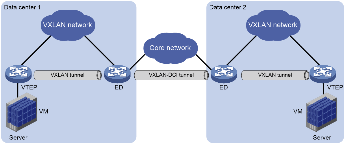

Working mechanisms
In an EVPN-DCI network, BGP EVPN peer relationships are established between EDs and between EDs and VTEPs. When advertising routes to a VTEP or another ED, an ED replaces the routes' nexthop IP address and router MAC address with its IP address and router MAC address.
In an EVPN-DCI network, a VTEP and an ED use a VXLAN tunnel to send traffic, and two EDs use a VXLAN-DCI tunnel to send traffic. An ED de-encapsulates incoming VXLAN packets and re-encapsulates them before forwarding the packets through a VXLAN or VXLAN-DCI tunnel.

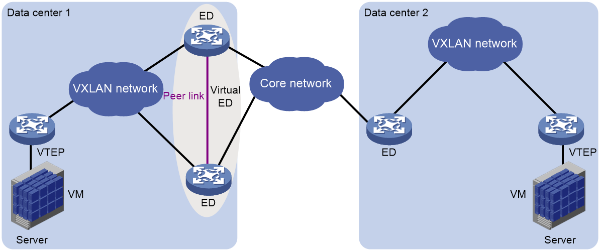

EVPN-DCI M-LAG
IMPORTANT: To use this feature, make sure the site network and the underlay network are both IPv4 networks or both IPv6 networks. |
As shown in Figure 3, you can use multichassis link aggregation (M-LAG) to virtualize two physical EDs of a data center into a virtual ED to prevent single points of failure from interrupting traffic. For more information about M-LAG, see Layer 2—LAN Switching Configuration Guide.
EVPN-DCI M-LAG uses the following mechanisms:
· VM reachability information synchronization—To ensure VM reachability information consistency in the M-LAG system, the member EDs synchronize MAC address entries and ARP or ND information with each other over the peer link. The peer link can only be an Ethernet aggregate link.
· Virtual ED address—The member EDs use a virtual ED address to set up VXLAN tunnels or VXLAN-DCI tunnels with VTEPs or remote EDs.
· Independent BGP neighbor relationship establishment—The member EDs use different BGP peer addresses to establish neighbor relationships with remote devices. For load sharing and link redundancy, a neighbor sends traffic destined for the virtual ED address to both of the member EDs through ECMP routes of the underlay network.
The member EDs in an M-LAG system communicate with remote data centers through the transport network. Devices in the dual-homed data center are unaware of the transport network. When the transport-side link fails on one of the member EDs, traffic destined for remote data centers is still sent to that ED. To resolve this issue, Monitor Link is used together with EVPN-DCI M-LAG.
On each member ED, the transport-facing physical interface is associated with the following loopback interfaces: The loopback interface that provides the IP address used for establishing BGP EVPN neighbor relationships and the loopback interface that provides the virtual ED address. If the transport-side link fails on a member ED, the loopback interfaces are placed in down state, and all traffic is forwarded by the other member ED. For more information about Monitor Link, see High Availability Configuration Guide.

Configuring EVPN-DCI dual-homing
For high availability and load sharing, you can deploy two EDs at a data center. To virtualize the redundant EDs into one device, you must configure the same virtual ED address on them.
Do not configure a virtual ED address on the only ED of a data center.
On a redundant ED, the virtual ED address must be the IP address of a loopback interface, and it cannot be the BGP peer IP address of the ED.
Redundant EDs cannot provide access service for local VMs. They can act only as EDs. For correct communication, do not redistribute external routes on only one of the redundant EDs. However, you can redistribute the same external routes on both EDs.
EVPN-DCI dual-homing is mutually exclusive with EVPN distributed relay. Do not use the evpn edge group and evpn m-lag group commands together.
To use EVPN-DCI dual-homing, make sure the overlay and undelay networks are both IPv4 networks or both IPv6 networks.
If you execute the undo bgp command to disable the BGP instance of the EVPN address family, the evpn edge group setting will also be deleted. Make sure you are fully aware of the impact of the undo bgp command when you use it on a live network.
1. Enter system view.
2. Configure a virtual ED address.
evpn edge group { group-ipv4 | group-ipv6 }
By default, no virtual ED address is configured.

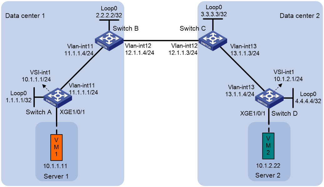

Example: Configuring EVPN-DCI Layer 3 communication (IPv4 underlay network)
As shown in Figure 5:
· Configure VXLAN 10 for data center 1, and configure VXLAN 20 for data center 2.
· Configure Switch A and Switch D as distributed EVPN gateways to perform Layer 3 forwarding between VXLAN 10 and VXLAN 20.
· Configure Switch B and Switch C as EDs.
NOTE: This example provides configuration of IPv4 sites. The configuration procedure does not differ between IPv4 and IPv6 sites. |
1. Configure IP addresses and unicast routing settings:
# On VM 1, specify 10.1.1.1 as the gateway address. On VM 2, specify 10.1.2.1 as the gateway address. (Details not shown.)
# Assign IP addresses to interfaces, as shown in Figure 5. (Details not shown.)
# Configure OSPF on the transport network for the switches to reach one another. (Details not shown.)
2. Configure Switch A:
# Enable L2VPN.
<SwitchA> system-view
[SwitchA] l2vpn enable
# Disable remote MAC address learning and remote ARP learning.
[SwitchA] vxlan tunnel mac-learning disable
[SwitchA] vxlan tunnel arp-learning disable
# Create VXLAN 10 on VSI vpna.
[SwitchA] vsi vpna
[SwitchA-vsi-vpna] vxlan 10
[SwitchA-vsi-vpna-vxlan-10] quit
# Create an EVPN instance on VSI vpna. Configure the switch to automatically generate an RD and a route target for the EVPN instance.
[SwitchA-vsi-vpna] evpn encapsulation vxlan
[SwitchA-vsi-vpna-evpn-vxlan] route-distinguisher auto
[SwitchA-vsi-vpna-evpn-vxlan] vpn-target auto
[SwitchA-vsi-vpna-evpn-vxlan] quit
[SwitchA-vsi-vpna] quit
# Configure BGP to advertise BGP EVPN routes.
[SwitchA] bgp 100
[SwitchA-bgp-default] peer 2.2.2.2 as-number 100
[SwitchA-bgp-default] peer 2.2.2.2 connect-interface loopback 0
[SwitchA-bgp-default] address-family l2vpn evpn
[SwitchA-bgp-default-evpn] peer 2.2.2.2 enable
[SwitchA-bgp-default-evpn] quit
[SwitchA-bgp-default] quit
# On Ten-GigabitEthernet 3/0/1, create Ethernet service instance 1000 to match VLAN 100.
[SwitchA] interface ten-gigabitethernet 3/0/1
[SwitchA-Ten-GigabitEthernet3/0/1] port link-type trunk
[SwitchA-Ten-GigabitEthernet3/0/1] port trunk permit vlan 100
[SwitchA-Ten-GigabitEthernet3/0/1] service-instance 1000
[SwitchA-Ten-GigabitEthernet3/0/1-srv1000] encapsulation s-vid 100
# Map Ethernet service instance 1000 to VSI vpna.
[SwitchA-Ten-GigabitEthernet3/0/1-srv1000] xconnect vsi vpna
[SwitchA-Ten-GigabitEthernet3/0/1-srv1000] quit
# Configure RD and route target settings for VPN instance vpn1.
[SwitchA] ip vpn-instance vpn1
[SwitchA-vpn-instance-vpn1] route-distinguisher 1:1
[SwitchA-vpn-instance-vpn1] address-family ipv4
[SwitchA-vpn-ipv4-vpn1] vpn-target 2:2
[SwitchA-vpn-ipv4-vpn1] quit
[SwitchA-vpn-instance-vpn1] address-family evpn
[SwitchA-vpn-evpn-vpn1] vpn-target 1:1
[SwitchA-vpn-evpn-vpn1] quit
[SwitchA-vpn-instance-vpn1] quit
# Configure VSI-interface 1 as a distributed gateway.
[SwitchA] interface vsi-interface 1
[SwitchA-Vsi-interface1] ip binding vpn-instance vpn1
[SwitchA-Vsi-interface1] ip address 10.1.1.1 255.255.255.0
[SwitchA-Vsi-interface1] mac-address 1-1-1
[SwitchA-Vsi-interface1] distributed-gateway local
[SwitchA-Vsi-interface1] quit
# Create VSI-interface 2. Associate VSI-interface 2 with VPN instance vpn1, and configure the L3 VXLAN ID as 1000 for the VPN instance.
[SwitchA] interface vsi-interface 2
[SwitchA-Vsi-interface2] ip binding vpn-instance vpn1
[SwitchA-Vsi-interface2] l3-vni 1000
[SwitchA-Vsi-interface2] quit
# Specify VSI-interface 1 as the gateway interface for VSI vpna.
[SwitchA] vsi vpna
[SwitchA-vsi-vpna] gateway vsi-interface 1
3. Configure Switch B:
# Enable L2VPN.
<SwitchB> system-view
[SwitchB] l2vpn enable
[SwitchB] vxlan tunnel mac-learning disable
[SwitchB] vxlan tunnel arp-learning disable
# Enable DCI on the Layer 3 interface that connects Switch B to Switch C for the switches to establish a VXLAN-DCI tunnel.
[SwitchB] interface vlan-interface 12
[SwitchB-Vlan-interface12] dci enable
[SwitchB-Vlan-interface12] quit
# Configure BGP to advertise BGP EVPN routes. Enable nexthop replacement for routes advertised to Switch A, and enable router MAC replacement for routes advertised to and received from Switch C.
[SwitchB] bgp 100
[SwitchB-bgp-default] peer 3.3.3.3 as-number 200
[SwitchB-bgp-default] peer 3.3.3.3 connect-interface loopback 0
[SwitchB-bgp-default] peer 3.3.3.3 ebgp-max-hop 64
[SwitchB-bgp-default] peer 1.1.1.1 as-number 100
[SwitchB-bgp-default] peer 1.1.1.1 connect-interface loopback 0
[SwitchB-bgp-default] address-family l2vpn evpn
[SwitchB-bgp-default-evpn] peer 3.3.3.3 enable
[SwitchB-bgp-default-evpn] peer 3.3.3.3 router-mac-local
[SwitchB-bgp-default-evpn] peer 1.1.1.1 enable
[SwitchB-bgp-default-evpn] peer 1.1.1.1 next-hop-local
[SwitchB-bgp-default-evpn] quit
[SwitchB-bgp-default] quit
[SwitchB] ip vpn-instance vpn1
[SwitchB-vpn-instance-vpn1] route-distinguisher 1:2
[SwitchB-vpn-instance-vpn1] address-family ipv4
[SwitchB-vpn-ipv4-vpn1] vpn-target 2:2
[SwitchB-vpn-ipv4-vpn1] quit
[SwitchB-vpn-instance-vpn1] address-family evpn
[SwitchB-vpn-evpn-vpn1] vpn-target 1:1
[SwitchB-vpn-evpn-vpn1] quit
[SwitchB-vpn-instance-vpn1] quit
[SwitchB] interface vsi-interface 2
[SwitchB-Vsi-interface2] ip binding vpn-instance vpn1
[SwitchB-Vsi-interface2] l3-vni 1000
[SwitchB-Vsi-interface2] quit
4. Configure Switch C:
# Enable L2VPN.
<SwitchC> system-view
[SwitchC] l2vpn enable
[SwitchC] vxlan tunnel mac-learning disable
[SwitchC] vxlan tunnel arp-learning disable
# Enable DCI on the Layer 3 interface that connects Switch C to Switch B for the switches to establish a VXLAN-DCI tunnel.
[SwitchC] interface vlan-interface 12
[SwitchC-Vlan-interface12] dci enable
[SwitchC-Vlan-interface12] quit
# Configure BGP to advertise BGP EVPN routes. Enable nexthop replacement for routes advertised to Switch D, and enable router MAC replacement for routes advertised to and received from Switch B.
[SwitchC] bgp 200
[SwitchC-bgp-default] peer 2.2.2.2 as-number 100
[SwitchC-bgp-default] peer 2.2.2.2 connect-interface Loopback 0
[SwitchC-bgp-default] peer 2.2.2.2 ebgp-max-hop 64
[SwitchC-bgp-default] peer 4.4.4.4 as-number 200
[SwitchC-bgp-default] peer 4.4.4.4 connect-interface Loopback 0
[SwitchC-bgp-default] address-family l2vpn evpn
[SwitchC-bgp-default-evpn] peer 2.2.2.2 enable
[SwitchC-bgp-default-evpn] peer 2.2.2.2 router-mac-local
[SwitchC-bgp-default-evpn] peer 4.4.4.4 enable
[SwitchC-bgp-default-evpn] peer 4.4.4.4 next-hop-local
[SwitchC-bgp-default-evpn] quit
[SwitchC-bgp-default] quit
[SwitchC] ip vpn-instance vpn1
[SwitchC-vpn-instance-vpn1] route-distinguisher 1:3
[SwitchC-vpn-instance-vpn1] address-family ipv4
[SwitchC-vpn-ipv4-vpn1] vpn-target 2:2
[SwitchC-vpn-ipv4-vpn1] quit
[SwitchC-vpn-instance-vpn1] address-family evpn
[SwitchC-vpn-evpn-vpn1] vpn-target 1:1
[SwitchC-vpn-evpn-vpn1] quit
[SwitchC-vpn-instance-vpn1] quit
[SwitchC] interface vsi-interface 2
[SwitchC-Vsi-interface2] ip binding vpn-instance vpn1
[SwitchC-Vsi-interface2] l3-vni 1000
[SwitchC-Vsi-interface2] quit
5. Configure Switch D:
# Enable L2VPN.
<SwitchD> system-view
[SwitchD] l2vpn enable
[SwitchD] vxlan tunnel mac-learning disable
[SwitchD] vxlan tunnel arp-learning disable
# Create an EVPN instance on VSI vpnb. Configure the switch to automatically generate an RD and a route target for the EVPN instance.
[SwitchD] vsi vpnb
[SwitchD-vsi-vpnb] evpn encapsulation vxlan
[SwitchD-vsi-vpnb-evpn-vxlan] route-distinguisher auto
[SwitchD-vsi-vpnb-evpn-vxlan] vpn-target auto
[SwitchD-vsi-vpnb-evpn-vxlan] quit
# Create VXLAN 20 on VSI vpnb.
[SwitchD-vsi-vpnb] vxlan 20
[SwitchD-vsi-vpnb-vxlan-20] quit
[SwitchD-vsi-vpnb] quit
[SwitchD] bgp 200
[SwitchD-bgp-default] peer 3.3.3.3 as-number 200
[SwitchD-bgp-default] peer 3.3.3.3 connect-interface Loopback 0
[SwitchD-bgp-default] address-family l2vpn evpn
[SwitchD-bgp-default-evpn] peer 3.3.3.3 enable
[SwitchD-bgp-default-evpn] quit
[SwitchD-bgp-default] quit
# On Ten-GigabitEthernet 3/0/1, create Ethernet service instance 3000 to match VLAN 3.
[SwitchD] interface ten-gigabitethernet 3/0/1
[SwitchD-Ten-GigabitEthernet3/0/1] port link-type trunk
[SwitchD-Ten-GigabitEthernet3/0/1] port trunk permit vlan 3
[SwitchD-Ten-GigabitEthernet3/0/1] service-instance 3000
[SwitchD-Ten-GigabitEthernet3/0/1-srv3000] encapsulation s-vid 3
# Map Ethernet service instance 3000 to VSI vpnb.
[SwitchD-Ten-GigabitEthernet3/0/1-srv3000] xconnect vsi vpnb
[SwitchD-Ten-GigabitEthernet3/0/1-srv3000] quit
[SwitchD] ip vpn-instance vpn1
[SwitchD-vpn-instance-vpn1] route-distinguisher 1:4
[SwitchD-vpn-instance-vpn1] address-family ipv4
[SwitchD-vpn-ipv4-vpn1] vpn-target 2:2
[SwitchD-vpn-ipv4-vpn1] quit
[SwitchD-vpn-instance-vpn1] address-family evpn

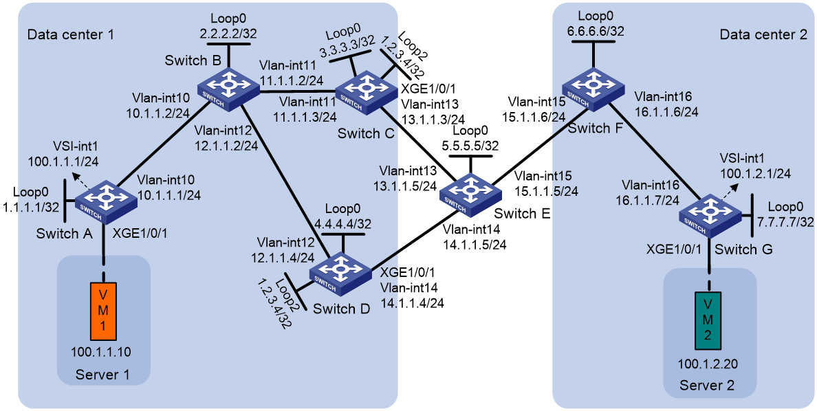

Example: Configuring EVPN-DCI dual-homing
As shown in Figure 7:
· Configure Switch A and Switch G as distributed EVPN gateways to perform Layer 3 forwarding between VXLAN 10 and VXLAN 20.
· Configure Switch C and Switch D as EDs of data center 1, and configure Switch F as the ED of data center 2.
· Configure Switch B as an RR.
NOTE: This example provides configuration of IPv4 sites over an IPv4 underlay network. The configuration procedure does not differ between IPv4 and IPv6 sites or underlay networks. |
# On VM 1, specify 100.1.1.1 as the gateway address. On VM 2, specify 100.1.2.1 as the gateway address. (Details not shown.)
# Assign IP addresses to the interfaces, as shown in Figure 7. (Details not shown.)
# Configure OSPF for the switches to reach one another. (Details not shown.)

Example: Configuring EVPN-DCI M-LAG
As shown in Figure 8:
· For data center 1, configure Switch C and Switch D as EDs and use M-LAG to virtualize them into one device.
· For data center 2, configure Switch F as an ED.
# Assign IP addresses to interfaces, as shown in Figure 8. (Details not shown.)

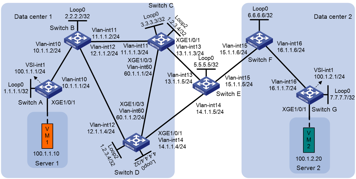

[SwitchC-Vsi-interface2] mac-address 1-2-3
# Configure monitor link group 1 to associate Ten-GigabitEthernet 3/0/1 with Loopback 0 and Loopback 2. Set the switchover delay for the downlink interface to 90 seconds.
[SwitchC] undo monitor-link disable
[SwitchC] monitor-link group 1
[SwitchC-mtlk-group1] port ten-gigabitethernet 3/0/1 uplink
[SwitchC-mtlk-group1] port loopback 0 downlink
[SwitchC-mtlk-group1] port loopback 2 downlink
[SwitchC-mtlk-group1] downlink up-delay 90
[SwitchC-mtlk-group1] quit
# Enable L2VPN.
# Enable DCI on the Layer 3 interface that connects Switch D to Switch E for automatic VXLAN-DCI tunnel establishment.
[SwitchD] interface vlan-interface 14
[SwitchD-Vlan-interface14] dci enable
[SwitchD-Vlan-interface14] quit
# Specify the virtual VTEP address as 1.2.3.4.
[SwitchD] evpn m-lag group 1.2.3.4
# Configure M-LAG system parameters.
[SwitchD] m-lag system-mac 0001-0001-0001
[SwitchD] m-lag system-number 2
[SwitchD] m-lag system-priority 10
[SwitchD] m-lag keepalive ip destination 60.1.1.1 source 60.1.1.2
[SwitchD] m-lag restore-delay 180
# Create Layer 2 dynamic aggregate interface Bridge-Aggregation 3.
[SwitchD] interface bridge-aggregation 3
[SwitchD-Bridge-Aggregation3] link-aggregation mode dynamic
[SwitchD-Bridge-Aggregation3] quit
# Assign Ten-GigabitEthernet 3/0/3 to link aggregation group 3.
[SwitchD] interface ten-gigabitethernet 3/0/3
[SwitchD-Ten-GigabitEthernet3/0/3] port link-aggregation group 3
[SwitchD-Ten-GigabitEthernet3/0/3] quit
# Specify Bridge-Aggregation 3 as the peer-link interface.
[SwitchD-Bridge-Aggregation3] port m-lag peer-link 1
# Configure BGP to advertise BGP EVPN routes. Enable nexthop replacement for routes advertised to Switch B, and enable router MAC replacement for routes advertised to and received from Switch F.
[SwitchD] bgp 100
[SwitchD-bgp-default] peer 6.6.6.6 as-number 200
[SwitchD-bgp-default] peer 6.6.6.6 connect-interface loopback 0
[SwitchD-bgp-default] peer 6.6.6.6 ebgp-max-hop 64
[SwitchD-bgp-default] peer 2.2.2.2 as-number 100
[SwitchD-bgp-default] peer 2.2.2.2 connect-interface loopback 0
[SwitchD-bgp-default-evpn] nexthop evpn-m-lag group-address
[SwitchD-bgp-default-evpn] peer 6.6.6.6 enable
[SwitchD-bgp-default-evpn] peer 6.6.6.6 router-mac-local
[SwitchD-bgp-default-evpn] peer 2.2.2.2 enable
[SwitchD-bgp-default-evpn] peer 2.2.2.2 next-hop-local
[SwitchD-vpn-instance-vpn1] route-distinguisher 1:2
[SwitchD-vpn-evpn-vpn1] vpn-target 1:1
[SwitchD-vpn-evpn-vpn1] quit
[SwitchD-vpn-instance-vpn1] quit
[SwitchD] interface vsi-interface 2
[SwitchD-Vsi-interface2] ip binding vpn-instance vpn1
[SwitchD-Vsi-interface2] l3-vni 1000
[SwitchD-Vsi-interface2] mac-address 1-2-3
[SwitchD-Vsi-interface2] quit
[SwitchD] undo monitor-link disable
[SwitchD] monitor-link group 1
[SwitchD-mtlk-group1] port ten-gigabitethernet 3/0/1 uplink
[SwitchD-mtlk-group1] port loopback 0 downlink
[SwitchD-mtlk-group1] port loopback 2 downlink
[SwitchD-mtlk-group1] downlink up-delay 90
[SwitchD-mtlk-group1] quit
6. Configure Switch F:
# Enable L2VPN.
<SwitchF> system-view
[SwitchF] l2vpn enable
[SwitchF] vxlan tunnel mac-learning disable
[SwitchF] vxlan tunnel arp-learning disable
# Enable DCI on the Layer 3 interface that connects Switch F to Switch E for automatic VXLAN-DCI tunnel establishment.
[SwitchF] interface vlan-interface 15
[SwitchF-Vlan-interface15] dci enable
[SwitchF-Vlan-interface15] quit
# Configure BGP to advertise BGP EVPN routes. Enable nexthop replacement for routes advertised to Switch G, and enable router MAC replacement for routes advertised to and received from Switch C and Switch D.
[SwitchF] bgp 200
[SwitchF-bgp-default] peer 3.3.3.3 as-number 100
[SwitchF-bgp-default] peer 3.3.3.3 connect-interface loopback 0
[SwitchF-bgp-default] peer 3.3.3.3 ebgp-max-hop 64
[SwitchF-bgp-default] peer 4.4.4.4 as-number 100
[SwitchF-bgp-default] peer 4.4.4.4 connect-interface loopback 0
[SwitchF-bgp-default] peer 4.4.4.4 ebgp-max-hop 64
[SwitchF-bgp-default] peer 7.7.7.7 as-number 200
[SwitchF-bgp-default] peer 7.7.7.7 connect-interface loopback 0
[SwitchF-bgp-default] address-family l2vpn evpn
[SwitchF-bgp-default-evpn] peer 3.3.3.3 enable
[SwitchF-bgp-default-evpn] peer 3.3.3.3 router-mac-local
[SwitchF-bgp-default-evpn] peer 4.4.4.4 enable
[SwitchF-bgp-default-evpn] peer 4.4.4.4 router-mac-local
[SwitchF-bgp-default-evpn] peer 7.7.7.7 enable
[SwitchF-bgp-default-evpn] peer 7.7.7.7 next-hop-local
[SwitchF-bgp-default-evpn] quit
[SwitchF-bgp-default] quit
[SwitchF] ip vpn-instance vpn1
[SwitchF-vpn-instance-vpn1] route-distinguisher 1:4
[SwitchF-vpn-instance-vpn1] address-family ipv4
[SwitchF-vpn-ipv4-vpn1] vpn-target 2:2
[SwitchF-vpn-ipv4-vpn1] quit
[SwitchF-vpn-instance-vpn1] address-family evpn
[SwitchF-vpn-evpn-vpn1] vpn-target 1:1
[SwitchF-vpn-evpn-vpn1] quit
[SwitchF-vpn-instance-vpn1] quit
[SwitchF] interface vsi-interface 2
[SwitchF-Vsi-interface2] ip binding vpn-instance vpn1
[SwitchF-Vsi-interface2] l3-vni 1000
[SwitchF-Vsi-interface2] quit
7. Configure Switch G:
# Enable L2VPN.
<SwitchG> system-view
[SwitchG] l2vpn enable
[SwitchG] vxlan tunnel mac-learning disable
[SwitchG] vxlan tunnel arp-learning disable
[SwitchG] vsi vpnb
[SwitchG-vsi-vpnb] vxlan 20
[SwitchG-vsi-vpnb-vxlan-20] quit
[SwitchG-vsi-vpnb] evpn encapsulation vxlan
[SwitchG-vsi-vpnb-evpn-vxlan] route-distinguisher auto
[SwitchG-vsi-vpnb-evpn-vxlan] vpn-target auto
[SwitchG-vsi-vpnb-evpn-vxlan] quit
[SwitchG-vsi-vpnb] quit
[SwitchG] bgp 200
[SwitchG-bgp-default] peer 6.6.6.6 as-number 200
[SwitchG-bgp-default] peer 6.6.6.6 connect-interface loopback 0
[SwitchG-bgp-default] address-family l2vpn evpn
[SwitchG-bgp-default-evpn] peer 6.6.6.6 enable
[SwitchG-bgp-default-evpn] quit
[SwitchG-bgp-default] quit
# On Ten-GigabitEthernet 3/0/1, create Ethernet service instance 2000 to match VLAN 200.
[SwitchG] interface ten-gigabitethernet 3/0/1
[SwitchG-Ten-GigabitEthernet3/0/1] port link-type trunk
[SwitchG-Ten-GigabitEthernet3/0/1] port trunk permit vlan 200
[SwitchG-Ten-GigabitEthernet3/0/1] service-instance 2000
[SwitchG-Ten-GigabitEthernet3/0/1-srv2000] encapsulation s-vid 200
# Map Ethernet service instance 2000 to VSI vpnb.
[SwitchG-Ten-GigabitEthernet3/0/1-srv2000] xconnect vsi vpnb
[SwitchG-Ten-GigabitEthernet3/0/1-srv2000] quit
[SwitchG] ip vpn-instance vpn1
[SwitchG-vpn-instance-vpn1] route-distinguisher 1:4
[SwitchG-vpn-instance-vpn1] address-family ipv4
[SwitchG-vpn-ipv4-vpn1] vpn-target 2:2
[SwitchG-vpn-ipv4-vpn1] quit
[SwitchG-vpn-instance-vpn1] address-family evpn
[SwitchG-vpn-evpn-vpn1] vpn-target 1:1
[SwitchG-vpn-evpn-vpn1] quit
[SwitchG-vpn-instance-vpn1] quit
[SwitchG] interface vsi-interface 1
[SwitchG-Vsi-interface1] ip binding vpn-instance vpn1
[SwitchG-Vsi-interface1] ip address 100.1.2.1 255.255.255.0
[SwitchG-Vsi-interface1] mac-address 2-2-2
[SwitchG-Vsi-interface1] distributed-gateway local
[SwitchG-Vsi-interface1] quit
[SwitchG] interface vsi-interface 2
[SwitchG-Vsi-interface2] ip binding vpn-instance vpn1
[SwitchG-Vsi-interface2] l3-vni 1000
[SwitchG-Vsi-interface2] quit
# Specify VSI-interface 1 as the gateway interface for VSI vpnb.
[SwitchG] vsi vpnb
[SwitchG-vsi-vpnb] gateway vsi-interface 1
1. Verify the configuration on EDs. (This example uses Switch C.)
# Verify that the ED has discovered Switch A and Switch F through MAC/IP advertisement routes and IP prefix advertisement routes, and has established VXLAN and VXLAN-DCI tunnels to the switches.
[SwitchC] display evpn auto-discovery macip-prefix
Destination IP Source IP L3VNI Tunnel mode OutInterface
1.1.1.1 3.3.3.3 1000 VXLAN Vsi-interface2
6.6.6.6 3.3.3.3 1000 VXLAN-DCI Vsi-interface2
# Verify that the VXLAN and VXLAN-DCI tunnels on the ED are up.
[SwitchC] display interface tunnel
Tunnel1
Current state: UP
Line protocol state: UP
Description: Tunnel1 Interface
Bandwidth: 64 kbps
Maximum transmission unit: 1464
Internet protocol processing: Disabled
Last clearing of counters: Never
Tunnel source 1.2.3.4, destination 1.1.1.1
Tunnel protocol/transport UDP_VXLAN/IP
Last 300 seconds input rate: 0 bytes/sec, 0 bits/sec, 0 packets/sec
Last 300 seconds output rate: 0 bytes/sec, 0 bits/sec, 0 packets/sec
Input: 0 packets, 0 bytes, 0 drops
Output: 0 packets, 0 bytes, 0 drops
Tunnel2
Current state: UP
Description: Tunnel2 Interface
Bandwidth: 64 kbps
Tunnel source 1.2.3.4, destination 6.6.6.6
Tunnel protocol/transport UDP_VXLAN-DCI/IP
# Verify that the ED has ARP entries and routes for the VMs.
[SwitchC] display ip routing-table vpn-instance vpn1
Destinations : 4 Routes : 4
Destination/Mask Proto Pre Cost NextHop Interface
100.1.1.0/24 BGP 255 0 1.1.1.1 Vsi2
100.1.1.10/32 BGP 255 0 1.1.1.1 Vsi2
100.1.2.0/24 BGP 255 0 6.6.6.6 Vsi2
100.1.2.20/32 BGP 255 0 6.6.6.6 Vsi2
2. Verify the configuration on Switch A:
# Verify that the switch has discovered the virtual ED through MAC/IP advertisement routes and IP prefix advertisement routes, and has established a VXLAN tunnel to the virtual ED.
[SwitchA] display evpn auto-discovery macip-prefix
1.2.3.4 1.1.1.1 1000 VXLAN Vsi-interface2
# Verify that the VXLAN tunnel on the switch is up.
[SwitchA] display interface tunnel
Tunnel1
Current state: UP
Bandwidth: 64 kbps
Tunnel source 1.1.1.1, destination 1.2.3.4
# Verify that the switch has ARP entries and routes for the VMs.
[SwitchA] display ip routing-table vpn-instance vpn1
100.1.2.0/24 BGP 255 0 1.2.3.4 Vsi2
100.1.2.10/32 BGP 255 0 1.2.3.4 Vsi2
3. Verify that VM 1 and VM 2 can communicate when both Switch C and Switch D are working correctly and when Switch C or Switch D fails. (Details not shown.)
