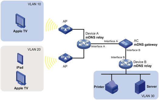

As shown in Figure 1, mDNS endpoint devices (Apple TVs and iPad) and mDNS service providers (printer and server) are in different VLANs. APs and the AC require inter-subnet Layer 3 communication. The AC acts as the mDNS gateway and cannot receive multicast mDNS packets sent from the endpoint devices and service providers.
To resolve this problem, enable mDNS relay on Device A and Device B and specify the mDNS gateway address on them. After receiving an mDNS packet from an endpoint device, Device A changes the packet destination IP address to the mDNS gateway address and unicasts it to the gateway. After receiving an mDNS packet from an mDNS service provider, Device B changes the packet destination IP address to the mDNS gateway address and unicasts it to the gateway.

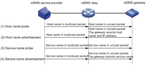

Relaying mDNS service advertisements
An mDNS service provider advertises its service to the mDNS gateway when it is attached to the network. The host name identifies the mDNS service provider and the service name identifies service type and other information provided by the service provider.
As shown in Figure 2, an mDNS service provider probes and advertises the host name and service name in the following workflow:
1.      Host name probe.
a.    The mDNS service provider automatically generates a host name after it is attached to the network. To detect the uniqueness of the host name, the service provider sends an mDNS query with multicast destination address 224.0.0.251 and starts the probe timer.
b.    After receiving the query, the mDNS relay replaces the destination IP address with the mDNS gateway address and unicasts it to the mDNS gateway.
c.    The mDNS gateway examines whether the host name conflicts with host names of existing mDNS service entries. If a conflict exists, the mDNS gateway sends the mDNS relay an mDNS response to announce the conflict. The mDNS relay changes the destination IP address of the response to multicast address 224.0.0.251 and forwards it to the mDNS service provider.
d.    After receiving the conflict announcement, the mDNS service provider generates another host name and starts probing again.
2.      Host name advertisement.
a.    The mDNS service provider advertises its host name if it does not receive any host name conflict announcement within the probe period. The destination of the advertisement packet is 224.0.0.251.
b.    After receiving the packet, the mDNS relay changes the packet destination IP address to the mDNS gateway address and unicasts it to the mDNS gateway.
c.    The mDNS gateway records the host name and IP address in the received packet.
3.      Service name probe.
a.    The mDNS service provider sends an mDNS query with destination address 224.0.0.251 to detect the uniqueness of the service name and starts the probe timer.
c.    The mDNS gateway examines whether the service name conflicts with service names of existing mDNS service entries. If a conflict exists, the mDNS gateway sends the mDNS relay an mDNS response to announce the conflict. The mDNS relay changes the destination IP address of the response to multicast address 224.0.0.251 and forwards it to the mDNS service provider.
d.    After receiving the conflict announcement, the mDNS service provider generates another service name and starts probing again.
4.      Service name advertisement.
a.    The mDNS service provider advertises its service name if it does not receive any service name conflict announcement within the probe period. The destination of the advertisement packet is 224.0.0.251.
c.    The mDNS gateway records the service name information in the received packet.
Figure 2 Relaying mDNS service advertisements

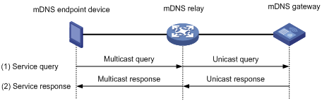

As shown in Figure 3, an mDNS query originated from the mDNS endpoint device is relayed as follows:
1.      Before accessing a service, the mDNS endpoint device first sends an mDNS query with multicast address 224.0.0.251 to detect whether this service is available.
2.      Upon receiving the query, the mDNS relay changes the query destination IP address to the mDNS gateway address and unicasts the query to the gateway.
3.      The mDNS gateway looks for a matching service after receiving the query. If the matching service exists, the mDNS gateway encapsulates the host name and IP address of the service provider into the response and unicasts it to the mDNS relay.
4.      The mDNS relay changes the response destination IP address to 224.0.0.251 and multicasts the response.
5.      After receiving the response, the mDSN endpoint device can access the service provider based on the IP address in the response. Other mDNS endpoints that receive the response will also record information about the service provider for future use.
Figure 3 Relaying mDNS queries

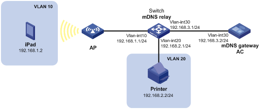

Network requirements
As shown in Figure 4, an enterprise network uses mDNS for communication. The working area is in VLAN 10 and uses subnet 192.168.1.0. The service area is in VLAN 20 and uses subnet 192.168.2.0. Subnet 192.168.3.0 runs between the mDNS relay and the mDNS gateway.
Configure mDNS relay on the switch to allow employers in the working area to access the printer in the service area.
Figure 4 Network diagram
1.      Configure the mDNS gateway and make sure route among the AP, the mDNS relay, and the mDNS gateway is reachable. (Details not shown.)
2.      Configure the mDNS relay.
# Specify 192.168.3.2 as the mDNS gateway address.
<Switch> system-view
[Switch] mdns relay gateway ip 192.168.3.2
# Enable mDNS relay in VLAN 10.
[Switch] vlan 10
[Switch-vlan10] mdns relay enable
# Specify 192.168.3.1 as the source IP address for mDNS packets.
[Switch-vlan10] mdns relay source ip 192.168.3.1
[Switch-vlan10] quit
# Enable mDNS relay in VLAN 20.
[Switch] vlan 20
[Switch-vlan20] mdns relay enable
[Switch-vlan20] mdns relay source ip 192.168.3.1
[Switch-vlan20] quit
# Display mDNS relay configuration.
[Switch] display mdns relay
mDNS relay configuration:
mDNS gateway IP: 192.168.3.2
mDNS relay configuration in VLANs:
VLAN ID  Source IP address           Probe interval (sec)
10       192.168.3.1                 --
20       192.168.3.1                 --
# Verify that the user in VLAN 10 can use the iPad to access the printer in VLAN 20. (Details not shown.)
