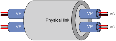

ATM is connection-oriented, and ATM connections are logical (virtual) connections. In an ATM network, you can create logical connections called virtual paths (VPs) and virtual circuits (VCs) on physical links.
As shown in Figure 1, you can create multiple VPs on a physical link, and each VP can be demultiplexed into multiple VCs. Cells from different users are transmitted over different VPs and VCs, which are identified by virtual path identifier (VPI) and virtual channel identifier (VCI). ATM uses VPI/VCI pairs to identify virtual connections.
Figure 1 Physical link, VP, and VC
ATM interfaces support only manually created permanent virtual circuits (PVCs), not switched virtual circuits (SVCs) created through the exchange of signals. A PVC is identified by a VPI/VCI pair.

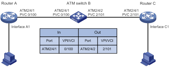

In an ATM network, an ATM switch forwards ATM cells by looking up the switching entries and changing the VPIs/VCIs. In PVC mode, the network administrator configures the switching entries and assigns VPIs/VCIs. Users can use the assigned VPIs/VCIs to configure the PVCs. If the ATM interfaces of two ATM devices are directly connected, they must be configured with the same VPIs/VCIs.
Figure 2 shows a typical ATM switching process:
1.        Router A forwards a cell through PVC 0/100 on interface ATM 2/4/1.
2.        ATM switch B receives the cell through PVC 0/100 on interface ATM 2/4/1.
3.        ATM switch B looks up its switching entries and forwards the cell through PVC 2/101 on interface ATM 2/4/2.
4.        Router C receives the cell through PVC 2/101 on interface ATM 2/4/1.
Figure 2 ATM switching

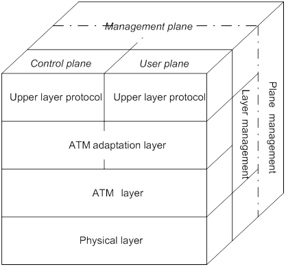

ATM architecture
ATM has a three-dimensional architecture. It contains the user plane, control plane, and management plane.
Both the user plane and the control plane are divided into the following layers: physical layer, ATM layer, ATM Adaptation Layer (AAL), and upper layer. Each layer is further divided into sublayers.
The control plane establishes and tears down connections with signaling protocols. The management plane contains layer management and plane management. Layer management manages the layers in each plane and has a layered structure corresponding to other planes. Plane management manages the system and the communications between different planes.
Figure 3 shows the relationships between layers and planes in ATM.
Figure 3 ATM architecture
ATM layers have the following functions:
·          Physical layer—Provides transmission channels for ATM cells. At this layer, cells received from the ATM layer are transferred into a continuous bit stream after transmission overheads are added to them. Meanwhile, continuous bit streams received from physical media are restored to cells, which are then passed to the ATM layer.
·          ATM layer—Resides over the physical layer, and implements cell-based communication with its peer layer by invoking the services provided by the physical layer. It is independent of physical media, implementation of the physical layer, and types of services being carried. AAL passes 48-byte payloads, which are called segmentation and reassembly protocol data units (SAR-PDUs) to the ATM layer. The ATM layer encapsulates the 48-byte payloads in 5-byte headers, and passes 53-byte cells to the physical layer. Other functions of the ATM layer include VPI/VCI transmission, cell multiplexing/demultiplexing, and generic flow control.
·          ATM Adaptation Layer—Provides interfaces between high-level protocols and the ATM Layer. It forwards information between the ATM layer and upper-layer protocols. Four types of AAL are available: AAL1, AAL2, AAL3/4, and AAL5, each of which supports specific services provided in an ATM network. H3C uses AAL5 for data communication services.
·          ATM upper-layer protocols—Responsible for WAN interconnection, Layer 3 interconnection, and IP over ATM.

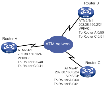

Example: Configuring IPoA
As shown in Figure 5, Router A, B, and C are connected to the ATM network for intercommunication.
The IP addresses of the ATM interfaces of the three routers are 202.38.160.1/24, 202.38.160.2/24, and 202.38.160.3/24.
In the ATM network:
·          The VPIs/VCIs of Router A are 0/40 and 0/41, connected to Router B and Router C, respectively.
·          The VPIs/VCs of Router B are 0/50 and 0/51, connected to Router A and Router C, respectively.
·          The VPIs/VCIs of Router C are 0/60 and 0/61, connected to Router A and Router B, respectively.
All the PVCs on ATM interfaces of the three routers operate in IPoA application mode.
Figure 5 Network diagram
1.        Configure Router A:
# Enter the view of interface ATM 2/4/1 and configure an IP address for it.
<RouterA> system-view
[RouterA] interface atm 2/4/1
[RouterA-ATM2/4/1] ip address 202.38.160.1 255.255.255.0
# Create PVCs, and enable them to carry IP.
[RouterA-ATM2/4/1] pvc to_b 0/40
[RouterA-ATM2/4/1-pvc-to_b-0/40] map ip 202.38.160.2
[RouterA-ATM2/4/1-pvc-to_b-0/40] quit
[RouterA-ATM2/4/1] pvc to_c 0/41
[RouterA-ATM2/4/1-pvc-to_c-0/41] map ip 202.38.160.3
2.        Configure Router B:
<RouterB> system-view
[RouterB] interface atm 2/4/1
[RouterB-ATM2/4/1] ip address 202.38.160.2 255.255.255.0
[RouterB-ATM2/4/1] pvc to_a 0/50
[RouterB-ATM2/4/1-pvc-to_a-0/50] map ip 202.38.160.1
[RouterB-ATM2/4/1-pvc-to_a-0/50] quit
[RouterB-ATM2/4/1] pvc to_c 0/51
[RouterB-ATM2/4/1-pvc-to_c-0/51] map ip 202.38.160.3
3.        Configure Router C:
<RouterC> system-view
[RouterC] interface atm 2/4/1
[RouterC-ATM2/4/1] ip address 202.38.160.3 255.255.255.0
[RouterC-ATM2/4/1] pvc to_a 0/60
[RouterC-ATM2/4/1-pvc-to_a-0/60] map ip 202.38.160.1
[RouterC-ATM2/4/1-pvc-to_a-0/60] quit
[RouterC-ATM2/4/1] pvc to_b 0/61
[RouterC-ATM2/4/1-pvc-to_b-0/61] map ip 202.38.160.2
# Use the ping command to verify that the three routers can ping each other successfully. (Details not shown.)
