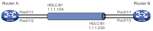

Configuring HDLC link bundling
About HDLC link bundling
HDLC link bundling bundles multiple interfaces using HDLC encapsulation (also known as HDLC interfaces) together to form one logical link.

HDLC link bundle interface
An HDLC link bundle interface is a logical interface comprising a bundle of HDLC links.
HDLC link bundle
An HDLC link bundle is a group of HDLC interfaces. When you create an HDLC link bundle interface, an HDLC link bundle numbered the same as the HDLC link bundle interface is automatically generated.
Member interface
An interface assigned to an HDLC link bundle is called an HDLC link bundle member interface. Only POS interfaces with HDLC encapsulation enabled can be assigned to an HDLC link bundle.
Member interfaces in an HDLC link bundle use the configuration on the HDLC link bundle interface to process Layer 3 services. All layer 3 service settings on the member interfaces, including the IP address, are void when the interfaces are assigned to the HDLC link bundle.

Configuring an HDLC link bundle interface
Configuring basic settings of an HDLC link bundle interface
To guarantee correct traffic transmission, as a best practice, configure each of the following parameters the same at both ends of an HDLC link bundle:
·          Minimum number of Selected interfaces required for bringing up the HDLC link bundle.
·          Maximum number of Selected interfaces allowed in the HDLC link bundle.
·          Minimum bandwidth required for bringing up the HDLC link bundle.
After the HDLC link bundle configuration is complete, the state of each member interface is determined again if you modify any of the following parameters:

As shown in Figure 2, to increase bandwidth and enhance connection reliability between Router A and Router B, create an HDLC link bundle.
Figure 2 Network diagram
1.        Configure Router A:
# Create HDLC link bundle interface 1 and assign an IP address to it.
<RouterA> system-view
[RouterA] interface hdlc-bundle 1
[RouterA-HDLC-bundle1] ip address 1.1.1.1 24
[RouterA-HDLC-bundle1] quit
# Assign POS 3/1/1 to HDLC link bundle 1, and configure the interface to use the master clock mode.
[RouterA] interface pos 3/1/1
[RouterA-Pos3/1/1] clock master
[RouterA-Pos3/1/1] link-protocol hdlc
[RouterA-Pos3/1/1] bundle id 1
[RouterA-Pos3/1/1] quit
# Assign POS 3/1/2 to HDLC link bundle 1, and configure the interface to use the master clock mode.
[RouterA] interface pos 3/1/2
[RouterA-Pos3/1/2] clock master
[RouterA-Pos3/1/2] link-protocol hdlc
[RouterA-Pos3/1/2] bundle id 1
[RouterA-Pos3/1/2] quit
2.        Configure Router B:
<RouterB> system-view
[RouterB] interface hdlc-bundle 1
[RouterB-HDLC-bundle1] ip address 1.1.1.2 24
[RouterB-HDLC-bundle1] quit
# Assign POS 3/1/1 to HDLC link bundle 1.
[RouterB] interface pos 3/1/1
[RouterB-Pos3/1/1] link-protocol hdlc
[RouterB-Pos3/1/1] bundle id 1
[RouterB-Pos3/1/1] quit
# Assign POS 3/1/2 to HDLC link bundle 1.
[RouterB] interface pos 3/1/2
[RouterB-Pos3/1/2] link-protocol hdlc
[RouterB-Pos3/1/2] bundle id 1
[RouterB-Pos3/1/2] quit
# Verify that the HDLC link bundle interfaces on Router A and Router B can ping each other.
[RouterA] ping –a 1.1.1.1 1.1.1.2
Ping 1.1.1.2 (1.1.1.2) from 1.1.1.1: 56 data bytes, press CTRL_C to break
56 bytes from 1.1.1.2: icmp_seq=0 ttl=255 time=0.000 ms
56 bytes from 1.1.1.2: icmp_seq=1 ttl=255 time=0.000 ms
56 bytes from 1.1.1.2: icmp_seq=2 ttl=255 time=0.000 ms
56 bytes from 1.1.1.2: icmp_seq=3 ttl=255 time=0.000 ms
56 bytes from 1.1.1.2: icmp_seq=4 ttl=255 time=0.000 ms
--- Ping statistics for 1.1.1.2 ---
round-trip min/avg/max/std-dev = 0.000/0.000/0.000/0.000 ms
# Verify that:
·          POS 3/1/1 and POS 3/1/2 are in Selected state and can perform load balancing.
·          The bandwidth of the HDLC link bundle is 1244160 kbps, the total bandwidth of two POS interfaces.
·          When one POS interface fails, the traffic can be forwarded through the other POS interface. This improves the link reliability.
Use Router A as an example.
[RouterA] display bundle hdlc-bundle 1
Bundle: HDLC-bundle1
  Selected members: 2, Total bandwidth: 1244160 kbps
  Member              State               Bandwidth(kbps)     Priority
  Pos3/1/1            Selected            622080              32768
  Pos3/1/2            Selected            622080              32768
