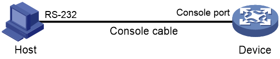

You can connect a terminal to the console port of the device to log in and manage the device, as shown in Figure 2. For information about the login procedure, see "Using the console port for the first device access."
Figure 2 Logging in through the console port
By default, console login is enabled and does not require authentication. The default user role is network-admin for a console user. To improve device security, configure password or scheme authentication for console login immediately after you log in to the device for the first time.

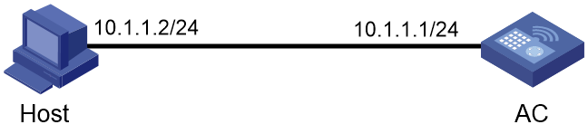

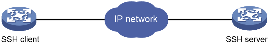

Using the device to log in to a Telnet server
You can use the device as a Telnet client to log in to a Telnet server.
Figure 3 Telnetting from the device to a Telnet server
Assign an IP address to the device and obtain the IP address of the Telnet server. If the device resides on a different subnet than the Telnet server, make sure the device and the Telnet server can reach each other.
2.     (Optional.) Specify the source IPv4 address or source interface for outgoing Telnet packets.
telnet client source { interface interface-type interface-number | ip ip-address }
By default, no source IPv4 address or source interface is specified. The device uses the primary IPv4 address of the output interface as the source address for outgoing Telnet packets.
3.     Return to user view.
4.     Use the device to log in to a Telnet server.
IPv4:
telnet remote-host [ service-port ] [ source { interface interface-type interface-number | ip ip-address } | dscp dscp-value ] *
IPv6:
telnet ipv6 remote-host [ -i interface-type interface-number ] [ port-number ] [ source { interface interface-type interface-number | ipv6 ipv6-address } | dscp dscp-value ] *

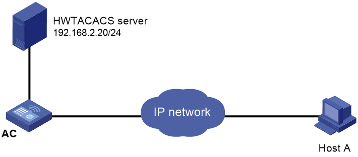

Using the device to log in to an SSH server
You can use the device as an SSH client to log in to an SSH server.
Figure 4 Logging in to an SSH server from the device
Assign an IP address to the device and obtain the IP address of the SSH server. If the device resides on a different subnet than the SSH server, make sure the device and the SSH server can reach each other.
To use the device to log in to an SSH server, execute one of the following commands in user view:
IPv4:
ssh2 server
IPv6:
ssh2 ipv6 server
To work with the SSH server, you might need to specify a set of parameters. For more information, see Security Configuration Guide.

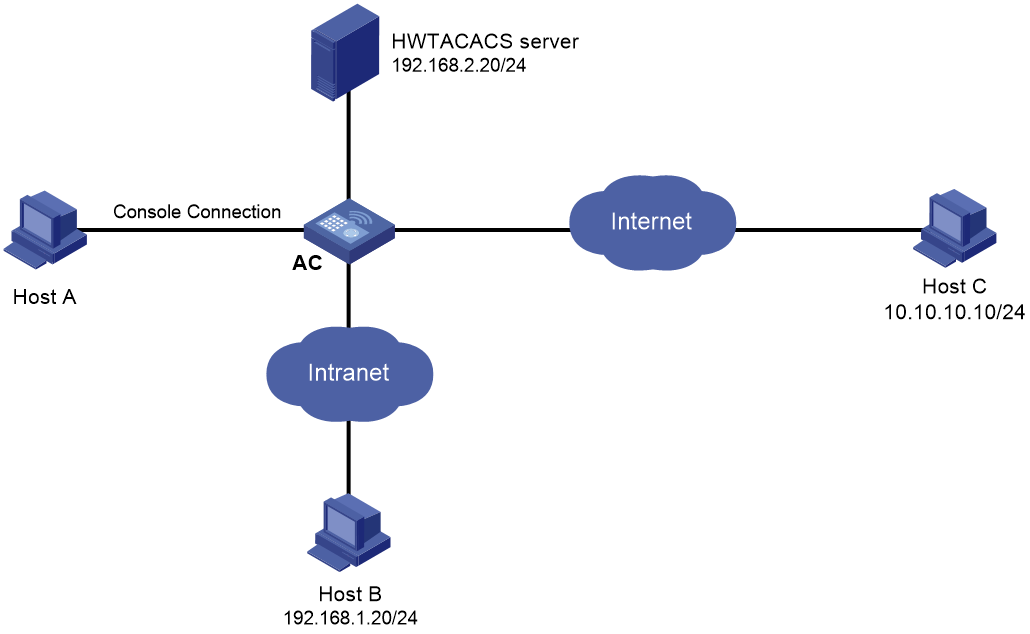

Web login configuration examples

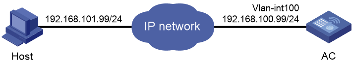

Example: Configuring HTTP login
As shown in Figure 5, the host and the AC can communicate over the IP network.
Configure the AC to allow the host to log in by using HTTP.
Figure 5 Network diagram
# Create VLAN-interface 100 and assign IP address 192.168.100.99/24 to the interface. (Details not shown.)
# Create a local user named admin. Set the password to hello12345, the service type to HTTP, and the user role to network-admin.
<AC> system-view
[AC] local-user admin
[AC-luser-manage-admin] service-type http
[AC-luser-manage-admin] authorization-attribute user-role network-admin
[AC-luser-manage-admin] password simple hello12345
[AC-luser-manage-admin] quit
# Enable HTTP.
[AC] ip http enable
1.     On the host, run a Web browser and enter the IP address of the device in the address bar.
The Web login page appears.
2.     Enter the username and password. Click Login.
After you pass authentication, the homepage appears and you can configure the AC.

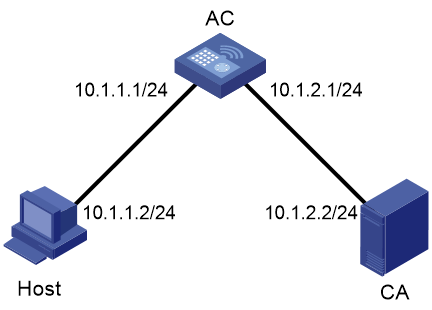

Example: Configuring HTTPS login with a Windows Server 2003 CA server
As shown in Figure 6, the host, AC, and CA can communicate over the IP network.
Perform the following tasks to allow only authorized users to access the AC's Web interface:
·     Configure the AC as the HTTPS server and request a certificate for the AC.
·     Configure the host as the HTTPS client and request a certificate for the host.
Figure 6 Network diagram
If the Windows Server 2003 CA server is used to issue certificates for the AC and the host, a security risk prompt will pop up when a user accesses the AC over HTTPS. If the user can accept the risk brought by this type of authentication, choose to ignore the prompt and continue to browse the webpage.
Assign IP addresses to relevant interfaces. Make sure the host, AC, and CA can communicate over the IP network. (Details not shown.)
This example uses a Windows Server 2003 CA server. Configure the Windows Server 2003 CA server as required. For more information, see PKI configuration in Security Configuration Guide.
1.     Configure the AC (HTTPS server):
# Create PKI entity en and set entity parameters.
<AC> system-view
[AC] pki entity en
[AC-pki-entity-en] common-name http-server1
[AC-pki-entity-en] fqdn ssl.security.com
[AC-pki-entity-en] quit
# Create PKI domain 1 and set domain parameters.
[AC] pki domain 1
[AC-pki-domain-1] ca identifier new-ca
[AC-pki-domain-1] certificate request url http://10.1.2.2/certsrv/mscep/mscep.dll
[AC-pki-domain-1] certificate request from ra
[AC-pki-domain-1] certificate request entity en
# Configure the PKI domain to use the 1024-bit long RSA key pair hostkey for both signing and encryption.
[AC-pki-domain-1] public-key rsa general name hostkey length 1024
[AC-pki-domain-1] quit
# Create RSA local key pairs.
[AC] public-key local create rsa
# Retrieve the CA certificate.
[AC] pki retrieve-certificate domain 1 ca
# Configure the AC to request a local certificate through SCEP.
[AC] pki request-certificate domain 1
# Create SSL server policy myssl. Specify PKI domain 1 for the SSL server policy, and enable certificate-based SSL client authentication.
[AC] ssl server-policy myssl
[AC-ssl-server-policy-myssl] pki-domain 1
[AC-ssl-server-policy-myssl] client-verify enable
[AC-ssl-server-policy-myssl] quit
# Create certificate attribute group mygroup1. Configure a certificate attribute rule that matches statements with the string of new-ca in the distinguished name of the subject name.
[AC] pki certificate attribute-group mygroup1
[AC-pki-cert-attribute-group-mygroup1] attribute 1 issuer-name dn ctn new-ca
[AC-pki-cert-attribute-group-mygroup1] quit
# Create certificate-based access control policy myacp. Configure a certificate access control rule that uses the matching criteria in certificate attribute group mygroup1.
[AC] pki certificate access-control-policy myacp
[AC-pki-cert-acp-myacp] rule 1 permit mygroup1
[AC-pki-cert-acp-myacp] quit
# Associate SSL server policy myssl with the HTTPS service.
[AC] ip https ssl-server-policy myssl
# Use certificate-based access control policy myacp to control HTTPS access.
[AC] ip https certificate access-control-policy myacp
# Enable the HTTPS service.
[AC] ip https enable
# Create local user usera. Set the password to hello12345, the service type to HTTPS, and the user role to network-admin.
[AC] local-user usera
[AC-luser-usera] password simple hello12345
[AC-luser-usera] service-type https
[AC-luser-usera] authorization-attribute user-role network-admin
2.     Configure the host (HTTPS client):
# On the host, run a Web browser and enter http://10.1.2.2/certsrv in the address bar.
# Request a certificate for the host as prompted.
1.     On the host, enter https://10.1.1.1 in the Web browser's address bar, and select the certificate issued by new-ca.
2.     When the Web login page appears, enter the username usera and password hello12345 to log in to the Web interface.
For more information about PKI and SSL configuration commands and the public-key local create rsa command, see Security Command Reference.
Example: Configuring HTTPS login with CA certificate and local certificate obtained
As shown in Figure 7, users can access and manage the device via the Web interface of the device. To avoid illegal user access, users must log in to the Web interface of the device through HTTPS.
Figure 7 Network diagram
When the host browser authenticates a local certificate provided by the HTTPS website, it identifies whether the alternative subject name in the certificate matches the domain name of the current access website. Therefore, you must configure the alternative subject name as the domain name of the HTTPS website as prompted by the CA when applying for a local certificate. This ensures that when you use the domain name to access the HTTPS website, the local certificate of the device Web interface can be successfully verified by the browser.
To manage multiple devices at the same time, you can apply for a wildcard certificate when applying for a local certificate from the CA. For example, you can configure the alternative subject name as *.abc.com, and map IP addresses for Web login to different domain names such as device1.abc.com and device2.abc.com. When you log in to any device through HTTPS, the local certificate of the Web interface can be successfully verified by the browser.
·     Make sure the following requirements are met:
¡     The host has obtained and installed a CA certificate that can verify the validity of the local certificate on the AC.
¡     When the host accesses the AC through the domain name in the alternative subject name field of the local certificate, the domain name can be resolved to an IP address that can log in to the AC Web interface.
·     The CA certificate file, local certificate file, and key pair associated with the local certificate file have been uploaded to the file system of the AC over FTP or TFTP. For more information about FTP and TFTP, see "Configuring FTP and TFTP."
1.     Configure a PKI domain:
# Create PKI domain aaa and enter its view.
<AC> system-view
[AC] pki domain aaa
# Disable CRL checking. (You can configure CRL checking as required. This example assumes CRL checking is not required.)
[AC-pki-domain-aaa] undo crl check enable
# Configure a general-purpose RSA key pair named abc for certificate request in  the view of
PKI domain aaa.
[AC-pki-domain-aaa] public-key rsa general name abc
[AC-pki-domain-aaa] quit
2.     Import the certificate files:
# Import a CA certificate in PEM format to PKI domain aaa. This example import a CA certificate named ca.pem.
[AC] pki import domain aaa pem ca filename ca.pem
# Import the local certificate file xyz.abc.com.cert.pem in PEM format that does not contain a key pair to the PKI domain.
[AC] pki import domain aaa pem local filename xyz.abc.com.cert.pem
# Import local asymmetric key pair file xyz.abc.com.cert.pem in PEM format to the PKI domain.
[AC] public-key local import rsa abc filename xyz.abc.com.key.pem
3.     Configure an SSL server policy and HTTPS service:
# Create SSL server policy myssl and specify PKI domain aaa for the SSL server policy.
[AC-ssl-server-policy-myssl] pki-domain aaa
For more information about PKI and SSL configuration commands, see Security Command Reference.
1.     On the host, enter the domain name of the AC Web interface in the Web browser's address bar.
2.     When the Web login page appears, enter username usera and password hello12345 to log in to the Web interface.

Example: Controlling Telnet login
As shown in Figure 8, the AC is a Telnet server.
Configure the AC to permit only Telnet packets sourced from Host B.
Figure 8 Network diagram
# Configure an ACL to permit packets sourced from Host B.
<AC> system-view
[AC] acl basic 2000 match-order config
[AC-acl-ipv4-basic-2000] rule 1 permit source 10.110.100.52 0
[AC-acl-ipv4-basic-2000] quit
# Enable the Telnet server and apply the ACL to filter Telnet logins.
[AC] telnet server enable
[AC] telnet server acl 2000
# Log in to Telnet server 10.110.110.66 from Host B.
C:> telnet 10.110.110.66
Trying 10.110.110.66 ...
Press CTRL+K to abort
Connected to 10.110.110.66 ...
* Copyright (c) 2004-2017 New H3C Technologies Co., Ltd. All rights reserved.*
* Without the owner's prior written consent,                                 *
* no decompiling or reverse-engineering shall be allowed.                    *
<AC>
The output shows that you can log in to the Telnet server from Host B.
# Log in to Telnet server 10.110.110.66 from Host A.
C:\> telnet 10.110.110.66
Failed to connect to the remote host!
The output shows that you cannot log in to the Telnet server from Host A.

Example: Controlling Web login
As shown in Figure 9, the AC is an HTTP server.
Configure the AC to provide HTTP service only to Host B.
Figure 9 Network diagram
# Create an ACL and configure rule 1 to permit packets sourced from Host B.
<AC> system-view
[AC] acl basic 2030 match-order config
[AC-acl-ipv4-basic-2030] rule 1 permit source 10.110.100.52 0
[AC-acl-ipv4-basic-2030] quit
# Enable the HTTP service and apply the ACL to the HTTP service so only a Web user on Host B can access the AC.
[AC] ip http enable
[AC] ip http acl 2030
# Verify that you can log in to HTTP server 10.110.110.66 from Host B.
1.     On Host B, launch a Web browser and enter http://10.110.110.66 in the address bar.
# Verify that you cannot log in to HTTP server 10.110.110.66 from Host A.
3.     On Host A, launch a Web browser and enter http://10.110.110.66 in the address bar.
4.     Enter the username and password. Click Login.
You cannot pass authentication.

Example: Configuring command authorization
As shown in Figure 10, a user needs to log in to the AC to manage the AC from Host A.
Configure the AC to perform the following operations:
·     Allow Host A to Telnet in after authentication.
·     Use the HWTACACS server to control the commands that the user can execute.
·     Use local authorization if the HWTACACS server is not available.
Figure 10 Network diagram
# Assign IP addresses to relevant interfaces. Make sure the AC and the HWTACACS server can reach each other, and the AC and Host A can reach each other. (Details not shown.)
# Enable the Telnet server.
<AC> system-view
# Enable scheme authentication for user lines VTY 0 through VTY 4.
[AC] line vty 0 4
[AC-line-vty0-4] authentication-mode scheme
# Enable command authorization for the user lines.
[AC-line-vty0-4] command authorization
[AC-line-vty0-4] quit
# Create HWTACACS scheme tac.
[AC] hwtacacs scheme tac
# Configure the scheme to use the HWTACACS server at 192.168.2.20:49 for authentication and authorization.
[AC-hwtacacs-tac] primary authentication 192.168.2.20 49
[AC-hwtacacs-tac] primary authorization 192.168.2.20 49
# Set the shared keys to expert.
[AC-hwtacacs-tac] key authentication simple expert
[AC-hwtacacs-tac] key authorization simple expert
# Remove domain names from usernames sent to the HWTACACS server.
[AC-hwtacacs-tac] user-name-format without-domain
[AC-hwtacacs-tac] quit
# Configure the system-defined domain (system).
[AC] domain system
# Use scheme tac for login user authentication and command authorization. Use local authentication and local authorization as the backup method.
[AC-isp-system] authentication login hwtacacs-scheme tac local
[AC-isp-system] authorization command hwtacacs-scheme tac local
[AC-isp-system] quit
# Create local user monitor. Set the simple password to hello12345, the service type to Telnet, and the default user role to level-1.
[AC] local-user monitor
[AC-luser-manage-monitor] password simple hello12345
[AC-luser-manage-monitor] service-type telnet
[AC-luser-manage-monitor] authorization-attribute user-role level-1
# Telnet to AC 10.110.100.77 from Host A. After login, execute the ip http enable command. Because you are not authorized to execute the command, the system displays Permission denied.
C:\> telnet 10.110.100.77
Trying 10.110.100.77 ...
Connected to 10.110.100.77 ...
login: monitor
Password:
<AC> system-view
System View: return to User View with Ctrl+Z.
[AC] ip http enable
Permission denied.
[AC]
# Execute the interface command. Because you are authorized to execute the command, you enter the interface view.
[AC] interface gigabitethernet 1/0/1
[AC-GigabitEthernet1/0/1]

Example: Configuring command accounting
As shown in Figure 11, users need to log in to the AC to manage the AC.
Configure the AC to send commands executed by users to the HWTACACS server to monitor and control user operations on the AC.
Figure 11 Network diagram
