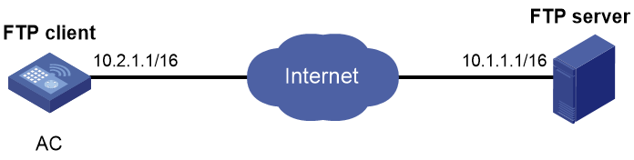

File Transfer Protocol (FTP) is an application layer protocol for transferring files from one host to another over an IP network. It uses TCP port 20 to transfer data and TCP port 21 to transfer control commands.
FTP is based on the client/server model. The device can act as the FTP server or FTP client.

Example: Using the device as an FTP client
As shown in Figure 1, the PC is acting as an FTP server. A user account with username abc and password hello12345 has been created on the PC.
·           Use the device as an FTP client to log in to the FTP server.
·           Download the temp.bin file from the PC to the device.
·           Upload configuration file startup.cfg from the device to the PC for backup.
Figure 1 Network diagram
# Configure IP addresses as shown in Figure 1. Make sure the AC and PC can reach each other. (Details not shown.)
# Examine the storage space of the AC. If the free space is insufficient, use the delete/unreserved file command to delete unused files. (Details not shown.)
# Log in to the FTP server at 10.1.1.1 using username abc and password hello12345.
