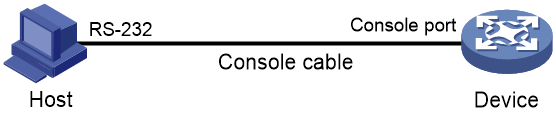

Using the console port for the first device access
Console login is the fundamental login method.
To log in through the console port, prepare a terminal, for example, a PC. Make sure the terminal has a terminal emulation program, such as HyperTerminal or PuTTY. For information about how to use terminal emulation programs, see the programs' user guides.
1.     Turn off the PC.
The serial ports on PCs do not support hot swapping. Before connecting a cable to or disconnecting a cable from a serial port on a PC, you must turn off the PC.
2.     Find the console cable shipped with the device and connect the DB-9 female connector of the console cable to the serial port of the PC.
3.     Identify the console port of the device carefully and connect the RJ-45 connector of the console cable to the console port.
IMPORTANT
IMPORTANT:
To connect a PC to an operating device, first connect the PC end. To disconnect a PC from an operating device, first disconnect the device end.
Figure 1 Connecting a terminal to the console port
4.     Turn on the PC.
5.     On the PC, launch the terminal emulation program, and create a connection that uses the serial port connected to the device. Set the port properties so the port properties match the following console port default settings:
¡     Bits per second—9600 bps.
¡     Flow control—None.
¡     Parity—None.
¡     Stop bits—1.
¡     Data bits—8.
6.     Power on the device and press Enter as prompted.
The user view prompt appears. You can enter commands to configure or manage the device. To get help, enter a question mark (?).

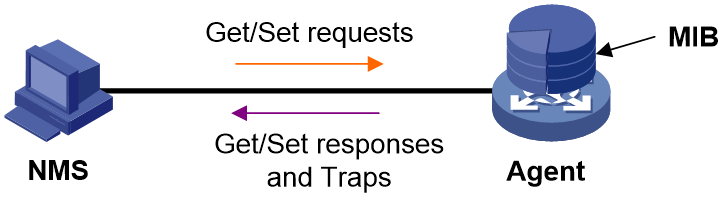

Configuring console login
About console login
You can connect a terminal to the console port of the device to log in and manage the device, as shown in Figure 2. For information about the login procedure, see "Using the console port for the first device access."
Figure 2 Logging in through the console port
By default, console login is enabled and does not require authentication. The default user role is network-admin for a console user. To improve device security, configure password or scheme authentication for console login immediately after you log in to the device for the first time.
A console login configuration change takes effect only on users who log in after the change is made. It does not affect users who are already online when the change is made.
In FIPS mode, the device supports only scheme authentication. You cannot disable authentication or configure password authentication.

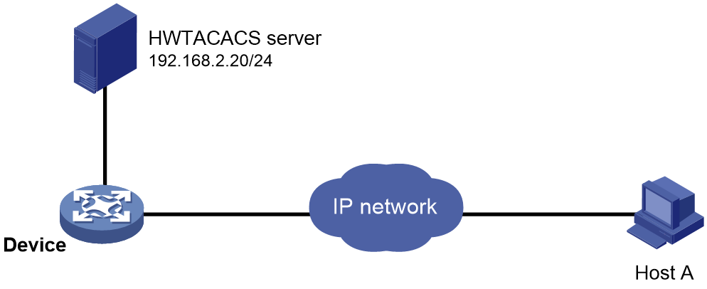

Using the device to log in to a Telnet server
You can use the device as a Telnet client to log in to a Telnet server.
Figure 3 Telnetting from the device to a Telnet server
Assign an IP address to the device and obtain the IP address of the Telnet server. If the device resides on a different subnet than the Telnet server, make sure the device and the Telnet server can reach each other.
2.     (Optional.) Specify the source IPv4 address or source interface for outgoing Telnet packets.
telnet client source { interface interface-type interface-number | ip ip-address }
By default, no source IPv4 address or source interface is specified. The device uses the primary IPv4 address of the output interface as the source address for outgoing Telnet packets.
3.     Return to user view.
4.     Use the device to log in to a Telnet server.
IPv4:
telnet remote-host [ service-port ] [ vpn-instance vpn-instance-name ] [ source { interface interface-type interface-number | ip ip-address } | dscp dscp-value ] *
IPv6:
telnet ipv6 remote-host [ -i interface-type interface-number ] [ port-number ] [ vpn-instance vpn-instance-name ] [ source { interface interface-type interface-number | ipv6 ipv6-address } | dscp dscp-value ] *

Accessing the device through SNMP
You can run SNMP on an NMS to access the device MIB and perform Get and Set operations to configure and manage the device.
Figure 5 SNMP access diagram
For more information about SNMP, see Network Management and Monitoring Configuration Guide.

Example: Controlling Telnet login
As shown in Figure 6, the device is a Telnet server.
Configure the device to permit only Telnet packets sourced from Host A and Host B.
Figure 6 Network diagram
# Configure an ACL to permit packets sourced from Host A and Host B.
<Sysname> system-view
[Sysname] acl basic 2000 match-order config
[Sysname-acl-ipv4-basic-2000] rule 1 permit source 10.110.100.52 0
[Sysname-acl-ipv4-basic-2000] rule 2 permit source 10.110.100.46 0
[Sysname-acl-ipv4-basic-2000] quit
# Apply the ACL to filter Telnet logins.
[Sysname] telnet server acl 2000

Example: Controlling SNMP access
As shown in Figure 7, the device is running SNMP.
Configure the device to allow Host A and Host B to access the device through SNMP.
Figure 7 Network diagram
Network diagram
# Create an ACL to permit packets sourced from Host A and Host B.
# Associate the ACL with the SNMP community and the SNMP group.
[Sysname] snmp-agent community read aaa acl 2000
[Sysname] snmp-agent group v2c groupa acl 2000
[Sysname] snmp-agent usm-user v2c usera groupa acl 2000

Example: Configuring command authorization
As shown in Figure 8, Host A needs to log in to the device to manage the device.
Configure the device to perform the following operations:
·     Allow Host A to Telnet in after authentication.
·     Use the HWTACACS server to control the commands that the user can execute.
·     If the HWTACACS server is not available, use local authorization.
Network diagram
Figure 8 Network diagram
# Assign IP addresses to relevant interfaces. Make sure the device and the HWTACACS server can reach each other. Make sure the device and Host A can reach each other. (Details not shown.)
# Enable the Telnet server.
<Device> system-view
[Device] telnet server enable
# Enable scheme authentication for user lines VTY 0 through VTY 63.
[Device] line vty 0 63
[Device-line-vty0-63] authentication-mode scheme
# Enable command authorization for the user lines.
[Device-line-vty0-63] command authorization
[Device-line-vty0-63] quit
# Create HWTACACS scheme tac.
[Device] hwtacacs scheme tac
# Configure the scheme to use the HWTACACS server at 192.168.2.20:49 for authentication and authorization.
[Device-hwtacacs-tac] primary authentication 192.168.2.20 49
[Device-hwtacacs-tac] primary authorization 192.168.2.20 49
# Set the shared keys to expert.
[Device-hwtacacs-tac] key authentication simple expert
[Device-hwtacacs-tac] key authorization simple expert
# Remove domain names from usernames sent to the HWTACACS server.
[Device-hwtacacs-tac] user-name-format without-domain
[Device-hwtacacs-tac] quit
# Configure the system-defined domain (system).
[Device] domain system
# Use HWTACACS scheme tac for login user authentication and command authorization. Use local authentication and local authorization as the backup method.
[Device-isp-system] authentication login hwtacacs-scheme tac local
[Device-isp-system] authorization command hwtacacs-scheme tac local
[Device-isp-system] quit
# Create local user monitor. Set the simple password to hello12345, the service type to Telnet, and the default user role to level-1.
[Device] local-user monitor
[Device-luser-manage-monitor] password simple hello12345
[Device-luser-manage-monitor] service-type telnet
[Device-luser-manage-monitor] authorization-attribute user-role level-1

As shown in Figure 9, users need to log in to the device to manage the device.
Configure the device to send commands executed by users to the HWTACACS server to monitor and control user operations on the device.
Figure 9 Network diagram
# Enable command accounting for user line console 0.
[Device] line console 0
[Device-line-console0] command accounting
[Device-line-console0] quit
# Enable command accounting for user lines VTY 0 through VTY 63.
[Device-line-vty0-63] command accounting
# Configure the scheme to use the HWTACACS server at 192.168.2.20:49 for accounting.
[Device-hwtacacs-tac] primary accounting 192.168.2.20 49
# Set the shared key to expert.
[Device-hwtacacs-tac] key accounting simple expert
# Configure the system-defined domain (system) to use the HWTACACS scheme for command accounting.
[Device-isp-system] accounting command hwtacacs-scheme tac
