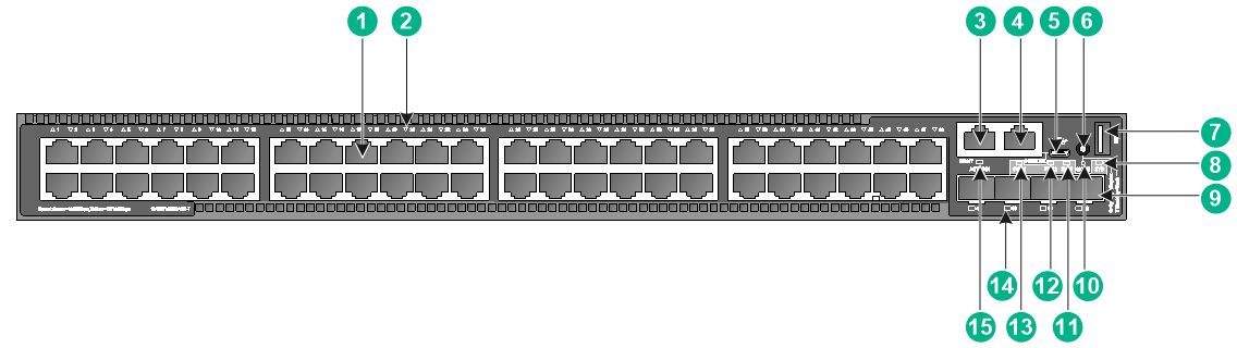

2 Chassis views

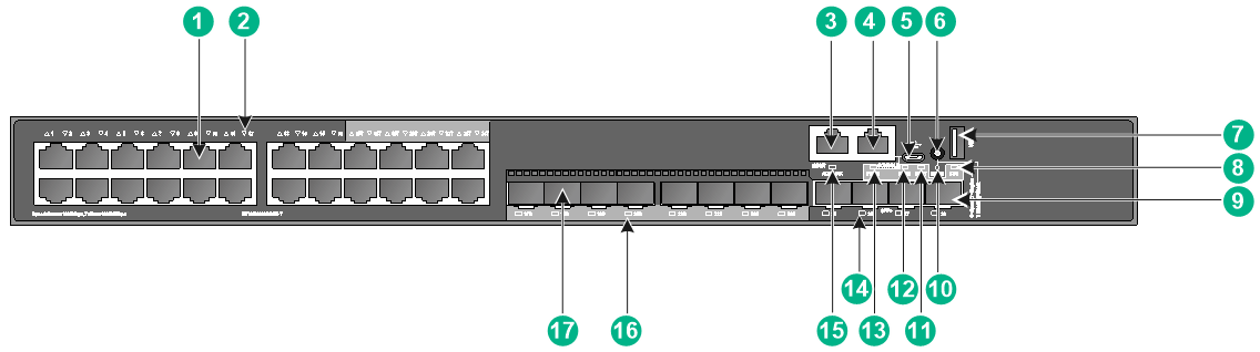

S5560X-30C-EI
Figure2-1 Front panel
(1) 10/100/1000BASE-T autosensing Ethernet port
(2) 10/100/1000BASE-T autosensing Ethernet port LED
(3) Management Ethernet port
(4) Console port (CONSOLE)
(5) Micro USB console port
(6) Mode button
(7) USB port
(8) System status LED (SYS)
(9) SFP+ port
(10) Mode LED (MODE)
(11) Expansion card status LED (SLOT)
(12) Power module 2 status LED (PWR2)
(13) Power module 1 status LED (PWR1)
(14) SFP+ port LED
(15) Management Ethernet port LED (ACT/LINK)
(16) SFP port LED
(17) SFP port

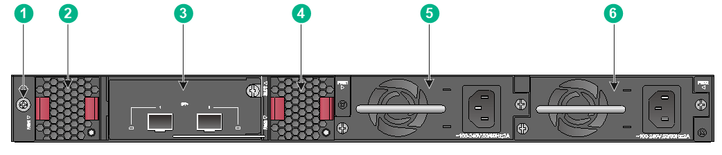

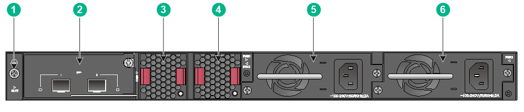

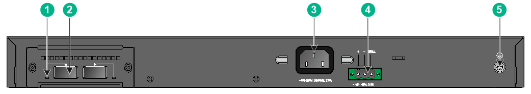

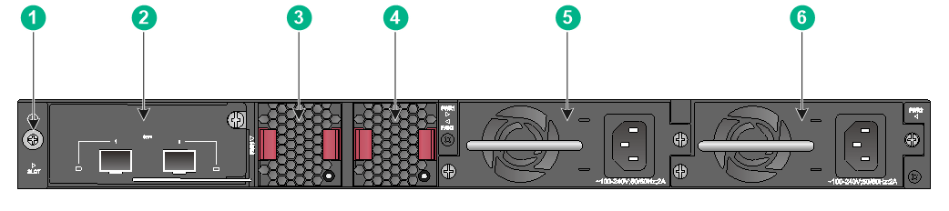

Figure2-2 Rear panel
(1) Grounding screw
(2) Fan tray 1
(3) Expansion card
(4) Fan tray 2
(5) Power module 1
(6) Power module 2
The S5560X-30C-EI switch comes with power module slot 1 empty and power module slot 2 installed with a filler panel. You can install one or two power modules for the switch as required. In this figure, two PSR150-A1 AC power modules are installed in the power module slots.
The S5560X-30C-EI switch comes with the two fan tray slots empty. You must install two fan trays of the same model for the switch. In this figure, two LSPM1FANSB fan trays are installed in the fan tray slots.
The S5560X-30C-EI switch comes with a filler panel in the expansion slot. You can select an expansion card for the switch as required. In this figure, an LSWM2SP2PM interface card is installed in the expansion slot.

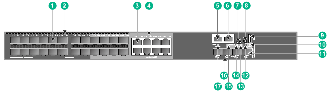

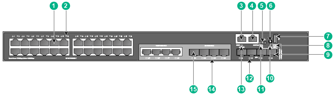

S5560X-30C-PWR-EI

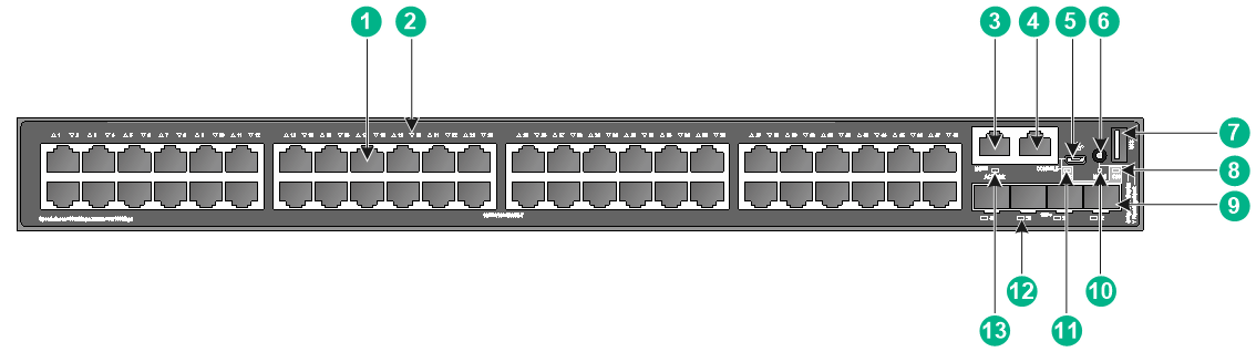

Figure2-3 Front panel
(6) Mode button
(7) USB port
(9) SFP+ port
(14) SFP+ port LED

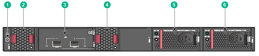

Figure2-4 Rear panel
(1) Grounding screw
(2) Fan tray 1
(3) Expansion card
(4) Fan tray 2
(5) Power module 1
(6) Power module 2
The S5560X-30C-PWR-EI switch comes with power module slot 1 empty and power module slot 2 installed with a filler panel. You can install one or two power modules for the switch as required. In this figure, two PSR720-56A AC power modules are installed in the power module slots.
The S5560X-30C-PWR-EI switch comes with the two fan tray slots empty. You must install two fan trays of the same model for the switch. In this figure, two LSPM1FANSB fan trays are installed in the fan tray slots.
The S5560X-30C-PWR-EI switch comes with a filler panel in the expansion slot. You can select an expansion card for the switch as required. In this figure, an LSWM2SP2PM interface card is installed in the expansion slot.

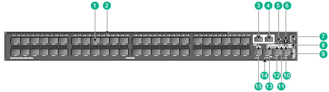

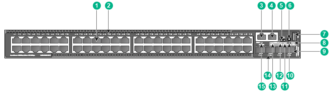

S5560X-54C-EI
Figure2-5 Front panel
(6) Mode button
(7) USB port
(9) SFP+ port
(14) SFP+ port LED

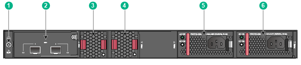

Figure2-6 Rear panel
(1) Grounding screw
(2) Expansion card
(3) Fan tray 1
(4) Fan tray 2
(5) Power module 1
(6) Power module 2
The S5560X-54C-EI switch comes with power module slot 1 empty and power module slot 2 installed with a filler panel. You can install one or two power modules for the switch as required. In this figure, two PSR150-A1 AC power modules are installed in the power module slots.
The S5560X-54C-EI switch comes with the two fan tray slots empty. You must install two fan trays of the same model for the switch. In this figure, two LSPM1FANSB fan trays are installed in the fan tray slots.
The S5560X-54C-EI switch comes with a filler panel in the expansion slot. You can select an expansion card for the switch as required. In this figure, an LSWM2SP2PM interface card is installed in the expansion slot.

Figure2-8 Rear panel
(1) Grounding screw
(2) Expansion card
(3) Fan tray 1
(4) Fan tray 2
(5) Power module 1
(6) Power module 2
The S5560X-54C-PWR-EI switch comes with power module slot 1 empty and power module slot 2 installed with a filler panel. You can install one or two power modules for the switch as required. In this figure, two PSR720-56A AC power modules are installed in the power module slots.
The S5560X-54C-PWR-EI switch comes with the two fan tray slots empty. You must install two fan trays of the same model for the switch. In this figure, two LSPM1FANSB fan trays are installed in the fan tray slots.
The S5560X-54C-PWR-EI switch comes with a filler panel in the expansion slot. You can select an expansion card for the switch as required. In this figure, an LSWM2SP2PM interface card is installed in the expansion slot.
S5560X-30F-EI
Figure2-9 Front panel
(1) SFP port
(2) SFP port LED
(3) 10/100/1000BASE-T autosensing Ethernet port
(4) 10/100/1000BASE-T autosensing Ethernet port LED
(5) Management Ethernet port
(6) Console port (CONSOLE)
(7) Micro USB console port
(8) Mode button
(9) USB port
(10) System status LED (SYS)
(11) SFP+ port
(12) Mode LED (MODE)
(13) Expansion card status LED (SLOT)
(14) Power module 2 status LED (PWR2)
(15) Power module 1 status LED (PWR1)
(16) SFP+ port LED
(17) Management Ethernet port LED (ACT/LINK)

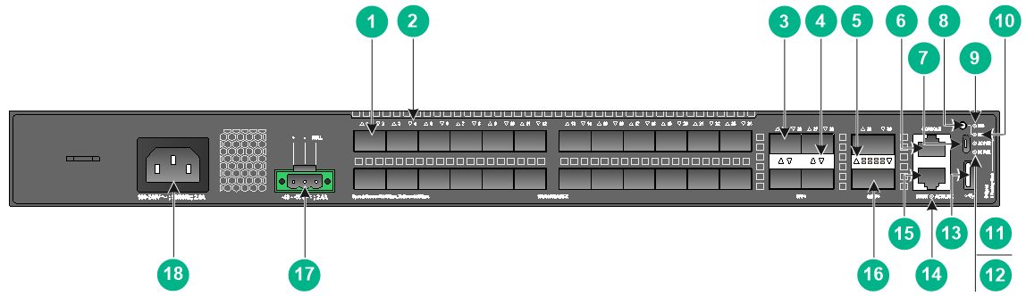

S5560X-30F-EIF
Figure2-11 Front panel
(1) SFP port
(2) SFP port LED
(3) SFP+ port
(4) SFP+ port LED
(5) QSFP+ port LED
(8) Mode button
(9) System status LED (SYS)
(11) AC power input status LED (AC PWR)
(12) DC power input status LED (DC PWR)
(13) USB port
(14) Management Ethernet port LED (ACT/LINK)
(16) QSFP+ port
(17) DC-input power receptacle
(18) AC-input power receptacle

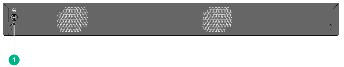

Figure2-12 Rear panel
(1) Grounding screw

Figure2-16 Rear panel
(1) QSFP+ port LED
(2) QSFP+ port
(3) AC power receptacle
(4) DC power receptacle
(5) Grounding screw

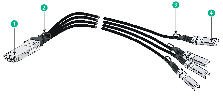

Table4-17 QSFP+ to SFP+ copper cables available for the QSFP+ ports
Max transmission distance
LSWM1QSTK3
1 m (3.28 ft)
LSWM1QSTK4
3 m (9.84 ft)
LSWM1QSTK5
5 m (16.40 ft)
Table4-18 QSFP+ fiber cables available for the QSFP+ ports
QSFP+ fiber cable
QSFP-40G-D-AOC-3M
3 m (9.84 ft)
QSFP-40G-D-AOC-7M
7 m (22.97 ft)
QSFP-40G-D-AOC-10M
10 m (32.81 ft)
QSFP-40G-D-AOC-20M
20 m (65.62 ft)

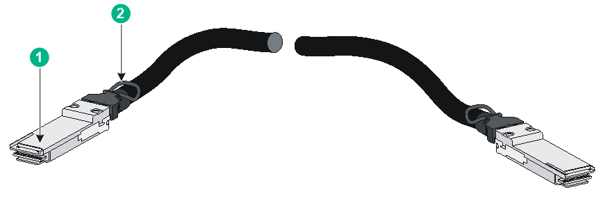

Figure4-3 40G QSFP+ cable
(1) Connector
(2) Pull tab
Figure4-4 40G QSFP+ to SFP+ cable
(1) QSFP+ module
(2) QSFP+ side pull tab
(3) SFP+ side pull tab
(4) SFP+ module

Input status LED and output status LED on the power module
The PSR360-56A, PSR560-56D, PSR720-56A, and PSR1110-56A power modules each have an input status LED and an output status LED. For more information about the LEDs, see the manuals for the power modules.
Fan tray status LED on the fan tray
The LSPM1FANSA and LSPM1FANSB fan trays each have a fan tray status LED. The fan tray status LED on the fan tray indicates the operating state of the fan tray.
Table4-30 Fan tray status LED description
LED mark
Status
Description
FAN
Steady yellow
The fan tray is operating correctly.
Flashing yellow (1 Hz)
The fan tray is faulty.
Off
The fan tray is not installed securely or has no power input.

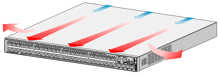

5 Cooling system
The switch uses a high-performance cooling system for fast heat dissipation and system stability. Consider the site ventilation design when you plan the installation site for the switch.
Some switch models use removable fan trays. You can choose fan tray models for these switches to provide airflow directions that match the heat dissipation requirements at the installation site. You must fully configure fan trays for these switches, and the fan trays on a switch must be the same model.
Table5-1 Cooling system
Device model
Fan tray type and model
Airflow direction
S5560X-30C-EI
S5560X-54C-EI
S5560X-30F-EI
S5560X-54F-EI
S5560X-30C-PWR-EI
S5560X-54C-PWR-EI
Removable fan tray LSPM1FANSA
From the power module side to the port side and side panels
(S5560X-54C-EI switch as an example)
Removable fan tray LSPM1FANSB
From the port side and side panels to the power module side
S5560X-30F-EIF
Fixed fan tray
From the port side to the grounding screw side
(S5560X-30F-EIF switch as an example)
S5560X-34S-EI
S5560X-54S-EI
Fixed fan tray
From the left side to the right side (face the port side of the device to identify the left and right sides)
(S5560X-34S-EI switch as an example)
