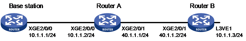

Example: Configuring a short static ARP entry
As shown in Figure 3, hosts are connected to Device B. Device B is connected to Device A through interface Ten-GigabitEthernet 2/0/1.
To ensure secure communications between Device A and Device B, configure a short static ARP entry for Device A on Device B.
Figure 3 Network diagram
# Configure an IP address for Ten-GigabitEthernet 2/0/1.
<DeviceB> system-view
[DeviceB] interface ten-gigabitethernet 2/0/1
[DeviceB-Ten-GigabitEthernet2/0/1] ip address 192.168.1.2 24
[DeviceB-Ten-GigabitEthernet2/0/1] quit
# Configure a short static ARP entry that has IP address 192.168.1.1 and MAC address 00e0-fc01-001f.
[DeviceB] arp static 192.168.1.1 00e0-fc01-001f
# Verify that Device B has a short static ARP entry for Device A
[DeviceB] display arp static
  Type: S-Static   D-Dynamic   O-Openflow   R-Rule   M-Multiport  I-Invalid
IP address      MAC address    VLAN/VSI name Interface                Aging Type
192.168.1.1     00e0-fc01-001f --            --                       --    S

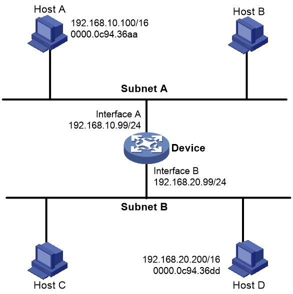

Example: Configuring common proxy ARP
As shown in Figure 5, Host A and Host D have the same prefix and mask, but they are located on different subnets. No default gateway is configured on Host A and Host D.
Configure common proxy ARP on the router to ensure communication between Host A and Host D.
Figure 5 Network diagram
# Configure the IP address of Ten-GigabitEthernet 2/0/1.
<Router> system-view
[Router] interface ten-gigabitethernet 2/0/1
[Router-Ten-GigabitEthernet2/0/1] ip address 192.168.10.99 255.255.255.0
# Enable common proxy ARP on Ten-GigabitEthernet 2/0/1.
[Router-Ten-GigabitEthernet2/0/1] proxy-arp enable
[Router-Ten-GigabitEthernet2/0/1] quit
# Configure the IP address of Ten-GigabitEthernet 2/0/0.
[Router] interface ten-gigabitethernet 2/0/0
[Router-Ten-GigabitEthernet2/0/0] ip address 192.168.20.99 255.255.255.0
# Enable common proxy ARP on Ten-GigabitEthernet 2/0/0.
[Router-Ten-GigabitEthernet2/0/0] proxy-arp enable
[Router-Ten-GigabitEthernet2/0/0] quit
# Verify that Host A and Host D can ping each other.

As shown in Figure 7, the base station, Router A, and Router B are in an MPLS L2VPN.
Enable ARP suppression on Router A to directly reply to ARP requests for Router B.
Figure 7 Network diagram
1.     Configure IP addresses for the interfaces, and make sure the base station can reach the L3VE interface VE-L3VPN 1 of Router B. (Details not shown.)
2.     Configure ARP suppression on Router A:
# Create a cross-connect group named vpna and create a cross-connect named svc in the group.
<RouterA> system-view
[RouterA] xconnect-group vpna
[RouterA-xcg-vpna] connection svc
# Enable ARP suppression for cross-connect svc in cross-connect group vpna.
[RouterA-xcg-vpna-svc] arp suppression enable
1.     On the base station, clear ARP entries, and ping the L3VE interface VE-L3VPN 1 of Router B. (Details not shown.)
2.     Verify that Router A has ARP suppression entries for the base station and Router B.
[RouterA-xcg-vpna-svc] display arp suppression xconnect-group
IP address      MAC address     Xconnect-group       Connection           Aging
10.1.1.1        00e0-fc04-582c  vpna                 svc                  25
10.1.1.3        0023-89b7-0861  vpna                 svc                  25
3.     Enable ARP debugging on Router B to verify that Router B does not receive an ARP request from the base station under the following conditions (details not shown):
a.     Clear ARP entries on the base station.
b.     Ping the L3VE interface VE-L3VPN 1 of Router B from the base station.
1.     Configure IP addresses for the interfaces, and make sure the base station can reach the L3VE interface VE-L3VPN 1 of Switch B. (Details not shown.)
2.     Configure ARP suppression on Switch A:
<SwitchA> system-view
[SwitchA] xconnect-group vpna
[SwitchA-xcg-vpna] connection svc
[SwitchA-xcg-vpna-svc] arp suppression enable
1.     On the base station, clear ARP entries, and ping the L3VE interface VE-L3VPN 1 of Switch B. (Details not shown.)
2.     Verify that Switch A has ARP suppression entries for the base station and Switch B.
[SwitchA-xcg-vpna-svc] display arp suppression xconnect-group
3.     Enable ARP debugging on Switch B to verify that Switch B does not receive an ARP request from the base station under the following conditions (details not shown):
b.     Ping the L3VE interface VE-L3VPN 1 of Switch B from the base station.

The ARP direct route advertisement feature advertises host routes instead of advertising the network route.
Application in Layer 3 access networks
As shown in Figure 8, ARP direct route advertisement is enabled on Interface A and Interface B. This feature generates a host route to Server A and a host route to Server B for the routing protocols to advertise. So each device forwards only the traffic destined to the server within the network, which saves bandwidth.
Figure 8 Application in a Layer 3 access network
If you enable ARP direct route advertisement on the public network or in a VPN instance, all interfaces on the public network or in the VPN instance are enabled with ARP direct route advertisement.
