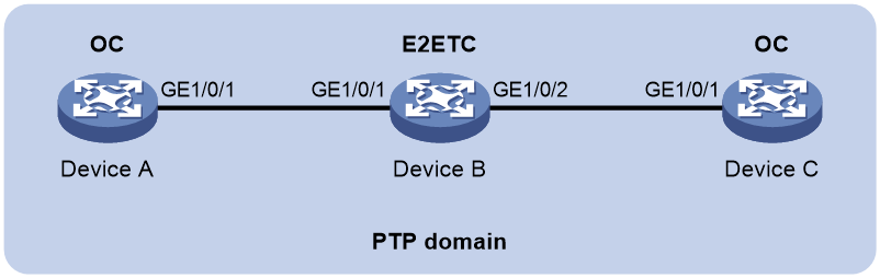

Example: Configuring Layer 2 IEEE 1588v2 PTP
As shown in Figure 1, a PTP domain contains Device A, Device B, and Device C. Configure Layer 2 IEEE 1588v2 PTP as follows for time synchronization:
·     Specify the IEEE 1588v2 PTP profile for the devices.
·     Specify the OC clock node type for Device A and Device C, and E2ETC clock node type for Device B. These clock nodes elect a GM through BMC based on their respective default GM attributes.

Procedures
Configuring Device A
# Specify the IEEE 1588v2 PTP profile.
<DeviceA> system-view
[DeviceA] ptp profile 1588v2
# Specify the OC clock node type.
[DeviceA] ptp mode oc
# Specify a PTP domain.
[DeviceA] ptp domain 0
# Enable PTP globally.
[DeviceA] ptp global enable
# Specify PTP for obtaining the time.
[DeviceA] clock protocol ptp
# Enable PTP on GigabitEthernet 1/0/1.
[DeviceA-GigabitEthernet1/0/1] ptp enable
[DeviceA-GigabitEthernet1/0/1] quit
Configuring Device B
<DeviceB> system-view
[DeviceB] ptp profile 1588v2
# Specify the E2ETC clock node type.
[DeviceB] ptp mode e2etc
[DeviceB] ptp domain 0
[DeviceB] ptp global enable
[DeviceB] clock protocol ptp
[DeviceB-GigabitEthernet1/0/1] ptp enable
[DeviceB-GigabitEthernet1/0/1] quit
# Enable PTP on GigabitEthernet 1/0/2.
[DeviceB] interface gigabitethernet 1/0/2
[DeviceB-GigabitEthernet1/0/2] ptp enable
[DeviceB-GigabitEthernet1/0/2] quit
Configuring Device C
<DeviceC> system-view
[DeviceC] ptp profile 1588v2
[DeviceC] ptp mode oc
[DeviceC] ptp domain 0
[DeviceC] ptp global enable
[DeviceC] clock protocol ptp
[DeviceC] interface gigabitethernet 1/0/1
[DeviceC-GigabitEthernet1/0/1] ptp enable
[DeviceC-GigabitEthernet1/0/1] quit
When the network topology is stable, perform the following tasks to verify the PTP configuration:
·     Use the display ptp clock command to display PTP clock information.
·     Use the display ptp interface brief command to display brief information about PTP interfaces.
# Display PTP clock information on Device A.
[DeviceA] display ptp clock
PTP profile         : IEEE 1588 Version 2
PTP mode            : OC
Slave only          : No
Clock ID            : 000FE2-FFFE-FF0000
Clock type          : Local
Clock domain        : 0
Number of PTP ports : 1
Priority1     : 128
Priority2     : 128
Clock quality :
 Class                 : 248
 Accuracy              : 254
 Offset (log variance) : 65535
Offset from master : 0 (ns)
Mean path delay    : 0 (ns)
Steps removed      : 0
Local clock time   : Sun Jan 15 20:57:29 2011
# Display brief information about PTP interfaces on Device A.
[DeviceA] display ptp interface brief
Name         State         Delay mechanism  Clock step  Asymmetry correction
GE1/0/1      Master        E2E              Two         0
# Display PTP clock information on Device B.
[DeviceB] display ptp clock
PTP mode            : E2ETC
Slave only          : No
Clock ID            : 000FE2-FFFE-FF0001
Clock type          : Local
Clock domain        : 0
Number of PTP ports : 2
Priority1     : 128
Priority2     : 128
Clock quality :
 Class                 : 248
 Accuracy              : 254
Offset from master : N/A
Mean path delay    : N/A
Steps removed      : N/A
# Display brief information about PTP interfaces on Device B.
[DeviceB] display ptp interface brief
GE1/0/1      N/A           E2E              Two         0
GE1/0/2      N/A           E2E              Two         0
# Display PTP clock information on Device C.
[DeviceC] display ptp clock
PTP mode            : OC
Slave only          : No
Clock ID            : 000FE2-FFFE-FF0002
Clock type          : Local
Clock domain        : 0
Priority1     : 128
Priority2     : 128
Clock quality :
 Class                 : 248
 Accuracy              : 254
Steps removed      : 0
Local clock time   : Sun Jan 15 20:57:29 2019
# Display brief information about PTP interfaces on Device C.
[DeviceC] display ptp interface brief
GE1/0/1      Slave           E2E              Two         0
The command outputs show that Device A is elected as the GM and GigabitEthernet1/0/1 on Device A is the master port.

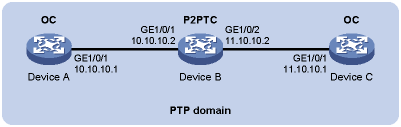

Example: Configuring Layer 3 IEEE 1588v2 PTP in multicast mode
As shown in Figure 2, a PTP domain contains Device A, Device B, and Device C. Configure Layer 3 IEEE 1588v2 PTP in multicast mode as follows for time synchronization:
·     Specify the OC clock node type for Device A and Device C, and the P2PTC clock node type for Device B. These clock nodes elect a GM through BMC based on their respective default GM attributes.
·     Configure the multicast PTP transport mode and UDP (IPv4) transport protocol for the devices.
·     Configure the peer delay measurement mechanism (p2p) for Device A and Device C.

Procedures
# Configure the source IP address for multicast PTP transport.
[DeviceA] ptp source 10.10.10.1
# On GigabitEthernet 1/0/1, specify the UDP (IPv4) transport protocol and the peer delay measurement mechanism (p2p) and enable PTP.
[DeviceA-GigabitEthernet1/0/1] ptp transport-protocol udp [DeviceA-GigabitEthernet1/0/1] ptp delay-mechanism p2p
# Specify the P2PTC clock node type.
[DeviceB] ptp mode p2ptc
[DeviceB] ptp source 10.10.10.2
# On GigabitEthernet 1/0/1, specify the UDP (IPv4) transport protocol and enable PTP.
DeviceB-GigabitEthernet1/0/1] ptp transport-protocol udp
# On GigabitEthernet 1/0/2, specify the UDP transport protocol and enable PTP.
[DeviceB-GigabitEthernet1/0/2] ptp transport-protocol udp
[DeviceC] ptp source 11.10.10.1
[DeviceC-GigabitEthernet1/0/1] ptp transport-protocol udp [DeviceC-GigabitEthernet1/0/1] ptp delay-mechanism p2p

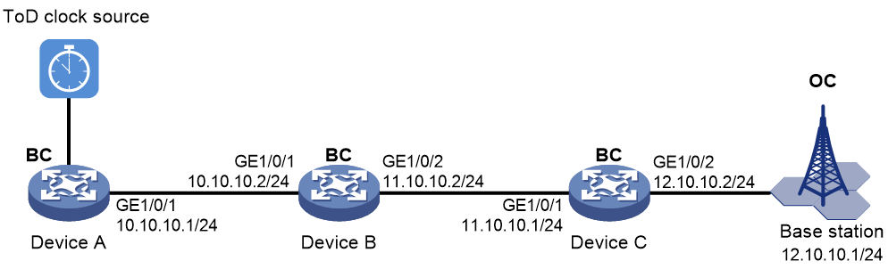

Example: Configuring Layer 3 IEEE 1588v2 PTP in unicast mode
As shown in Figure 3, configure PTP (IEEE 1588 version 2, IPv4 UDP transport, and unicast transmission) to enable Device A, Device B, Device C, and the base station to synchronize the time with the ToD clock source.
·     Specify the IEEE 1588 version 2 PTP profile and unicast IPv4 UDP transport of PTP messages for Device A, Device B, and Device C.
·     Assign Device A, Device B, Device C, and the base station to PTP domain 0. Specify the BC clock node type for Device A, Device B, and Device C.
·     Connect Device A to the ToD clock source and Device C to the base station.
·     Use the default Request_Response delay measurement mechanism on all clock nodes in the PTP domain.
Figure 3 Network diagram

As shown in Figure 3, assign IP addresses to the interfaces and make sure the devices can reach each other. (Details not shown.)
Procedures

Example: Configuring IEEE 802.1AS PTP
As shown in Figure 4, a PTP domain contains Device A, Device B, and Device C. Configure IEEE 802.1AS PTP as follows for time synchronization:
·     Specify the IEEE 802.1AS PTP profile for the devices.
Figure 4 Network diagram

Procedures
# Specify the IEEE 802.1AS PTP profile.
[DeviceA] ptp profile 802.1AS
[DeviceB] ptp profile 802.1AS
# Specify the IEEE 1588 802.1AS PTP profile.
[DeviceC] ptp profile 802.1AS
PTP profile         : IEEE 802.1AS
PTP mode            : OC
Slave only          : No
Clock type          : Local
Clock domain        : 0
Priority1     : 246
Priority2     : 248
Clock quality :
 Class                 : 248
 Accuracy              : 254
 Offset (log variance) : 16640
Steps removed      : 0
GE1/0/1      Master        P2P              Two         0
PTP mode            : P2PTC
Slave only          : No
Clock type          : Local
Clock domain        : 0
Priority1     : 246
Priority2     : 248
Clock quality :
 Class                 : 248
 Accuracy              : 254
Steps removed      : N/A
GE1/0/1      N/A           P2P              Two         0
GE1/0/2      N/A           P2P              Two         0
PTP mode            : OC
Slave only          : No
Clock type          : Local
Clock domain        : 0
Priority1     : 128
Priority2     : 128
Clock quality :
 Class                 : 248
 Accuracy              : 254
Steps removed      : 0
GE1/0/1      Slave           P2P              Two         0
Configuration files
·     Device A and Device C:
 clock protocol ptp
 ptp profile 8021as
 ptp mode oc
 ptp domain 0
 ptp global enable
interface GigabitEthernet 1/0/1
 ptp enable
·     Device B:
 clock protocol ptp
 ptp profile 8021as
 ptp mode p2ptc
 ptp domain 0
 ptp global enable
 ptp enable
interface GigabitEthernet 1/0/2
 ptp enable

Example: Configuring SMPTE ST 2059-2 PTP in unicast mode
As shown in Figure 6, configure PTP (SMPTE ST 2059-2, IPv4 UDP transport, unicast transmission) to enable Device A, Device B, Device C, and the base station to synchronize time with the ToD clock source .
·     Specify the SMPTE ST 2059-2 PTP profile and unicast IPv4 UDP transport of PTP messages for Device A, Device B, and Device C.
Figure 6 Network diagram

As shown in Figure 6, assign IP addresses to the interfaces, and make sure the devices can reach each other. (Details not shown.)
