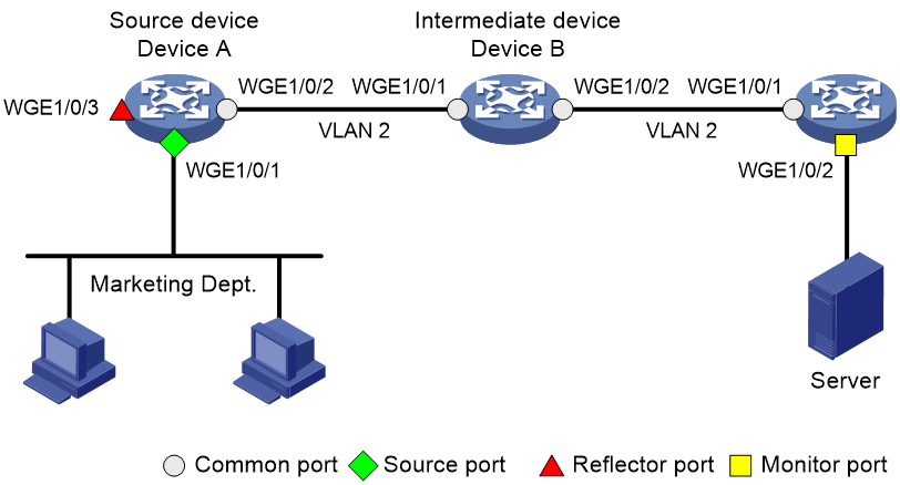

Layer 2 remote port mirroring can be implemented through the reflector port method or the egress port method.
Reflector port method
In Layer 2 remote port mirroring that uses the reflector port method, packets are mirrored as follows:
1. The source device copies packets received on the mirroring sources to the reflector port.
2. The reflector port broadcasts the mirrored packets in the remote probe VLAN.
3. The intermediate devices transmit the mirrored packets to the destination device through the remote probe VLAN.
4. Upon receiving the mirrored packets, the destination device determines whether the ID of the mirrored packets is the same as the remote probe VLAN ID. If the two VLAN IDs match, the destination device forwards the mirrored packets to the data monitoring device through the monitor port.
Figure 2 Layer 2 remote port mirroring implementation through the reflector port method

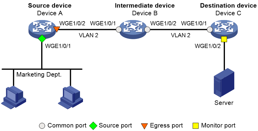

Egress port method
In Layer 2 remote port mirroring that uses the egress port method, packets are mirrored as follows:
1. The source device copies packets received on the mirroring sources to the egress port.
2. The egress port forwards the mirrored packets to the intermediate devices.
3. The intermediate devices flood the mirrored packets in the remote probe VLAN and transmit the mirrored packets to the destination device.
Figure 3 Layer 2 remote port mirroring implementation through the egress port method

Example: Configuring Layer 2 remote port mirroring (RSPAN with reflector port)
As shown in Figure 6, configure Layer 2 remote port mirroring to enable the server to monitor the bidirectional traffic of the Marketing Department.
1. Configure Device C (the destination device):
# Configure Twenty-FiveGigE 1/0/1 as a trunk port, and assign the port to VLAN 2.
<DeviceC> system-view
[DeviceC] interface twenty-fivegige 1/0/1
[DeviceC-Twenty-FiveGigE1/0/1] port link-type trunk
[DeviceC-Twenty-FiveGigE1/0/1] port trunk permit vlan 2
[DeviceC-Twenty-FiveGigE1/0/1] quit
# Create a remote destination group.
[DeviceC] mirroring-group 2 remote-destination
# Create VLAN 2.
[DeviceC] vlan 2
# Disable MAC address learning for VLAN 2.
[DeviceC-vlan2] undo mac-address mac-learning enable
[DeviceC-vlan2] quit
# Configure VLAN 2 as the remote probe VLAN for the mirroring group.
[DeviceC] mirroring-group 2 remote-probe vlan 2
# Configure Twenty-FiveGigE 1/0/2 as the monitor port for the mirroring group.
[DeviceC] interface twenty-fivegige 1/0/2
[DeviceC-Twenty-FiveGigE1/0/2] mirroring-group 2 monitor-port
# Disable the spanning tree feature on Twenty-FiveGigE 1/0/2.
[DeviceC-Twenty-FiveGigE1/0/2] undo stp enable
# Assign Twenty-FiveGigE 1/0/2 to VLAN 2.
[DeviceC-Twenty-FiveGigE1/0/2] port access vlan 2
[DeviceC-Twenty-FiveGigE1/0/2] quit
2. Configure Device B (the intermediate device):
# Create VLAN 2.
<DeviceB> system-view
[DeviceB] vlan 2
[DeviceB-vlan2] undo mac-address mac-learning enable
[DeviceB-vlan2] quit
[DeviceB] interface twenty-fivegige 1/0/1
[DeviceB-Twenty-FiveGigE1/0/1] port link-type trunk
[DeviceB-Twenty-FiveGigE1/0/1] port trunk permit vlan 2
[DeviceB-Twenty-FiveGigE1/0/1] quit
# Configure Twenty-FiveGigE 1/0/2 as a trunk port, and assign the port to VLAN 2.
[DeviceB] interface twenty-fivegige 1/0/2
[DeviceB-Twenty-FiveGigE1/0/2] port link-type trunk
[DeviceB-Twenty-FiveGigE1/0/2] port trunk permit vlan 2
[DeviceB-Twenty-FiveGigE1/0/2] quit
3. Configure Device A (the source device):
# Create a remote source group.
<DeviceA> system-view
[DeviceA] mirroring-group 1 remote-source
# Create VLAN 2.
[DeviceA] vlan 2
[DeviceA-vlan2] undo mac-address mac-learning enable
[DeviceA-vlan2] quit
[DeviceA] mirroring-group 1 remote-probe vlan 2
# Configure Twenty-FiveGigE 1/0/1 as a source port for the mirroring group.
[DeviceA] mirroring-group 1 mirroring-port twenty-fivegige 1/0/1 both
# Configure Twenty-FiveGigE 1/0/3 as the reflector port for the mirroring group.
[DeviceA] mirroring-group 1 reflector-port twenty-fivegige 1/0/3
This operation may delete all settings made on the interface. Continue? [Y/N]: y
[DeviceA] interface twenty-fivegige 1/0/2
[DeviceA-Twenty-FiveGigE1/0/2] port link-type trunk
[DeviceA-Twenty-FiveGigE1/0/2] port trunk permit vlan 2
[DeviceA-Twenty-FiveGigE1/0/2] quit
# Verify the mirroring group configuration on Device C.
[DeviceC] display mirroring-group all
Mirroring group 2:
Type: Remote destination
Status: Active
Monitor port: Twenty-FiveGigE1/0/2
Remote probe VLAN: 2
# Verify the mirroring group configuration on Device A.
[DeviceA] display mirroring-group all
Mirroring group 1:
Type: Remote source
Status: Active
Mirroring port:
Twenty-FiveGigE1/0/1 Both
Reflector port: Twenty-FiveGigE1/0/3
Example: Configuring Layer 2 remote port mirroring (RSPAN with egress port)
On the Layer 2 network shown in Figure 7, configure Layer 2 remote port mirroring to enable the server to monitor the bidirectional traffic of the Marketing Department.
# Create VLAN 2.
[DeviceC] vlan 2
# Assign Twenty-FiveGigE 1/0/2 to VLAN 2 as an access port.
# Create VLAN 2.
[DeviceB] vlan 2
# Create VLAN 2.
[DeviceA] vlan 2
# Configure VLAN 2 as the remote probe VLAN of the mirroring group.
# Configure Twenty-FiveGigE 1/0/2 as the egress port for the mirroring group.
[DeviceA] mirroring-group 1 monitor-egress twenty-fivegige 1/0/2
# Disable the spanning tree feature on the port.
[DeviceA-Twenty-FiveGigE1/0/2] undo stp enable
Mirroring group 2:
Status: Active
Mirroring group 1:
Type: Remote source
Status: Active
Mirroring port:
Monitor egress port: Twenty-FiveGigE1/0/2

As shown in Figure 9, configure flow mirroring so that the server can monitor the following traffic:
· All traffic that the Technical Department sends to access the Internet.
· IP traffic that the Technical Department sends to the Marketing Department during working hours (8:00 to 18:00) on weekdays.
# Create working hour range work, in which working hours are from 8:00 to 18:00 on weekdays.
<Device> system-view
[Device] time-range work 8:00 to 18:00 working-day
# Create IPv4 advanced ACL 3000 to allow packets from the Technical Department to access the Internet and the Marketing Department during working hours.
[Device] acl advanced 3000
[Device-acl-ipv4-adv-3000] rule permit tcp source 192.168.2.0 0.0.0.255 destination-port eq www
[Device-acl-ipv4-adv-3000] rule permit ip source 192.168.2.0 0.0.0.255 destination 192.168.1.0 0.0.0.255 time-range work
[Device-acl-ipv4-adv-3000] quit
# Create traffic class tech_c, and configure the match criterion as ACL 3000.
[Device] traffic classifier tech_c
[Device-classifier-tech_c] if-match acl 3000
[Device-classifier-tech_c] quit
# Create traffic behavior tech_b, configure the action of mirroring traffic to Twenty-FiveGigE 1/0/3.
[Device] traffic behavior tech_b
[Device-behavior-tech_b] mirror-to interface twenty-fivegige 1/0/3
[Device-behavior-tech_b] quit
# Create QoS policy tech_p, and associate traffic class tech_c with traffic behavior tech_b in the QoS policy.
[Device] qos policy tech_p
[Device-qospolicy-tech_p] classifier tech_c behavior tech_b
[Device-qospolicy-tech_p] quit
# Apply QoS policy tech_p to the incoming packets of Twenty-FiveGigE 1/0/4.
[Device] interface twenty-fivegige 1/0/4
[Device-Twenty-FiveGigE1/0/4] qos apply policy tech_p inbound
[Device-Twenty-FiveGigE1/0/4] quit
# Verify that the server can monitor the following traffic:
· All traffic sent by the Technical Department to access the Internet.
· IP traffic that the Technical Department sends to the Marketing Department during working hours on weekdays.
(Details not shown.)
