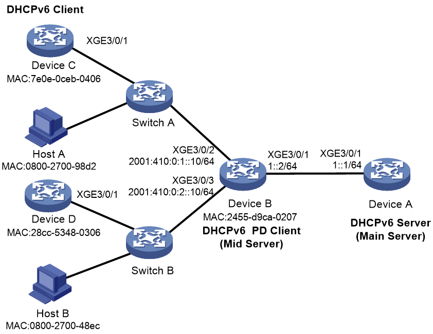

As shown in Figure 1, Host A and Device C obtain IPv6 prefixes from the DHCPv6 prefix delegation (PD) client and generate IPv6 global unicast addresses through stateless address autoconfiguration. Host B and Device D use the stateful address autoconfiguration method to obtain IPv6 global unicast addresses from the IPv6 address pool on the DHCPv6 PD client.
Configure the network as follows:
·     Configure Device A as the DHCPv6 server. Assign IPv6 address 1::1/64 to Ten-GigabitEthernet 3/0/1. Create an IPv6 address pool and apply a prefix pool that contains prefix 2001:0410::/32 to that address pool. The IPv6 address pool can then assign prefixes to the DHCPv6 PD client.
·     Configure Device B as the DHCPv6 PD client. Enable the DHCPv6 PD client to perform the following tasks: Obtain prefix 2001:410::/48 from the DHCPv6 server. The prefix ID of that prefix is 11. Automatically generate an IPv6 address for Ten-GigabitEthernet 3/0/2 and advertise the obtained prefix to endpoints.
·     Configure Device C to obtain an IPv6 prefix from the DHCPv6 PD client through the IPv6 ND protocol and generate an IPv6 address for Ten-GigabitEthernet 3/0/1 through stateless address autoconfiguration.
·     Configure Host A to obtain an IPv6 prefix from the DHCPv6 PD client through the IPv6 ND protocol and automatically generate an IPv6 address.
·     Create an IPv6 address pool on Device B by using the prefix associated with prefix ID 11. This IPv6 address pool is used for IPv6 address assignment to Host B and Ten-GigabitEthernet 3/0/1 of Device D.
Figure 1 Network diagram

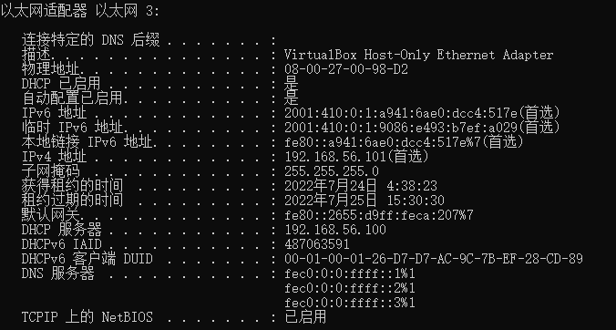

Configuring DHCPv6 clients
Configuring stateless address autoconfiguration
# Configure Device C and Host A.
1.     Enable the stateless address autoconfiguration feature on Ten-GigabitEthernet 3/0/1 of Device C, so the interface can automatically generate a global unicast address.

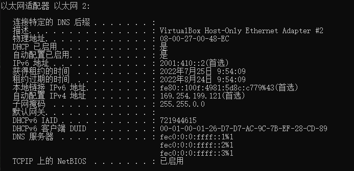

2.     Enable Host A to automatically obtain an IPv6 address. In this example, the operating system is Windows 10.
a.     Click Network in the desktop, and then open Network and Internet.
b.     Open the Network and Sharing Center window, and then select the network (Ethernet xxx) on which the host resides.
c.     Click Properties.
d.     Select Internet Protocol Version 6 (TCP/IPv6), click Properties, select Obtain an IPv6 address automatically in the pop-up window, and then click OK.
Configuring stateful address autoconfiguration
# Configure Device D and Host B.
1.     Configure Ten-GigabitEthernet 3/0/1 as a DHCPv6 client to obtain an IPv6 prefix and other network settings, and enable support for rapid address/prefix assignment on that DHCPv6 client.
<DeviceD> system-view
[DeviceD] interface ten-gigabitethernet 3/0/1
[DeviceD-Ten-GigabitEthernet3/0/1] ipv6 address dhcp-alloc rapid-commit
[DeviceD-Ten-GigabitEthernet3/0/1] quit
2.     Enable Host B to automatically obtain an IPv6 address.
The configuration procedure is similar as that of Host A.

# View the IPv6 global unicast addresses obtained by Host A on the related PC.
C:\Users\UserAccount>ipconfig /all

# View the IPv6 global unicast addresses obtained by Host B on the related PC.
