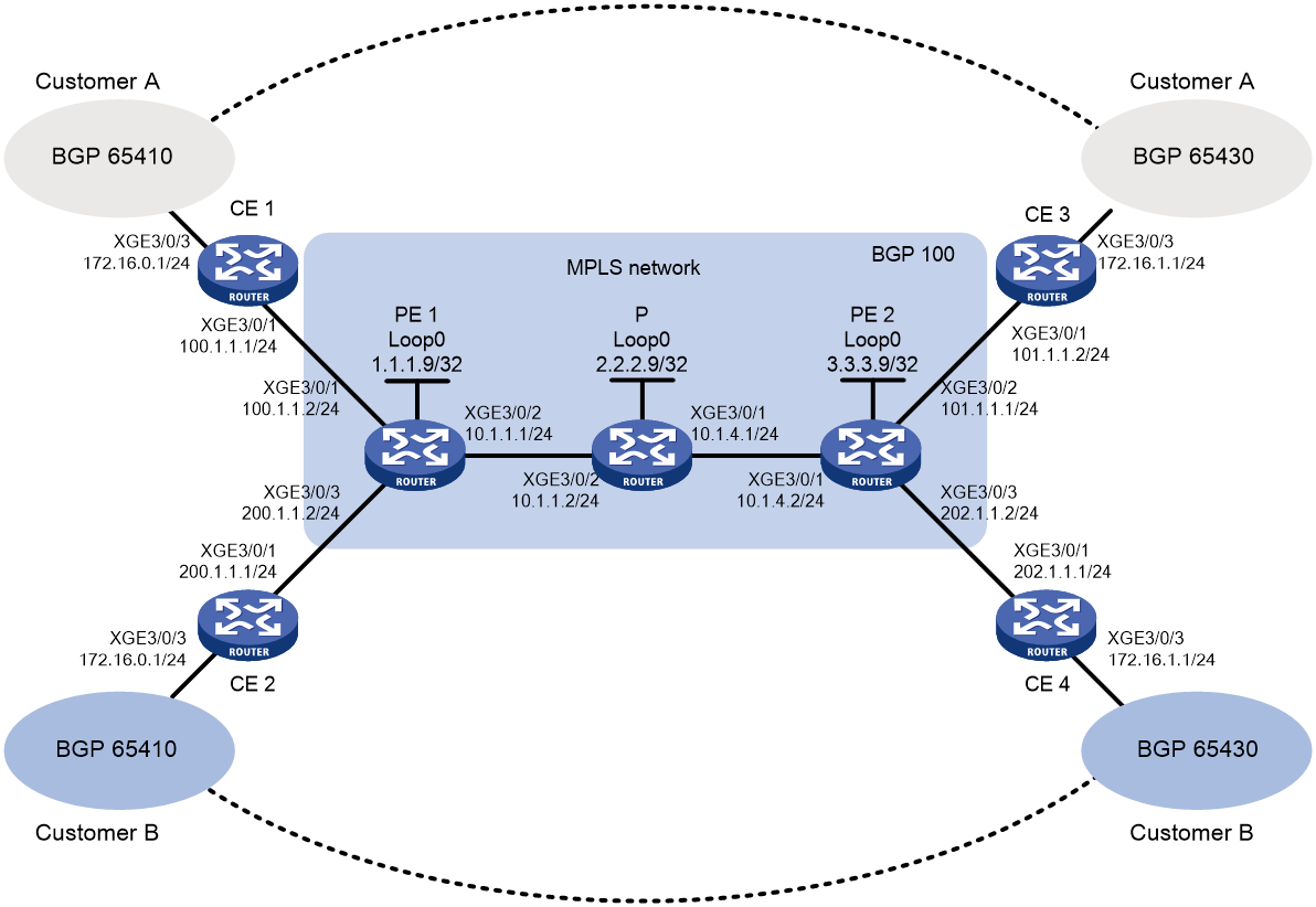

As shown in Figure 1, configure MPLS L3VPN to allow communication between different sites of a customer and to isolate different customers.
Figure 1 Network diagram

1.     Configure OSPF on the MPLS backbone to ensure IP connectivity within the backbone:
# On PE 1, configure IP addresses for the loopback interface and the core-facing interface.

# On PE 2, configure IP addresses for the loopback interface and the core-facing interface.

round-trip min/avg/max/std-dev = 0.000/0.800/2.000/0.748 ms
4.     Establish EBGP peer relationships between PEs and CEs, and redistribute VPN routes into BGP:
# On PE 1, create BGP process 100.
[PE1] bgp 100
# On PE 1, specify CE 1 as a peer and redistribute direct routes of CE 1 into the BGP routing table of VPN instance customerA.
[PE1-bgp-default] ip vpn-instance customerA
[PE1-bgp-default-customerA] peer 100.1.1.1 as-number 65410
[PE1-bgp-default-customerA] address-family ipv4 unicast
[PE1-bgp-default-ipv4-customerA] peer 100.1.1.1 enable
[PE1-bgp-default-ipv4-customerA] import-route direct
[PE1-bgp-default-ipv4-customerA] quit
[PE1-bgp-default-customerA] quit
# On PE 1, specify CE 2 as a peer and redistribute direct routes of CE 2 into the BGP routing table of VPN instance customerB.
[PE1-bgp-default] ip vpn-instance customerB
[PE1-bgp-default-customerB] peer 200.1.1.1 as-number 65410
[PE1-bgp-default-customerB] address-family ipv4 unicast
[PE1-bgp-default-ipv4-customerB] peer 200.1.1.1 enable
[PE1-bgp-default-ipv4-customerB] import-route direct
[PE1-bgp-default-ipv4-customerB] quit
[PE1-bgp-default-customerB] quit
[PE1-bgp-default] quit
# On PE 2, create BGP process 100.
[PE2] bgp 100
# On PE 2, specify CE 3 as a peer and redistribute direct routes of CE 3 into the BGP routing table of VPN instance customerA.
[PE2-bgp-default] ip vpn-instance customerA
[PE2-bgp-default-customerA] peer 101.1.1.2 as-number 65430
[PE2-bgp-default-customerA] address-family ipv4 unicast
[PE2-bgp-default-ipv4-customerA] peer 101.1.1.2 enable
[PE2-bgp-default-ipv4-customerA] import-route direct
[PE2-bgp-default-ipv4-customerA] quit
[PE2-bgp-default-customerA] quit
# On PE 2, specify CE 4 as a peer and redistribute direct routes of CE 4 into the BGP routing table of VPN instance customerB.
[PE2-bgp-default] ip vpn-instance customerB
[PE2-bgp-default-customerB] peer 202.1.1.1 as-number 65430
[PE2-bgp-default-customerB] address-family ipv4 unicast
[PE2-bgp-default-ipv4-customerB] peer 202.1.1.1 enable
[PE2-bgp-default-ipv4-customerB] import-route direct
[PE2-bgp-default-ipv4-customerB] quit
[PE2-bgp-default-customerB] quit
[PE2-bgp-default] quit
# On CE 1, create BGP process 65410, specify 100.1.1.2 as the peer, and specify the peer's AS number as 100.
<CE1> system-view
[CE1] bgp 65410
[CE1-bgp-default] peer 100.1.1.2 as-number 100
# On CE 1, enable BGP to exchange IPv4 unicast routing information with peer 100.1.1.2.
[CE1-bgp-default] address-family ipv4 unicast
[CE1-bgp-default-ipv4] peer 100.1.1.2 enable
# On CE 1, redistribute the direct route for the site into EBGP.
[CE1-bgp-default-ipv4] import-route direct
[CE1-bgp-default-ipv4] quit
[CE1-bgp-default] quit
# On CE 2, create BGP process 65410, specify 200.1.1.2 as the peer, and specify the peer's AS number as 100.
<CE2> system-view
[CE2] bgp 65410
[CE2-bgp-default] peer 200.1.1.2 as-number 100
# On CE 2, enable BGP to exchange IPv4 unicast routing information with peer 200.1.1.2.
[CE2-bgp-default] address-family ipv4 unicast
[CE2-bgp-default-ipv4] peer 200.1.1.2 enable
# On CE 2, redistribute the direct route for the site into EBGP.
[CE2-bgp-default-ipv4] import-route direct
[CE2-bgp-default-ipv4] quit
[CE2-bgp-default] quit
# On CE 3, create BGP process 65430, specify 101.1.1.1 as the peer, and specify the peer's AS number as 100.
<CE3> system-view
[CE3] bgp 65430
[CE3-bgp-default] peer 101.1.1.1 as-number 100
# On CE 3, enable BGP to exchange IPv4 unicast routing information with peer 101.1.1.1.
[CE3-bgp-default] address-family ipv4 unicast
[CE3-bgp-default-ipv4] peer 101.1.1.1 enable
# On CE 3, redistribute the direct route for the site into EBGP.
[CE3-bgp-default-ipv4] import-route direct
[CE3-bgp-default-ipv4] quit
[CE3-bgp-default] quit
# On CE 4, create BGP process 65430, specify 202.1.1.2 as the peer, and specify the peer's AS number as 100.
<CE4> system-view
[CE4] bgp 65430
[CE4-bgp-default] peer 202.1.1.2 as-number 100
# On CE 4, enable BGP to exchange IPv4 unicast routing information with peer 202.1.1.2.
[CE4-bgp-default] address-family ipv4 unicast
[CE4-bgp-default-ipv4] peer 202.1.1.2 enable
# On CE 4, redistribute the direct route for the site into EBGP.
[CE4-bgp-default-ipv4] import-route direct
[CE4-bgp-default-ipv4] quit
[CE4-bgp-default] quit
# Verify that a BGP peer relationship in Established state has been established between a PE and a CE.
[PE1] display bgp peer ipv4 vpn-instance customerA
 BGP local router ID: 1.1.1.9
 Local AS number: 100
 Total number of peers: 1                  Peers in established state: 1
* - Dynamically created peer
  Peer                    AS  MsgRcvd  MsgSent OutQ PrefRcv Up/Down  State
  100.1.1.1             65410        4        4    0       2 13:35:25 Established
5.     Create an MP-IBGP peer relationship between PEs:
# On PE 1, configure 3.3.3.9 as the BGP peer and specify Loopback 0 as the source interface for sending routing updates to the peer.
[PE1] bgp 100
[PE1-bgp-default] peer 3.3.3.9 as-number 100
[PE1-bgp-default] peer 3.3.3.9 connect-interface loopback 0
# On PE 1, enable the peer 3.3.3.9 for the BGP-VPNv4 address family.
[PE1-bgp] address-family vpnv4
[PE1-bgp-default-vpnv4] peer 3.3.3.9 enable
[PE1-bgp-default-vpnv4] quit
[PE1-bgp] quit
# On PE 2, configure 1.1.1.9 as the BGP peer and specify Loopback 0 as the source interface for sending routing updates to the peer.
[PE2] bgp 100
[PE2-bgp-default] peer 1.1.1.9 as-number 100
[PE2-bgp-default] peer 1.1.1.9 connect-interface loopback 0
# On PE 2, enable the peer 1.1.1.9 for the BGP-VPNv4 address family.
[PE2-bgp] address-family vpnv4
[PE2-bgp-default-vpnv4] peer 1.1.1.9 enable
[PE2-bgp-default-vpnv4] quit
# Verify that a BGP peer relationship in Established state has been established between the PEs.
[PE1] display bgp peer vpnv4
  3.3.3.9                100        8        8    0       0 00:00:08 Established
# Execute the display ip routing-table vpn-instance command on the PEs.
[PE1] display ip routing-table vpn-instance customerA
Destinations : 13        Routes : 13
0.0.0.0/32          Direct 0    0            127.0.0.1       InLoop0
100.1.1.0/24        Direct 0    0            100.1.1.2       XGE3/0/1
100.1.1.0/32        Direct 0    0            100.1.1.2       XGE3/0/1
100.1.1.2/32        Direct 0    0            127.0.0.1       InLoop0
100.1.1.255/32      Direct 0    0            100.1.1.2       XGE3/0/1
101.1.1.0/24        BGP    255  0            3.3.3.9         XGE3/0/2
127.0.0.0/8         Direct 0    0            127.0.0.1       InLoop0
127.0.0.0/32        Direct 0    0            127.0.0.1       InLoop0
127.0.0.1/32        Direct 0    0            127.0.0.1       InLoop0
127.255.255.255/32  Direct 0    0            127.0.0.1       InLoop0
224.0.0.0/4         Direct 0    0            0.0.0.0         NULL0
224.0.0.0/24        Direct 0    0            0.0.0.0         NULL0
    255.255.255.255/32  Direct 0    0            127.0.0.1       InLoop0
The output shows that PE 1 has a route to the remote CE of Customer A. Output on PE 2 is similar.
