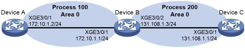

As shown in Figure 1, Device A and Device B establish a neighbor relationship in OSPF process 100, and Device B and Device C establish a neighbor relationship in OSPF process 200. Device A and Device C cannot learn routes from each other through OSPF.

# Execute the display ospf peer command on Device B to verify that Device A and Device C have already established a neighbor relationship.
[DeviceB] display ospf peer
OSPF Process 100 with Router ID 2.2.2.9
Neighbor Brief Information
Area: 0.0.0.0
Router ID Address Pri Dead-Time State Interface
1.1.1.9 172.10.1.1 1 30 Full/DR XGE3/0/1
OSPF Process 200 with Router ID 2.2.2.9
Area: 0.0.0.0
3.3.3.9 131.108.1.1 1 39 Full/BDR XGE3/0/2
# Execute the display ip routing-table command on Device A to verify that Device A does not have a route to 131.108.1.0/24.
[DeviceA] display ip routing-table
Destinations : 11 Routes : 11
Destination/Mask Proto Pre Cost NextHop Interface
0.0.0.0/32 Direct 0 0 127.0.0.1 InLoop0
1.1.1.9/32 Direct 0 0 127.0.0.1 InLoop0
127.0.0.0/8 Direct 0 0 127.0.0.1 InLoop0
127.0.0.0/32 Direct 0 0 127.0.0.1 InLoop0
127.0.0.1/32 Direct 0 0 127.0.0.1 InLoop0
127.255.255.255/32 Direct 0 0 127.0.0.1 InLoop0
172.10.1.0/24 Direct 0 0 172.10.1.1 XGE3/0/1
172.10.1.0/32 Direct 0 0 172.10.1.1 XGE3/0/1
172.10.1.1/32 Direct 0 0 127.0.0.1 InLoop0
172.10.1.255/32 Direct 0 0 172.10.1.1 XGE3/0/1
255.255.255.255/32 Direct 0 0 127.0.0.1 InLoop0
# Execute the display ip routing-table command on Device C to verify that Device C does not have a route to 172.10.1.0/24.
# Execute the display ip routing-table command on Device C.
3.3.3.9/32 Direct 0 0 127.0.0.1 InLoop0
131.108.1.0/24 Direct 0 0 131.108.1.1 XGE3/0/2
131.108.1.0/32 Direct 0 0 131.108.1.1 XGE3/0/2
131.108.1.1/32 Direct 0 0 127.0.0.1 InLoop0
131.108.1.255/32 Direct 0 0 131.108.1.1 XGE3/0/2
