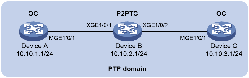

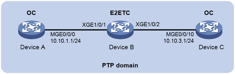

A node in a PTP domain is a clock node. A port enabled with PTP is a PTP port. PTP defines the following types of basic clock nodes:
·     Ordinary Clock (OC)—A PTP clock with a single PTP port in a PTP domain for time synchronization. It synchronizes time from its upstream clock node through the port. If an OC operates as the clock source, it sends synchronization time through a single PTP port to its downstream clock nodes.
·     Boundary Clock (BC)—A clock with more than one PTP port in a PTP domain for time synchronization. A BC uses one of the ports to synchronize time from its upstream clock node. It uses the other ports to synchronize time to the relevant upstream clock nodes. If a BC operates as the clock source, such as BC 1 in Figure 1, it synchronizes time through multiple PTP ports to its downstream clock nodes.
·     Transparent Clock (TC)—A TC does not keep time consistency with other clock nodes. A TC has multiple PTP ports. It forwards PTP messages among these ports and performs delay corrections for the messages, instead of performing time synchronization. TCs include the following types:
¡     End-to-End Transparent Clock (E2ETC)—Forwards all PTP packets in the network and supports calculation of the delay on the entire link.
¡     Peer-to-Peer Transparent Clock (P2PTC)—Forwards only Sync, Follow_Up, and Announce messages, terminates other PTP messages, and supports calculation of the delay on the entire link.
Figure 1 shows the positions of these types of clock nodes in a PTP domain.
Figure 1 Clock nodes in a PTP domain

Example: Configuring PTP (IEEE 1588 version 2, IEEE 802.3/Ethernet transport, multicast transmission)
As shown in Figure 4, configure PTP (IEEE 1588 version 2, IEEE 802.3/Ethernet transport, multicast transmission) to enable time synchronization between the devices.
·     Specify the IEEE 1588 version 2 PTP profile and the IEEE 802.3/Ethernet transport protocol for PTP messages on Device A, Device B, and Device C.
·     Assign Device A, Device B, and Device C to the same PTP domain. Specify the OC clock node type for Device A and Device C, and E2ETC clock node type for Device B. All clock nodes elect a GM through BMC in the PTP domain.
·     Use the default Request_Response delay measurement mechanism on Device A and Device C.
You can use the device as Device A or Device C, and cannot use it as Device B.
Figure 4 Network diagram
1.     Configure Device A:
# Specify the IEEE 1588 version 2 PTP profile.
<DeviceA> system-view
[DeviceA] ptp profile 1588v2
# Specify the OC clock node type.
[DeviceA] ptp mode oc
# Create a PTP domain.
[DeviceA] ptp domain 0
# Enable PTP globally.
[DeviceA] ptp global enable
# Specify PTP for obtaining the time.
[DeviceA] clock protocol ptp
# Configure the priority of the timing signal acquired via PTP as 1.
[DeviceA] network-clock source ptp priority 1
# Enable PTP on M-GigabitEthernet 0/0/0.
[DeviceA] interface m-gigabitethernet 0/0/0
[DeviceA-M-GigabitEthernet0/0/0] ptp enable
[DeviceA-M-GigabitEthernet0/0/0] quit
2.     Configure Device B:
<DeviceB> system-view
[DeviceB] ptp profile 1588v2
# Specify the E2ETC clock node type.
[DeviceB] ptp mode e2etc
[DeviceB] ptp domain 0
[DeviceB] ptp global enable
[DeviceB] clock protocol ptp
# Enable PTP on Ten-GigabitEthernet 1/0/1.
[DeviceB] interface ten-gigabitethernet 1/0/1
[DeviceB-Ten-GigabitEthernet1/0/1] ptp enable
[DeviceB-Ten-GigabitEthernet1/0/1] quit
# Enable PTP on Ten-GigabitEthernet 1/0/2.
[DeviceB] interface ten-gigabitethernet 1/0/2
[DeviceB-Ten-GigabitEthernet1/0/2] ptp enable
[DeviceB-Ten-GigabitEthernet1/0/2] quit
3.     Configure Device C:
<DeviceC> system-view
[DeviceC] ptp profile 1588v2
[DeviceC] ptp mode oc
[DeviceC] ptp domain 0
[DeviceC] ptp global enable
[DeviceC] clock protocol ptp
[DeviceC] network-clock source ptp priority 1
[DeviceC] interface m-gigabitethernet 0/0/0
[DeviceC-M-GigabitEthernet0/0/0] ptp enable
[DeviceC-M-GigabitEthernet0/0/0] quit
When the network is stable, perform the following tasks:
·     Use the display ptp clock command to display PTP clock information.
·     Use the display ptp interface brief command to display brief PTP running information for all PTP interfaces.
# Display PTP clock information on Device A.
[DeviceA] display ptp clock
PTP global state    : Enabled
PTP profile         : IEEE 1588 Version 2
PTP mode            : OC
Slave only          : No
Lock status         : Locked
Clock ID            : 000FE2-FFFE-FF0000
Clock type          : Local
Clock domain        : 0
Number of PTP ports : 1
Priority1     : 128
Priority2     : 128
Clock quality :
 Class                 : 248
 Accuracy              : 254
 Offset (log variance) : 65535
Offset from master : 0 (ns)
Mean path delay    : 0 (ns)
Steps removed      : 0
Local clock time   : Sun Jan 15 20:57:29 2019
# Display brief PTP running information for all PTP interfaces on Device A.
[DeviceA] display ptp interface brief
Name           State         Delay mechanism  Clock step  Asymmetry correction
MGE0/0/0       Master        E2E              Two         0
# Display PTP clock information on Device B.
[DeviceB] display ptp clock
PTP mode            : E2ETC
Slave only          : No
Clock ID            : 000FE2-FFFE-FF0001
Clock type          : Local
Clock domain        : 0
Number of PTP ports : 2
Priority1     : 128
Priority2     : 128
Clock quality :
 Class                 : 248
 Accuracy              : 254
Offset from master  : N/A
Mean path delay     : N/A
Steps removed       : N/A
# Display brief PTP running information for all PTP interfaces on Device B.
[DeviceB] display ptp interface brief
Name       InstID    State         Delay mechanism  Clock step  Asymmetry correction
XGE1/0/1   0         N/A           E2E              Two         0
XGE1/0/2   0         N/A           E2E              Two         0
The command outputs show that Device A is elected as the GM and M-GigabitEthernet 0/0/0 on Device A is the master port.
Example: Configuring PTP (IEEE 1588 version 2, IPv4 UDP transport, multicast transmission)
As shown in Figure 5, configure PTP (IEEE 1588 version 2, IPv4 UDP transport, multicast transmission) to enable time synchronization between the devices.
·     Specify the IEEE 1588 version 2 PTP profile for Device A, Device B, and Device C.
·     Specify multicast IPv4 UDP transport for PTP messages.
·     Assign Device A, Device B, and Device C to the same PTP domain. Specify the OC clock node type for Device A and Device C, and P2PTC clock node type for Device B. All clock nodes elect a GM through BMC in the PTP domain.
·     Specify the peer delay measurement mechanism (p2p) for Device A and Device C.
Figure 5 Network diagram
# Configure the source IP address for multicast PTP messages transmitted over IPv4 UDP.
[DeviceA] ptp source 10.10.1.1
# On M-GigabitEthernet 0/0/0, specify the IPv4 UDP transport protocol for PTP messages, specify the delay measurement mechanism as p2p, and enable PTP.
[DeviceA-M-GigabitEthernet0/0/0] ptp transport-protocol udp [DeviceA-M-GigabitEthernet0/0/0] ptp delay-mechanism p2p
# Specify the P2PTC clock node type.
[DeviceB] ptp mode p2ptc
# Configure the source IP address for multicast PTP messages transmitted over UDP.
[DeviceB] ptp source 10.10.2.1
# On Ten-GigabitEthernet 1/0/1, specify the IPv4 UDP transport protocol for PTP messages and enable PTP.
DeviceB-Ten-GigabitEthernet1/0/1] ptp transport-protocol udp
# On Ten-GigabitEthernet 1/0/2, specify the IPv4 UDP transport protocol for PTP messages and enable PTP.
[DeviceB-Ten-GigabitEthernet1/0/2] ptp transport-protocol udp
[DeviceC] ptp source 10.10.3.1
[DeviceC-M-GigabitEthernet0/0/0] ptp transport-protocol udp [DeviceC-M-GigabitEthernet0/0/0] ptp delay-mechanism p2p
PTP mode            : OC
Slave only          : No
Clock type          : Local
Clock domain        : 0
Priority1     : 128
Priority2     : 128
Clock quality :
 Class                 : 248
 Accuracy              : 254
Steps removed      : 0
MGE0/0/0        Master        P2P              Two         0
PTP mode            : P2PTC
Slave only          : No
Lock status         : Unlocked
Clock type          : Local
Clock domain        : 0
Priority1     : 128
Priority2     : 128
Clock quality :
 Class                 : 248
 Accuracy              : 254
Steps removed       : N/A
XGE1/0/1   0          N/A           P2P              Two         0
XGE1/0/2   0          N/A           P2P              Two         0
