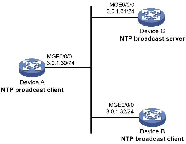

NTP working mechanism
Figure 1 shows how NTP synchronizes the system time between two devices (Device A and Device B, in this example). Assume that:
·     Prior to the time synchronization, the time is set to 10:00:00 am for Device A and 11:00:00 am for Device B.
·     Device B is used as the NTP server. Device A is to be synchronized to Device B.
·     It takes 1 second for an NTP message to travel from Device A to Device B, and from Device B to Device A.
·     It takes 1 second for Device B to process the NTP message.
Figure 1 Basic work flow
The synchronization process is as follows:
1.     Device A sends Device B an NTP message, which is timestamped when it leaves Device A. The time stamp is 10:00:00 am (T1).
2.     When this NTP message arrives at Device B, Device B adds a timestamp showing the time when the message arrived at Device B. The timestamp is 11:00:01 am (T2).
3.     When the NTP message leaves Device B, Device B adds a timestamp showing the time when the message left Device B. The timestamp is 11:00:02 am (T3).
4.     When Device A receives the NTP message, the local time of Device A is 10:00:03 am (T4).
Up to now, Device A can calculate the following parameters based on the timestamps:
·     The roundtrip delay of the NTP message: Delay = (T4 – T1) – (T3 – T2) = 2 seconds.
·     Time difference between Device A and Device B: Offset = [ (T2 – T1) + (T3 – T4) ] /2 = 1 hour.
Based on these parameters, Device A can be synchronized to Device B.
This is only a rough description of the work mechanism of NTP. For more information, see the related protocols and standards.

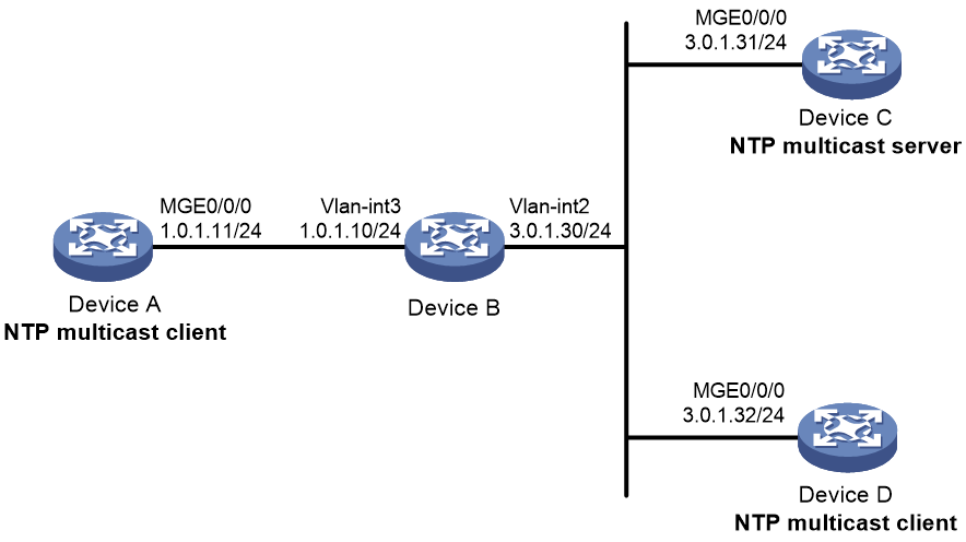

NTP architecture
NTP uses stratums 1 to 16 to define clock accuracy, as shown in Figure 2. A lower stratum value represents higher accuracy. Clocks at stratums 1 through 15 are in synchronized state, and clocks at stratum 16 are not synchronized.
Figure 2 NTP architecture
A stratum 1 NTP server gets its time from an authoritative time source, such as an atomic clock. It provides time for other devices as the primary NTP server. A stratum 2 time server receives its time from a stratum 1 time server, and so on.
To ensure time accuracy and availability, you can specify multiple NTP servers for a device. The device selects an optimal NTP server as the clock source based on parameters such as stratum. The clock that the device selects is called the reference source. For more information about clock selection, see the related protocols and standards.
If the devices in a network cannot synchronize to an authoritative time source, you can perform the following tasks:
·     Select a device that has a relatively accurate clock from the network.
·     Use the local clock of the device as the reference clock to synchronize other devices in the network.

Example: Configuring NTP broadcast association mode
As shown in Figure 8, configure Switch C as the NTP server for multiple devices on the same network segment so that these devices synchronize the time with Switch C.
·     Configure Switch C's local clock as its reference source, with stratum level 2.
·     Configure Switch C to operate in broadcast server mode and send broadcast messages from management Ethernet interface MGE 0/0/0.
·     Configure Switch A and Switch B to operate in broadcast client mode, and listen to broadcast messages on management Ethernet interface MGE 0/0/0.
Figure 8 Network diagram
1.     Assign an IP address to each interface, and make sure Switch A, Switch B, and Switch C can reach each other, as shown in Figure 8. (Details not shown.)
2.     Configure Switch C:
# Enable the NTP service.
<SwitchC> system-view
[SwitchC] ntp-service enable
# Specify NTP for obtaining the time.
[SwitchC] clock protocol ntp
# Specify the local clock as the reference source, with stratum level 2.
[SwitchC] ntp-service refclock-master 2
# Configure Switch C to operate in broadcast server mode and send broadcast messages from MGE 0/0/0.
[SwitchC] interface M-GigabitEthernet 0/0/0
[SwitchC-M-GigabitEthernet0/0/0] ntp-service broadcast-server
3.     Configure Switch A:
<SwitchA> system-view
[SwitchA] ntp-service enable
[SwitchA] clock protocol ntp
# Configure Switch A to operate in broadcast client mode and receive broadcast messages on MGE 0/0/0.
[SwitchA] interface M-GigabitEthernet 0/0/0
[SwitchA-M-GigabitEthernet0/0/0] ntp-service broadcast-client

Example: Configuring NTP multicast association mode
As shown in Figure 9, configure Switch C as the NTP server for multiple devices on different network segments so that these devices synchronize the time with Switch C.
·     Configure Switch C to operate in multicast server mode and send multicast messages from management Ethernet interface MGE 0/0/0.
·     Configure Switch A and Switch D to operate in multicast client mode and receive multicast messages on management Ethernet interface MGE 0/0/0, respectively.
Figure 9 Network diagram
The device can only be used as Device A, Device C, or Device D, and cannot be used as Device B.
1.     Assign an IP address to each interface, and make sure the switches can reach each other, as shown in Figure 9. (Details not shown.)
# Configure Switch C to operate in multicast server mode and send multicast messages from MGE 0/0/0.
[SwitchC-M-GigabitEthernet0/0/0] ntp-service multicast-server
3.     Configure Switch D:
<SwitchD> system-view
[SwitchD] ntp-service enable
[SwitchD] clock protocol ntp
# Configure Switch D to operate in multicast client mode and receive multicast messages on MGE 0/0/0.
[SwitchD] interface M-GigabitEthernet 0/0/0
[SwitchD-M-GigabitEthernet0/0/0] ntp-service multicast-client
4.     Verify the configuration:
# Verify that Switch D has synchronized to Switch C, and the clock stratum level is 3 on Switch D and 2 on Switch C.
Switch D and Switch C are on the same subnet, so Switch D can receive the multicast messages from Switch C without being enabled with the multicast functions.
[SwitchD-M-GigabitEthernet0/0/0] display ntp-service status
 Clock status: synchronized
 Clock stratum: 3
 System peer: 3.0.1.31
 Local mode: bclient
 Reference clock ID: 3.0.1.31
 Leap indicator: 00
 Clock jitter: 0.044281 s
 Stability: 0.000 pps
 Clock precision: 2^-23
 Root delay: 0.00229 ms
 Root dispersion: 4.12572 ms
 Reference time: d0d289fe.ec43c720  Sat, Jan  8 2019  7:00:14.922
 System poll interval: 64 s
# Verify that an IPv4 NTP association has been established between Switch D and Switch C.
[SwitchD-M-GigabitEthernet0/0/0] display ntp-service sessions
       source          reference       stra reach poll  now offset  delay disper
 [1245]3.0.1.31        127.127.1.0        2     1   64  519   -0.0 0.0022 4.1257
Notes: 1 source(master),2 source(peer),3 selected,4 candidate,5 configured.
 Total sessions: 1
5.     Configure Switch B:
Because Switch A and Switch C are on different subnets, you must enable the multicast functions on Switch B before Switch A can receive multicast messages from Switch C.
# Enable IP multicast functions.
<SwitchB> system-view
[SwitchB] multicast routing
[SwitchB-mrib] quit
[SwitchB-Vlan-interface2] pim dm
[SwitchB-Vlan-interface2] quit
[SwitchB] vlan 3
[SwitchB-vlan3] port ten-gigabitethernet 1/0/1
[SwitchB-vlan3] quit
[SwitchB] interface vlan-interface 3
[SwitchB-Vlan-interface3] igmp enable
[SwitchB-Vlan-interface3] igmp static-group 224.0.1.1
[SwitchB-Vlan-interface3] quit
[SwitchB] igmp-snooping
[SwitchB-igmp-snooping] quit
[SwitchB] interface ten-gigabitethernet 1/0/1
[SwitchB-Ten-GigabitEthernet1/0/1] igmp-snooping static-group 224.0.1.1 vlan 3
6.     Configure Switch A:
# Configure Switch A to operate in multicast client mode and receive multicast messages on MGE 0/0/0.
[SwitchA-M-GigabitEthernet 0/0/0] ntp-service multicast-client
# Verify that Switch A has synchronized its time with Switch C, and the clock stratum level of Switch A is 3.
[SwitchA-M-GigabitEthernet 0/0/0] display ntp-service status
 Clock stratum: 3
 Local mode: bclient
 Leap indicator: 00
 Clock jitter: 0.165741 s
 Root delay: 0.00534 ms
 Root dispersion: 4.51282 ms
 Reference time: d0c61289.10b1193f  Wed, Dec 29 2019 20:03:21.065
# Verify that an IPv4 NTP association has been established between Switch A and Switch C.
[SwitchA-M-GigabitEthernet 0/0/0] display ntp-service sessions
 [1234]3.0.1.31        127.127.1.0        2   247   64  381   -0.0 0.0053 4.5128
 Total sessions: 1

Example: Configuring NTP authentication in broadcast association mode
As shown in Figure 11, configure Switch C as the NTP server for multiple devices on the same network segment so that these devices synchronize the time with Switch C. Configure Switch A and Switch B to authenticate the NTP server.
·     Configure Switch C's local clock as its reference source, with stratum level 3.
·     Configure Switch A and Switch B to operate in broadcast client mode and receive broadcast messages on management Ethernet interface MGE 0/0/0.
·     Enable NTP authentication on Switch A, Switch B, and Switch C.
Figure 11 Network diagram
1.     Assign an IP address to each interface, and make sure Switch A, Switch B, and Switch C can reach each other, as shown in Figure 11. (Details not shown.)
2.     Configure Switch A:
# Enable NTP authentication on Switch A. Create a plaintext NTP authentication key, with key ID of 88 and key value of 123456. Specify it as a trusted key.
[SwitchA] ntp-service authentication enable
[SwitchA] ntp-service authentication-keyid 88 authentication-mode md5 simple 123456
[SwitchA] ntp-service reliable authentication-keyid 88
# Configure Switch A to operate in NTP broadcast client mode and receive NTP broadcast messages on MGE 0/0/0.
3.     Configure Switch B:
[SwitchB] ntp-service enable
[SwitchB] clock protocol ntp
# Enable NTP authentication on Switch B. Create a plaintext NTP authentication key, with key ID of 88 and key value of 123456. Specify it as a trusted key.
[SwitchB] ntp-service authentication enable
[SwitchB] ntp-service authentication-keyid 88 authentication-mode md5 simple 123456
[SwitchB] ntp-service reliable authentication-keyid 88
# Configure Switch B to operate in broadcast client mode and receive NTP broadcast messages on MGE 0/0/0.
[SwitchB] interface M-GigabitEthernet 0/0/0
[SwitchB-M-GigabitEthernet0/0/0] ntp-service broadcast-client
4.     Configure Switch C:
# Specify the local clock as the reference source, with stratum level 3.
[SwitchC] ntp-service refclock-master 3
# Configure Switch C to operate in NTP broadcast server mode and use MGE 0/0/0 to send NTP broadcast packets.
[SwitchC-M-GigabitEthernet0/0/0] quit
5.     Verify the configuration:
NTP authentication is enabled on Switch A and Switch B, but not on Switch C, so Switch A and Switch B cannot synchronize their local clocks to Switch C.
[SwitchB-M-GigabitEthernet0/0/0] display ntp-service status
 Clock status: unsynchronized
 Clock stratum: 16
 Reference clock ID: none
6.     Enable NTP authentication on Switch C:
# Enable NTP authentication on Switch C. Create a plaintext NTP authentication key, with key ID of 88 and key value of 123456. Specify it as a trusted key.
[SwitchC] ntp-service authentication enable
[SwitchC] ntp-service authentication-keyid 88 authentication-mode md5 simple 123456
[SwitchC] ntp-service reliable authentication-keyid 88
# Specify Switch C as an NTP broadcast server, and associate key 88 with Switch C.
[SwitchC-M-GigabitEthernet0/0/0] ntp-service broadcast-server authentication-keyid 88
# Verify that Switch B has synchronized its time with Switch C, and the clock stratum level of Switch B is 4.
 Clock stratum: 4
 Local mode: bclient
 Leap indicator: 00
 Clock jitter: 0.006683 s
 Root delay: 0.00127 ms
 Root dispersion: 2.89877 ms
 Reference time: d0d287a7.3119666f  Sat, Jan  8 2019  6:50:15.191
# Verify that an IPv4 NTP association has been established between Switch B and Switch C.
[SwitchB-M-GigabitEthernet0/0/0] display ntp-service sessions
 [1245]3.0.1.31        127.127.1.0        3     3   64   68   -0.0 0.0000    0.0
 Total sessions: 1

SNTP configuration examples
Example: Configuring SNTP
As shown in Figure 12, perform the following tasks:
·     Configure Device A's local clock as its reference source, with stratum level 2.
·     Configure Device B to operate in SNTP client mode, and specify Device A as the NTP server.
·     Configure NTP authentication on Device A and SNTP authentication on Device B.
Figure 12 Network diagram
1.     Assign an IP address to each interface, and make sure Device A and Device B can reach each other, as shown in Figure 12. (Details not shown.)
2.     Configure Device A:
<DeviceA> system-view
[DeviceA] ntp-service enable
[DeviceA] clock protocol ntp
# Configure the local clock as the reference source, with stratum level 2.
[DeviceA] ntp-service refclock-master 2
# Enable NTP authentication on Device A.
[DeviceA] ntp-service authentication enable
# Configure a plaintext NTP authentication key, with key ID of 10 and key value of aNiceKey.
[DeviceA] ntp-service authentication-keyid 10 authentication-mode md5 simple aNiceKey
# Specify the key as a trusted key.
[DeviceA] ntp-service reliable authentication-keyid 10
3.     Configure Device B:
# Enable the SNTP service.
<DeviceB> system-view
[DeviceB] sntp enable
[DeviceB] clock protocol ntp
# Enable SNTP authentication on Device B.
[DeviceB] sntp authentication enable
# Configure a plaintext authentication key, with key ID of 10 and key value of aNiceKey.
[DeviceB] sntp authentication-keyid 10 authentication-mode md5 simple aNiceKey
[DeviceB] sntp reliable authentication-keyid 10
# Specify Device A as the NTP server of Device B, and associate the server with key 10.
[DeviceB] sntp unicast-server 1.0.1.11 authentication-keyid 10
# Verify that an SNTP association has been established between Device B and Device A, and Device B has synchronized its time with Device A.
[DeviceB] display sntp sessions
NTP server     Stratum   Version    Last receive time
1.0.1.11        2         4          Tue, May 17 2019  9:11:20.833 (Synced)
