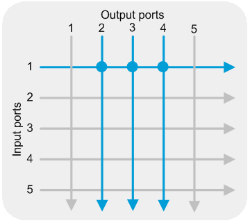

Fan-out
To send a packet to multiple receivers (for example, sending rapidly changing market data to multiple servers), a traditional switch or router broadcasts the packet to multiple ports in a specific VLAN or multicasts the packet to the specific ports. These two methods take at least 500 ns of latency.
A Layer 1 Ethernet switch implements fast 1:N traffic copying through the fan-out feature. This feature fast copies traffic from one port to multiple ports, with latency as low as 4 ns. Layer 1 Ethernet switches support physical signal regeneration and clock data recovery, ensuring data integrity even after multiple copies. As shown in Figure 2, you can configure the fan-out feature to copy traffic from port 1 to ports 2, 3 and 4.
Figure 2 Fan-out diagram
To configure fast interface forwarding, specify a source interface for the current interface. When a packet is received on the specified source interface, the packet will be directly forwarded out the current interface without table lookup. Fast interface forwarding provides both low latency and fast packet transmission.
Fast interface forwarding supports the following forwarding modes:
·     1:1—One source interface corresponds to one destination interface. Packets received on the specified source interface are forwarded out the specified destination interface.
·     1:N—One source interface corresponds to multiple destination interfaces. A copy of each packet received on the source interface is forwarded out each destination interface.

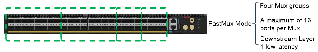

Layer 1.5 Ethernet switch
The H3C S6116-48X-M Layer 1.5 Ethernet switches support all the features of Layer 1 Ethernet switches, including fan-out and patch panel. They also support field programmable gate array (FPGA) cards and can load multiple FPGA applications. You can dynamically switch between different applications according to the network requirements to achieve different functions.
A Layer 1.5 Ethernet switch supports the following FPGA applications:
·     FastMux—This application supports four Mux groups, which separately implement 15:1, 15:1, 7:1, and 7:1 upstream traffic multiplexing ratios with a minimum latency of 35 ns.
·     Enhanced SecurityMux—This application supports one Mux group with two upstream interfaces. This application supports a maximum upstream traffic multiplexing ratio of 46:2 and a maximum downstream demultiplexing ratio of 2:46. This application supports ACL-based packet forwarding control on the outgoing interfaces of upstream or downstream traffic.
·     Multi-group SecurityMux—This application supports four Mux groups and four Demux groups. A Mux group can have one upstream interface. The groups separately implement 7:1, 7:1, 13:1, and 15:1 upstream traffic multiplexing ratios, and 1:7, 1:7, 1:13, 1:15 downstream traffic demultiplexing ratios. This application supports ACL-based packet forwarding control on the outgoing interfaces of downstream traffic. Two monitor ports are used to monitor the traffic of Mux groups.
·     Tapping Aggregation—This application supports mirroring incoming traffic to other interfaces and load-sharing mirrored traffic among the monitor ports. You can configure a maximum of four monitor ports.

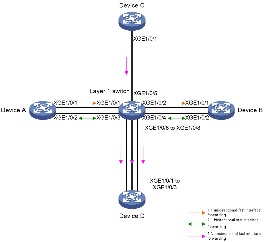

FastMux
FastMux is an applications designed for ultra-low latency. The downstream traffic is broadcast by the Layer 1 fan-out feature without FPGA processing. The upstream traffic is multiplexed by FPGA cards with a minimum latency of 35 ns. The switch supports configuring four Mux groups in FastMux mode. The software design is highly flexible, and allows you to dynamically move ports among groups according to the requirements.
Figure 3 FastMux group diagram (for illustration only)

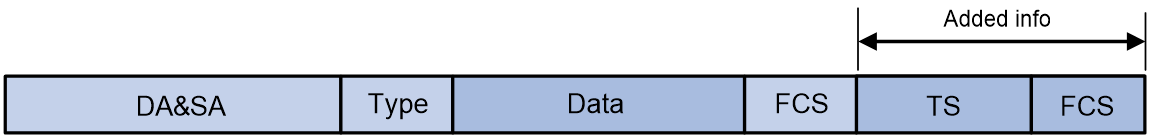

Tapping aggregation is an application designed for data mirroring. This feature mirrors and timestamps the packets of one or more ports, and aggregates them on up to four monitoring ports for traffic forwarding and backup. Traffic is load-shared among multiple monitoring ports.
After a packet is mirrored and aggregated, the packet has an additional 17-byte timestamp (TS) field and 4-byte frame check sequence (FCS) field at the end compared to the original packet.
Figure 4 Original packet
Figure 5 Mirrored and aggregated packet
If the length of the original packet exceeds 1518 bytes, the mirrored and aggregated packet will be truncated to the first 1518 bytes and then the TS and FCS fields will be added.

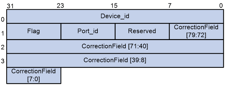

As shown in Figure 6, the TS field contains 17 bytes, including a complete timestamp in CF field format and packet information.
Figure 6 Timestamp format
The fields are described as follows:
·     Device_id: A 4-byte string indicating the device ID.
·     Only the primary IPv4 address of the management Ethernet interface on the device can be used as the device ID. Secondary IPv4 addresses and IPv6 addresses cannot be used as the device ID.
·     If the management Ethernet interface is only configured with secondary IPv4 addresses or IPv6 addresses, the device ID is 0.
·     Flag: 1 byte long. Its bits are as follows:
¡     [7:4]: Reserved bits, which are fixed at 0.
¡     [3]: Syn_lost. The value of 1 indicates a local clock, and the value of 0 indicates a synchronized clock.
The clock is considered as synchronized in following scenarios:
·     When the external clock source of the device is GPS/1PPS and the clock source is locked, the clock is considered synchronized.
·     When the external clock source of the device is SyncE and the clock source is locked, the clock is considered synchronized after PTP convergence.
·     When the device does not have an external clock source and only uses the PTP feature, the clock is considered synchronized after PTP convergence.
¡     [2]: Trunk_frame. The value of 1 indicates that the packet length exceeds 1518 bytes (original frame length including FCS). The value of 0 indicates that the packet length does not exceed 1518 bytes.
¡     [1]: Reserved bit, which is fixed at 0.
¡     [0]: Indicates whether a packet is normal. The value of 1 indicates a normal packet, and the value of 0 indicates an abnormal packet (for example, a packet with a CRC error).
·     Port_id: 1 byte long. This field represents the number of the port that receives the mirrored packet on the device panel. For example, the value of 2 represents that the mirrored packet is received by the port numbered 2 on the device panel.
·     Reserved: 1 byte long. This field is reserved for future use, and all bits are set to 0.
·     CorrectionField: 10-byte extended CorrectionField.
To represent a larger time range, the FPGA cards extend the 64-bit CorrectionField defined by the 1588v2 standard to 80 bits. The calculation method for the CorrectionField value remains unchanged. The value is calculated by multiplying the total number of nanoseconds since January 1, 1970 (00:00:00 GMT) until the device time by 216.
To convert the CorrectionField value to the timestamp format, use the following formulas (ps for picoseconds, ns for nanosecond, and s for seconds):
·     ps = CorrectionField[15:0] * 1000 / 216. In the simplified calculation, you can directly take bits [15:6] of the CorrectionField as the value for ps.
·     ns = CorrectionField[79:16] % 1000000000 (dividing by 1 billion and taking the remainder).
·     s = CorrectionField[79:16] / 1000000000 (dividing by 1 billion and rounding down).
The total number of seconds calculated is the total number of seconds from January 1st, 1970 (00:00:00 GMT) until the current time.
