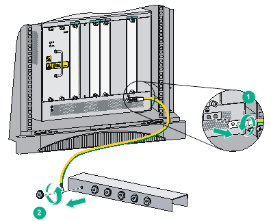

Removing the grounding cable
1.     Loosen the two screws at the grounding holes of the chassis, and then remove the grounding cable from the chassis.
2.     Use a lever to loosen the hex nut on the grounding post of the grounding strip, and remove the other end of the grounding cable (with a ring terminal) from the grounding post.
Figure 1 Removing the grounding cable

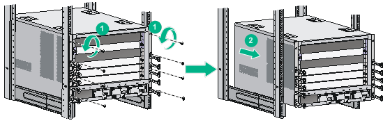

To remove the chassis from the rack:
1.     Prepare the wooden box and packing bag of the chassis. Make sure the box and bag are clean, dry, and not damaged.
2.     Remove the top cap and side panels from the wooden box, and put the pallet base to a proper place.
3.     Use a Phillips screwdriver to loosen the screws that attach the mounting brackets to the rack.
4.     Use a minimum of two people to slide the chassis outwards along the slide rails. When most part of the chassis is removed from the slide rails, lift up the chassis by holding the handles at the chassis sides to completely remove the chassis from the rack.
5.     Put the chassis onto the pallet base of the wooden box.
Figure 2 Removing the chassis from the rack

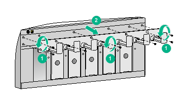

Removing the mounting brackets
1.     Prepare the packing box of the mounting brackets. Make sure the box is clean, dry, and not damaged.
2.     As shown in Figure 3, use a Phillips screwdriver to loosen the screws that attach the mounting brackets to the chassis, and then remove the mounting brackets.
3.     Put the mounting brackets into the box.
Figure 3 Removing the mounting brackets from the chassis

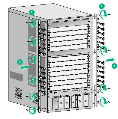

Removing the cable management brackets
1.     Prepare the packing bag of the cable management brackets. Make sure the bag is clean, dry, and not damaged.
2.     Use a Phillips screwdriver to loosen the screws that attach the cable management brackets to the chassis, and then remove the cable management brackets.
3.     Put the cable management brackets into the bag.
Figure 4 Removing the cable management brackets

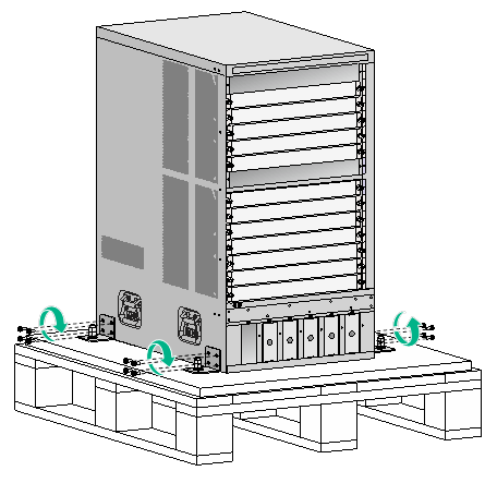

Repackaging the router chassis only for the SR8812-X router
1.     As shown in Figure 5, align the screw holes on the two sides of the chassis bottom to the L-type brackets on the pallet base of the wooden box.
2.     Screw in the screws shipped with your router and fasten.
Figure 5 Repackaging the router chassis

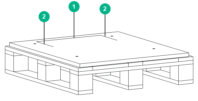

1.     Align the left, right, and rear edges of the chassis bottom with the left, right, and rear positioning lines respectively on the wooden pallet base.
Figure 6 wooden pallet base
(1) Rear positioning line
(2) Left and right positioning lines

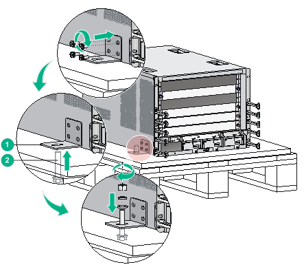

2.     Use screws to attach L-type brackets to the chassis.
3.     Align the mounting holes on the L-type brackets with the mounting holes in the wooden pallet base.
4.     Use the L-type brackets to attach the chassis to the wooden pallet base.
¡     For the SR8816-X router, place the flat washer and spring washer in sequence onto each L-type bracket and insert and fasten the bracket into the mounting hole in the wooden pallet base.
¡     For the SR8804-X, SR8808-X, and SR8808H-X routers, perform the following steps:
-     Attach a washer to a bolt.
-     Insert the bolt through the mounting hole from the bottom of the wooden pallet base until the bolt reaches out the mounting hole from the top of the wooden pallet base.
-     Attach another washer and two nuts to the bolt in sequence.
-     Fasten the nuts.
Figure 7 Using the L-type brackets to secure the chassis to the wooden pallet base (SR8804-X)

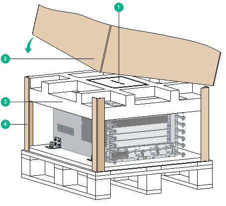

Figure 8 Repackaging the chassis (SR8804-X)
(1) Accessories box
(2) Cardboard box
(3) Foam cushion
(4) Paper angle bead
