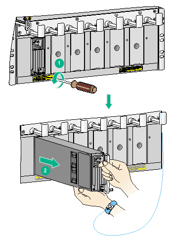

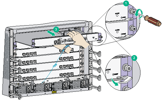

Replacing a card
CAUTION
CAUTION:
·     The cards on the routers are hot swappable. However, to remove the only MPU on the router, you must first power off the router.
·     To replace an MPU or service module, first remove all its cables.
·     Replace all Type-A switching fabric modules if one of them needs to be replaced. For more information, see H3C SR8800-X Router Series Hardware Information and Specifications.
The replacement procedure is the same for the cards installed in horizontal or vertical slots. The following procedure replaces a card in a horizontal slot.
To replace a card:
1.     Prepare an antistatic mat to place the removed card.
2.     Wear an ESD wrist strap and make sure it makes good skin contact and is correctly grounded. For more information, see "Attaching an ESD wrist strap."
3.     Use a Phillips screwdriver to loosen the captive screws on the card.
4.     Press the ejector buttons on the ejector levers to release the ejector levers. (This step is applicable only to a switching fabric module with ejector buttons on the ejector levers.)
5.     Press the ejector levers down so that they are vertical to the front panel. (This step applies only to ejector levers similar to those on a CSPEX-1504X card.)
6.     Move the ejector levers outwards to separate the card from the backplane.
7.     Use one hand to slowly move the card outwards. Supporting the bottom of the card with the other hand, pull the card out of the slot along slide rails.
8.     Put the removed card on the antistatic mat.
Figure6-4 Removing a card
9.     Install a new card. For the installation procedure, see "Installing MPUs/service modules/switching fabric modules."
If you are not to install a new card, perform the following tasks to ensure adequate ventilation and dust prevention:
¡     If a service module with a height of 1.2U is removed from an SR8808H-X or SR8816-X router, install a filler panel in the slot and an air duct above the slot immediately.
¡     If another type of card is removed from the card, install a filler panel in the slot immediately.

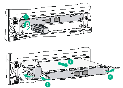

Replacing a subcard
CAUTION
CAUTION:
All subcards except for the MIC-SM are hot swappable.
This section describes the procedure for replacing a subcard on a base card.
To replace a subcard:
1.     Prepare an antistatic mat to place the removed subcard.
2.     Put on an ESD wrist strap, and make sure the wrist strap makes good skin contact and is correctly grounded. For more information, see "Attaching an ESD wrist strap."
3.     Identify whether the subcard is hot swappable.
¡     If the subcard is hot swappable, go to the next step.
¡     If the subcard is not hot swappable, make sure the base card is powered off.
4.     Use a Phillips screwdriver to loosen the captive screws on the subcard.
5.     Rotate out the ejector levers to unseat the subcard from the base card.
6.     Slowly pull out the subcard along the guide rails.
7.     Put the removed subcard on an antistatic mat or in the original package.
8.     Install the new subcard. For more information about how to install a subcard, see "Installing a subcard."
Figure6-5 Removing a subcard

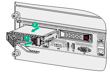

Replacing a hard disk
CAUTION
CAUTION:
Do not hot swap a hard disk when the operating system on the hard disk is running.
To replace a hard disk:
1.     Prepare an antistatic mat to place the removed hard disk.
2.     Put on an ESD wrist strap, and make sure the wrist strap makes good skin contact and is reliably grounded. For more information, see "Attaching an ESD wrist strap."
3.     Press the button on the hard disk panel. The hard disk panel will open automatically.
4.     Gently pull out the hard disk along the guide rails.
5.     Install the new hard disk. For more information about how to install a hard disk, see "Installing a hard disk."
Figure6-6 Removing a hard disk

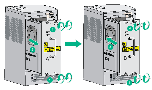

Replacing a fan tray
WARNING
WARNING!
To avoid bodily injury, do not touch the rotating fans when replacing a fan tray.
CAUTION
CAUTION:
To install fan trays in FAN 10 to FAN 14 slots on an SR8816-X router, orient the fan tray with the yellow warning sign in the upper half. To install fan trays in the other fan tray slots, orient the fan tray with the yellow warning sign in the lower half.
SR8800-X routers provide the following types of fan tray slots:
·     Vertical slots: SR8804-X, SR8812-X, SR8808H-X, and SR8816-X.
·     Horizontal slots: SR8808-X.
The fan tray replacement procedure is similar for all routers. The following procedure uses the SR8804-X router as an example.
To replace a fan tray:
1.     Prepare an antistatic mat to place the fan tray to be removed.
2.     Put on an ESD wrist strap and make sure the wrist strap makes good skin contact and is correctly grounded. For more information, see "Attaching an ESD wrist strap."
3.     Remove the captive screws on the fan tray.
4.     Hold the handle of the fan tray with one hand to gently pull the fan tray part way out of the chassis. After the fans stop rotating, support the bottom of the fan tray with the other hand, and take out the fan tray from the chassis.
5.     Put the removed fan tray on the antistatic mat.
6.     Unpack the fan tray to be installed.
7.     Holding the handle of the fan tray with one hand and supporting bottom with the other, gently slide the fan tray along the guide rails into the slot until it is firmly secured in the slot.
8.     Fasten the captive screws on the fan tray.
Figure6-7 Replacing a fan tray (SR8804-X)
(A) Fan tray to be replaced
(B) Fan tray to be installed

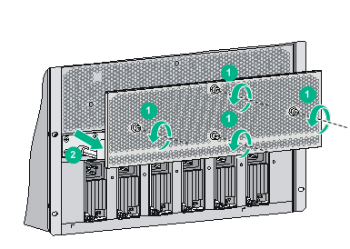

Replacing an air filter
CAUTION
CAUTION:
Clean air filters every month to guarantee adequate ventilation and avoid over-temperature.
Keep the removed screws secure from loss when replacing an air filter on an SR8804-X or SR8812-X router.
To replace an air filter:
1.     Loosen the screws on the air filter.
2.     Remove the air filter from the chassis.
Figure6-8 Removing the air filter from the SR8808-X chassis
Figure6-9 Removing the air filter from the other models
3.     Attach the cleaned air filter to the router.
For the installation procedures, see "(Optional) Installing an air filter on the chassis."

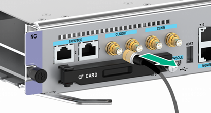

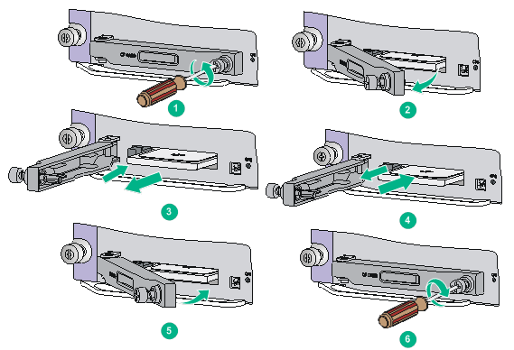

Replacing a CF card
CAUTION
CAUTION:
To avoid hardware or file system damage, do not remove a CF card when the router is booting or the CF card LED is flashing.
The CF card is installed on the MPU of the router.
To replace a CF card:
1.     Observe the CF card LED status.
¡     If the LED is on, you cannot remove the CF card. You must use the umount command in user view to unmount the CF card and wait until the CF card LED is off. If you want to continue to use the CF card, execute the mount command in user view to mount the CF card again.
For more information about the umount and mount commands, see file system management in H3C SR8800-X Routers Fundamentals Command Reference.
¡     If the LED is flashing, data is being read from or written to the CF card. Only after the LED stops flashing, you can remove the CF card.
¡     If the LED is off, the CF card is unmounted. You can remove the CF card.
2.     Use a Phillips screwdriver to loosen the screw at the right side of the CF card protection cover, and open the CF card protection cover.
Skip this step if the MPU does not have a CF card protection cover.
3.     Push the eject button on the CF card slot all the way until the CF card in the slot ejects. Remove the CF card from the slot, and put the removed CF card on an antistatic bag or into its original package.
4.     Before inserting the CF card, make sure the CF card eject button is pushed to the end and does not reset automatically. Push the new CF card all the way into the CF card slot until the eject button resets.
5.     Close the CF card cover and use a Phillips screwdriver to fasten the screw on the CF card protection cover.
Figure6-10 Replacing a CF card

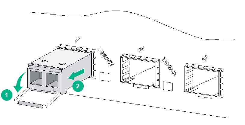

Replacing an XFP/QSFP+/QSFP28/SFP28/SFP+/SFP transceiver module
The replacement procedure is similar for XFP, QSFP+, QSFP28, SFP28, SFP+, and SFP transceiver modules. The following uses an SFP+ transceiver module for illustration.
To replace an SFP+ transceiver module:
1.     Wear an ESD wrist strap and make sure it makes good skin contact and is correctly grounded.
2.     Remove the optical fibers from the module.
There is a latching mechanism between a fiber connector and transceiver module bore to prevent connector disengagement. Release the latching mechanism before removing the optical fiber. To avoid damages, do not use excessive force.
3.     Pivot the bail latch down to the horizontal position.
4.     Hold the bail latch to pull the module out of the slot. Make sure you apply force in the direction parallel to the ground. To avoid damaging the bail latch, do not use excessive force.
If you apply force at an angle when pulling the module out, you can hardly pull the module out and the module or fiber port might be damaged.
5.     Insert dust plugs into the removed module, and put the module into its packaging bag.
6.     Install a new module. For the installation procedure, see "Installing an XFP/QSFP+/QSFP28/SFP28/SFP+/SFP module."
Figure6-11 Removing an SFP+ transceiver module

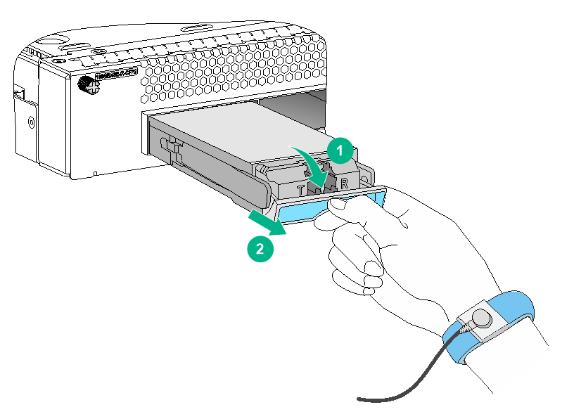

Replacing a CFP transceiver module
1.     Wear an ESD wrist strap and make sure it makes good skin contact and is reliably grounded.
3.     Loosen the captive screws on the module.
4.     Carefully pull the module out of the slot. Make sure you apply force in the direction parallel to the ground.
If you apply force at an angle, you can hardly pull the module out and the module or fiber port might be damaged.
5.     Insert the plugs into the removed module, and put the module into its packaging bag.
6.     Install a new module. For the installation procedure, see "Installing a CFP module."
Figure6-12 Removing a CFP transceiver module
Replacing a CFP2 transceiver module
2.     Remove the optical fibers from the module and pivot down the handle so that the handle is parallel with the module body.
3.     Hold the handle to pull the module out.
To avoid damaging the handle, do not use excessive force.
4.     Insert dust plugs into the transceiver module ports and put the transceiver module in its package.
5.     Install a new CFP2 transceiver module. For the installation procedure, see "Installing a CFP2 transceiver module."
Figure6-13 Removing a CFP2 transceiver module

Replacing an SMB coaxial clock cable
1.     Wear an ESD wrist strap and make sure it makes good skin contact and is reliably grounded. For more information, see "Attaching an ESD wrist strap."
2.     Remove the SMB coaxial clock cable from the clock port.
3.     Install a new SMB coaxial clock cable. For the installation procedure, see "Installing an SMB coaxial clock cable".
4.     If you are no to install a new SMB coaxial clock cable after removing the old one, insert a dust plug into the clock port.
Figure6-15 Replacing an SMB coaxial clock cable
