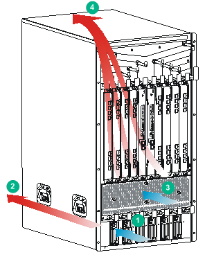

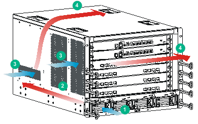

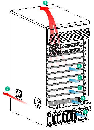

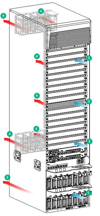

Figure1-1 describes the airflow through the SR8808-X chassis. Figure1-2 describes the airflow through the SR8808H-X chassis. Figure1-3 describes the airflow through the SR8816-X chassis. Figure1-4 describes the airflow through the other models.
Figure1-1 Airflow through the SR8808-X chassis
(1) Direction of the airflow into the power supplies
(2) Direction of the airflow out of the power supplies
(3) Direction of the airflow into the chassis
(4) Direction of the airflow out of the chassis
Figure1-2 Airflow through the SR8808H-X chassis
Figure1-3 Airflow through the SR8816-X chassis
Figure1-4 Airflow through the other models

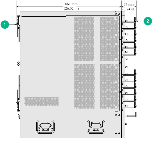

Figure1-5 describes the depth of the SR8804-X, SR8808-X (one fan tray), SR8808-X (two fan trays), and SR8812-X chassis. Figure1-6 describes the depth of the SR8808H-X and SR8816-X chassis.
Figure1-5 SR8812-X chassis depth
(1) Ejector levers of the switching fabric modules
(2) Cable management bracket
