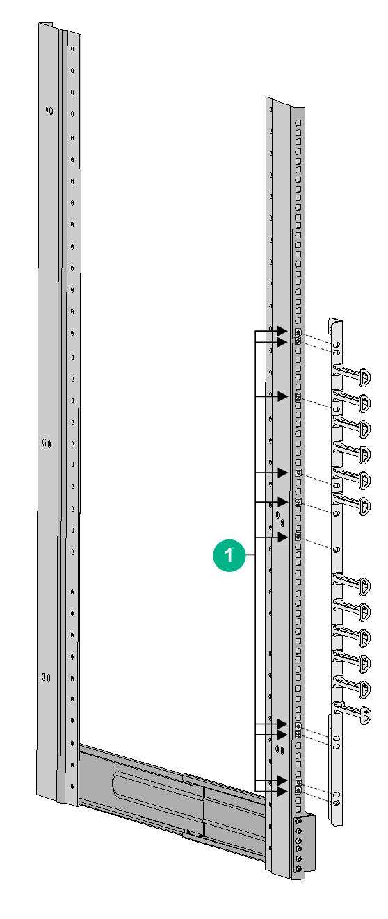

Before mounting the chassis in the rack, attach cage nuts to the front rack posts.
1.     Align the bottom edge of a mounting bracket with the top flange of a slide rail. Then mark the cage nut installation holes on the front rack post.
If the mounting brackets are already installed, you can use a pattern tool to record the installation holes of the mounting brackets and mark the cage nut holes accordingly.
2.     Install cage nuts into the marked square holes on the front rack posts.
Figure2-1 Installing cage nuts (SR8812-X)
(1) Installation holes for cage nuts

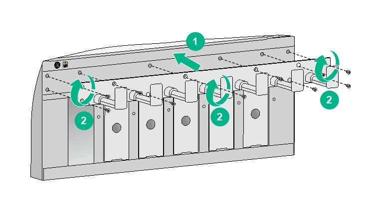

The SR8812-X router comes with the signal cable management brackets attached to the mounting brackets. You need to install the power cord management bracket for the router.
To install the power cord management bracket:
1.     Unpack the power cord management bracket.
2.     Place the power cord management bracket against the chassis and align the mounting holes in the bracket with the installation holes in the chassis.
3.     Use screws to secure the power cord management bracket to the chassis.
Figure2-2 Installing a power cord management bracket

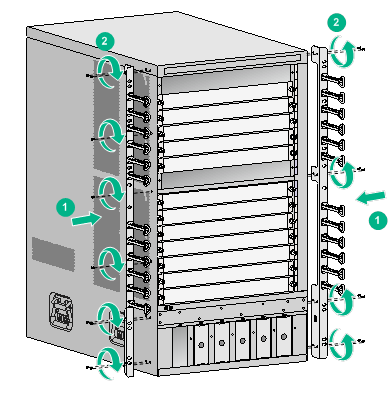

Before installing the router in the rack, attach the mounting brackets to the chassis.
The left and right mounting brackets available for the router are labeled with L and R marks, respectively.
To install the mounting brackets, face the front of the router, and attach the left and right mounting brackets to the two sides of the router, as shown in Figure2-3.
Figure2-3 Installing the mounting brackets

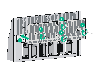

Installing an air filter for an SR8808-X router
1.     Place the air filter over the inlet vents at the front panel bottom, and then align the captive screws on the air filter with the screw holes in the chassis.
2.     Faster the captive screws.
Figure2-4 Installing an air filter

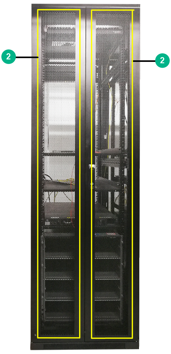

Installing an air filter for the SR8808H-X/SR8816-X

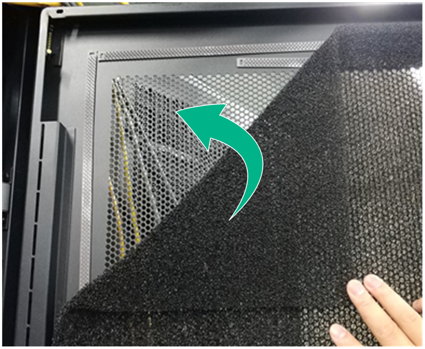

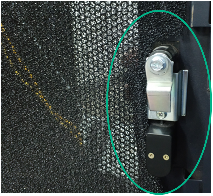

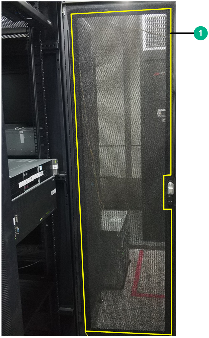

To prevent dust for the SR8808H-X/SR8816-X router, install an air filter on the cabinet. For a cabinet with a double-leaf door, cut the air filter into two halves based on the door size and install the air filter on the two door leaves.
To install an air filter on a cabinet:
1.     As shown in Figure2-5, paste air filter securing strips along the edge of the interior side of the cabinet door at a location 1 to 2 cm (0.39 to 0.79 in) away from the perforation holes. For a large-area single-leaf door, attach more securing strips.
Figure2-5 Attaching air filter securing strips
(1) Securing strip installation position on a single-leaf door
(2) Securing strip installation position on a double-leaf door
2.     Press the air filter onto the securing strips to cover the entire cabinet door.
Figure2-6 Pasting the air filter onto the securing strips
3.     Cut off the excess parts at locations such as the door lock location.
Figure2-7 Cutting off the excess parts
4.     Press the air filter again to ensure that it is attached to the securing strips tightly.

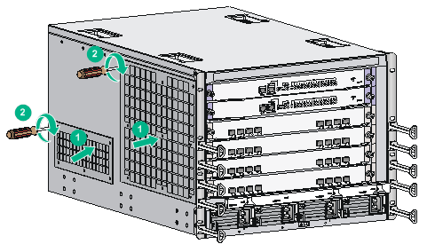

1.     Place the air filter over the inlet vents on the left panel of the chassis, and then align the captive screws on the air filter with the screw holes in the chassis.
2.     Fasten the captive screws.
Figure2-8 Installing an air filter

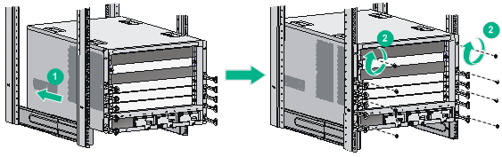

1.     Move the chassis to face the rear of the chassis towards the front of the rack.
2.     Lift the router by using the handles or supporting the bottom of the chassis until the bottom of the router is a little higher than the slide rails on the rack.
3.     Place the router on the slide rails and slide the router along the slide rails until the mounting brackets on the router touch the front rack posts.
4.     Attach the chassis to the rack with mounting screws.
Figure2-9 Installing the chassis in the rack
If the mounting holes in the mounting brackets cannot align with the cage nuts on the rack, verify that the bottom edge of the slide rail aligns with the middle of the narrower metal area between holes and that the cage nuts are installed in the correct holes.

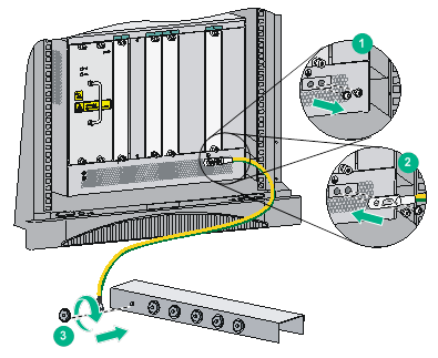

If a grounding strip is available at the installation site, connect the grounding cable through the grounding strip.
To connect the grounding cable:
1.     Unpack the grounding cable.
The grounding cable provided with the router is compliant with the NEBS standards.
2.     Remove the grounding screws from the grounding holes at the rear of the chassis.
3.     Fasten the grounding screws, which are attached with the dual-hole terminals of the grounding cable, into the grounding holes of the chassis.
4.     Connect the ring terminal of the grounding cable to the grounding post of the grounding strip, and fasten the grounding cable to the grounding strip with the hex nut.
Figure2-10 Connecting the grounding cable to a grounding strip

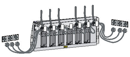

Grounding the router through the PE wire of an AC power supply
CAUTION
CAUTION:
Make sure the AC power supply uses a three-wire cable with a protection wire, and the PE wire of the AC power supply is correctly grounded at the power distribution room or AC power supply transformer side. In addition, make sure the PE connector on the router is correctly connected to the PE wire of the AC power supply.
If the router is AC powered and no grounding strip is available at the installation site, you can ground the router through the PE wire of the AC power supply, as shown in Figure2-11.
Figure2-11 Grounding the router through the PE wire of the AC power supply

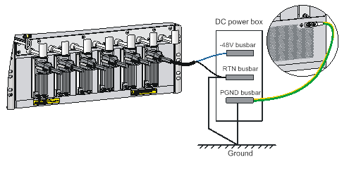

Grounding the router through the RTN wire of a DC power supply
CAUTION
CAUTION:
Make sure the RTN wire is correctly grounded from the DC egress of the DC power cabinet.
If the router is powered by a –48 V DC power supply and no grounding strip is available at the installation site, you can ground the router through the return (RTN) wire of the DC power supply, as shown in Figure2-12.
Figure2-12 Grounding the router through the RTN wire of the DC power supply
