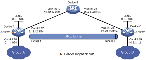

Network requirements
As shown in Figure 1, Group A and Group B are two private IPv4 networks. Device A and Device C will establish a GRE tunnel to interconnect Group 1 and Group 2.
To save IP address space, configure tunnel interface Tunnel 1 to borrow an IP address from the loopback interface loopback 0.
Figure 1 Network diagram

# Verify that the interface Tunnel 1 has borrowed the IP address 8.8.8.8/32 from loopback 0.
[DeviceA] display interface tunnel 1
Tunnel1
Current state: UP
Line protocol state: UP
Description: Tunnel1 Interface
Bandwidth: 64kbps
Maximum Transmit Unit: 1476
Internet Address is 8.8.8.8/32 Unnumbered
Tunnel source 12.12.12.1, destination 23.23.23.3
Tunnel keepalive disabled
Tunnel TTL 255
Tunnel protocol/transport GRE/IP
    GRE key disabled
    Checksumming of GRE packets disabled
Last clearing of counters: Never
Last 300 seconds input rate: 0 bytes/sec, 0 bits/sec, 0 packets/sec
Last 300 seconds output rate: 0 bytes/sec, 0 bits/sec, 0 packets/sec
Input: 11 packets, 924 bytes, 0 drops
Output: 10 packets, 840 bytes, 0 drops
# Verify that VLAN-interface 10 on Device A can ping the IP address of VLAN-interface 10 on Device C.
[DeviceA] ping -a 10.1.1.1 10.2.1.1
Ping 10.2.1.1 (10.2.1.1) from 10.1.1.1: 56 data bytes, press CTRL_C to break
56 bytes from 10.2.1.1: icmp_seq=0 ttl=255 time=32.641 ms
56 bytes from 10.2.1.1: icmp_seq=1 ttl=255 time=4.881 ms
56 bytes from 10.2.1.1: icmp_seq=2 ttl=255 time=4.816 ms
56 bytes from 10.2.1.1: icmp_seq=3 ttl=255 time=26.393 ms
56 bytes from 10.2.1.1: icmp_seq=4 ttl=255 time=43.003 ms
--- Ping statistics for 10.2.1.1 ---
round-trip min/avg/max/std-dev = 4.816/22.347/43.003/15.241 ms
