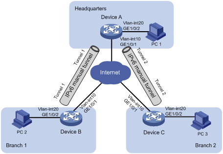

Network requirements
As shown in Figure 1, in IPv6 networks, Device A, Device B, and Device C act as the gateways of the headquarters, Branch 1, and Branch 2, respectively.
Configure IPv6 over IPv4 manual tunnels to ensure that the headquarters can communicate with the two branches over IPv4 networks.
Configure OSPFv3 on the gateways to ensure that the following requirements are met:
·     The gateways have routes to destination IPv6 addresses through tunnel interfaces.
·     Branch 1 and Branch 2 can communicate with each other through the headquarters.
Figure 1 Network diagram

Software version used
This configuration example was created and verified on S7500EX-CMW710-R7168.
For tunnel interfaces to send and receive packets, you must configure a tunnel-type service loopback group.
On the device, a tunneled packet cannot be directly routed based on its destination address. It is sent to a tunnel-type service loopback group, which then delivers the packet to the forwarding module for Layer 3 forwarding.
