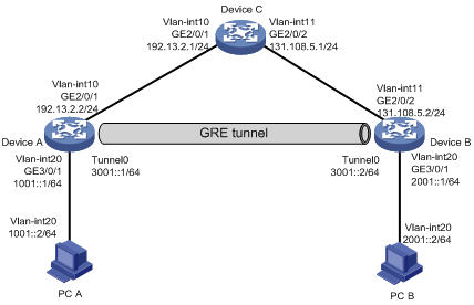

As shown in Figure 1, Device A, Device B, and Device C are all on an IPv4 network. Dual stack devices Device A and Device B each connect to an IPv6 host.
Configure a GRE/IPv4 tunnel between Device A and Device B, so PC A and PC B can communicate with each other over the IPv4 network.
Figure 1 Network diagram
