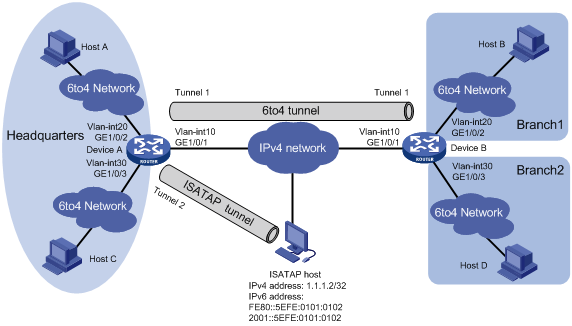

Network requirements
As shown in Figure 1, configure a 6to4 tunnel between Device A and Device B to allow communications between the headquarters and the branches over the IPv4 network.
Configure an ISATAP tunnel between Device A and the ISATAP host to allow the host in the IPv4 network to access the headquarters.
Figure 1 Network diagram
Device
Interface
IP address
Device
Interface
IP address
Device A
Vlan-int10
2.1.1.1/24
Device B
Vlan-int10
3.1.1.1/24
Vlan-int20
2002:0201:0101:1::1/64
Vlan-int20
2002:0301:0101:1::1/64
Vlan-int30
2002:0201:0101:2::1/64
Vlan-int30
2002:0301:0101:2::1/64
Tunnel 1
3001::1/64
Tunnel 1
3001::2/64
Tunnel 2
2001::5EFE:0201:0101/64
