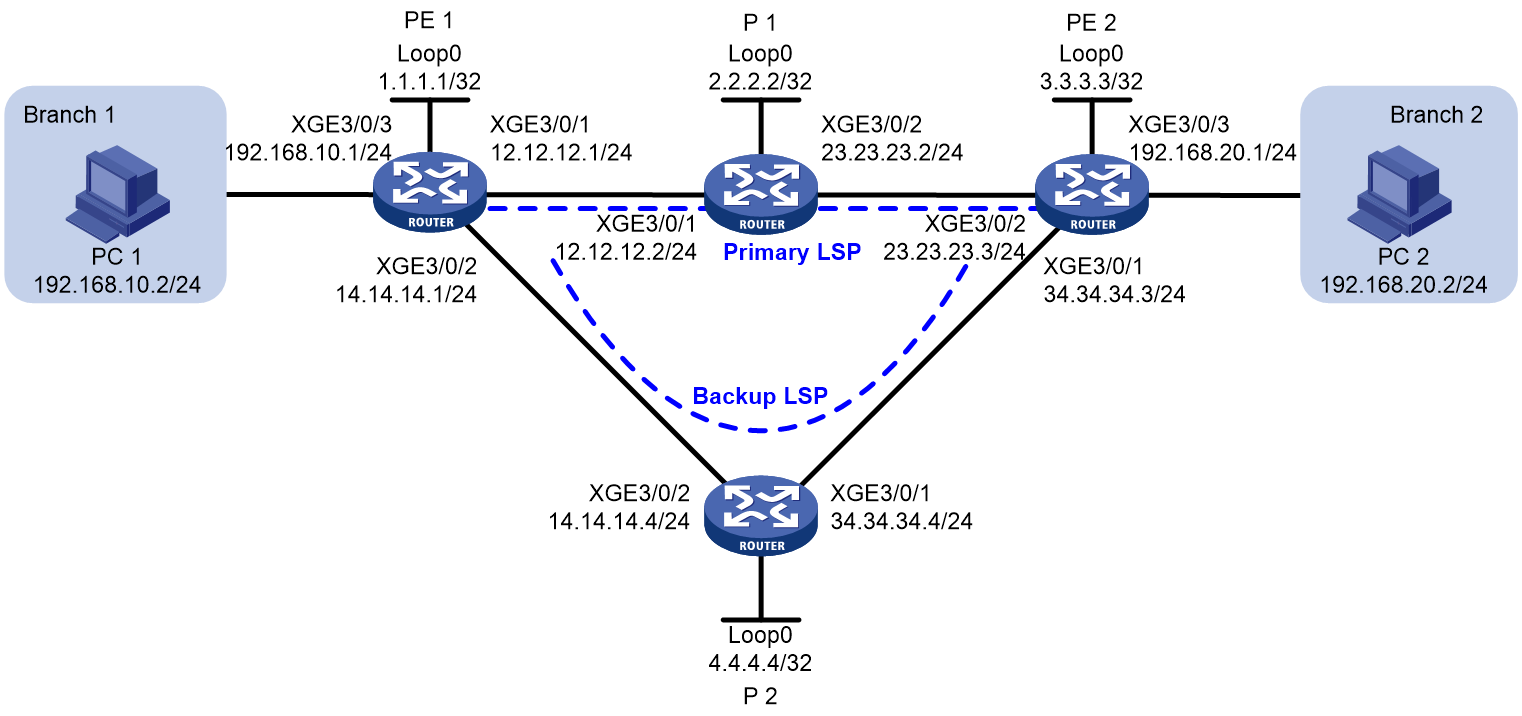

Example: Configuring BFD for an LSP
As shown in Figure 1, Branch 1 and Branch 2 of a company are connected to each other through an MPLS backbone of the ISP. The branches need to exchange real-time data.
To ensure high availability of the real-time service between the branches, deploy LDP FRR on the MPLS backbone to provide a primary LSP and a backup LSP. Configure BFD for the primary LSP, so when the primary LSP fails, BFD can quickly detect the failure and notify LDP of the failure to trigger a traffic switchover to the backup LSP.
Figure 1 Network diagram

  TTL   Replier            Time    Type      Downstream
  0                                Ingress   14.14.14.4/[1133]
  1     14.14.14.4         2 ms    Transit   34.34.34.3/[1141]
  2     34.34.34.3         2 ms    Egress
Configuration files
·     PE 1
ospf 1
 fast-reroute lfa
 area 0.0.0.0
  network 1.1.1.1 0.0.0.0
  network 12.12.12.0 0.0.0.255
  network 14.14.14.0 0.0.0.255
  network 192.168.10.0 0.0.0.255
 mpls lsr-id 1.1.1.1
mpls ldp
 lsp-trigger prefix-list PE1
 mpls bfd enable
interface LoopBack0
 ip address 1.1.1.1 255.255.255.255
interface Ten-GigabitEthernet3/0/1
 port link-mode route
 ip address 12.12.12.1 255.255.255.0
 mpls enable
 mpls ldp enable
interface Ten-GigabitEthernet3/0/2
 ip address 14.14.14.1 255.255.255.0
 mpls enable
 mpls ldp enable
 ip prefix-list PE1 index 10 permit 192.168.10.0 24
 ip prefix-list PE1 index 20 permit 192.168.20.0 24
 ip prefix-list PE1 index 30 permit 1.1.1.1 32
 ip prefix-list PE1 index 40 permit 3.3.3.3 32
 mpls bfd 3.3.3.3 32
·     PE 2
ospf 1
 fast-reroute lfa
 area 0.0.0.0
  network 3.3.3.3 0.0.0.0
  network 23.23.23.0 0.0.0.255
  network 34.34.34.0 0.0.0.255
  network 192.168.20.0 0.0.0.255
 mpls lsr-id 3.3.3.3
mpls ldp
 lsp-trigger prefix-list PE2
 mpls bfd enable
interface LoopBack0
 ip address 3.3.3.3 255.255.255.255
 ip address 34.34.34.3 255.255.255.0
 mpls enable
 mpls ldp enable
 ip address 23.23.23.3 255.255.255.0
 mpls enable
 mpls ldp enable
 ip prefix-list PE2 index 10 permit 192.168.10.0 24
 ip prefix-list PE2 index 20 permit 192.168.20.0 24
 ip prefix-list PE2 index 30 permit 1.1.1.1 32
 ip prefix-list PE2 index 40 permit 3.3.3.3 32
 mpls bfd 1.1.1.1 32
·     P 1
ospf 1
 area 0.0.0.0
  network 2.2.2.2 0.0.0.0
 mpls lsr-id 2.2.2.2
mpls ldp
 lsp-trigger prefix-list P1
interface LoopBack0
 ip address 2.2.2.2 255.255.255.255
 ip address 12.12.12.2 255.255.255.0
 mpls enable
 mpls ldp enable
 ip address 23.23.23.2 255.255.255.0
 mpls enable
 mpls ldp enable
 ip prefix-list P1 index 10 permit 192.168.10.0 24
 ip prefix-list P1 index 20 permit 192.168.20.0 24
 ip prefix-list P1 index 30 permit 1.1.1.1 32
 ip prefix-list P1 index 40 permit 3.3.3.3 32
·     P 2
ospf 1
 area 0.0.0.0
  network 4.4.4.4 0.0.0.0
 mpls lsr-id 4.4.4.4
mpls ldp
 lsp-trigger prefix-list P2
interface LoopBack0
 ip address 4.4.4.4 255.255.255.255
 ip address 34.34.34.4 255.255.255.0
 ospf cost 10
 mpls enable
 mpls ldp enable
 ip address 14.14.14.4 255.255.255.0
 ospf cost 10
 mpls enable
 mpls ldp enable
 ip prefix-list P2 index 10 permit 192.168.10.0 24
 ip prefix-list P2 index 20 permit 192.168.20.0 24
 ip prefix-list P2 index 30 permit 1.1.1.1 32
 ip prefix-list P2 index 40 permit 3.3.3.3 32

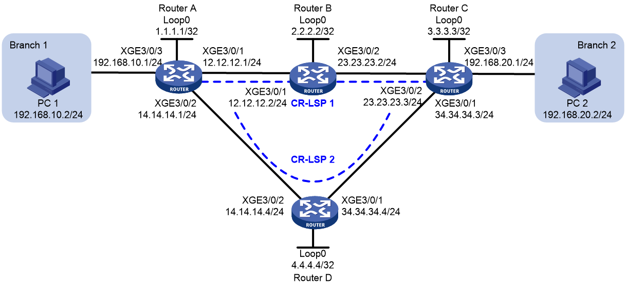

Example: Configuring BFD for an MPLS TE tunnel
As shown in Figure 2, Branch 1 and Branch 2 of a company are connected to each other through an MPLS TE tunnel. The branches need to exchange real-time data.
To ensure high availability of the real-time service between the branches, deploy CRLSP backup for the MPLS TE tunnel to provide a primary CRLSP and a backup CRLSP. Configure BFD for the MPLS TE tunnel, so when the primary CRLSP fails, BFD can quickly detect the failure and notify RSVP of the failure to trigger a traffic switchover to the backup CRLSP.
Figure 2 Network diagram
·     OSPF TE uses Opaque Type 10 LSAs to carry link TE attributes. To configure OSPF TE, you must enable the OSPF Opaque capability. For more information about the OSPF Opaque capability, see OSPF configuration in Layer 3—IP Routing Configuration Guide for the device.
·     MPLS TE cannot reserve resources and allocate labels on OSPF virtual links to establish CRLSPs. To configure OSPF TE, make sure no virtual links exist in OSPF areas.
Procedures
1.     Assign IP addresses to interfaces:
# Assign an IP address to Ten-GigabitEthernet 3/0/1 on Router A.
<RouterA> system-view
[RouterA] interface Ten-GigabitEthernet3/0/1
[RouterA-Ten-GigabitEthernet3/0/1] ip address 12.12.12.1 24
[RouterA-Ten-GigabitEthernet3/0/1] quit
# # Assign IP addresses to other interfaces (including the loopback interfaces) according to Figure 2. (Details not shown.)
2.     Configure an LSR ID, enable MPLS, MPLS TE, and RSVP-TE on the routers:
# Configure Router A.
[RouterA] mpls lsr-id 1.1.1.1
[RouterA] mpls te
[RouterA-te] quit
[RouterA] rsvp
[RouterA-rsvp] quit
[RouterA-Ten-GigabitEthernet3/0/1] mpls enable
[RouterA-Ten-GigabitEthernet3/0/1] mpls te enable
[RouterA-Ten-GigabitEthernet3/0/1] rsvp enable
[RouterA] interface Ten-GigabitEthernet3/0/2
[RouterA-Ten-GigabitEthernet3/0/2] mpls enable
[RouterA-Ten-GigabitEthernet3/0/2] mpls te enable
[RouterA-Ten-GigabitEthernet3/0/2] rsvp enable
[RouterA-Ten-GigabitEthernet3/0/2] quit
# Configure Router B, Router C, and Router D in the same way as you configure Route A. (Details not shown.)
3.     On the MPLS backbone, configure OSPF to ensure IP connectivity between the routers, enable the OSPF Opaque capability, and enable MPLS TE in OSPF area 0:
[RouterA] ospf
[RouterA-ospf-1] opaque-capability enable
[RouterA-ospf-1] area 0
[RouterA-ospf-1-area-0.0.0.0] mpls te enable
[RouterA-ospf-1-area-0.0.0.0] network 1.1.1.1 0.0.0.0
[RouterA-ospf-1-area-0.0.0.0] network 12.12.12.0 0.0.0.255
[RouterA-ospf-1-area-0.0.0.0] network 14.14.14.0 0.0.0.255
[RouterA-ospf-1-area-0.0.0.0] network 192.168.10.0 0.0.0.255
[RouterA-ospf-1-area-0.0.0.0] quit
[RouterA-ospf-1] quit
# Configure Router B.
[RouterB] ospf
[RouterB-ospf-1] opaque-capability enable
[RouterB-ospf-1] area 0
[RouterB-ospf-1-area-0.0.0.0] mpls te enable
[RouterB-ospf-1-area-0.0.0.0] network 2.2.2.2 0.0.0.0
[RouterB-ospf-1-area-0.0.0.0] network 12.12.12.0 0.0.0.255
[RouterB-ospf-1-area-0.0.0.0] network 23.23.23.0 0.0.0.255
[RouterB-ospf-1-area-0.0.0.0] quit
[RouterB-ospf-1] quit
# Configure Router C.
[RouterC] ospf
[RouterC-ospf-1] opaque-capability enable
[RouterC ospf-1] area 0
[RouterC-ospf-1-area-0.0.0.0] mpls te enable
[RouterC-ospf-1-area-0.0.0.0] network 3.3.3.3 0.0.0.0
[RouterC ospf-1-area-0.0.0.0] network 23.23.23.0 0.0.0.255
[RouterC ospf-1-area-0.0.0.0] network 34.34.34..0 0.0.0.255
[RouterC ospf-1-area-0.0.0.0] network 192.168.20.0 0.0.0.255
[RouterC ospf-1-area-0.0.0.0] quit
[RouterC ospf-1] quit
# Configure Router D.
[RouterD] ospf
[RouterD-ospf-1] opaque-capability enable
[RouterD-ospf-1] area 0
[RouterD-ospf-1-area-0.0.0.0] mpls te enable
[RouterD-ospf-1-area-0.0.0.0] network 4.4.4.4 0.0.0.0
[RouterD-ospf-1-area-0.0.0.0] network 14.14.14.0 0.0.0.255
[RouterD-ospf-1-area-0.0.0.0] network 34.34.34.0 0.0.0.255
[RouterD-ospf-1-area-0.0.0.0] quit
[RouterD-ospf-1] quit
4.     Configure the MPLS TE tunnel:
# On Router A, create an MPLS TE tunnel named Tunnel3. Specify the destination address as the LSR ID of Router C (3.3.3.3), specify the signaling protocol as RSVP-TE, and enable CRLSP hot-standby backup for the tunnel.
[RouterA] interface tunnel 3 mode mpls-te
[RouterA-Tunnel3] ip address 9.1.1.1 255.255.255.0
[RouterA-Tunnel3] destination 3.3.3.3
[RouterA-Tunnel3] mpls te signaling rsvp-te
[RouterA-Tunnel3] mpls te backup hot-standby
[RouterA-Tunnel3] quit
# Create explicit paths for the tunnel. Configure CR-LSP 1 as the primary path and CR-LSP 2 as the backup path by setting the preference of CR-LSP 1 to 1 and that of CR-LSP 2 to 2.
[RouterA] explicit-path cr-lsp1
[RouterA-explicit-path-cr-lsp1] nexthop 12.12.12.2
[RouterA-explicit-path-cr-lsp1] quit
[RouterA]explicit-path cr-lsp2
[RouterA-explicit-path-cr-lsp2] nexthop 14.14.14.4
[RouterA-explicit-path-cr-lsp2]quit
[RouterA-Tunnel3] mpls te path preference 1 explicit-path cr-lsp1
[RouterA-Tunnel3] mpls te path preference 2 explicit-path cr-lsp2
# On Router C, create an MPLS TE tunnel named Tunnel3. Specify the destination address as the LSR ID of Router A1.1.1.1), specify the signaling protocol as RSVP-TE, and enable CRLSP hot-standby backup for the tunnel.
[RouterC] interface tunnel 3 mode mpls-te
[RouterC-Tunnel3] ip address 9.3.3.3 255.255.255.0
[RouterC-Tunnel3] destination 1.1.1.1
[RouterC-Tunnel3] mpls te signaling rsvp-te
[RouterC-Tunnel3] mpls te backup hot-standby
[RouterC-Tunnel3] quit
[RouterC] explicit-path cr-lsp1
[RouterC-explicit-path-cr-lsp1] nexthop 23.23.23.2
[RouterC-explicit-path-cr-lsp1] quit
[RouterC]explicit-path cr-lsp2
[RouterC-explicit-path-cr-lsp2] nexthop 34.34.34.4
[RouterC-explicit-path-cr-lsp2]quit
[RouterC-Tunnel3] mpls te path preference 1 explicit-path cr-lsp1
[RouterC-Tunnel3] mpls te path preference 2 explicit-path cr-lsp2
5.     Configure a static route to direct traffic to the MPLS TE tunnel:
# On Router A, configure a static route to direct traffic destined for 192.168.20.0/24 to MPLS TE tunnel interface Tunnel3.
[RouterA] ip route-static 192.168.20.0 24 tunnel 3 preference 1
# On Router C, configure a static route to direct traffic destined for 192.168.10.0/24 to MPLS TE tunnel interface Tunnel3.
[RouterC] ip route-static 192.168.10.0 24 tunnel 3 preference 1
6.     Enable BFD for MPLS, and configure BFD to verify connectivity of the MPLS TE tunnel:
[RouterA] mpls bfd enable
[RouterA-Tunnel3] mpls bfd
[RouterC] mpls bfd enable
[RouterC-Tunnel3] mpls bfd
1.     Verify that the MPLS TE tunnel has been established successfully:
# On Router A and Router C, execute the display interface tunnel command. The output shows that the tunnel state is UP. Take Router A as an example:
<RouterA> display interface tunnel
Tunnel3
Interface index: 17796
Current state: UP
Line protocol state: UP
Description: Tunnel3 Interface
Bandwidth: 64kbps
Maximum Transmit Unit: 1496
Internet Address is 9.1.1.1/24 Primary
Tunnel source unknown, destination 3.3.3.3
Tunnel TTL 255
Tunnel protocol/transport CR_LSP
Last clearing of counters: Never
Last 300 seconds input rate: 0 bytes/sec, 0 bits/sec, 0 packets/sec
Last 300 seconds output rate: 0 bytes/sec, 0 bits/sec, 0 packets/sec
Input: 0 packets, 0 bytes, 0 drops
Output: 0 packets, 0 bytes, 0 drops
2.     On Router A, execute the tracert mpls te command to verify that the current path in use is CR-LSP1. (To use the tracert feature, you must also enable sending of ICMP time exceeded messages on the transit devices and enable sending of ICMP destination unreachable messages on the destination device.)
<RouterA>tracert mpls te Tunnel 3
MPLS trace route TE tunnel Tunnel3
  0                                Ingress   12.12.12.2/[1140]
  1     12.12.12.2         30 ms   Transit   23.23.23.3/[3]
  2     23.23.23.3         2 ms    Egress
3.     On Router A, execute the display mpls bfd command. The output shows that two BFD sessions have been created for the MPLS TE tunnel. The session for the primary CRLSP is up and that for the backup CRLSP is down. Take Router A as an example:
<RouterA>display mpls bfd te tunnel 3
 Total number of sessions: 2, 1 up, 1 down, 0 init
 FEC Type: TE Tunnel
 FEC Info:
   Send Addr: 1.1.1.1
   End  Addr: 3.3.3.3
   Tunnel ID: 3
   LSP ID   : 1150
 NHLFE ID: 1045
 Local Discr: 1026                   Remote Discr: -
 Source IP: 1.1.1.1                  Destination IP: 127.0.0.2
 Session State: Down                 Session Role: Passive
 Template Name: -
 FEC Type: TE Tunnel
 FEC Info:
   Send Addr: 1.1.1.1
   End  Addr: 3.3.3.3
   Tunnel ID: 3
   LSP ID   : 1151
 NHLFE ID: 1047
 Local Discr: 1027                   Remote Discr: 515
 Source IP: 1.1.1.1                  Destination IP: 127.0.0.1
 Session State: Up                   Session Role: Passive
 Template Name: -
4.     Continuously ping Router C from Router A. During this period, shut down Ten-GigabitEthernet 3/0/1 of Router B. Verify the communication between Router A and Router C.
# Continuously ping Router C from Router A.
<RouterA>ping -c 10000 -a 192.168.10.1 192.168.20.1
Ping 192.168.20.1 (192.168.20.1) from 192.168.10.1: 56 data bytes, press CTRL_C
to break
56 bytes from 192.168.20.1: icmp_seq=0 ttl=254 time=3.443 ms
56 bytes from 192.168.20.1: icmp_seq=1 ttl=254 time=2.835 ms
# Shut down Ten-GigabitEthernet 3/0/1 of Router B.
[RouterB] interface Ten-GigabitEthernet3/0/1
[RouterB-Ten-GigabitEthernet3/0/1] shutdown
# You can see that Router A and Router C resumed connectivity quickly after a short period of disconnection.
to break
56 bytes from 192.168.20.1: icmp_seq=22 ttl=254 time=3.503 ms
Request time out
56 bytes from 192.168.20.1: icmp_seq=24 ttl=254 time=2.434 ms
56 bytes from 192.168.20.1: icmp_seq=25 ttl=254 time=3.196 ms
56 bytes from 192.168.20.1: icmp_seq=26 ttl=254 time=3.592 ms
56 bytes from 192.168.20.1: icmp_seq=27 ttl=254 time=2.305 ms
56 bytes from 192.168.20.1: icmp_seq=28 ttl=254 time=2.139 ms
--- Ping statistics for 192.168.20.1 ---
29 packet(s) transmitted, 28 packet(s) received, 3.4% packet loss
round-trip min/avg/max/std-dev = 2.076/2.701/3.921/0.609 ms
5.     Test whether a switchover has happened:
# On Router A, execute the tracert mpls te command. You can see the currently used path of the tunnel is CR-LSP2.
  0                                Ingress   14.14.14.4/[1142]
  1     14.14.14.4         198 ms  Transit   34.34.34.3/[3]
  2     34.34.34.3         7 ms    Egress
# On Router A, execute the display mpls bfd command. The output shows that a BFD session exists for the CR-LSP2 path of the tunnel and the session state is up.
 Total number of sessions: 1, 1 up, 0 down, 0 init

Configuration files
·     Router A:
ospf 1
 area 0.0.0.0
  mpls te enable
 mpls lsr-id 1.1.1.1
mpls te
 nexthop index 1 12.12.12.2 include strict
 nexthop index 1 14.14.14.4 include strict
rsvp
 mpls bfd enable
interface LoopBack0
 mpls enable
 mpls te enable
 rsvp enable
 mpls enable
 mpls te enable
 rsvp enable
interface Ten-GigabitEthernet3/0/3
 ip address 192.168.10.1 255.255.255.0
interface Tunnel3 mode mpls-te
 mpls bfd
 destination 3.3.3.3
 ip route-static 192.168.20.0 24 Tunnel3 preference 1
·     Router B:
ospf 1
 area 0.0.0.0
  mpls te enable
 mpls lsr-id 2.2.2.2
mpls te
rsvp
interface LoopBack0
 mpls enable
 mpls te enable
 rsvp enable
 mpls enable
 mpls te enable
 rsvp enable
·     Router C:
ospf 1
 area 0.0.0.0
  mpls te enable
 mpls lsr-id 3.3.3.3
mpls te
 nexthop index 1 23.23.23.2 include strict
 nexthop index 1 34.34.34.4 include strict
rsvp
 mpls bfd enable
interface LoopBack0
 mpls enable
 mpls te enable
 rsvp enable
 mpls enable
 mpls te enable
 rsvp enable
 ip address 192.168.20.1 255.255.255.0
 mpls bfd
 destination 1.1.1.1
 ip route-static 192.168.10.0 24 Tunnel3 preference 1
·     Router D:
ospf 1
 area 0.0.0.0
  mpls te enable
 mpls lsr-id 4.4.4.4
mpls te
rsvp
interface LoopBack0
 mpls enable
 mpls te enable
 rsvp enable
 mpls enable
 mpls te enable
 rsvp enable
