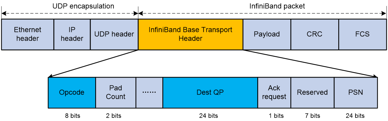

IPCC takes effect only on RoCEv2 packets. RoCEv2 uses UDP encapsulation. Figure 1 shows the RoCEv2 packet format.
Figure 1 RoCEv2 packet format
·     Ethernet header—Contains source and destination MAC addresses.
·     IP header—Contains source and destination IP addresses.
·     UDP header—Contains source and destination port numbers. The destination port number of RoCEv2 packets is 4791.
·     Payload—Message payload.
·     CRCCyclic redundancy check.
·     FCS—Frame check sequence.
·     InfiniBand Base Transport Header—Contains key information about an RoCEv2 packet. IPCC is related to the following fields:
¡     Opcode—Indicates the RoCEv2 packet type, which can be one of the following:
-     ConnectMsg—Communication management (CM) connection setup packet. The packet is used for RoCEv2 connection setup. The sender and receiver use the RoCEv2 connection to exchange data packets.
-     Send—Send packet. The sender uses the packet to request data from the receiver, without specifying the address where the receiver stores data.
-     Write—Write packet. The packet carries the address, key, and length of data to be written to the receiver.
-     Read—Read packet. The packet carries the address, key, and length of data to be read from the receiver.
-     ACK—ACK packet. The packet is a response message returned by the receiver.
The Send, Write, and Read RoCEv2 packets are RoCEv2 data packets.
¡     Dest QP—Destination Queue Pair (QP), identifying an RoCEv2 flow. This field is similar to the destination port number. It is a key value for setting up an RoCEv2 flow table.

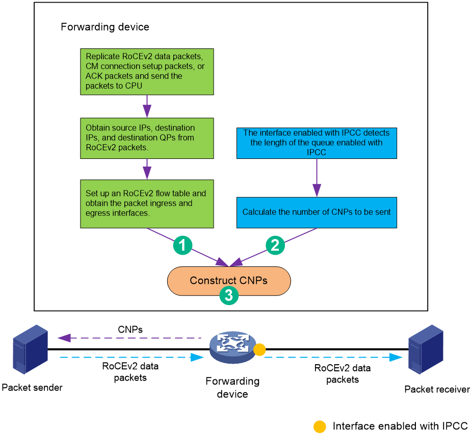

As shown in Figure 2, IPCC works as follows:
1.     Set up an RoCEv2 flow table.
After you enable IPCC for an interface on the forwarding device, the interface replicates RoCEv2 data packets passing the interface and sends the packets to the CPU. The CPU processes the packets as follows:
a.     Generates an RoCEv2 flow table based on the quadruple information (client IP, server IP, client QP, and server QP) in the RoCEv2 connection setup packets.
b.     Associates the RoCEv2 flow table with the interface based on the RoCEv2 data packets.
By maintaining the RoCEv2 flow table, the forwarding device can obtain address and forwarding path information about each RoCEv2 flow.
2.     Calculate the number of CNPs to be sent.
After you enable IPCC for a queue on the interface, the forwarding device monitors the length of the queue and calculates the number of CNPs to be sent as follows:
¡     When the length of the queue increases, the forwarding device needs to send a small number of CNPs if the cache usage of the queue is low. If the cache usage of the queue is high, the forwarding device needs to send a large number of CNPs to reduce queue congestion and forwarding latency.
¡     When the length of the queue decreases, the forwarding device does not need to send CNPs if the cache usage of the queue is low. If the cache usage of the queue is high, the forwarding device needs to send a small number of CNPs to reduce queue congestion while ensuring throughput and latency performance.
3.     Construct and send CNPs.
The forwarding device constructs CNPs based on the calculated number and address information in the RoCEv2 flow table and sends the CNPs to the sender. Then, the sender reduces the RoCEv2 packet sending rate.
Figure 2 IPCC mechanism

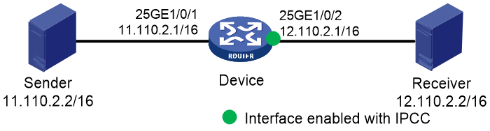

As shown in Figure 3, the sender is deployed with storage services carried by RoCEv2. Enable IPCC on interface Twenty-FiveGigE1/0/2 on Device to control the RoCEv2 packet sending rate of the sender, ensuring low latency and high throughput for the RoCEv2 service.
Figure 3 Network diagram
1.     Configure IP addresses and subnet masks for the interfaces, as shown in Figure 3. (Details not shown.)
2.     Configure IPCC:
# Enable IPCC.
<Device> system-view
[Device] interface twenty-fivegige 1/0/2
[Device-Twenty-FiveGigE1/0/2] ipcc enable
[Device-Twenty-FiveGigE1/0/2] quit
# Enable IPCC for queue 4.
[Device] ipcc queue 4
# Configure IPCC to operate in low latency mode.
[Device] ipcc mode low-latency
# View statistics of CNPs that are proactively sent by the device.
<Device> display ipcc statistics
Total statistics:
 RoCEv2 flow entries: 1
Interface statistics of 25GE1/0/2
 CNP number: 3
 Flow information:
 DIP              SIP              DQP
 12.110.2.2       11.110.2.2       2090
