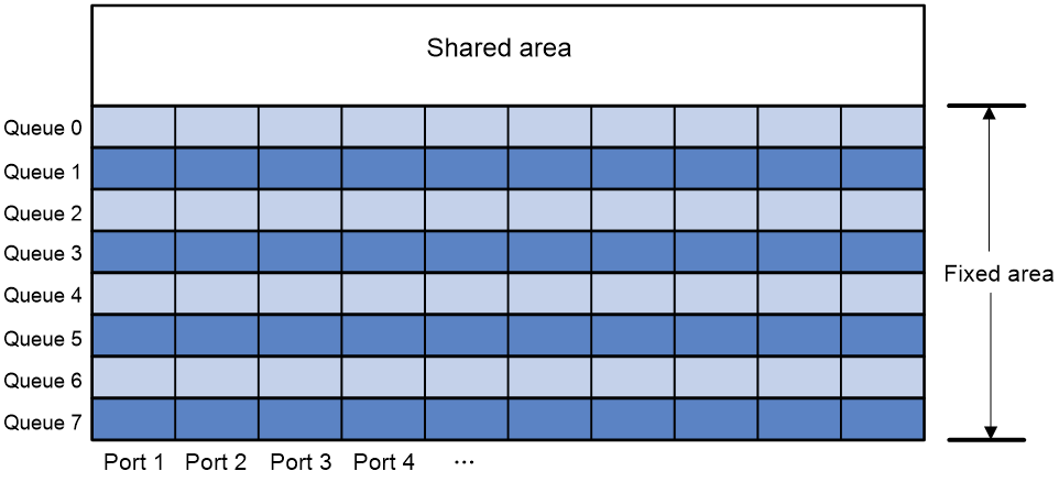

Fixed area and shared area
Each type of resources has a fixed area and a shared area.
·     Fixed area—Partitioned into queues, each of which is equally divided by all the interfaces on a card, as shown in Figure 2. When congestion occurs or the CPU is busy, the following rules apply:
a.     An interface first uses the relevant queues of the fixed area to store packets.
b.     When a queue is full, the interface uses the corresponding queue of the shared area.
c.     When the queue in the shared area is also full, the interface discards subsequent packets.
The system allocates the fixed area among queues as specified by the user. Even if a queue is not full, other queues cannot preempt its space. Similarly, the share of a queue for an interface cannot be preempted by other interfaces even if it is not full.
·     Shared area—Partitioned into queues, each of which is not equally divided by the interfaces, as shown in Figure 2. The system determines the actual shared-area space for each queue according to user configuration and the number of packets actually received and sent. If a queue is not full, other queues can preempt its space.
The system puts packets received or sent on all interfaces into a queue in the order they arrive. When the queue is full, subsequent packets are dropped.
Figure 2 Fixed area and shared area

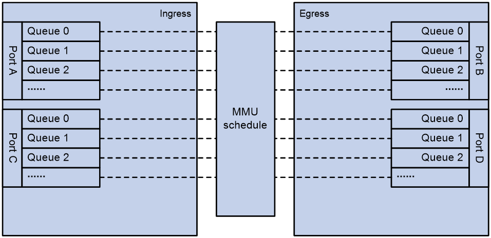

The Transient Capture Buffer (TCB) feature monitors packet drop events on a set of memory management unit (MMU) resources. When a packet is dropped on a queue, the system collects drop time, drop reason, packet metadata, and other information and reports them to an NMS through gRPC.
An MMU manages the allocation of the ingress buffer and egress buffer and flexibly schedules queues to deal with traffic bursts.
Figure 3 MMU queues

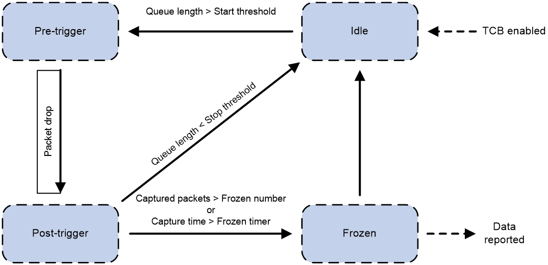

How TBC works
The TCB state machine works as follows:
1.     The state machine enters the idle state when TCB is enabled.
2.     When the queue length is greater than start-threshold-value, the state machine transitions from the idle state to the pre-trigger state. The system captures packets by using the pre-sample-rate.
3.     When packet drops occur on the queue, the state machine transitions from the pre-trigger to the post-trigger state.
4.     When the queue length is smaller than stop-threshold-value, the state machine transitions from the post-trigger to the idle state. The system stops capturing packets.
5.     When the queue length is greater than start-threshold-value, step 2 is repeated.
6.     When the number of captured packets reaches the frozen-number or the capture timer expires, the state machine transitions from the post-trigger to the frozen state.
7.     The state machine analyzes the drop reason and dropped packet characteristics and sends the analysis results to the gRPC module, which reports them to an NMS.
8.     The state machine transitions from the frozen to the idle state.
Figure 4 TCB state machine

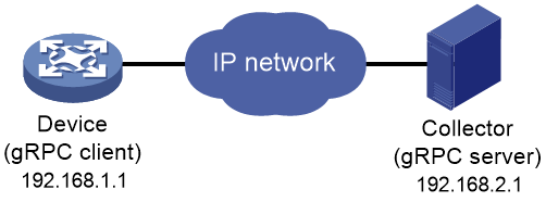

TCB configuration examples
Example: Configuring TCB on an interface
As shown in Figure 5, configure TCB and gRPC on the device to monitor packet drops and report packet drop information to the collector through gRPC.
Figure 5 Network diagram
1.     Assign IP addresses to the device and the collector and configure routes. Make sure the network connections are available. (Details not shown.)
2.     Configure TCB:
# Create an IPv4 advanced ACL numbered 3001, and configure a rule to match packets with source IP address 192.168.5.2.
<Device> system-view
[Device] acl advanced 3001
[Device-acl-ipv4-adv-3001] rule permit ip source 192.168.5.2 0
[Device-acl-ipv4-adv-3001] quit
# Configure TCB on GigabitEthernet 1/0/1.
[Device-GigabitEthernet1/0/1] buffer transient-capture egress queue 1 enable no-local-analysis acl 3001
3.     Configure gRPC:
# Enable the gRPC service.
[Device] grpc enable
# Create a sensor group named test, and add sensor paths tcb/tcbpacketinfoevent and tcb/tcbrawpacketinfoevent.
[Device] telemetry
[Device-telemetry] sensor-group test
[Device-telemetry-sensor-group-test] sensor path tcb/tcbpacketinfoevent
[Device-telemetry-sensor-group-test] sensor path tcb/tcbrawpacketinfoevent
[Device-telemetry-sensor-group-test] quit
# Create a destination group named collector1. Specify a collector that uses IPv4 address 192.168.2.1 and port number 50050.
[Device-telemetry] destination-group collector1
[Device-telemetry-destination-group-collector1] ipv4-address 192.168.2.1 port 50050
[Device-telemetry-destination-group-collector1] quit
# Configure a subscription named A to bind sensor group test with destination group collector1. Set the sampling interval to 10 seconds.
[Device-telemetry] subscription A
[Device-telemetry-subscription-A] sensor-group test sample-interval 10
[Device-telemetry-subscription-A] destination-group collector1
[Device-telemetry-subscription-A] quit
[Device-telemetry] quit
# Verify that the collector receives packet drop information when packet drops occur on a queue enabled with TCB. (Details not shown.)
