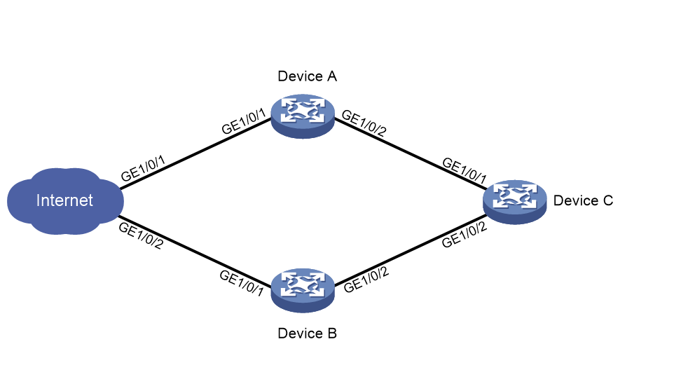

Example: Configuring GIR in an ECMP-based node redundancy environment
As shown in Figure 1, Device A and Device B have ECMP routes for traffic between Internet and Device C. Before upgrading Device A, use GIR to place it in maintenance mode to prevent packet losses during upgrade. Then, change Device A back to normal mode after its software is upgraded.
Figure 1 Network diagram
1.     Configure IP addresses and a unicast routing protocol (for example, OSPF). Make sure ECMP routes are available for traffic between the Internet and Device C to traverse Device A or Device B to reach the destination. (Details not shown.)
2.     Isolate Device A from the network before you upgrade it.
# Change Device A from the normal mode to the maintenance mode.

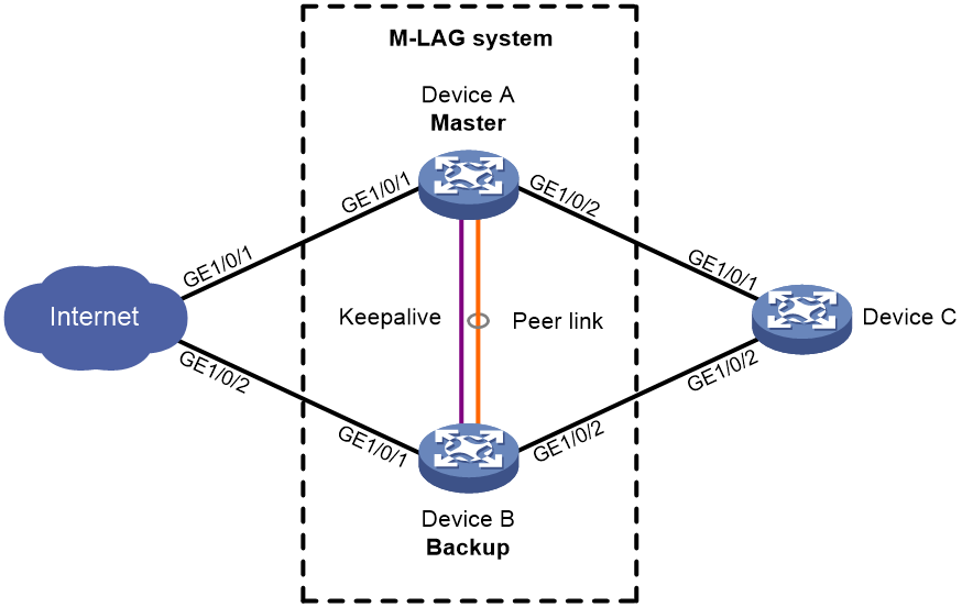

Example: Configuring GIR on an M-LAG system
As shown in Figure 2, Device A and Device B form an M-LAG system.
Use the following method to upgrade the M-LAG system to prevent packet loss during the upgrade:
1.     Upgrade Device B.
2.     Perform a forward switching operation by using the isolate method on Device A.
3.     Upgrade Device A.
Figure 2 Network diagram
