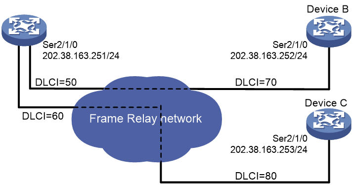

As shown in Figure 1:
·     A Frame Relay network provides data communications between user devices such as routers and hosts. The user devices are also called data terminal equipment (DTE).
·     The devices that provide access to the Frame Relay network for DTEs are called data circuit-terminating equipment (DCE).
Frame Relay interfaces include the following types:
·     User-to-network interface (UNI)—A DCE is connected to a DTE through UNI interfaces. UNI interfaces include the following types:
¡     DTE interface—The UNI interface on the DTE side.
¡     DCE interface—The UNI interface on the DCE side.
·     Network-to-network interface (NNI)—A DCE is connected to a Frame Relay switch in the Frame Relay network through an NNI interface. The switches in the Frame Relay network are interconnected with NNI interfaces.
A DTE interface can connect only to a DCE interface, and an NNI interface can connect only to an NNI interface. On a Frame Relay switch, the Frame Relay interface type must be NNI or DCE.
·     Device B and Device C form a simple Frame Relay network.
·     DTE devices Device A and Device D are attached to the network.
The interface type DTE or DCE is identified only for the UNI interfaces. A virtual circuit between two DTE devices can be assigned different DLCIs on different segments.
Figure 1 Frame Relay network

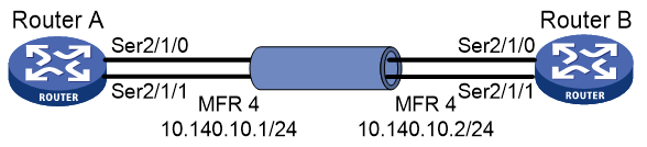

Typically, Frame Relay is used for Frame Relay access. Frame Relay access encapsulates upper-layer packets on a user device by using Frame Relay and connects the user device to a Frame Relay network.
With Frame Relay, you can construct a public or private network as shown in Figure 2 and construct direct connections between data devices as shown in Figure 3.
Figure 2 Interconnecting LANs through a Frame Relay network
Figure 3 Interconnecting LANs through a dedicated line

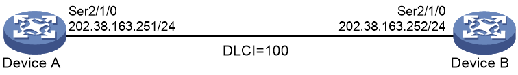

As shown in Figure 4, configure Frame Relay so that Router A and Router B can communicate.
Figure 4 Network diagram
(Method 1) Using main interfaces:
1.     Configure Router A:
# Assign an IP address to Serial 2/1/0.
<RouterA> system-view
[RouterA] interface serial 2/1/0
[RouterA-Serial2/1/0] ip address 202.38.163.251 255.255.255.0
# Enable Frame Relay encapsulation on the interface.
[RouterA-Serial2/1/0] link-protocol fr
# Set the type of the interface to DCE.
[RouterA-Serial2/1/0] fr interface-type dce
# Configure a local virtual circuit.
[RouterA-Serial2/1/0] fr dlci 100
2.     Configure Router B:
<RouterB> system-view
[RouterB] interface serial 2/1/0
[RouterB-Serial2/1/0] ip address 202.38.163.252 255.255.255.0
[RouterB-Serial2/1/0] link-protocol fr
# Set the type of the interface to DTE.
[RouterB-Serial2/1/0] fr interface-type dte
[RouterB-Serial2/1/0] quit
(Method 2) Using subinterfaces:
# Enable Frame Relay encapsulation on Serial 2/1/0.
# Set the type of Serial 2/1/0 to DCE.
[RouterA-Serial2/1/0] quit
# Create a subinterface named Serial 2/1/0.1.
[RouterA] interface serial 2/1/0.1 p2p
# Configure the IP address and create a virtual circuit for Serial 2/1/0.1.
[RouterA-Serial2/1/0.1] ip address 202.38.163.251 255.255.255.0
[RouterA-Serial2/1/0.1] fr dlci 100
# Set the type of Serial 2/1/0 to DTE.
[RouterB] interface serial 2/1/0.1 p2p
[RouterB-Serial2/1/0.1] ip address 202.38.163.252 255.255.255.0
[RouterB-Serial2/1/0.1] fr dlci 100
[RouterB-Serial2/1/0.1] quit
This section verifies the configuration used in method 1.
# On Router B, verify that the PVC is active.
[RouterB] display fr pvc
PVC information for interface Serial2/1/0 (DTE, physically up)
  DLCI: 100  Type: Dynamic  Interface: Serial2/1/0
    Encapsulation: IETF  Broadcast
    Creation time: 2014/02/19 01:38:00  Status: Active
    Input: 2 packets, 60 bytes, 0 dropped
    Output: 2 packets, 60 bytes, 0 dropped
# Verify that Router A and Router B can ping each other.
[RouterB] ping 202.38.163.251
Ping 202.38.163.251 (202.38.163.251): 56 data bytes, press CTRL_C to break
56 bytes from 202.38.163.251: icmp_seq=0 ttl=255 time=76.007 ms
56 bytes from 202.38.163.251: icmp_seq=1 ttl=255 time=8.790 ms
56 bytes from 202.38.163.251: icmp_seq=2 ttl=255 time=1.630 ms
56 bytes from 202.38.163.251: icmp_seq=3 ttl=255 time=0.841 ms
56 bytes from 202.38.163.251: icmp_seq=4 ttl=255 time=1.012 ms
--- Ping statistics for 202.38.163.251 ---
5 packets transmitted, 5 packets received, 0.0% packet loss
round-trip min/avg/max/std-dev = 0.841/17.656/76.007/29.326 ms

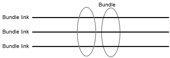

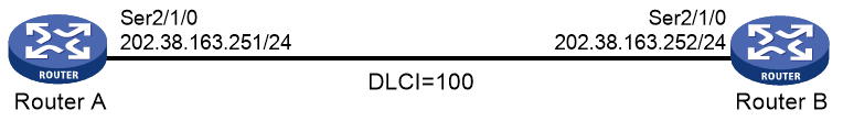

Multilink Frame Relay (MFR) is a cost-effective bandwidth solution that is based on Frame Relay Forum Multilink Frame Relay UNI/NNI Implementation Agreement (FRF.16.1). This feature increases bandwidth by bundling multiple physical links into a logical link.
MFR uses the following concepts:
·     Bundle—A virtual interface formed by combining multiple physical interfaces. A bundle corresponds to an MFR interface. A bundle is visible to the data link layer.
·     Bundle link—Corresponds to a physical interface. A bundle contains and manages multiple bundle links, as shown in Figure 5. Bundle links are visible to the physical layer.
Figure 5 Bundle and bundle links
After a bundle is formed, its bundle links periodically send hello messages to maintain link status. If a bundle link fails to receive a hell acknowledgment after it resends hell messages for the specified maximum number of times, the bundle link is considered to be down at the link layer.
MFR interfaces support DTE and DCE interface types and QoS queuing mechanisms. Physical interfaces bundled into an MFR interface use the data link and network parameter settings of the MFR interface. Their original parameters settings do not work.

As shown in Figure 6, use MFR to bind the physical links between Router A and Router B into a logical link with higher bandwidth than each physical link.
Figure 6 Network diagram
# Create an interface named MFR 4, and assign an IP address to the interface.
[RouterA] interface mfr 4
[RouterA-MFR4] ip address 10.140.10.1 255.255.255.0
[RouterA-MFR4] fr interface-type dte
# Configure a static Frame Relay address-to-DLCI mapping for the interface.
[RouterA-MFR4] fr map ip 10.140.10.2 100
[RouterA-MFR4] quit
# Bind Serial 2/1/0 and Serial 2/1/1 to MFR 4.
[RouterA-Serial2/1/0] link-protocol mfr
[RouterA-Serial2/1/0] fr mfr mfr4
[RouterA] interface serial 2/1/1
[RouterA-Serial2/1/1] link-protocol mfr
[RouterA-Serial2/1/1] fr mfr mfr4
[RouterA-Serial2/1/1] quit
[RouterB] interface mfr 4
[RouterB-MFR4] ip address 10.140.10.2 255.255.255.0
[RouterB-MFR4] fr interface-type dce
# Create a virtual circuit for the interface.
[RouterB-MFR4] fr dlci 100
[RouterB-MFR4-fr-dlci-100] quit
[RouterB-MFR4] fr map ip 10.140.10.1 100
[RouterB-MFR4] quit
