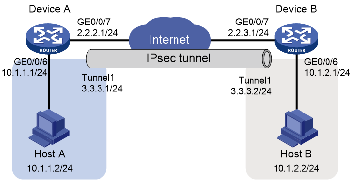

Symptom
As shown in Figure 1, an IKE-based IPsec tunnel needs to be established between Device A and Device B to protect the private network traffic between Host A and Host B. The encapsulation mode for the IPsec tunnel is the tunnel mode. After completing the configuration on Device A and Device B, traffic fails to be forwarded between Host A and Host B.
After you execute the display ike sa command on Device A, no information is displayed, which indicates that the phase-1 IKE negotiation was unsuccessful. RD is displayed in the Flag field after you execute the display ike sa command and no information is displayed after you execute the display ipsec sa command. This indicates that the phase-2 IKE negotiation was also unsuccessful.

Figure 1 Network diagram

1.     Check whether the IPsec gateways can ping each other:
Use the ping command to check the network connectivity.
a.     If the ping is unsuccessful, continue troubleshooting according to the procedures for troubleshooting ping failures in Troubleshooting Layer 3—IP Services. Make sure Host A and Host B can ping their respective IPsec gateways, and the IPsec gateways can ping each other.
b.     If the issue persists, go to step 2.
2.     Check whether the IPsec profile configurations are correct:
a.     Execute the display ipsec profile command to check whether the configurations on the local IPsec gateway Device A and the peer IPsec gateway Device B are complete. Verify that both transform set and IKE profile have been configured on each device. Make sure security proposals with the same encryption algorithm, authentication algorithm, and PFS are configured on the devices.
