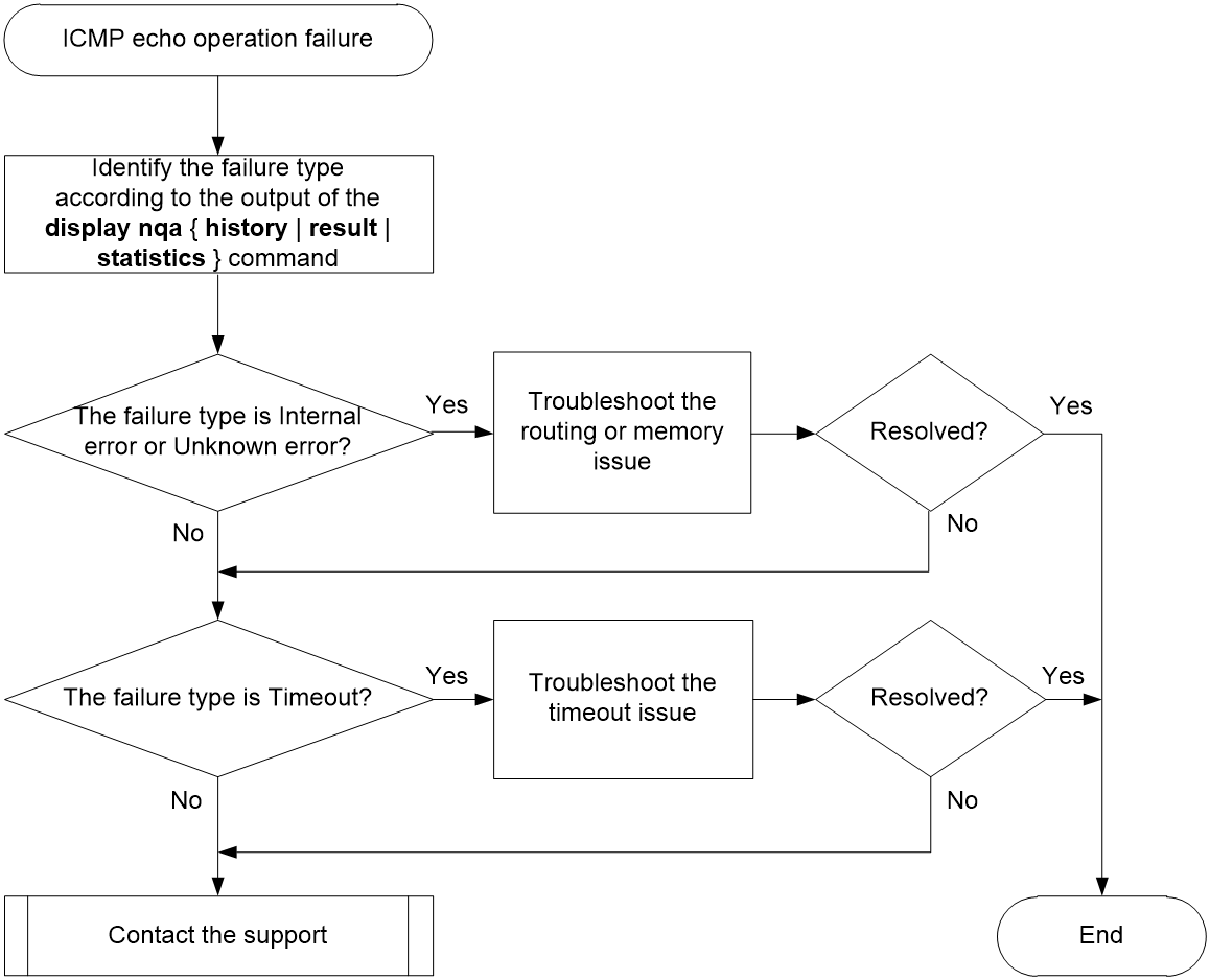

Troubleshooting flow
Figure 1 shows the troubleshooting flowchart.
Figure 1 Flowchart for troubleshooting ICMP echo operation failure
Solution
1.     Execute the display nqa { history | result | statistics } command to view the NQA operation results. Identify the failed NQA operation, its execution time, and the failure type.
¡     If the value of the Status field in the output of the display nqa history command is not Succeeded, it indicates that the NQA operation fails.
<Sysname> display nqa history admin test
NQA entry (admin admin, tag test) history records:
Index      Response     Status           Time
10         500          Timeout          2023-03-12 17:03:01.6
9          500          Timeout          2023-03-12 17:03:01.1
Available values for the Status field include:
-     Succeeded.
-     Internal error. (This state does not trigger the Track state change in NQA-Track collaboration.)
-     Unknown error. (This state triggers the Track state change in NQA-Track collaboration.)
-     Timeout. (This state triggers the Track state change in NQA-Track collaboration.)
¡     If the values in the Extended results area in the output of the display nqa result command are not 0, it indicates that the most recent NQA operation fails.
<Sysname> display nqa result admin test
NQA entry (admin admin, tag test) test results:
    Send operation times: 1              Receive response times: 1
    Min/Max/Average round trip time: 35/35/35
    Square-Sum of round trip time: 1225
    Last succeeded probe time: 2023-03-12 10:50:33.2
  Extended results:
    Packet loss ratio: 0%
    Failures due to timeout: 0
    Failures due to disconnect: 0
    Failures due to no connection: 0
    Failures due to internal error: 0
    Failures due to other errors: 0
¡     If the values in the Extended results area in the output of the display nqa statistics command are not 0, it indicates that a performed NQA operation fails.
<Sysname> display nqa statistics admin test
NQA entry (admin admin, tag test) test statistics:
  NO. : 1
    Start time: 2023-03-12 09:30:20.0
    Life time: 2 seconds
    Min/Max/Average round trip time: 13/13/13
    Square-Sum of round trip time: 169
  Extended results:
¡     If the time displayed in the output of the display nqa { history | result | statistics } command is not as expected, the NQA operation you configured might not have started. Execute the nqa schedule command to start the NQA operation.
2.     To resolve an NQA operation failure due to internal errors or unknown errors, perform the following tasks:
a.     Identify the destination address of the NQA operation.
Execute the display current-configuration [ configuration nqa ] command to view NQA configuration. The destination ip or destination ipv6 field in the output displays the destination address of the NQA operation. If the destination address is incorrect, execute the undo nqa schedule command in system view to stop the NQA operation. Then, execute the destination ip or destination ipv6 command in NQA operation view to edit the destination address before you restart the operation.
b.     Execute the ping command to ping the destination address of the NQA operation. If the address cannot be pinged, resolve the unreachability issue. If there is a data link to the destination address but the device has no routes to the address in the routing table, execute the out interface or next-hop ip command in ICMP echo operation view. With either command executed, NQA will skip the routing table lookup and directly encapsulate the NQA probe packets with the specified IP address.
c.     Identify whether the NQA operation failure is caused by device memory insufficiency.
d.     Execute the display memory-threshold command to view information about the memory alarm threshold. If the value of the Current free-memory state field is Minor (level-1 alarm threshold state), Severe (level-2 alarm threshold state), or Critical (level-3 alarm threshold state), it indicates that the device memory is insufficient. Resolve the device memory insufficiency.
3.     To resolve an NQA operation failure due to timeout issues, perform the following tasks:
b.     Execute the ping command to ping the destination address of the NQA operation. If the IP address cannot be pinged, resolve the unreachability issue. If there is a data link to the destination address but the device has no routes to the address in the routing table, execute the out interface or next-hop ip command in ICMP echo operation view. With either command executed, NQA will skip the routing table lookup and directly encapsulate the NQA probe packets with the specified IP address.
c.     If the destination address can be pinged but packet loss randomly occurs, execute the display nqa statistics command to view the value of the Max round trip time field. Identify whether the value is close to the value configured by the probe timeout command in ICMP echo operation view.
-     If they are close, it indicates that the link delay is relatively high and the probe timeout time is too small. Execute the probe timeout command to set a probe timeout time that is greater than the maximum round-trip time.
-     If they are not close, the random packet loss issue exists on the link. Identify whether CRC errors occur on the input interface of the probe responses by executing the display interface command. The value of the CRC field in the Input area of the command output represents the number of inbound packets that contained CRC errors. If this number continues to grow rapidly, a component on the transmission path might be faulty. Further troubleshoot the issue.
d.     Execute the ping command to ping the destination address of the NQA operation with the same settings configured for the operation. Identify whether the NQA operation failed due to incorrect parameter configuration. The settings include the packet size, output interface, next hop, source address, and initial TTL value.
-     If the destination address can be pinged, the security devices on the probed path might have filtered the NQA probe packets. Further troubleshoot the issue.
-     If the destination address cannot be pinged, edit the settings for probe packets. If the destination address can be pinged, the NQA operation failure might be caused by incorrect parameter configuration.
The default TTL value is 20 for ICMP echo operations. If more than 20 devices exist between the source and destination on the network, execute the ttl command in ICMP echo operation view to set a greater TTL value.
If the probe packets are too large, causing excessive fragments and processing timeout, execute the data-size command in ICMP echo operation view to set a smaller payload size for each probe packet.
If the output interface and next hop are configured incorrectly, execute the out interface and nexthop commands in ICMP echo operation view to edit the output interface and next hop.
If the source address is configured incorrectly, execute the source ip or source ipv6 command in ICMP echo operation view to edit the source address for probe packets. ICMP echo operations do not support source port configuration. For operations that support source port configuration, also execute the source port command to edit the source port.
If the probe timeout time is too small, execute the probe timeout command in ICMP echo operation view to set a greater probe timeout timer.
-     If the destination address still cannot be pinged, identify the cause of packet loss through methods such as packet capture, traffic measurement, and debugging.
4.     If the issue persists, collect the following information and contact Technical Support:

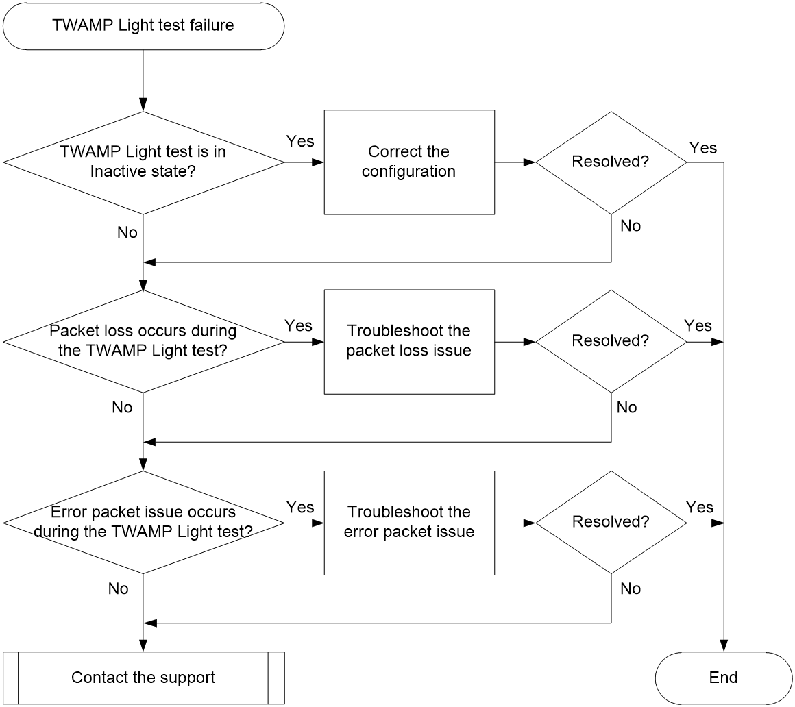

Figure 2 shows the troubleshooting flowchart:
Figure 2 Flowchart for troubleshooting TWAMP Light test failure
Solution
1.     Collect the status and results of the failed TWAMP Light test.
Execute the display nqa twamp-light client and display nqa twamp-light client statistics two-way-loss test-session commands on the device. Identify the failed TWAMP Light test and collect its status and results.
¡     Execute the display nqa twamp-light client command on the device. If the Status field value in the output is Inactive, it indicates that the status of the TWAMP Light test is abnormal.
<Sysname> display nqa twamp-light client
Brief information about all test sessions:
Total sessions: 1
Active sessions: 1
ID    Status     Source IP/Port         Destination IP/Port
1     Active     1.1.1.1/10000          1.1.1.2/20000
¡     Execute the display nqa twamp-light client statistics two-way-loss test-session command on the device. If the Loss count field value is not 0, it indicates that TWAMP Light test packet loss has occurred on the network. If the Error count field value is not 0, it indicates that the device receives error TWAMP Light test packets.
<Sysname> display nqa twamp-light client statistics two-way-delay test-session 1
Latest two-way loss statistics:
    Index         Loss count    Loss ratio    Error count    Error ratio
    1             200           100.0000%     0              0.0000%
    2             200           100.0000%     0              0.0000%
    3             200           100.0000%     0              0.0000%
    4             200           100.0000%     0              0.0000%
    5             200           100.0000%     0              0.0000%
Average loss count  : 200             Average loss ratio  : 100.0000%
Maximum loss count  : 200             Maximum loss ratio  : 100.0000%
Minimum loss count  : 200             Minimum loss ratio  : 100.0000%
Average error count : 0               Average error ratio : 0.0000%
Maximum error count : 0               Maximum error ratio : 0.0000%
Minimum error count : 0               Minimum error ratio : 0.0000%
2.     To resolve the test status anomaly, perform the following tasks:
a.     If the device has just completed startup or active/standby switchover, or the interface card where the interface (specified in the source interface command) is located has not completed startup, wait for the device state to become stable. Execute the display system stable state command. If the System state field value in the output is Stable, the device is already in a stable state. In this case, identify whether the test status changes to Active.
-     If it changes to Active, no further action is required.
-     If it does not change to Active, proceed to the next step.
b.     If the device is operating stably, identify whether the configuration is complete.
-     On a Layer 3 VPN network, execute the display nqa twamp-light client verbose command to view the VPN bound to the TWAMP Light test and execute the display ip vpn-instance command to identify whether the VPN exists. If the bound VPN does not exist, execute the ip vpn-instance command in system view to create a VPN instance.
-     On a Layer 2 VPN network, execute the display nqa twamp-light client verbose command to view the source interface. If the Source interface field value is a hyphen (-), execute the source interface command in TWAMP Light client-session view to specify a source AC for test packets, and make sure the specified interface is up.
c.     Identify whether the network connection is ready. If a source interface or source AC is specified for the TWAMP Light test, make sure the source interface or source AC is up.
-     Execute the display l2vpn pw xconnect-group or display l2vpn forwarding ac command. If the State field (which represents AC state) value is Down, resolve the AC issue.
-     Execute the display interface command. If the values for the Current state and Line protocol state fields (which indicate the interface state) are Down, bring up the interface.
3.     To resolve the test packet loss issue, perform the following tasks:
