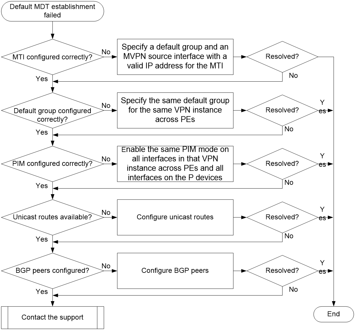

Troubleshooting flow
Figure 1 shows the troubleshooting flowchart.
Figure 1 Flowchart for troubleshooting the default MDT establishment failure
Solution
1.     Execute the display interface command to check the state and address encapsulation information of MTIs.
2.     Execute the display multicast-vpn default-group command to verify that different PEs have the same default group for the same VPN instance.
3.     Execute the display pim interface verbose command on each device. Verify that PIM is enabled on a minimum of one interface in the VPN instance on each PE. Ensure that the same PIM mode is enabled on the interfaces in the same VPN instance across PEs and all interfaces on the P devices.
4.     Execute the display ip routing-table command to verify that the local PE has unicast route entries to the the remote PE in the same VPN instance.
5.     Execute the display bgp peer command to verify that a BGP peer relationship has been established between the PEs.
6.     If the issue persists, collect the following information and contact Technical Support:
¡     Results of each step.
¡     The configuration file, log messages, and alarm messages.

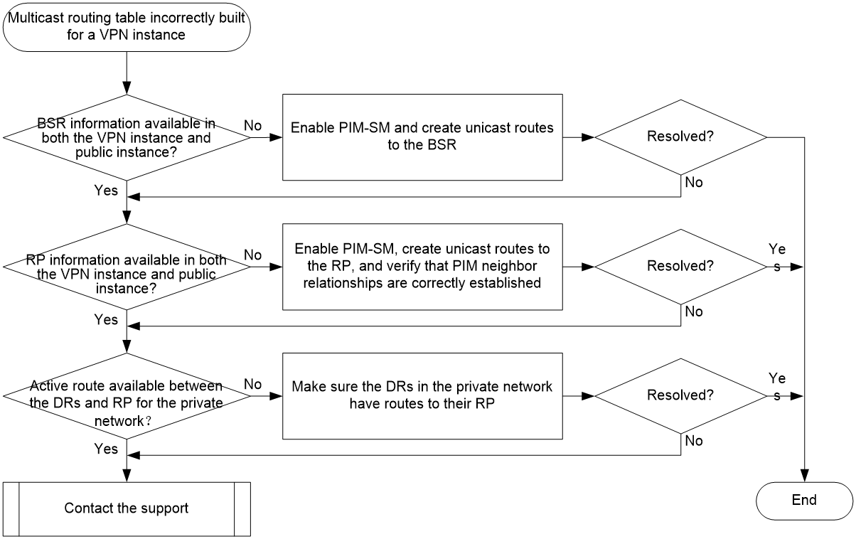

Figure 2 Troubleshooting flowchart for issues with building the multicast routing table for a VPN instance
Solution
1.     Use the display pim bsr-info command to verify that the public and VPN instances have BSR information. If BSR information is absent, check for unicast routes to the BSR.
2.     Use the display pim rp-info command to verify that the RP information is correct. If no RP information is displayed, verify the presence of a unicast route to the RP. Additionally, execute the display pim neighbor command to verify that PIM neighbor relationships have been correctly established on both public and private networks.
3.     Use the ping command to check connectivity between the DR and RP on the private network, and between the receivers and the multicast source.
4.     If the issue persists, collect the following information and contact Technical Support:
