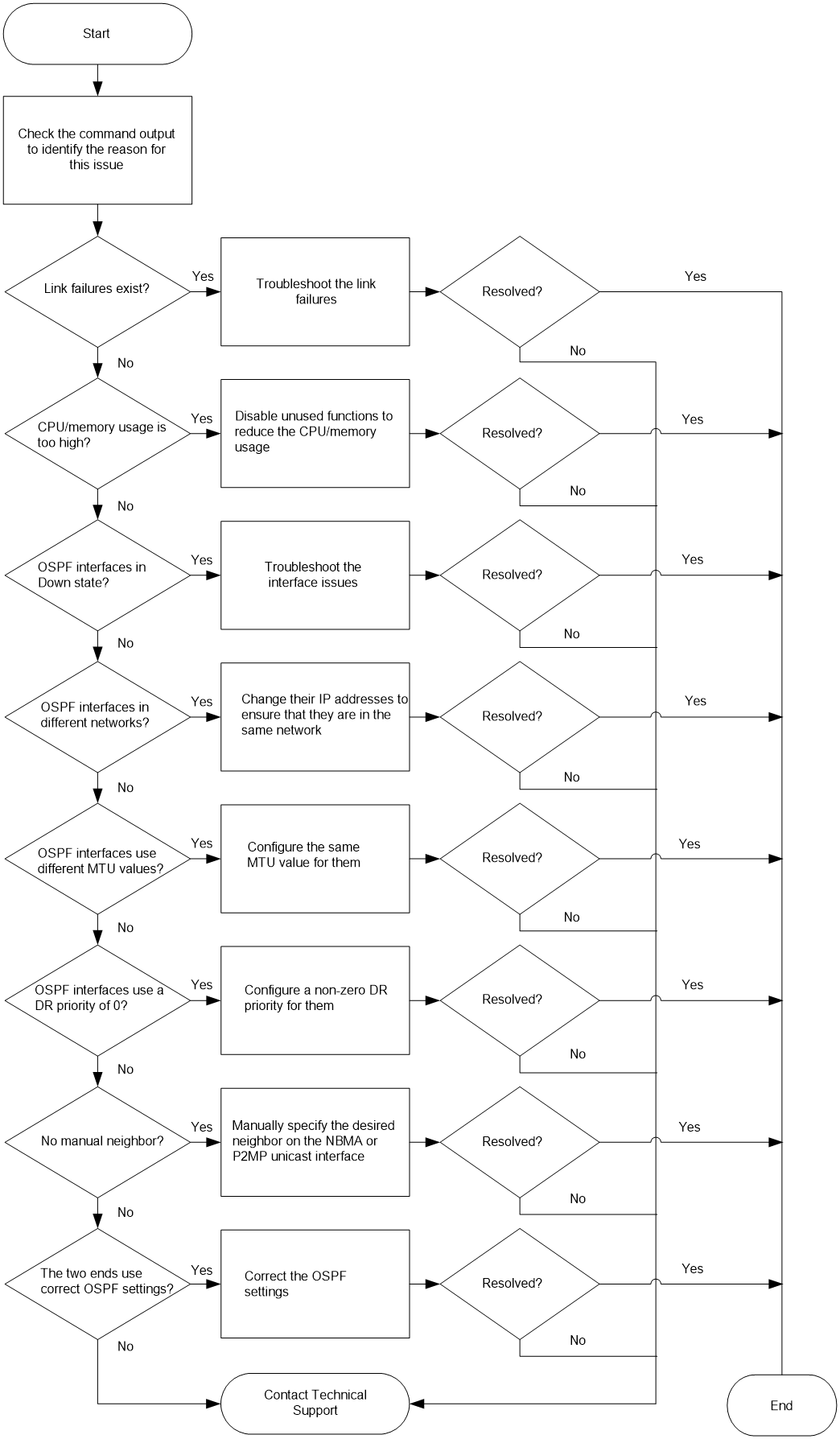

Troubleshooting flow
Figure 1 shows the troubleshooting flowchart.
Figure 1 Troubleshooting flowchart
Solution
1.     Identify the reason for the OSPF neighbor down issue through the CLI.

2.     Check for link failures.
Execute the ping command to check for link failures. If the related links operate correctly, proceed to 3.
3.     Identify whether the CPU usage is too high.
Execute the display cpu-usage command to examine CPU usage. If the CPU usage of the device's MPU and interface modules is excessively high, OSPF might fail to receive or send protocol packets correctly, causing neighbor flapping. To resolve this issue, disable unnecessary functions. If the CPU usage is not high, proceed to step 5.
4.     Identify whether the memory usage exceeds the memory usage threshold.
Execute the display memory-threshold command. If the Current free-memory state field in the output, which represents the current memory usage of the system, displays Minor, Severe, or Critical, it indicates that the remaining free memory is relatively insufficient. In this case, the device might be unable to send or receive OSPF packets, or might process OSPF packets slowly. To resolve this issue, disable unnecessary functions. If the Current free-memory state field displays Normal, proceed to step 5.
5.     Identify whether the physical link state of each OSPF interface is in UP.
Execute the display interface [ interface-type [ interface-number | interface-number.subnumber ] ] command to identify whether the physical link state of each OSPF interface is UP.
¡     If the physical link state of an OSPF interface is DOWN, the interface has failed. First resolve this issue.
¡     If the physical link state of each OSPF interface is UP, execute the display ospf interface command to identify whether each OSPF interface is in a normal state.
-     If an OSPF interface is in DOWN state, identify whether the network command was executed in the related OSPF process to advertise the network segment to which that interface belongs. If OSPF did not advertise the network segment, identify whether OSPF is enabled on the interface. If OSPF is enabled, troubleshoot the interface issue on the network layer.
-     If the OSPF interfaces are in a normal state, including DR, BDR, DROther, and P-2-P, proceed to step 6.
6.     Identify whether the IP addresses of the two ends are in the same network segment.
Execute the display interface brief command to view IP addresses of the two neighboring interfaces.
¡     If the two interface IP addresses are not in the same network segment, execute the ip address command on either of the interfaces to change its IP address. Make sure IP addresses of the two neighboring interfaces are in the same network segment.
¡     If the two interface IP addresses are in the same network segment, proceed to step 7.
7.     Identify whether the related OSPF interfaces have the same MTU value.
If the ospf mtu-enable command was executed on the OSPF interfaces, those OSPF interfaces must add the same MTU value to DD packets. If this requirement is not met, the OSPF interfaces cannot be establish an OSPF neighbor relationship. By default, the MTU value in DD packets is 0. Execute the display interface [ interface-type [ interface-number | interface-number.subnumber ] ] command to view the MTU information of each interface.
¡     If the interfaces have different MTU values, execute the mtu size command in interface view to configure the same MTU value for the interfaces.
¡     If the interfaces have the same MTU value, proceed to step 8.
8.     Verify that the DR priority of each neighboring OSPF interface is not zero.
On a broadcast or NBMA network, to elect a DR correctly, make sure that a minimum of one OSPF interface has a non-zero DR priority. If the DR priority is 0 for both of the two neighboring OSPF interfaces, the highest neighbor states at both ends are 2-Way. Execute the display ospf interface command to view OSPF interface information. The Priority field in the command output displays the DR priority of an interface.
If the DR priority of each neighboring interface is not zero, proceed to step 9.
9.     Identify whether an NBMA or P2MP unicast neighbor has been manually specified.
When the network type of an OSPF interface is NBMA or P2MP unicast, you must use the peer command to specify a neighbor by its IP address. Execute the display this command in interface view. If the network type of an interface is NBMA or P2MP unicast, execute the peer command to manually specify a neighbor by its IP address.
If an NBMA or P2MP unicast neighbor has been manually specified, proceed to step 10.
10.     Identify whether the OSPF settings at the two ends are correct.
a.     Execute the display ospf command to view the OSPF router IDs of the two ends. If the two ends use the same router ID, edit the configuration to avoid the conflict. If the two ends use different router IDs, proceed to the next step.
b.     Execute the display ospf interface command to view the OSPF area IDs of the two ends. If the two ends use different area IDs, edit the configuration to ensure area ID consistency. If the two ends use the same area ID, proceed to the next step.
c.     Execute the display ospf interface command to view the network types of interfaces at the two ends. If the two interfaces are configured with different network types, edit the configuration to ensure network type consistency. If the network type is PTP for one end and Broadcast for the other, the neighbor relationship can reach Full state, but routing information cannot be calculated.
If the two ends are configured with the same network type, proceed to the next step.
d.     Execute the display ospf statistics error command every 10 seconds for 5 minutes to view OSPF error statistics. Pay attention to the following fields:
-     Bad authentication type: If the value of this field keeps increasing, the two OSPF neighbors are configured with different OSPF authentication modes. To resolve this issue, edit the authentication mode setting to make sure the two devices have the same authentication mode.
-     Hello-time mismatch: If the value of this field keeps increasing, the two neighboring interfaces are configured with different hello intervals. To resolve this issue, edit the hello interval setting to make sure the OSPF interfaces have the same hello interval value.
-     Dead-time mismatch: If the value of this field keeps increasing, the two neighboring interfaces are configured with different dead intervals. To resolve this issue, edit the dead interval setting to make sure the OSPF interfaces have the same dead interval value.
-     Ebit option mismatch: If the value of this field keeps increasing, the two neighbors are of different OSPF area types. (For example, one end is in a normal area and the other end is in a stub area.) To resolve this issue, edit the OSPF area setting to make sure the two ends have the same area type.
If the issue persists, proceed to step 11.
11.     If the issue persists, collect the following information and contact Technical Support:
¡     Results of each step.
¡     The configuration file, log messages, and alarm messages.

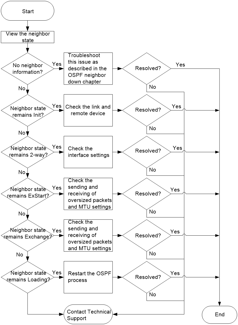

Figure 2 shows the troubleshooting flowchart:
Figure 2 Troubleshooting flowchart
Solution
1.     Execute the display ospf peer command to view OSPF neighbor information, and perform different tasks based on the neighbor state.
¡     If no neighbor information exists:
The OSPF neighbor went down or flapped. See "OSPF neighbor down" to troubleshoot the issue.
¡     If the neighbor state remains Init:
The remote device cannot receive Hello packets from the local device. In this case, identify whether the link or the remote device has failed.
¡     If the neighbor state remains 2-Way:
Execute the display ospf interface verbose command to identify whether the DR priority of the neighbor-facing OSPF interface is zero.
-     If the DR priority of the OSPF interface is zero, no action is required.
-     If the DR priority of the OSPF interface is not zero, proceed to step 2.
¡     If the neighbor state remains ExStart:
The device keeps performing DD negotiation but cannot perform DD synchronization. The following are the common causes for this issue:
-     The neighbor-facing interface cannot send and receive oversized packets correctly.
Repeat the ping -s packet-size neighbor-address command, set the value for the packet-size argument to 1500 or greater, and then view the transmission and reception of oversized packets. If the remote end still cannot be pinged, troubleshoot the link issue first.
-     The two ends use different MTU values.
If the ospf mtu-enable command was configured on the neighbor-facing OSPF interface, identify whether the two ends use the same MTU value. If they use different MTU values, configure the same MTU value for them.
If the issue persists, proceed to step 2.
¡     If the neighbor state remains Exchange:
The device is performing DD packet exchange. Troubleshoot this issue in the same way as when the neighbor state remains ExStart.
¡     If the neighbor state remains Loading:
Execute the reset ospf [ process-id ] process command to restart the OSPF process.
2.     If the issue persists, collect the following information and contact Technical Support:

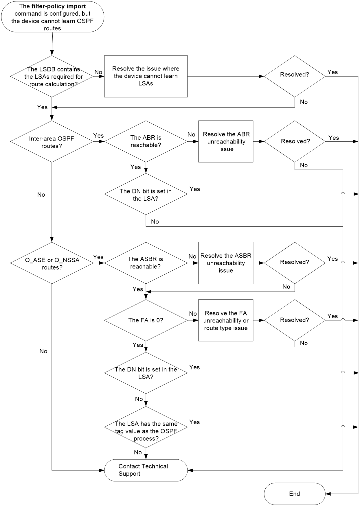

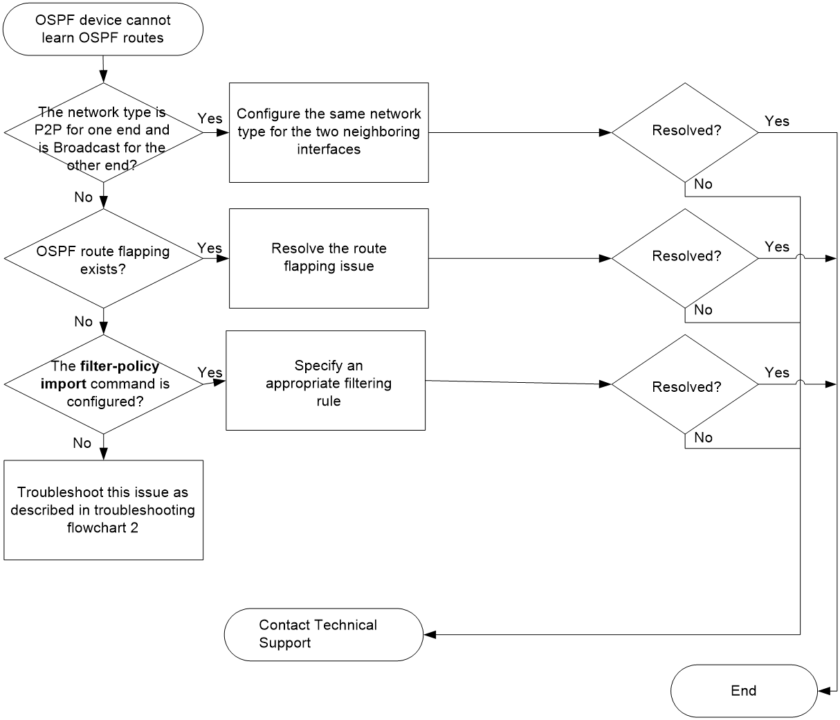

Figure 3 and Figure 4 show the troubleshooting flowcharts.
Figure 3 Troubleshooting flowchart 1
Figure 4 Troubleshooting flowchart 2

1.     Identify whether the network type is P2P for one end and is Broadcast for the other end.
If yes, the neighbor relationship can reach Full state, but the two ends cannot learn routes from each other. To resolve this issue:
a.     Execute the display ospf interface command to view the network types of the two neighboring OSPF interfaces.
<Sysname> display ospf interface
         OSPF Process 1 with Router ID 5.5.5.5
                 Interfaces
 Area: 0.0.0.1
 IP Address      Type      State    Cost  Pri   DR              BDR
 192.168.51.5    PTP       P-2-P    1     1     0.0.0.0         0.0.0.0
b.     If this issue exists, execute the ospf network-type command to configure the same network type for the two neighboring interfaces.
If this issue does not exist, proceed to step 2.
2.     Check the OSPF routing table multiple times for OSPF route flapping.
Execute the display ip routing-table protocol ospf verbose command, and then identify flapping OSPF routes by the Age field in the command output.
¡     If the Age field of an OSPF route displays a small value, the OSPF route flaps, and you must troubleshoot the route flapping issue.
¡     If no route flapping issue is found, proceed to step 3.

3.     Identify whether the filter-policy import command is configured in the OSPF process.
In scenarios where route filtering is configured, check for OSPF route filtering errors.
a.     Execute the display this command in the related OSPF process on the local device to identify whether the filter-policy import command is configured in the OSPF process.
[Sysname-ospf-1] display this
ospf 1
 import-route direct
 filter-policy 2000 import
 area 0.0.0.1
  network 192.168.51.0 0.0.0.255
  nssa
return
b.     If the filter-policy import command is configured, identify whether the filtering rule specified by using this command are appropriate.
-     If an ACL is used for route filtering, execute the display acl { acl-number | name acl-name } command to view its configuration details.
-     If a prefix list is used for route filtering, execute the display ip prefix-list command to view its configuration details.
-     If a routing policy is used for route filtering, execute the display route-policy command to view its configuration details.
If the desired routes are unexpectedly denied by the filtering rule, identify whether the filtering rule meets the requirements. If it is inappropriate, specify a new filtering rule by using the filter-policy import command.
c.     If the desired routes are not denied by the filtering rule or the filter-policy import command is not configured in the OSPF process, proceed to step 4.
4.     Identify whether the LSDB of the OSPF process contains LSAs that carry the OSPF routes that have not been learned.
Choose the appropriate troubleshooting method based on the type of OSPF routes that have not been learned in the OSPF process.
¡     Intra-area OSPF routes
If the OSPF process lacks intra-area routes, execute the display ospf [ process-id ] lsdb router command in user view to identify whether the LSDB of the OSPF process contains all the Router LSAs in the area.
<Sysname> display ospf 100 lsdb router

-     If the LSDB lacks some Router LSAs, proceed to step 7.
-     If the LSDB contains all of the Router LSAs, but cannot calculate routing information, proceed to step 7.
¡     Inter-area OSPF routes

-     If the LSDB lacks some AS External LSAs or NSSA External LSAs, proceed to step 7.
-     If the LSDB contains all of the AS External LSAs or NSSA External LSAs, but cannot learn O_ASE or O_NSSA routes, proceed to step 7.
5.     Identify whether the ABR is reachable.
Inter-area routes are advertised by the ABR. If the local device and the ABR cannot reach each other, the local device will not be able to learn inter-area routes.
a.     Execute the display ospf [ process-id ] lsdb summary command on the local device, and then view the Adv Rtr field in the command output. This field displays the router ID of the ABR, which advertised the Network Summary LSA.

c.     If the output of the display ospf abr-asbr command does not include a route to the ABR, proceed to step 7.
d.     If the output of the display ospf abr-asbr command includes a route to the ABR, and the local device is an ABR, identify whether the local OSPF area is a backbone area.
-     If the OSPF area is not a backbone area (with a non-zero area ID), no action is required. According to RFC 2328, ABRs do not process the Network Summary LSAs received from non-backbone areas.
-     If the OSPF area is a backbone area (with an area ID of 0), but it cannot learn inter-area routes, proceed to step 7.
e.     If the output of the display ospf abr-asbr command includes a route to the ABR, and the OSPF process is bound to a VPN instance, identify whether the vpn-instance-capability simple command is configured in the OSPF process. If this command is configured, proceed to step 7.

6.     Identify whether the ASBR is reachable and whether loop prevention is enabled.
O_ASE routes and O_NSSA routes are advertised by the ASBR. If the local device and the ASBR cannot reach each other, the local device will not be able to learn routes from devices located in other ASs.
a.     Execute the display ospf [ process-id ] lsdb [ ase | nssa ] command, and then view the Adv Rtr field in the command output. This field displays the router ID of the ASBR, which advertised the AS External LSA (Type-5) or NSSA External LSA (Type-7).

c.     If the output of the display ospf abr-asbr command does not include a route to the ASBR, proceed to step 7.
d.     If the output of the display ospf abr-asbr command includes a route to the ASBR, and the Forwarding Address field of the LSA is not 0, check the reachability and route type of the forwarding address.
Execute the disply ospf routing forwarding-address { mask-length | mask } command in user view to identify whether the local device has a route to the forwarding address.
<Sysname> display ospf 100 routing 192.168.51.5 24

Troubleshoot this issue as described in Table 2.
Table 2 Troubleshooting methods
Whether the forwarding address is reachable
Unreachable
If the display ospf routing forwarding-address { mask-length | mask } command does not display route information for the forwarding address, the forwarding address is unreachable. In this case, proceed to step 7.
Reachable
If the missing external routes are advertised in an NSSA External LSA, no action is required. According to RFC 3101, the route to the forwarding address must belong to the same OSPF area as the NSSA External LSA. If the Area field displays an area ID different from that of an NSSA External LSA, the OSPF process will not use that NSSA External LSA for route calculation. Therefore, it is normal that the OSPF process lacks the related external routes.
If the Type field displays Type1 or Type2 in the output of the display ospf routing forwarding-address { mask-length | mask } command, the route to the forwarding address is an external route. According to RFC 2328, if the route to a non-zero forwarding address is an external route, OSPF will not use the related LSA for route calculation. Therefore, it is normal that the OSPF process lacks the related external routes.
e.     If the output of the display ospf abr-asbr command includes a route to the ASBR, and the OSPF process is bound to a VPN instance, identify whether the vpn-instance-capability simple command is configured in the OSPF process.
If this command is not configured, troubleshoot this issue as described in Table 3.
