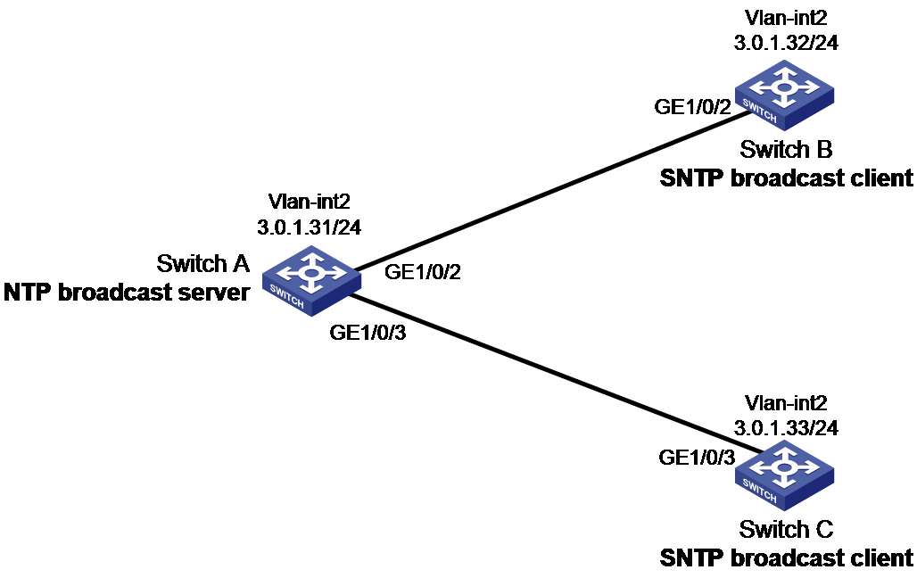

NTP working mechanism
Figure 1 shows how NTP synchronizes the system time between two devices (Device A and Device B, in this example). Assume that:
·     Prior to the time synchronization, the time is set to 10:00:00 am for Device A and 11:00:00 am for Device B.
·     Device B is used as the NTP server. Device A is to be synchronized to Device B.
·     It takes 1 second for an NTP message to travel from Device A to Device B, and from Device B to Device A.
·     It takes 1 second for Device B to process the NTP message.
Figure 1 Basic work flow
The synchronization process is as follows:
1.     Device A sends Device B an NTP message, which is timestamped when it leaves Device A. The time stamp is 10:00:00 am (T1).
2.     When this NTP message arrives at Device B, Device B adds a timestamp showing the time when the message arrived at Device B. The timestamp is 11:00:01 am (T2).
3.     When the NTP message leaves Device B, Device B adds a timestamp showing the time when the message left Device B. The timestamp is 11:00:02 am (T3).
4.     When Device A receives the NTP message, the local time of Device A is 10:00:03 am (T4).
Up to now, Device A can calculate the following parameters based on the timestamps:
·     The roundtrip delay of the NTP message: Delay = (T4 – T1) – (T3 – T2) = 2 seconds.
·     Time difference between Device A and Device B: Offset = [ (T2 – T1) + (T3 – T4) ] /2 = 1 hour.
Based on these parameters, Device A can be synchronized to Device B.
This is only a rough description of the work mechanism of NTP. For more information, see the related protocols and standards.

NTP configuration examples
Example: Configuring NTP client/server association mode
As shown in Figure 4, perform the following tasks:
·     Configure Device A's local clock as its reference source, with stratum level 2.
·     Configure Device B to operate in client mode and specify Device A as the NTP server of Device B.
Figure 4 Network diagram
1.     Assign an IP address to each interface, and make sure Device A and Device B can reach each other, as shown in Figure 4. (Details not shown.)
2.     Configure Device A:
# Enable the NTP service.

Figure 6 Network diagram
1.     Assign an IP address to each interface, and make sure Device A and Device B can reach each other, as shown in Figure 6. (Details not shown.)

Example: Configuring NTP broadcast association mode
As shown in Figure 8, configure Switch C as the NTP server for multiple devices on the same network segment so that these devices synchronize the time with Switch C.
·     Configure Switch C's local clock as its reference source, with stratum level 2.
·     Configure Switch C to operate in broadcast server mode and send broadcast messages from VLAN-interface 2.
·     Configure Switch A and Switch B to operate in broadcast client mode, and listen to broadcast messages on VLAN-interface 2.
Figure 8 Network diagram
1.     Assign an IP address to each interface, and make sure Switch A, Switch B, and Switch C can reach each other, as shown in Figure 8. (Details not shown.)
2.     Configure Switch C:

Example: Configuring NTP authentication in broadcast association mode
As shown in Figure 12, configure Switch C as the NTP server for multiple devices on the same network segment so that these devices synchronize the time with Switch C. Configure Switch A and Switch B to authenticate the NTP server.
·     Configure Switch C's local clock as its reference source, with stratum level 3.
·     Configure Switch A and Switch B to operate in broadcast client mode and receive broadcast messages on VLAN-interface 2.
·     Enable NTP authentication on Switch A, Switch B, and Switch C.
Figure 12 Network diagram
1.     Assign an IP address to each interface, and make sure Switch A, Switch B, and Switch C can reach each other, as shown in Figure 12. (Details not shown.)

5.     Verify the configuration:
NTP authentication is enabled on Switch A and Switch B, but not on Switch C, so Switch A and Switch B cannot synchronize their local clocks to Switch C.
[SwitchB-Vlan-interface2] display ntp-service status
 Clock status: unsynchronized
 Clock stratum: 16
 Reference clock ID: none
6.     Enable NTP authentication on Switch C:
# Enable NTP authentication on Switch C. Create a plaintext NTP authentication key, with key ID of 88 and key value of 123456. Specify it as a trusted key.
[SwitchC] ntp-service authentication enable
[SwitchC] ntp-service authentication-keyid 88 authentication-mode md5 simple 123456
[SwitchC] ntp-service reliable authentication-keyid 88
# Specify Switch C as an NTP broadcast server, and associate key 88 with Switch C.
[SwitchC] interface vlan-interface 2
[SwitchC-Vlan-interface2] ntp-service broadcast-server authentication-keyid 88
# Verify that Switch B has synchronized its time with Switch C, and the clock stratum level of Switch B is 4.
 Clock status: synchronized
 Clock stratum: 4
 System peer: 3.0.1.31
 Local mode: bclient
 Reference clock ID: 3.0.1.31
 Leap indicator: 00
 Clock jitter: 0.006683 s
 Stability: 0.000 pps
 Clock precision: 2^-23
 Root delay: 0.00127 ms
 Root dispersion: 2.89877 ms
 Reference time: d0d287a7.3119666f  Sat, Jan  8 2019  6:50:15.191
 System poll interval: 64 s
# Verify that an IPv4 NTP association has been established between Switch B and Switch C.
[SwitchB-Vlan-interface2] display ntp-service sessions
       source          reference       stra reach poll  now offset  delay disper
 [1245]3.0.1.31        127.127.1.0        3     3   64   68   -0.0 0.0000    0.0
Notes: 1 source(master),2 source(peer),3 selected,4 candidate,5 configured.
 Total sessions: 1

Example: Configuring SNTP in broadcast association mode
As shown in Figure 14, configure Switch A as the NTP broadcast server to provide NTP clock synchronization for other devices on the LAN.
·     On Switch A, configure the local clock as the reference source, with stratum level 2.
·     Configure Switch A to operate in broadcast server mode and send broadcast messages from VLAN-interface 2.
·     Configure Switch B and Switch C to operate in broadcast client mode, and listen to broadcast messages on VLAN-interface 2.
Figure 14 Network diagram
