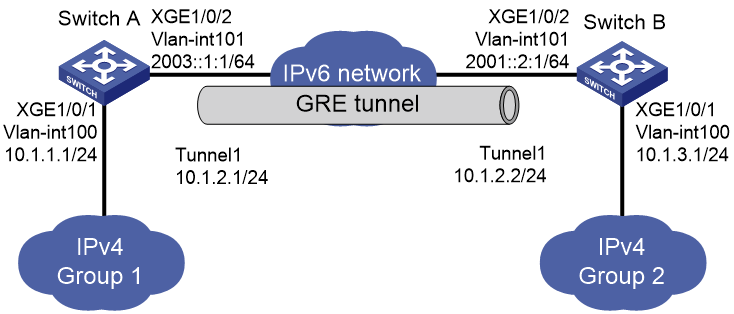

Example: Configuring an IPv4 over IPv6 GRE tunnel
As shown in Figure 7, two IPv4 subnets Group 1 and Group 2 are connected to an IPv6 network. Create a GRE/IPv6 tunnel between Switch A and Switch B, so the two IPv4 subnets can communicate with each other through the GRE tunnel over the IPv6 network.
Before performing the following configuration, configure an IP address for each interface, and make sure Switch A and Switch B can reach each other.
1. Configure Switch A:
# Enter system view.
<SwitchA> system-view
# Create a tunnel interface Tunnel 1, and specify the tunnel mode as GRE/ IPv6.
[SwitchA] interface tunnel 1 mode gre ipv6
# Configure an IP address for the tunnel interface.
[SwitchA-Tunnel1] ip address 10.1.2.1 255.255.255.0
# Configure the source address of the tunnel interface as the IPv6 address of VLAN-interface 101 on Switch A.
[SwitchA-Tunnel1] source 2003::1:1
# Configure the destination address of the tunnel interface as the IPv6 address of VLAN-interface 101 on Switch B.
[SwitchA-Tunnel1] destination 2001::2:1
[SwitchA-Tunnel1] quit
# Configure a static route from Switch A through the tunnel interface to Group 2.
[SwitchA] ip route-static 10.1.3.0 255.255.255.0 tunnel 1
2. Configure Switch B:
<SwitchB> system-view
# Create a tunnel interface Tunnel 1, and specify the tunnel mode as GRE/IPv6.
[SwitchB] interface tunnel 1 mode gre ipv6
[SwitchB-Tunnel1] ip address 10.1.2.2 255.255.255.0
# Configure the source address of tunnel interface as the IPv6 address of VLAN-interface 101 on Switch B.
[SwitchB-Tunnel1] source 2001::2:1
# Configure the destination address of the tunnel interface as the IPv6 address of VLAN-interface 101 on Switch A.
[SwitchB-Tunnel1] destination 2003::1:1
[SwitchB-Tunnel1] quit
# Configure a static route from Switch B through the tunnel interface to Group 1.
[SwitchB] ip route-static 10.1.1.0 255.255.255.0 tunnel 1
# Display tunnel interface information on Switch A.
[SwitchA] display interface tunnel 1
Tunnel1
Current state: UP
Line protocol state: UP
Description: Tunnel1 Interface
Bandwidth: 64kbps
Maximum transmission unit: 64000
Internet address: 10.1.2.1/24 (primary)
Tunnel source 2003::1:1, destination 2001::2:1
Tunnel TTL 255
Tunnel protocol/transport GRE/IPv6
GRE key disabled
Checksumming of GRE packets disabled
Last clearing of counters: Never
Last 300 seconds input rate: 0 bytes/sec, 0 bits/sec, 0 packets/sec
Last 300 seconds output rate: 0 bytes/sec, 0 bits/sec, 0 packets/sec
Input: 0 packets, 0 bytes, 0 drops
Output: 0 packets, 0 bytes, 0 drops
# Display tunnel interface information on Switch B.
[SwitchB] display interface tunnel 1
Tunnel1
Current state: UP
Bandwidth: 64kbps
Internet address: 10.1.2.2/24 (primary)
Tunnel source 2001::2:1, destination 2003::1:1
Tunnel TTL 255
GRE key disabled
# From Switch B, ping the IP address of VLAN-interface 100 on Switch A.
[SwitchB] ping -a 10.1.3.1 10.1.1.1
Ping 10.1.1.1 (10.1.1.1) from 10.1.3.1: 56 data bytes, press CTRL+C to break
56 bytes from 10.1.1.1: icmp_seq=0 ttl=255 time=2.000 ms
56 bytes from 10.1.1.1: icmp_seq=1 ttl=255 time=1.000 ms
56 bytes from 10.1.1.1: icmp_seq=2 ttl=255 time=1.000 ms
56 bytes from 10.1.1.1: icmp_seq=3 ttl=255 time=0.000 ms
56 bytes from 10.1.1.1: icmp_seq=4 ttl=255 time=1.000 ms
--- Ping statistics for 10.1.1.1 ---
round-trip min/avg/max/std-dev = 0.000/1.000/2.000/0.632 ms
The output shows that Switch B can successfully ping Switch A.
