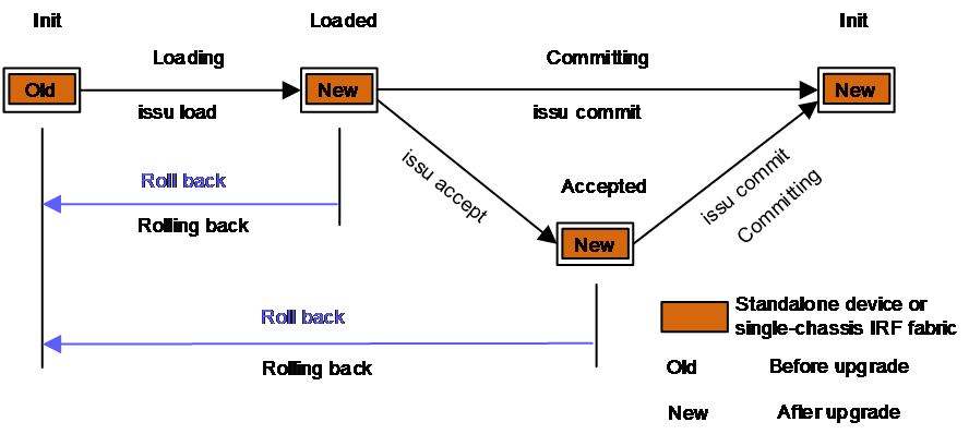

Performing an incremental upgrade on a standalone device (centralized devices) or a single-chassis IRF fabric (centralized IRF devices)
As shown in Figure 1, the upgrade operates as follows:
1.     The device is in Init state before the upgrade and enters Loading state when the issu load command is executed. When the upgrade completes, the device enters Loaded state.
2.     The device enters Accepted state when the issu accept command is executed successfully to accept the upgrade to a compatible version and delete the automatic rollback timer.
3.     The device enters Committing state when the issu commit command is executed to complete the ISSU upgrade to a compatible version, and it enters Init state when the upgrade completes.
IMPORTANT
IMPORTANT:
If a rollback is performed during the upgrade process, the system will roll back to the version before the upgrade.

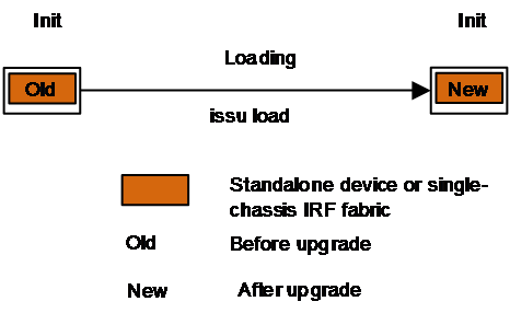

Figure 1 Performing an incremental upgrade on a standalone device or a single-chassis IRF fabric
Performing a reboot, ISSU reboot, or incompatible upgrade on a standalone device (centralized devices) or single-chassis IRF fabric (centralized IRF devices)
As shown in Figure 2, the device is in Init state before the upgrade and enters Loading state when the issu load command is executed. When the upgrade completes, the device enters Loaded state.
Figure 2 Performing a reboot, ISSU reboot, or incompatible upgrade on a standalone device or single-chassis IRF fabric

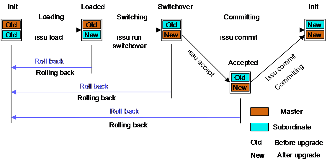

Performing a compatible upgrade on a multichassis IRF fabric
As shown in Figure 3, the upgrade operates as follows:
1.     The device is in Init state before the upgrade and enters Loading state when the issu load command is executed to upgrade a subordinate device in the IRF fabric. When the upgrade completes, the device enters Loaded state.
2.     The device enters Switching state when the issu run switchover command is executed to perform an ISSU switchover. When the switchover completes, the device enters Switchover state.
3.     The device enters Accepted state when the issu accept command is executed successfully to accept the upgrade to a compatible version and delete the automatic rollback timer.
4.     The device enters Committing state when the issu commit command is executed to upgrade all other member devices in the IRF fabric. When the upgrade completes, the device enters Init state.
IMPORTANT
IMPORTANT:
Figure 3 Performing a compatible upgrade on a multichassis IRF fabric
