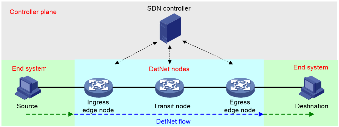

DetNet end-to-end network architecture
H3C DetNet end-to-end network architecture, as shown in Figure 1, includes end systems, SDN controller, and DetNet nodes. Based on different positions on the forwarding plane, DetNet nodes can be divided into three categories: ingress edge nodes, transit nodes, and egress edge nodes.
Figure 1 DetNet end-to-end network architecture
·     SDN controller—Collects information including the topology and latency of the DetNet network, calculates the paths that meet the end-to-end latency requirements of the service, and establishes a mapping relationship between DetNet flows and forwarding cycles.
·     Ingress edge node—Based on packet characteristics, determines whether a flow between end systems is allowed to enter the DetNet network for deterministic forwarding, and divides the packets that arrive irregularly into different forwarding cycles. The flow entering the DetNet network is called a DetNet flow, which can be defined by the five-tuple of IP packets (source IP address, destination IP address, source port number, destination port number, protocol type) and the DSCP value.
·     Transit node and egress edge node—Forwards the incoming packets through its outgoing interface in the timeslot for the corresponding queue

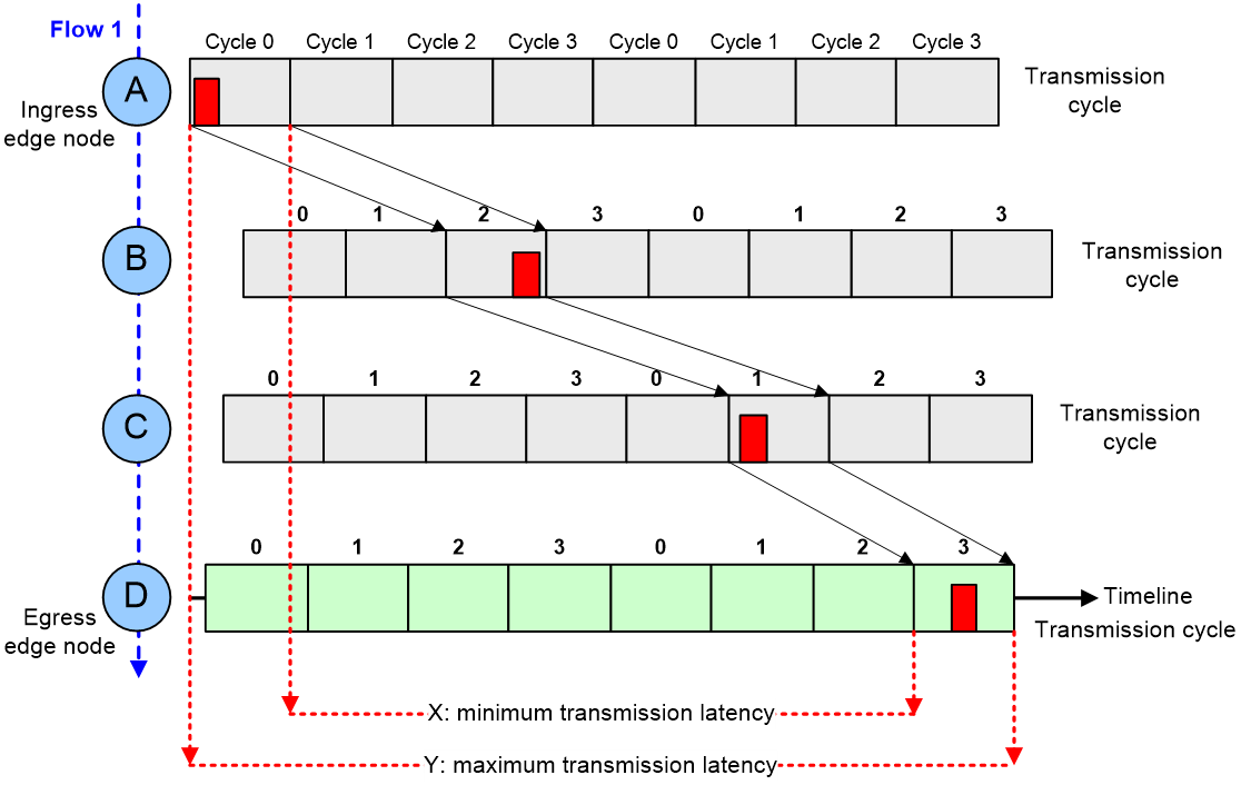

End-to-end deterministic transmission mechanism of RCQF
To ensure deterministic latency and jitter in end-to-end transmission, RCQF adopts a cyclic queuing and forwarding mechanism. Each deterministic traffic flow are assigned with a forwarding cycle. In this way, RCQF controls the behavior of each flow to avoid conflicts, reduces queuing latency within nodes, and ultimately achieves deterministic latency.
Figure 2 Queuing and forwarding for end-to-end deterministic transmission
The queuing and forwarding for end-to-end deterministic transmission is implemented as follows:
1.     The forwarding path and timing for each deterministic flow is planned. For example, for Flow 1 in Figure 2, the planned forwarding path is node A -> node B -> node C -> node D.
2.     All nodes on the packet forwarding path perform accurate frequency synchronization. Then, the timelines on the nodes are divided into equal cycles (with a duration of T).
3.     Every pair of adjacent nodes establish a stable cyclic mapping relationship. Then, the controller plane of the DetNet network uniformly schedules the deterministic flows to make sure they are forwarded only within a specific timeslot. For example, a packet sent in cycle 0 from node A will be sent in cycle 2 from node B, as shown in Figure 2. For each pair of adjacent nodes, the difference in the cycle number for each deterministic flow remains fixed, but the exact time at which a packet is sent within the corresponding cycle might vary.
4.     All nodes along the path cache, encapsulate, and periodically forward packets of deterministic flows along the predetermined forwarding path based on the established cyclic mapping relationships
In this way, the sending time of a packet at each node on the forwarding path is limited within a specific cycle, and the latency jitter of the packet at that node is bounded. No matter how many nodes exist on the path, the jitter of the previous node will not increase the jitter latency of the subsequent node, but only increase the overall latency of the packet. Each node absorbs the corresponding jitter in time, preventing the overall jitter from accumulating or spreading and ensuring an end-to-end jitter of two cycles (Y-X=2T).
·     The minimum transmission latency (X) occurs when the first node sends a packet at the end of a cycle, and the last node sends the packet at the beginning of a cycle.
·     The maximum transmission latency (Y) occurs when the first node sends a packet at the beginning of a cycle, and the last node sends the packet at the end of a cycle.

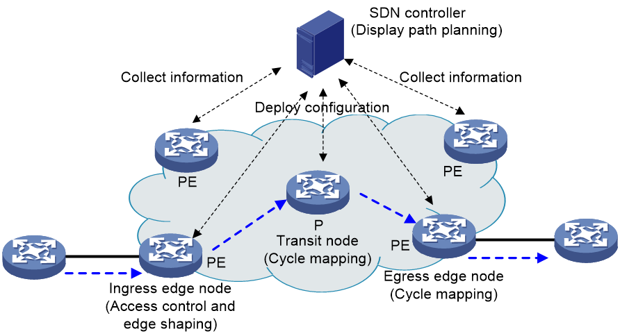

DetNet forwarding process overview
Figure 3 shows the overall forwarding process of a DetNet flow in a DetNet network.
Figure 3 DetNet forwarding process
1.     In a DetNet network, all devices adopt technologies such as PTP and SyncE to achieve nanosecond-level frequency synchronization.
2.     Each node measures the latency and jitter within a single node and between the uplink and downlink nodes accurately through technologies such as DetNetOAM.
3.     The SDN controller calculates the SRv6 explicit routes and queue mapping information that meet the DetNet requirement for latency based on the configured policies, and then issues the information to the ingress edge node. For networks that do not support SDN controllers, DetNet flows and DetNet paths can be manually configured on the ingress edge node.
4.     The ingress edge node identifies and filters packets incoming through a specified interface based on flow characteristics. It then encapsulates the packets with SRv6, and appends the SID list with the cycle attributes of each transit node in the SRH header. When DetNet flows exceed the reserved bandwidth of the interface, the ingress edge node discards packets that exceed the bandwidth and does not provide deterministic transmission assurance.
5.     The encapsulated data packets are shaped on the ingress edge node, enter the corresponding queue and are forwarded within the specified cycle.
6.     When the data packets arrive enters a downlink node, the node puts the packets in the corresponding queue based on the cycle attributes carried in the packet headers, and then waits for cyclic scheduling and forwarding.

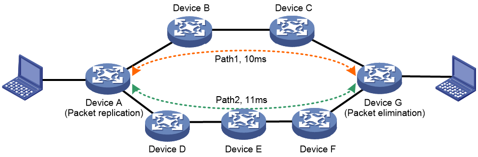

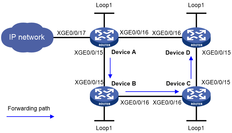

DetNet path redundancy
DetNet path redundancy enhances the reliability of DetNet paths. As shown in Figure 4, multiple DetNet paths can exist between the ingress edge node and egress edge node in a DetNet network. In this case, the ingress edge node replicates packets of DetNet flows and forwards the packets synchronously through multiple paths. The egress edge node eliminates redundant duplicates and reorders the packets. If a path fails, DetNet packet flows can still be forwarded to the receiver through other paths.
Figure 4 DetNet path redundancy
Compared with traditional methods, such as ECMP routes, link aggregation, and primary/backup links, path redundancy does not involve link switchovers and is more time-efficient, thus better ensuring forwarding reliability. However, it consumes more bandwidth resources.

Configuring a forwarding timeslot for a DetNet path
Use this command to specify a queue for the outgoing interface on each node of a DetNet path. After the configuration, each node will forward the incoming packets through its outgoing interface in the timeslot for the corresponding queue.
In most cases, the SDN controller performs parameter detection and latency deviation calculation for a DetNet path, and then automatically deploys the forwarding timeslot configuration to the ingress edge node of the path. Manual configuration through the CLI is usually used for debugging.
You must configure the forwarding timeslot for each node in the forwarding order of a path, which starts from the ingress edge node and ends at the egress edge node.
To add transit nodes, perform one of the following tasks:
·     Delete the forwarding timeslot configuration for all existing nodes after the new nodes, and then configure a forwarding timeslot for each node starting from the new node closest to the ingress edge node.
·     Execute the undo timeslot command to delete the forwarding timeslot configuration for all nodes on the path, and then configure a forwarding timeslot for each node in the planned forwarding order.
2.     Enter DetNet path view.
detnetip path path-id
3.     Configure a forwarding timeslot for a node on a DetNet path.
timeslot hop hop-index value value
By default, the forwarding timeslot is not configured for a node on a DetNet path.
Execute this command multiple times to configure a forwarding timeslot for each node in the forwarding order of a path.

In a network that supports DetNet path redundancy, you can bind multiple DetNet paths to the same DetNet path group if they are in mutual backup relationships. After you configure a DetNet path group on the ingress edge node, DetNet flows entering the DetNet network from the same source interface are automatically replicated and forwarded over multiple DetNet paths in that DetNet path group. For the egress edge node to distinguish packets of the same DetNet flow from other packets, you must specify the flow ID and device ID to be carried in packets.
DetNet paths in a DetNet path group might be different in terms of latency. Use this command on the ingress edge node to set the delay timer for the egress edge node to send packets after packet elimination. Upon receiving packets of the same DetNet flow from different paths, the egress edge node first eliminates redundant duplicates and reorders them based on information carried in the packets, including the timestamp, flow ID, packet sequence ID, and delay timer. Then, it forwards the packets after the specified delay timer expires.
Multiple DetNet path groups can co-exist on the ingress edge node.
In the current software version, you can bind a maximum of 10 DetNet paths to a DetNet path group, and the SRv6 path policies configured for these DetNet paths must contain the same destination endpoint.
Make sure the DetNet paths in a DetNet path group are configured with the same source interface.

Example: Configuring DetNet in an SRv6 TE policy network
As shown in Figure 5, an SRv6 TE policy is deployed in the IGP network. Perform the following tasks to specify that the service traffic is forwarded sequentially through Device A, Device B, Device C, and Device D:
·     Configure IS-IS for Device A to Device D to achieve Layer 3 connectivity.
·     Configure an SRv6 TE policy and enable DetNet on Device A to specify the forwarding path as Device A -> Device B -> Device C -> Device D.
·     On the forwarding path, specify queue 2 for the outgoing interface on the ingress edge node Device A whose node index is 1, queue 5 for the outgoing interface on Device B whose node index is 2, queue 8 for the outgoing interface on Device C whose index is 3, and queue 10 for the outgoing interface on Device D whose index is 4.
Figure 5 Network diagram
Device
Interface
IP address
Device
Interface
IP address
Device A
Loop1
1::1/128
Device B
Loop1
2::2/128
XGE0/0/15
1000::1/64
XGE0/0/15
1000::2/64
XGE0/0/16
4000::1/64
XGE0/0/16
2000::2/64
Device C
Loop1
3::3/128
Device D
Loop1
4::4/128
XGE0/0/15
3000::3/64
XGE0/0/15
3000::4/64
XGE0/0/16
2000::3/64
XGE0/0/16
4000::4/64
1.     Configure IPv6 addresses and prefix lengths for interfaces as shown in Table 2. (Details not shown.)
2.     Configure an SRv6 TE policy:
¡     Configure Device A:
# Configure the SID list.
<DeviceA> system-view
[DeviceA] segment-routing ipv6
[DeviceA-segment-routing-ipv6] encapsulation source-address 1::1
[DeviceA-segment-routing-ipv6] locator a ipv6-prefix 5000:: 64 static 32 args 8
[DeviceA-segment-routing-ipv6-locator-a] opcode 1 end no-flavor
[DeviceA-segment-routing-ipv6-locator-a] quit
[DeviceA-segment-routing-ipv6] traffic-engineering
[DeviceA-srv6-te] srv6-policy locator a
[DeviceA-srv6-te] segment-list s1
[DeviceA-srv6-te-sl-s1] index 10 ipv6 6000::100
[DeviceA-srv6-te-sl-s1] index 20 ipv6 7000::100
[DeviceA-srv6-te-sl-s1] index 30 ipv6 8000::100
[DeviceA-srv6-te-sl-s1] quit
# Create an SRv6 TE policy and configure SRv6 TE policy attributes.
[DeviceA-srv6-te] policy p1
[DeviceA-srv6-te-policy-p1] binding-sid ipv6 5000::200
[DeviceA-srv6-te-policy-p1] color 10 end-point ipv6 4::4
[DeviceA-srv6-te-policy-p1] candidate-paths
[DeviceA-srv6-te-policy-p1-path] preference 10
[DeviceA-srv6-te-policy-p1-path-pref-10] explicit segment-list s1
[DeviceA-srv6-te-policy-p1-path-pref-10] quit
[DeviceA-srv6-te-policy-p1-path] quit
[DeviceA-srv6-te-policy-p1] quit
[DeviceA-srv6-te] quit
[DeviceA-segment-routing-ipv6] quit
# Configure IS-IS to achieve network layer communication and set the cost type as wide.
[DeviceA] isis 1
[DeviceA-isis-1] network-entity 00.0000.0000.0001.00
[DeviceA-isis-1] cost-style wide
[DeviceA-isis-1] address-family ipv6 unicast
[DeviceA-isis-1-ipv6] segment-routing ipv6 locator a
[DeviceA-isis-1-ipv6] quit
[DeviceA-isis-1] quit
[DeviceA] interface ten-gigabitethernet 0/0/15
[DeviceA-Ten-GigabitEthernet0/0/15] isis ipv6 enable 1
[DeviceA-Ten-GigabitEthernet0/0/15] quit
[DeviceA] interface ten-gigabitethernet 0/0/16
[DeviceA-Ten-GigabitEthernet0/0/16] isis ipv6 enable 1
[DeviceA-Ten-GigabitEthernet0/0/16] quit
[DeviceA] interface loopback 1
[DeviceA-LoopBack1] isis ipv6 enable 1
[DeviceA-LoopBack1] quit
¡     Configure Device B:
# Configure the SRv6 End.SID.
<DeviceB> system-view
[DeviceB] segment-routing ipv6
[DeviceB-segment-routing-ipv6] locator b ipv6-prefix 6000:: 64 static 32 args 8
[DeviceB-segment-routing-ipv6-locator-b] opcode 1 end no-flavor
[DeviceB-segment-routing-ipv6-locator-b] quit
[DeviceB-segment-routing-ipv6] quit
[DeviceB] isis 1
[DeviceB-isis-1] network-entity 00.0000.0000.0002.00
[DeviceB-isis-1] cost-style wide
[DeviceB-isis-1] address-family ipv6 unicast
[DeviceB-isis-1-ipv6] segment-routing ipv6 locator b
[DeviceB-isis-1-ipv6] quit
[DeviceB-isis-1] quit
[DeviceB] interface ten-gigabitethernet 0/0/15
[DeviceB-Ten-GigabitEthernet0/0/15] isis ipv6 enable 1
[DeviceB-Ten-GigabitEthernet0/0/15] quit
[DeviceB] interface ten-gigabitethernet 0/0/16
[DeviceB-Ten-GigabitEthernet0/0/16] isis ipv6 enable 1
[DeviceB-Ten-GigabitEthernet0/0/16] quit
[DeviceB] interface loopback 1
[DeviceB-LoopBack1] isis ipv6 enable 1
[DeviceB-LoopBack1] quit
¡     Configure Device C:
<DeviceC> system-view
[DeviceC] segment-routing ipv6
[DeviceC-segment-routing-ipv6] locator c ipv6-prefix 7000:: 64 static 32 args 8
[DeviceC-segment-routing-ipv6-locator-c] opcode 1 end no-flavor
[DeviceC-segment-routing-ipv6-locator-c] quit
[DeviceC-segment-routing-ipv6] quit
[DeviceC] isis 1
[DeviceC-isis-1] network-entity 00.0000.0000.0003.00
[DeviceC-isis-1] cost-style wide
[DeviceC-isis-1] address-family ipv6 unicast
[DeviceC-isis-1-ipv6] segment-routing ipv6 locator c
[DeviceC-isis-1-ipv6] quit
[DeviceC-isis-1] quit
[DeviceC] interface ten-gigabitethernet 0/0/15
[DeviceC-Ten-GigabitEthernet0/0/15] isis ipv6 enable 1
[DeviceC-Ten-GigabitEthernet0/0/15] quit
[DeviceC] interface ten-gigabitethernet 0/0/16
[DeviceC-Ten-GigabitEthernet0/0/16] isis ipv6 enable 1
[DeviceC-Ten-GigabitEthernet0/0/16] quit
[DeviceC] interface loopback 1
[DeviceC-LoopBack1] isis ipv6 enable 1
[DeviceC-LoopBack1] quit
¡     # Configure Device D:
<DeviceD> system-view
[DeviceD] segment-routing ipv6
[DeviceD-segment-routing-ipv6] locator d ipv6-prefix 8000:: 64 static 32 args 8
[DeviceD-segment-routing-ipv6-locator-d] opcode 1 end no-flavor
[DeviceD-segment-routing-ipv6-locator-d] quit
[DeviceD-segment-routing-ipv6] quit
[DeviceD] isis 1
[DeviceD-isis-1] network-entity 00.0000.0000.0004.00
[DeviceD-isis-1] cost-style wide
[DeviceD-isis-1] address-family ipv6 unicast
[DeviceD-isis-1-ipv6] segment-routing ipv6 locator d
[DeviceD-isis-1-ipv6] quit
[DeviceD-isis-1] quit
[DeviceD] interface ten-gigabitethernet 0/0/15
[DeviceD-Ten-GigabitEthernet0/0/15] isis ipv6 enable 1
[DeviceD-Ten-GigabitEthernet0/0/15] quit
[DeviceD] interface ten-gigabitethernet 0/0/16
[DeviceD-Ten-GigabitEthernet0/0/16] isis ipv6 enable 1
[DeviceD-Ten-GigabitEthernet0/0/16] quit
[DeviceD] interface loopback 1
[DeviceD-LoopBack1] isis ipv6 enable 1
[DeviceD-LoopBack1] quit
# Create a DetNet flow and configure the flow ID as 10, the destination IPv6 address as AD80::ABAA:0000:00C2:0002, and the IPv6 prefix length as 112.
[DeviceA] detnetip flow 10 destination-ipv6 AD80::ABAA:0000:00C2:0002 prefix 112
# Create a DetNet path with path ID 10 and enter its view.
[DeviceA] detnetip path 10
# Specify the path type as SRv6 for the DetNet path, and enter SRv6 DetNet path view.
[DeviceA-detnet-path10] type srv6
# Configure the Color value as 10 and the destination endpoint (Device D) IPv6 address as 4::4 for the SRv6 DetNet path.
[DeviceA-detnet-path10-srv6] policy color 10 end-point ipv6 4::4
[DeviceA-detnet-path10-srv6] quit
# Specify the source interface as Ten-GigabitEthernet0/0/17 for the DetNet path.
[DeviceA-detnet-path10] source interface ten-gigabitethernet 0/0/17
# Apply the DetNet path to DetNet flow 10.
[DeviceA-detnet-path10] apply flow 10
# Configure forwarding timeslots for nodes on the DetNet path: Specify queue 2 for the outgoing interface on the ingress edge node whose node index is 1, queue 5 for the outgoing interface on node 2, queue 8 for the outgoing interface on node 3, and queue 10 for the outgoing interface on node 4.+
[DeviceA-detnet-path10] timeslot hop 1 value 2
[DeviceA-detnet-path10] timeslot hop 2 value 5
[DeviceA-detnet-path10] timeslot hop 3 value 8
[DeviceA-detnet-path10] timeslot hop 4 value 10
[DeviceA-detnet-path10] quit
[DeviceA] quit
<DeviceA> display detnetip path id 10
DetNet IP path information:
   path id          : 10
   type             : SRv6
   source-interface : Ten-GigabitEthernet0/0/17
   policy color     : 10
   end-point        : 4::4
   flow list        : 10
   timeslot         : 2,5,8,10
