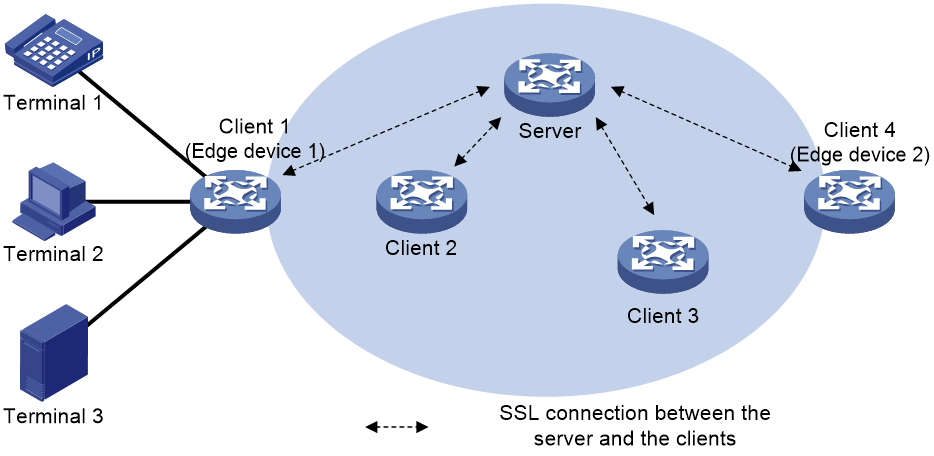

Trust network architecture
As shown in Figure 1, a trusted network adopts the Client/Server mode, in which the trust level feature is enabled on each network transmission device. The devices in the trust network architecture include terminals and network transmission devices.
Figure 1 Trust network architecture
Terminal
A terminal in a trust network (terminal) refers to a device with a security level in its IP address and secure communication requirements. In the IP address of a terminal, three bits are used to carry the security levels of the packets generated by the terminal, so as to identify the trustworthiness of the packets.
Network transmission device
Network transmission devices include the following types according to the device location in the transmission network:
·     Edge device—Network transmission devices located at the edge of a trust network and connected to Layer 3 of the terminals. The security levels of the packets received by edge devices are extracted according to the configuration.
·     Non-edge device—Network transmission devices that participate in trusted forwarding except edge devices. The packets received by non-edge devices can be forwarded normally according to the routes, without extracting their security levels.
Network transmission devices include the following types according to the device function in the transmission network:
·     Server—Network transmission devices acting as the server in a trust network. The server is the configuration center of the trust network. You need to configure the trust level policies and the parameters for secure transmission of packets on the server. The server deploys the configurations related to the trust level policies and the parameters for secure transmission of packets to all clients through SSL connection.
The server can be deployed as an edge device or a non-edge device. A device can only act as a server or a client.
Multiple servers can be deployed in a trust network, and a client can only be connected to a server. Make sure the configurations of trust level modules on multiple servers in a trust network are consistent. Otherwise, the packets cannot be forwarded according to the expected paths.
·     Client—Network transmission devices acting as the clients in a trust network. According to the configurations deployed by the server, a client calculates the trusted forwarding path and completes trusted forwarding of packets.

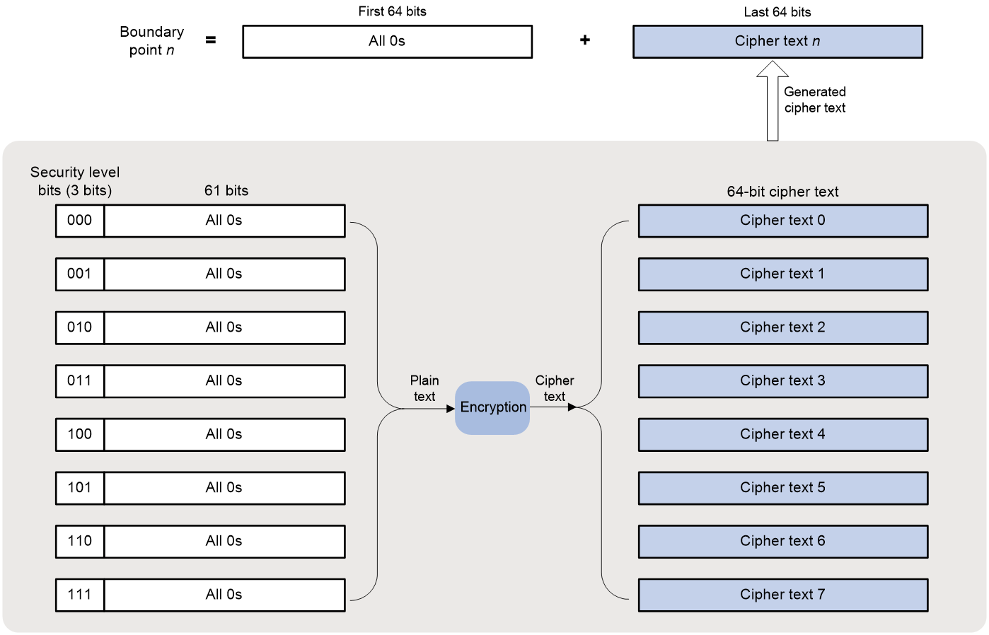

Boundary point is a parameter configured on the server to extract the security level of packets. The boundary point configurations are deployed to all clients. This command only takes effect on edge devices.
You need to configure eight boundary points (boundary point 0 to boundary point 7) on the server to extract eight security levels of the packets respectively. The boundary points use IPv6 address format. The generation method of the boundary points is shown in Figure 2.
Figure 2 Generation method of the boundary points
For example, boundary point 1 is generated as follows:
1.     Take the 64-bit binary number (with three security level bits of 001 and 61 bits of 0) as the plain text.
2.     Use the same algorithm as that used by the terminal to encrypt the plain text to generate a 64-bit cipher text.
3.     The 64-bit number with all bits of 0 and the generated 64-bit cipher text together form boundary point 1.
Edge devices use the boundary points to extract the packet security levels according to the following rules:
·     If the last 64 bits of the source IPv6 addresses of the received packets are in the range of cipher text 0 to cipher text 1, the security level of the packets is 0.
·     If the last 64 bits of the source IPv6 addresses of the received packets are in the range of cipher text 1 to cipher text 2, the security level of the packets is 1.
·     By analogy, if the last 64 bits of the source IPv6 addresses of the received packets are in the range of cipher text 7 to cipher text 0, the security level of the packets is 7.

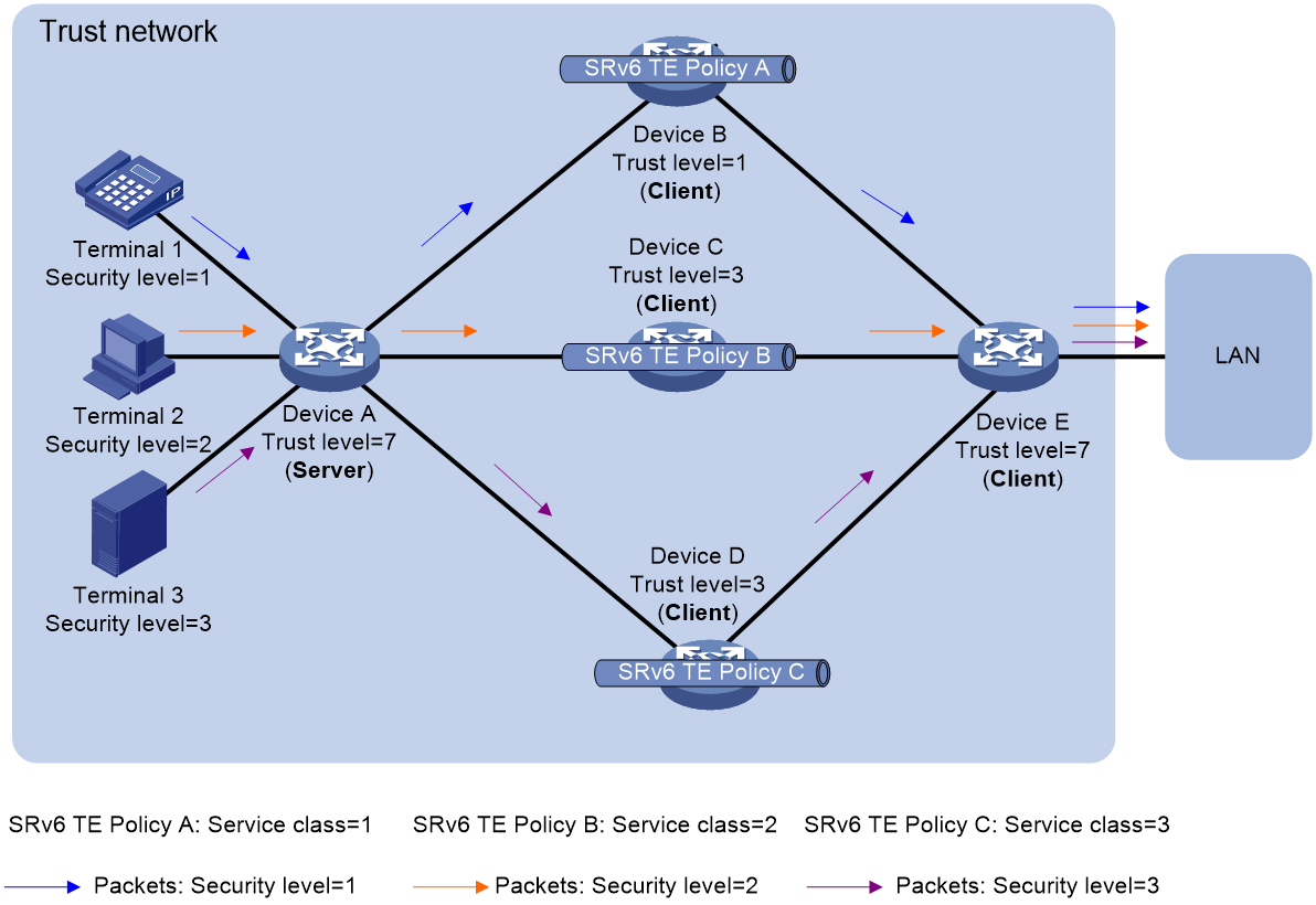

Figure 3 shows a packet forwarding process in a trust network.
Figure 3 Trust network forwarding diagram

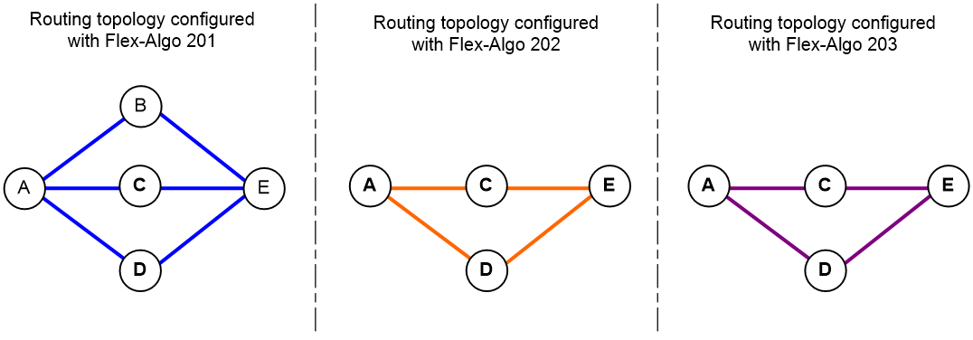

Generating network topologies based on flexible algorithms
1.     A network transmission device deploys the flexible algorithms supported by the device to neighboring devices according to its trust level. If the security levels of the received packets are lower than or equal to the trust level of the device, the flexible algorithms are deployed.
2.     For the trust network shown in the trust network forwarding diagram in "Trusted forwarding mechanism," IS-IS protocol calculates the routing topologies according to IS-IS System IDs and flexible algorithms, as shown in Figure 4.
¡     The trust level of Device A and Device E is 7, and flexible algorithm 201, 202, and 203 are deployed.
¡     The trust level of Device B is 1, and flexible algorithm 201 is deployed.
¡     The trust level of Device C and Device D is 3, and flexible algorithm 201, 202, and 203 are deployed.
Figure 4 Calculated routing topologies

The edge device (Device A) finds the matching SRv6 TE policy tunnel according to the packet security levels and service classes. The candidate path of an SRv6 TE policy is calculated in the corresponding routing topology configured with specific flexible algorithm. If multiple physical paths exist in the routing topology, with an SRv6 TE policy, the traffic can be load shared among multiple paths, or a path can be strictly selected in priority to send the packets to the next network transmission device.
For the routing topologies in the calculated routing topologies diagram, when strictly selecting a physical path, the SRv6 TE policy selects a forwarding path as follows:
·     The service class of the packets with security level 1 is 1, matching with SRv6 TE Policy A. The candidate path Device A > Device B > Device E for SRv6 TE Policy A is calculated in the routing topology configured with flexible algorithm 201.
·     The service class of the packets with security level 2 is 2, matching with SRv6 TE Policy B. The candidate path Device A > Device C > Device E for SRv6 TE Policy B is calculated in the routing topology configured with flexible algorithm 202.
·     The service class of the packets with security level 3 is 3, matching with SRv6 TE Policy C. The candidate path Device A > Device D > Device E for SRv6 TE Policy C is calculated in the routing topology configured with flexible algorithm 203.

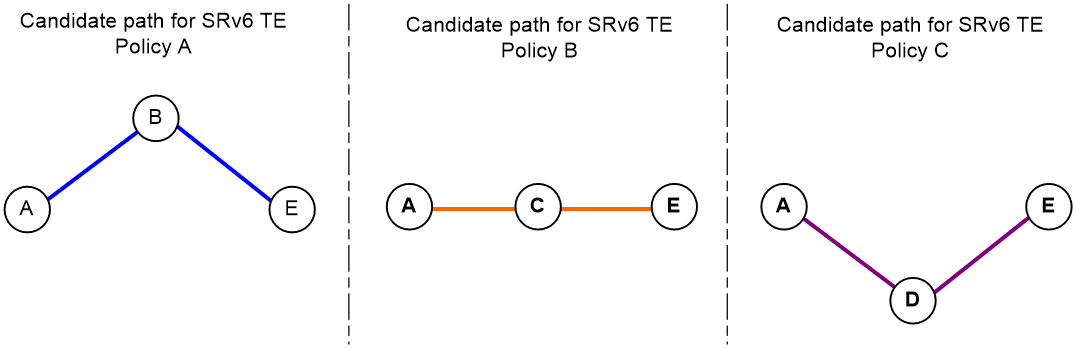

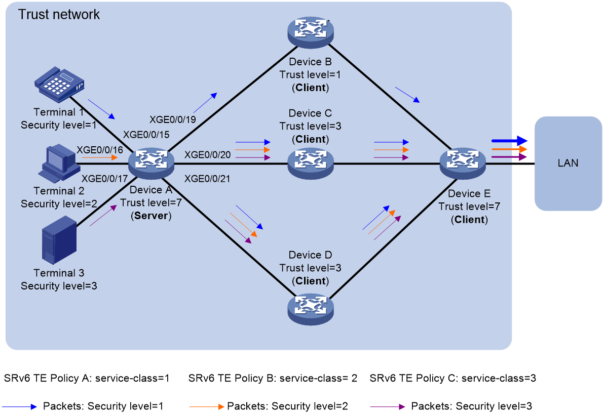

The actual forwarding paths of the packets are finally calculated as shown in Figure 5.
Figure 5 Strictly calculated actual forwarding topologies
For non-edge devices (Device B, Device C, Device D, and Device E), the received packets can be forwarded normally through SRv6 tunnels.

Three terminals are deployed in a trust network: IP phone (with security level 1), host (with security level 2), and DHCP server (with security level 3).
Device A and Device E are the most trusted, with trust level 7. The trust level of Device B is the lowest, which is 1. The trust level of Device C and Device D is medium, which is 3.
According to the security level of the terminals, trusted forwarding of the packets generated by the terminals is as follows:
·     The packets generated by the IP phone are forwarded in three paths: Device A > Device B > Device E, Device A > Device C > Device E, and Device A > Device D > Device E.
·     The packets generated by the host are forwarded in two paths: Device A > Device C > Device E and Device A > Device D > Device E.
·     The packets generated by the DHCP server are forwarded in two paths: Device A > Device C > Device E and Device A > Device D > Device E.
Figure 6 Trust level configuration network diagram

d.     Configure SRv6 TE policies (only Device A).
# Configure SRv6 TE policy tunnels from Device A to Device E.
[DeviceA] segment-routing ipv6
[DeviceA-segment-routing-ipv6] traffic-engineering
[DeviceA-srv6-te] srv6-policy locator a0
[DeviceA-srv6-te] segment-list se130
[DeviceA-srv6-te-sl-se130] index 10 ipv6 EE:130::1
[DeviceA-srv6-te-sl-se130] quit
[DeviceA-srv6-te] policy pe130
[DeviceA-srv6-te-policy-pe130] color 130 end-point ipv6 5::5
[DeviceA-srv6-te-policy-pe130] service-class 1
[DeviceA-srv6-te-policy-pe130] drop-upon-invalid enable
[DeviceA-srv6-te-policy-pe130] candidate-paths
[DeviceA-srv6-te-policy-pe130-path] preference 10
[DeviceA-srv6-te-policy-pe130-path-pref-10] explicit segment-list se130
[DeviceA-srv6-te-policy-pe130-path-pref-10] quit
[DeviceA-srv6-te-policy-pe130-path] quit
[DeviceA-srv6-te-policy-pe130] quit
[DeviceA-srv6-te] segment-list se131
[DeviceA-srv6-te-sl-se131] index 10 ipv6 EE:131::1
[DeviceA-srv6-te-sl-se131] quit
[DeviceA-srv6-te] policy pe131
[DeviceA-srv6-te-policy-pe131] color 131 end-point ipv6 5::5
[DeviceA-srv6-te-policy-pe131] service-class 2
[DeviceA-srv6-te-policy-pe131] drop-upon-invalid enable
[DeviceA-srv6-te-policy-pe131] candidate-paths
[DeviceA-srv6-te-policy-pe131-path] preference 10
[DeviceA-srv6-te-policy-pe131-path-pref-10] explicit segment-list se131
[DeviceA-srv6-te-policy-pe131-path-pref-10] quit
[DeviceA-srv6-te-policy-pe131-path] quit
[DeviceA-srv6-te-policy-pe131] quit
[DeviceA-srv6-te] segment-list se132
[DeviceA-srv6-te-sl-se132] index 10 ipv6 EE:132::1
[DeviceA-srv6-te-sl-se132] quit
[DeviceA-srv6-te] policy pe132
[DeviceA-srv6-te-policy-pe132] color 132 end-point ipv6 5::5
[DeviceA-srv6-te-policy-pe132] service-class 3
[DeviceA-srv6-te-policy-pe132] drop-upon-invalid enable
[DeviceA-srv6-te-policy-pe132] candidate-paths
[DeviceA-srv6-te-policy-pe132-path] preference 10
[DeviceA-srv6-te-policy-pe132-path-pref-10] explicit segment-list se132
[DeviceA-srv6-te-policy-pe132-path-pref-10] quit
[DeviceA-srv6-te-policy-pe132-path] quit
[DeviceA-srv6-te-policy-pe132] quit
[DeviceA-srv6-te] segment-list se133
[DeviceA-srv6-te-sl-se133] index 10 ipv6 EE:133::1
[DeviceA-srv6-te-sl-se133] quit
[DeviceA-srv6-te] policy pe133
[DeviceA-srv6-te-policy-pe133] color 133 end-point ipv6 5::5
[DeviceA-srv6-te-policy-pe133] service-class 4
[DeviceA-srv6-te-policy-pe133] drop-upon-invalid enable
[DeviceA-srv6-te-policy-pe133] candidate-paths
[DeviceA-srv6-te-policy-pe133-path] preference 10
[DeviceA-srv6-te-policy-pe133-path-pref-10] explicit segment-list se133
[DeviceA-srv6-te-policy-pe133-path-pref-10] quit
[DeviceA-srv6-te-policy-pe133-path] quit
[DeviceA-srv6-te-policy-pe133] quit
[DeviceA-srv6-te] segment-list se134
[DeviceA-srv6-te-sl-se134] index 10 ipv6 EE:134::1
[DeviceA-srv6-te-sl-se134] quit
[DeviceA-srv6-te] policy pe134
[DeviceA-srv6-te-policy-pe134] color 134 end-point ipv6 5::5
[DeviceA-srv6-te-policy-pe134] service-class 5
[DeviceA-srv6-te-policy-pe134] drop-upon-invalid enable
[DeviceA-srv6-te-policy-pe134] candidate-paths
[DeviceA-srv6-te-policy-pe134-path] preference 10
[DeviceA-srv6-te-policy-pe134-path-pref-10] explicit segment-list se134
[DeviceA-srv6-te-policy-pe134-path-pref-10] quit
[DeviceA-srv6-te-policy-pe134-path] quit
[DeviceA-srv6-te-policy-pe134] quit
[DeviceA-srv6-te] segment-list se135
[DeviceA-srv6-te-sl-se135] index 10 ipv6 EE:135::1
[DeviceA-srv6-te-sl-se135] quit
[DeviceA-srv6-te] policy pe135
[DeviceA-srv6-te-policy-pe135] color 135 end-point ipv6 5::5
[DeviceA-srv6-te-policy-pe135] service-class 6
[DeviceA-srv6-te-policy-pe135] drop-upon-invalid enable
[DeviceA-srv6-te-policy-pe135] candidate-paths
[DeviceA-srv6-te-policy-pe135-path] preference 10
[DeviceA-srv6-te-policy-pe135-path-pref-10] explicit segment-list se135
[DeviceA-srv6-te-policy-pe135-path-pref-10] quit
[DeviceA-srv6-te-policy-pe135-path] quit
[DeviceA-srv6-te-policy-pe135] quit
[DeviceA-srv6-te] segment-list se136
[DeviceA-srv6-te-sl-se136] index 10 ipv6 EE:136::1
[DeviceA-srv6-te-sl-se136] quit
[DeviceA-srv6-te] policy pe136
[DeviceA-srv6-te-policy-pe136] color 136 end-point ipv6 5::5
[DeviceA-srv6-te-policy-pe136] service-class 7
[DeviceA-srv6-te-policy-pe136] drop-upon-invalid enable
[DeviceA-srv6-te-policy-pe136] candidate-paths
[DeviceA-srv6-te-policy-pe136-path] preference 10
[DeviceA-srv6-te-policy-pe136-path-pref-10] explicit segment-list se136
[DeviceA-srv6-te-policy-pe136-path-pref-10] quit
[DeviceA-srv6-te-policy-pe136-path] quit
[DeviceA-srv6-te-policy-pe136] quit
[DeviceA-srv6-te] segment-list se137
[DeviceA-srv6-te-sl-se137] index 10 ipv6 EE:137::1
[DeviceA-srv6-te-sl-se137] quit
[DeviceA-srv6-te] policy pe137
[DeviceA-srv6-te-policy-pe137] color 137 end-point ipv6 5::5
[DeviceA-srv6-te-policy-pe137] service-class 8
[DeviceA-srv6-te-policy-pe137] drop-upon-invalid enable
[DeviceA-srv6-te-policy-pe137] candidate-paths
[DeviceA-srv6-te-policy-pe137-path] preference 10
[DeviceA-srv6-te-policy-pe137-path-pref-10] explicit segment-list se137
[DeviceA-srv6-te-policy-pe137-path-pref-10] quit
[DeviceA-srv6-te-policy-pe137-path] quit
[DeviceA-srv6-te-policy-pe137] quit
[DeviceA-srv6-te] quit
[DeviceA-segment-routing-ipv6] quit
e.     Configure static route-based traffic steering.
# Configure IPv6 static routes for steering matching traffic to the SRv6 TE policies.
[DeviceA] ipv6 route-static 123:456:: 64 srv6-policy name pe130
[DeviceA] ipv6 route-static 123:456:: 64 srv6-policy name pe131
[DeviceA] ipv6 route-static 123:456:: 64 srv6-policy name pe132
[DeviceA] ipv6 route-static 123:456:: 64 srv6-policy name pe133
[DeviceA] ipv6 route-static 123:456:: 64 srv6-policy name pe134
[DeviceA] ipv6 route-static 123:456:: 64 srv6-policy name pe135
[DeviceA] ipv6 route-static 123:456:: 64 srv6-policy name pe136
[DeviceA] ipv6 route-static 123:456:: 64 srv6-policy name pe137
2.     Configure Device B (trust level client):
# Enter trust-level view.
<DeviceB> system-view
[DeviceB] trust-level
# Configure Device B to operate in the client mode.
[DeviceB-trust-level] client enable
# Configure the parameters of the trust level server on Device B.
[DeviceB-trust-level-client] server ipv6-address 1::1 ssl-client-policy trust
[DeviceB-trust-level-client] quit
[DeviceB-trust-level] quit
Configure Device C, Device D, and Device E in the same way. (Details not shown.)
By using a packet capture tool to capture the packets, very that the packets are forwarded as follows:
·     The packets generated by the host are forwarded in two paths: Device A > Device C > Device E, Device A > Device D > Device E.
·     The packets generated by the DHCP server are forwarded in two paths: Device A > Device C > Device E, Device A > Device D > Device E.
