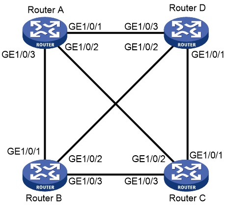

As shown in Figure 4, the same level routers on a network, including non-DIS routers, establish adjacency with each other.
Figure 4 DIS in the IS-IS broadcast network
The DIS creates and updates pseudonodes, and generates LSPs for the pseudonodes, to describe all routers on the network.
A pseudonode represents a virtual node on the broadcast network. It is not a real router. In IS-IS, it is identified by the system ID of the DIS and a 1-byte Circuit ID (a non-zero value).
Using pseudonodes simplifies network topology and can reduce the amount of resources consumed by SPF.
·     On an IS-IS broadcast network, all routers establish adjacency relationships, but they synchronize their LSDBs through the DIS.

Configuring IPv6 IS-IS MTR
On a network, IPv4 and IPv6 topologies must be consistent so that both IPv6 IS-IS and IPv4 IS-IS can use the SPF algorithm to perform route calculation. If they are different, routers supporting both IPv4 and IPv6 might send IPv6 packets to routers that do not support IPv6, resulting in packet loss.
To resolve this issue, configure IPv6 IS-IS MTR to perform route calculation separately in IPv4 and IPv6 topologies.
Figure 7 Network diagram
As shown in Figure 7, the numbers refer to the link costs. Router A, Router B, and Router D support both IPv4 and IPv6. Router C supports only IPv4 and cannot forward IPv6 packets.
Enable IPv6 IS-IS MTR on Router A, Router B, Router C, and Router D to make them perform route calculation separately in IPv4 and IPv6 topologies. With this configuration, Router A does not forward IPv6 packets destined to Router D through Router B, avoiding packet loss.

Limiting LSP flooding
On an NBMA network, many P2P links might exist. As shown in Figure 8, Routers A, B, C and D run IS-IS. When Router A generates an LSP, it floods the LSP out of GigabitEthernet1/0/1, GigabitEthernet1/0/2, and GigabitEthernet1/0/3. After Router D receives the LSP from GigabitEthernet1/0/3, it floods it out of GigabitEthernet1/0/1 and GigabitEthernet1/0/2 to Router B and Router C. However, Router B and Router C have already received the LSP from Router A. Repeated LSP flooding consumes extra bandwidth.
Figure 8 Network diagram of a fully meshed network
To avoid this problem, you can add interfaces to a mesh group or block some interfaces.
·     An interface in a mesh group floods a received LSP only to interfaces not in the mesh group.
·     A blocked interface sends LSPs only after receiving LSP requests.
Before you configure this task, you must consider redundancy for interfaces in case LSP packets cannot be flooded because of link failures.

Figure 9 Network diagram for IS-IS FRR
In Figure 9, after you enable FRR on Router B, IS-IS automatically calculates or designates a backup next hop when a link failure is detected. In this way, packets are directed to the backup next hop to reduce traffic recovery time. Meanwhile, IS-IS calculates the shortest path based on the new network topology, and forwards packets over the path after network convergence.
You can assign a backup next hop for IS-IS FRR through the following ways:
·     Enable IS-IS FRR to calculate a backup next hop through Loop Free Alternate (LFA) calculation.
·     Designate a backup next hop with a routing policy for routes matching specific criteria.
The LFA calculation of FRR and that of TE are mutually exclusive.
