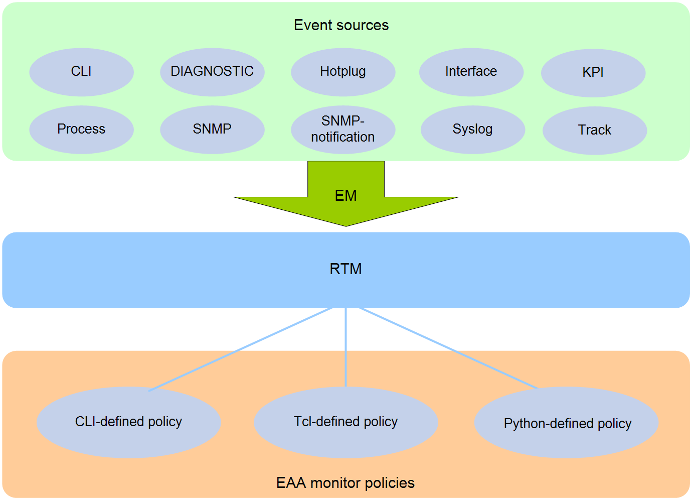

Embedded Automation Architecture (EAA) is a monitoring framework that enables you to self-define monitored events and actions to take in response to an event. It allows you to create monitor policies by using the CLI or Tcl scripts.
EAA framework
EAA framework includes a set of event sources, a set of event monitors, a real-time event manager (RTM), and a set of user-defined monitor policies, as shown in Figure 1.
Figure 1 EAA framework
Event sources
Event sources are software or hardware modules that trigger events (see Figure 1).
For example, the CLI module triggers an event when you enter a command. The Syslog module (the information center) triggers an event when it receives a log message.
Event monitors
EAA creates one event monitor to monitor the system for the event specified in each monitor policy. An event monitor notifies the RTM to run the monitor policy when the monitored event occurs.
RTM
RTM manages the creation, state machine, and execution of monitor policies.
EAA monitor policies
A monitor policy specifies the event to monitor and actions to take when the event occurs.
You can configure EAA monitor policies by using the CLI, Tcl, or Python.

Elements in a monitor policy
Elements in an EAA monitor policy include event, action, user role, and runtime.

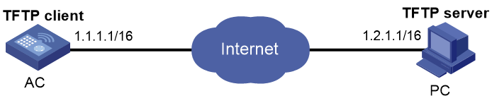

Example: Configuring a CLI event monitor policy by using Tcl
As shown in Figure 2, use Tcl to create a monitor policy on the AC. This policy must meet the following requirements:
·     EAA sends the log message "rtm_tcl_test is running" when a command that contains the display this string is entered.
·     The system executes the command only after it executes the policy successfully.
Figure 2 Network diagram
# Edit a Tcl script file (rtm_tcl_test.tcl, in this example) for EAA to send the message "rtm_tcl_test is running" when a command that contains the display this string is executed.
::platformtools::rtm::event_register cli sync mode execute pattern display this user-role network-admin
::platformtools::rtm::action syslog priority 1 facility local4 msg rtm_tcl_test is running
# Download the Tcl script file from the TFTP server at 1.2.1.1.
<AC> tftp 1.2.1.1 get rtm_tcl_test.tcl
# Create Tcl-defined policy test and bind it to the Tcl script file.
<AC> system-view
[AC] rtm tcl-policy test rtm_tcl_test.tcl
[AC] quit
# Execute the display rtm policy registered command to verify that a Tcl-defined policy named test is displayed in the command output.
<AC> display rtm policy registered
Total number: 1
Type  Event             TimeRegistered       PolicyName
TCL   CLI               May 06 09:47:12 2019 test
# Enable the information center to output log messages to the current monitoring terminal.
<AC> terminal monitor
The current terminal is enabled to display logs.
<AC> system-view
[AC] info-center enable
Information center is enabled.
[AC] quit
# Execute the display this command. Verify that the system displays an "rtm_tcl_test is running" message and a message that the policy is being executed successfully.
<AC> display this
%Jan  1 09:50:04:634 2019 AC RTM/1/RTM_ACTION: rtm_tcl_test is running
%Jan  1 09:50:04:634 2019 AC RTM/6/RTM_POLICY: TCL policy test is running successfully.
