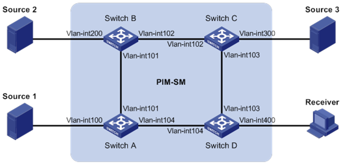

Example: Configuring IGMP SSM mapping
As shown in Figure 6:
·     OSPF runs on the network.
·     The PIM-SM domain uses the SSM model for multicast delivery. The SSM group range is 232.1.1.0/24.
·     IGMPv3 runs on VLAN-interface 400 of Switch D. The receiver host runs IGMPv2, and does not support IGMPv3. The receiver host cannot specify multicast sources in its membership reports.
·     Source 1, Source 2, and Source 3 send multicast packets to multicast groups in the SSM group range 232.1.1.0/24.
Configure the IGMP SSM mapping feature on Switch D so that the receiver host can receive multicast data only from Source 1 and Source 3.
Figure 6 Network diagram

Assign an IP address and subnet mask to each interface as shown in Figure 6, and configure OSPF on the switches in the PIM-SM domain. (Details not shown.)
1.     Enable IP multicast routing, PIM-SM, and IGMP:
# On Switch D, enable IP multicast routing.
<SwitchD> system-view
[SwitchD] multicast routing
[SwitchD-mrib] quit
# Enable IGMPv3 on the receiver-side interface (VLAN-interface 400).
[SwitchD] interface vlan-interface 400
[SwitchD-Vlan-interface400] igmp enable
[SwitchD-Vlan-interface400] igmp version 3
[SwitchD-Vlan-interface400] quit
# Enable PIM-SM on the other interfaces.
[SwitchD] interface vlan-interface 103
[SwitchD-Vlan-interface103] pim sm
[SwitchD-Vlan-interface103] quit
[SwitchD] interface vlan-interface 104
[SwitchD-Vlan-interface104] pim sm
[SwitchD-Vlan-interface104] quit
# On Switch A, enable IP multicast routing.
<SwitchA> system-view
[SwitchA] multicast routing
[SwitchA-mrib] quit
# Enable PIM-SM on each interface.
[SwitchA-Vlan-interface100] pim sm
[SwitchA] interface vlan-interface 101
[SwitchA-Vlan-interface101] pim sm
[SwitchA-Vlan-interface101] quit
[SwitchA] interface vlan-interface 104
[SwitchA-Vlan-interface104] pim sm
[SwitchA-Vlan-interface104] quit

2.     Configure the SSM group range:
# On Switch D, specify 232.1.1.0/24 as the SSM group range.
[SwitchD] acl basic 2000
[SwitchD-acl-ipv4-basic-2000] rule permit source 232.1.1.0 0.0.0.255
[SwitchD-acl-ipv4-basic-2000] quit
[SwitchD] pim
[SwitchD-pim] ssm-policy 2000
[SwitchD-pim] quit
# Configure the SSM group range on Switch A, Switch B, and Switch C in the same way Switch D is configured. (Details not shown.)
3.     Configure IGMP SSM mappings on Switch D.
[SwitchD] igmp
[SwitchD-igmp] ssm-mapping 133.133.1.1 2000
[SwitchD-igmp] ssm-mapping 133.133.3.1 2000
[SwitchD-igmp] quit
# Display IGMP SSM mappings for multicast group 232.1.1.1 on Switch D.
[SwitchD] display igmp ssm-mapping 232.1.1.1
 Group: 232.1.1.1
 Source list:
        133.133.1.1
        133.133.3.1
# On Switch D, display information about IGMP multicast groups that hosts have dynamically joined.
[SwitchD] display igmp group
IGMP groups in total: 1
 Vlan-interface400(133.133.4.2):
  IGMP groups reported in total: 1
   Group address   Last reporter   Uptime      Expires
   232.1.1.1       133.133.4.1     00:02:04    off
# Display PIM routing entries on Switch D.
[SwitchD] display pim routing-table
 Total 0 (*, G) entry; 2 (S, G) entry
 (133.133.1.1, 232.1.1.1)
     Protocol: pim-ssm, Flag:
     UpTime: 00:13:25
     Upstream interface: Vlan-interface104
         Upstream neighbor: 192.168.4.2
         RPF prime neighbor: 192.168.4.2
     Downstream interface information:
     Total number of downstream interfaces: 1
         1: Vlan-interface400
             Protocol: igmp, UpTime: 00:13:25, Expires: -
 (133.133.3.1, 232.1.1.1)
     UpTime: 00:13:25
     Upstream interface: Vlan-interface103
         Upstream neighbor: 192.168.3.1
         RPF prime neighbor: 192.168.3.1
