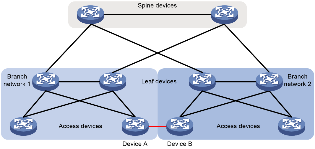

As shown in Figure 1, Device A and Device B belongs to different branch networks. If a link exists between Device A and Device B, a loop might occur in the network. After configuring LLDP cross-domain detection, you can manually assign the devices to different domains, and use LLDP to detect whether the specified LLDP neighbor is in the local domain. In addition, you can block the link to neighbors in other domains to eliminate the potential loop risk.
Figure 1 LLDP cross-domain detection application scenario

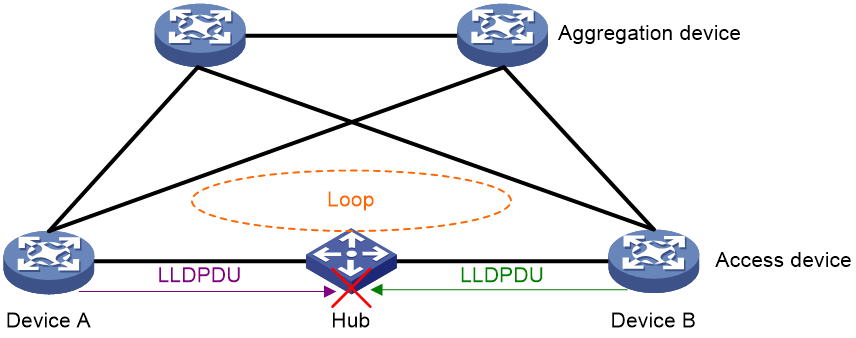

Figure 2 LLDP black hole detection application scenario
As shown in Figure 2, Device A and Device B are connected through a hub, causing a loop in the network. However, since LLDP packets are point-to-point packets, they are terminated at the next node after being sent from the device. Therefore, the HUB acts as a black hole for LLDP packets. LLDP packets cannot be transmitted between Device A and Device B through the HUB. As a result, Device A and Device B cannot use LLDP to learn about the physical link between them and the formed loop, and therefore the loop cannot be eliminated in time. In order to eliminate potential loop risks, it required to detect LLDP black holes and block the links leading to the black holes.
The LLDP black hole detection feature takes effect only if the following conditions are met:
·     On both ends of the LLDP connection, both global and port-level LLDP black hole detection functions are enabled.
·     On the ports with LLDP black hole detection enabled, the link status is UP, LLDP is enabled, and the operating mode is TxRx.

lldp timer rx-blackhole-timeout
Use lldp timer rx-blackhole-timeout to configure the timeout for receiving LLDP black hole detection packets on a port.
Use undo lldp timer rx-blackhole-timeout to restore the default.
This command is available only in Release 1125 and later.
Syntax
lldp timer rx-blackhole-timeout timeout
undo timer lldp tx-blackhole-timeout
Default
The timeout for a port to receive LLDP black hole detection packets is (the port’s sending interval for LLDP black hole detection packets × 3 + 10) seconds.
Views
Layer 2 Ethernet interface view
Predefined user roles
network-admin
Parameters
timeout: Specifies the timeout for receiving LLDP black hole detection packets, in the range of 10 to 65535, in seconds.
Usage guidelines
Operating mechanism
When a port is blocked by LLDP black hole detection, the port starts the LLDP black hole detection packet receiving timer. Before the timer times out, the port resets the timer and remains in a blocked state when it receives an LLDP black hole detection packet. After the timer times out, the port resumes normal forwarding.
The timeout for receiving LLDP black hole detection packets on a port can be configured by using the lldp timer rx-blackhole-timeout and lldp global timer rx-blackhole-timeout commands. When both commands are executed, the lldp timer rx-blackhole-timeout command takes precedence. If a port is not configured with a timeout, it uses the global timeout set by the lldp global timer rx-blackhole-timeout command.
The timeout for receiving LLDP black hole detection packets on the local device should not be less than the interval for sending LLDP black hole detection packets on the peer device. Otherwise, LLDP black hole detection will not take effect.
Examples
# Configure the timeout for receiving LLDP black hole detection packets as 12 seconds on port GigabitEthernet 1/0/1.
<Sysname> system-view
[Sysname] interface gigabitethernet 1/0/1
[Sysname-GigabitEthernet1/0/1] lldp timer rx-blackhole-timeout 12
Related commands
lldp blackhole-detection enable
lldp global blackhole-detection enable
lldp global timer blackhole-detection-interval
lldp timer blackhole-detection-interval
