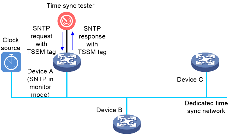

Figure 1 Basic work flow
The synchronization process is as follows:
1.     Device A sends Device B an NTP message, which is timestamped when it leaves Device A. The time stamp is 10:00:00 am (T1).
2.     When this NTP message arrives at Device B, Device B adds a timestamp showing the time when the message arrived at Device B. The timestamp is 11:00:01 am (T2).
3.     When the NTP message leaves Device B, Device B adds a timestamp showing the time when the message left Device B. The timestamp is 11:00:02 am (T3).
4.     When Device A receives the NTP message, the local time of Device A is 10:00:03 am (T4).
Up to now, Device A can calculate the following parameters based on the timestamps:
·     The roundtrip delay of the NTP message: Delay = (T4 – T1) – (T3 – T2) = 2 seconds.
·     Time difference between Device A and Device B: Offset = [ (T2 – T1) + (T3 – T4) ] /2 = 1 hour.
Based on these parameters, Device A can be synchronized to Device B.

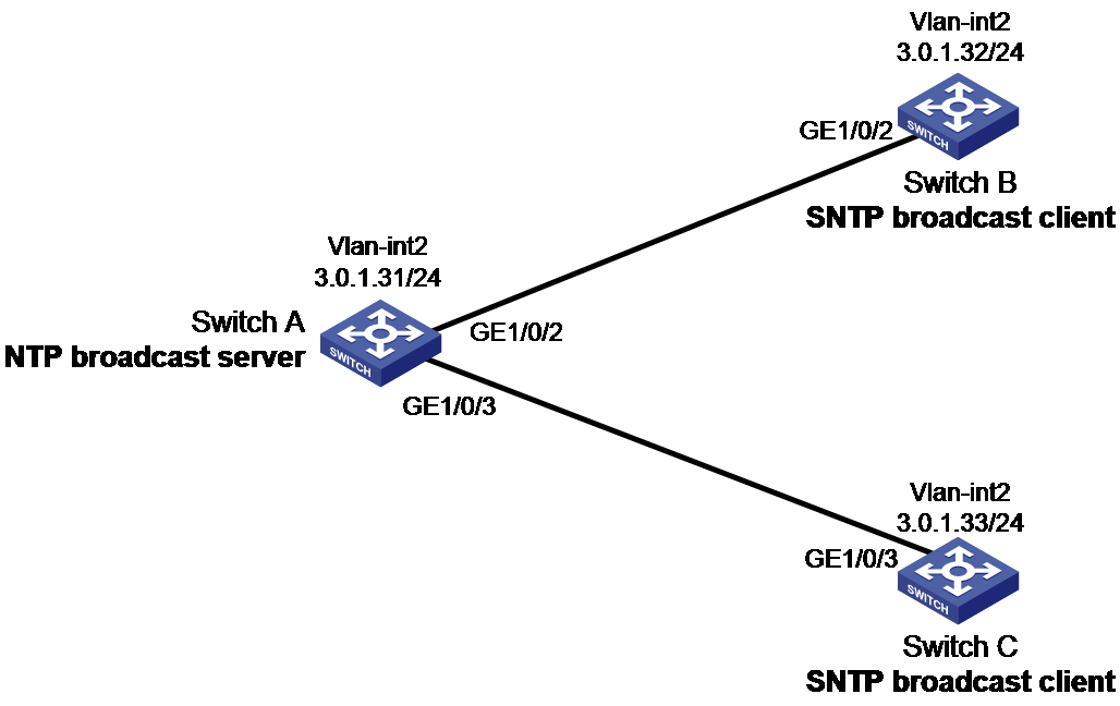

NTP uses stratums 0 to 16 to define clock accuracy, as shown in Figure 2. A lower stratum value represents higher accuracy.
Figure 2 NTP architecture
A stratum 1 NTP server gets its time from an authoritative time source, such as an atomic clock. It provides time for other devices as the primary NTP server. A stratum 2 time server receives its time from a stratum 1 time server, and so on.
To ensure time accuracy and availability, you can specify multiple NTP servers for a device. The device selects an optimal NTP server as the clock source based on parameters such as stratum. The clock that the device selects is called the reference source. For more information about clock selection, see the related protocols and standards.
If the devices in a network cannot synchronize to an authoritative time source, you can perform the following tasks:
·     Select a device that has a relatively accurate clock from the network.
·     Use the local clock of the device as the reference clock to synchronize other devices in the network.

Example: Configuring NTP client/server association mode
As shown in Figure 4, perform the following tasks:
·     Configure Device A's local clock as its reference source, with stratum level 2.
·     Configure Device B to operate in client mode and specify Device A as the NTP server of Device B.
Figure 4 Network diagram
1.     Assign an IP address to each interface, and make sure Device A and Device B can reach each other, as shown in Figure 4. (Details not shown.)
2.     Configure Device A:
# Enable the NTP service.
<DeviceA> system-view
[DeviceA] ntp-service enable
# Specify the local clock as the reference source, with stratum level 2.
[DeviceA] ntp-service refclock-master 2
3.     Configure Device B:
<DeviceB> system-view
[DeviceB] ntp-service enable
# Specify NTP for obtaining the time.
[DeviceB] clock protocol ntp
# Specify Device A as the NTP server of Device B.
[DeviceB] ntp-service unicast-server 1.0.1.11
# Verify that Device B has synchronized its time with Device A, and the clock stratum level of Device B is 3.
[DeviceB] display ntp-service status
 Clock status: synchronized
 Clock stratum: 3
 System peer: 1.0.1.11
 Local mode: client
 Reference clock ID: 1.0.1.11
 Leap indicator: 00
 Clock jitter: 0.000977 s
 Stability: 0.000 pps
 Clock precision: 2^-20
 Root delay: 0.00383 ms
 Root dispersion: 16.26572 ms
 Reference time: d0c6033f.b9923965  Wed, Dec 29 2019 18:58:07.724
 System poll interval: 64 s
# Verify that an IPv4 NTP association has been established between Device B and Device A.
[DeviceB] display ntp-service sessions
       source          reference       stra reach poll  now offset  delay disper
[12345]1.0.1.11        127.127.1.0        2     1   64   15   -4.0 0.0038 16.262
Notes: 1 source(master), 2 source(peer), 3 selected, 4 candidate, 5 configured.
 Total sessions: 1

Example: Configuring NTP symmetric active/passive association mode
As shown in Figure 6, perform the following tasks:
·     Configure Device A to operate in symmetric active mode and specify Device B as the passive peer of Device A.
Figure 6 Network diagram
1.     Assign an IP address to each interface, and make sure Device A and Device B can reach each other, as shown in Figure 6. (Details not shown.)
2.     Configure Device B:
3.     Configure Device A:
[DeviceA] clock protocol ntp
# Configure Device B as its symmetric passive peer.
[DeviceA] ntp-service unicast-peer 3.0.1.32
# Verify that Device B has synchronized its time with Device A.
 Clock stratum: 3
 System peer: 3.0.1.31
 Local mode: sym_passive
 Reference clock ID: 3.0.1.31
 Leap indicator: 00
 Clock jitter: 0.000916 s
 Root delay: 0.00609 ms
 Root dispersion: 1.95859 ms
 Reference time: 83aec681.deb6d3e5  Wed, Jan  8 2019 14:33:11.081
   [12]3.0.1.31        127.127.1.0        2    62   64   34 0.4251 6.0882 1392.1
 Total sessions: 1

Example: Configuring NTP broadcast association mode
As shown in Figure 8, configure Switch C as the NTP server for multiple devices on the same network segment so that these devices synchronize the time with Switch C.
·     Configure Switch C's local clock as its reference source, with stratum level 2.
·     Configure Switch C to operate in broadcast server mode and send broadcast messages from VLAN-interface 2.
·     Configure Switch A and Switch B to operate in broadcast client mode, and listen to broadcast messages on VLAN-interface 2.
Figure 8 Network diagram
1.     Assign an IP address to each interface, and make sure Switch A, Switch B, and Switch C can reach each other, as shown in Figure 8. (Details not shown.)
2.     Configure Switch C:
<SwitchC> system-view
[SwitchC] ntp-service enable
[SwitchC] clock protocol ntp
[SwitchC] ntp-service refclock-master 2
# Configure Switch C to operate in broadcast server mode and send broadcast messages from VLAN-interface 2.
[SwitchC] interface vlan-interface 2
[SwitchC-Vlan-interface2] ntp-service broadcast-server
3.     Configure Switch A:
<SwitchA> system-view
[SwitchA] ntp-service enable
[SwitchA] clock protocol ntp
# Configure Switch A to operate in broadcast client mode and receive broadcast messages on VLAN-interface 2.
[SwitchA-Vlan-interface2] ntp-service broadcast-client
4.     Configure Switch B:
<SwitchB> system-view
[SwitchB] ntp-service enable
[SwitchB] clock protocol ntp
# Configure Switch B to operate in broadcast client mode and receive broadcast messages on VLAN-interface 2.
[SwitchB-Vlan-interface2] ntp-service broadcast-client
The following procedure uses Switch A as an example to verify the configuration.
# Verify that Switch A has synchronized to Switch C, and the clock stratum level is 3 on Switch A and 2 on Switch C.
[SwitchA-Vlan-interface2] display ntp-service status
 Clock stratum: 3
 Local mode: bclient
 Leap indicator: 00
 Clock jitter: 0.044281 s
 Root delay: 0.00229 ms
 Root dispersion: 4.12572 ms
 Reference time: d0d289fe.ec43c720  Sat, Jan  8 2019  7:00:14.922
# Verify that an IPv4 NTP association has been established between Switch A and Switch C.
[SwitchA-Vlan-interface2] display ntp-service sessions
 [1245]3.0.1.31        127.127.1.0        2     1   64  519   -0.0 0.0022 4.1257
Notes: 1 source(master),2 source(peer),3 selected,4 candidate,5 configured.
 Total sessions: 1

Example: Configuring NTP authentication in client/server association mode
As shown in Figure 11, perform the following tasks:
·     Configure NTP authentication on both Device A and Device B.
Figure 11 Network diagram
1.     Assign an IP address to each interface, and make sure Device A and Device B can reach each other, as shown in Figure 11. (Details not shown.)
# Enable NTP authentication on Device B.
[DeviceB] ntp-service authentication enable
# Create a plaintext authentication key, with key ID 42 and key value aNiceKey.
[DeviceB] ntp-service authentication-keyid 42 authentication-mode md5 simple aNiceKey
# Specify the key as a trusted key.
[DeviceB] ntp-service reliable authentication-keyid 42
# Specify Device A as the NTP server of Device B, and associate the server with key 42.
[DeviceB] ntp-service unicast-server 1.0.1.11 authentication-keyid 42
To enable Device B to synchronize its clock with Device A, enable NTP authentication on Device A.
4.     Configure NTP authentication on Device A:
# Enable NTP authentication.
[DeviceA] ntp-service authentication enable
[DeviceA] ntp-service authentication-keyid 42 authentication-mode md5 simple aNiceKey
[DeviceA] ntp-service reliable authentication-keyid 42
 Clock stratum: 3
 Local mode: client
 Leap indicator: 00
 Clock jitter: 0.005096 s
 Root delay: 0.00655 ms
 Root dispersion: 1.15869 ms
 Reference time: d0c62687.ab1bba7d  Wed, Dec 29 2019 21:28:39.668
 [1245]1.0.1.11        127.127.1.0        2     1   64  519   -0.0 0.0065    0.0
 Total sessions: 1
Example: Configuring NTP authentication in broadcast association mode
As shown in Figure 12, configure Switch C as the NTP server for multiple devices on the same network segment so that these devices synchronize the time with Switch C. Configure Switch A and Switch B to authenticate the NTP server.
·     Configure Switch C's local clock as its reference source, with stratum level 3.
·     Configure Switch A and Switch B to operate in broadcast client mode and receive broadcast messages on VLAN-interface 2.
·     Enable NTP authentication on Switch A, Switch B, and Switch C.
Figure 12 Network diagram
1.     Assign an IP address to each interface, and make sure Switch A, Switch B, and Switch C can reach each other, as shown in Figure 12. (Details not shown.)

5.     Verify the configuration:
NTP authentication is enabled on Switch A and Switch B, but not on Switch C, so Switch A and Switch B cannot synchronize their local clocks to Switch C.
[SwitchB-Vlan-interface2] display ntp-service status
 Clock status: unsynchronized
 Clock stratum: 16
 Reference clock ID: none
6.     Enable NTP authentication on Switch C:
# Enable NTP authentication on Switch C. Create a plaintext NTP authentication key, with key ID of 88 and key value of 123456. Specify it as a trusted key.
[SwitchC] ntp-service authentication enable
[SwitchC] ntp-service authentication-keyid 88 authentication-mode md5 simple 123456
[SwitchC] ntp-service reliable authentication-keyid 88
# Specify Switch C as an NTP broadcast server, and associate key 88 with Switch C.
[SwitchC-Vlan-interface2] ntp-service broadcast-server authentication-keyid 88
# Verify that Switch B has synchronized its time with Switch C, and the clock stratum level of Switch B is 4.
 Clock stratum: 4
 Local mode: bclient
 Leap indicator: 00
 Clock jitter: 0.006683 s
 Root delay: 0.00127 ms
 Root dispersion: 2.89877 ms
 Reference time: d0d287a7.3119666f  Sat, Jan  8 2019  6:50:15.191
# Verify that an IPv4 NTP association has been established between Switch B and Switch C.
[SwitchB-Vlan-interface2] display ntp-service sessions
 [1245]3.0.1.31        127.127.1.0        3     3   64   68   -0.0 0.0000    0.0
 Total sessions: 1

Figure 13 SNTP operating in monitor mode
Operating mechanism
The Time Synchronization Status Monitoring (TSSM) tag in SNTP packets is used to enhance the security and reliability of the time synchronization process. The TSSM tag is typically used in time synchronization applications with higher security levels to ensure that responses are made only to SNTP requests from known and trusted time sources.
When the device acts as an SNTP client, the packets it send do not carry the TSSM tag, and it can synchronize time with the SNTP server.
When SNTP is enabled, the SNTP server functionality is automatically enabled on the device. When the device operates as an SNTP server:
·     By default, when the device receives an SNTP request, it processes it as a clock synchronization request regardless of whether it carries the TSSM flag, and responds with a packet that does not contain the TSSM flag.
·     If this command is configured, the SNTP server will identify whether the received SNTP request contains the TSSM flag. If the request does not contain the TSSM flag, the device will discard the request. The device responds to the request only if the request contains the TSSM flag.
After this feature is configured, the device can synchronize its clock as an SNTP client with upstream devices, but it cannot provide SNTP time synchronization services to downstream devices.

Example: Configuring SNTP in broadcast association mode
As shown in Figure 15, configure Switch A as the NTP broadcast server to provide NTP clock synchronization for other devices on the LAN.
·     On Switch A, configure the local clock as the reference source, with stratum level 2.
·     Configure Switch A to operate in broadcast server mode and send broadcast messages from VLAN-interface 2.
·     Configure Switch B and Switch C to operate in broadcast client mode, and listen to broadcast messages on VLAN-interface 2.
Figure 15 Network diagram
