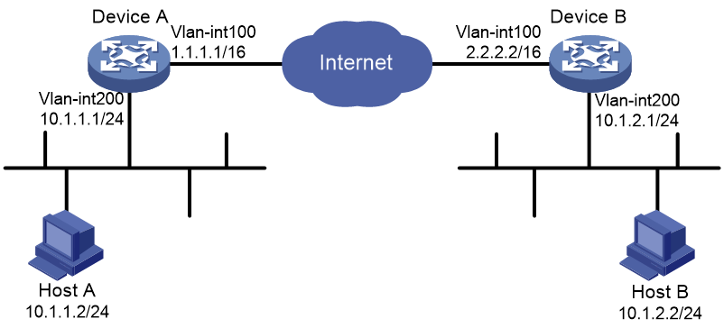

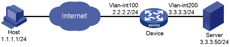

Figure 1 IPsec protection in transport mode
Tunnel mode
The security protocols protect the entire IP packet. The entire IP packet is used to calculate the security protocol headers. The calculated security protocol headers and the encrypted data (only for ESP encapsulation) are encapsulated in a new IP packet. In this mode, the encapsulated packet has two IP headers. The inner IP header is the original IP header. The outer IP header is added by the network device that provides the IPsec service. You must use the tunnel mode when the secured transmission start and end points are not the actual start and end points of the data packets (for example, when two gateways provide IPsec but the data start and end points are two hosts behind the gateways). The tunnel mode is typically used for protecting gateway-to-gateway communications, as shown in Figure 2.
Figure 2 IPsec protection in tunnel mode

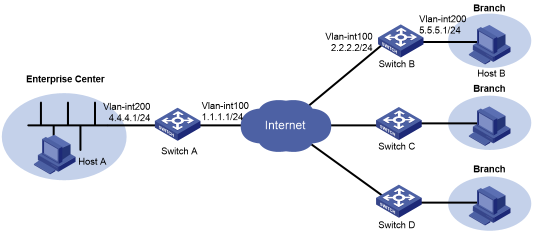

IPsec RRI
IPsec Reverse Route Injection (RRI) enables an IPsec tunnel gateway to automatically add and delete static routes destined for the protected private networks. It automatically adds the static routes when the IPsec SAs are established and deletes the static routes when the IPsec SAs are deleted. This greatly reduces the static route configuration work load on the gateway and increases the scalability of the IPsec VPN.
IPsec RRI is applicable to gateways that must provide many IPsec tunnels (for example, a headquarters gateway).
As shown in Figure 4, the traffic between the enterprise center and the branches are protected by IPsec. The gateway at the enterprise center is configured with static routes to route traffic to the IPsec-protected interfaces. It is difficult to add or modify static routes on the gateway at the enterprise center if the IPsec VPN has a large number of branches or if the network structure changes.
Figure 4 IPsec VPN
After you can enable IPsec RRI on the gateway, the gateway automatically adds a static route to the routing table each time an IPsec tunnel is established. The destination IP address is the protected private network, and the next hop is the remote IP address of the IPsec tunnel. Traffic destined for the peer end is routed to the IPsec tunnel interface and thereby protected by IPsec.
You can advertise the static routes created by IPsec RRI in the internal network, and the internal network device can use them to forward traffic in the IPsec VPN.
You can set preferences for the static routes created by IPsec RRI to implement flexible route management. For example, you can set the same preference for multiple routes to the same destination to implement load sharing, or you can set different preferences to implement route backup.
You can also set tags for the static routes created by IPsec RRI to implement flexible route control through routing policies.

Example: Configuring a manual mode IPsec tunnel for IPv4 packets
As shown in Figure 7, establish an IPsec tunnel between Switch A and Switch B to protect data flows between the switches. Configure the tunnel as follows:
·     Specify the encapsulation mode as tunnel, the security protocol as ESP, the encryption algorithm as AES-CBC-192, and the authentication algorithm as HMAC-SHA1.
·     Manually set up IPsec SAs.
Figure 7 Network diagram
1.     Configure Switch A:
# Configure an IP address for VLAN-interface 1.
<SwitchA> system-view
[SwitchA] interface vlan-interface 1
[SwitchA-Vlan-interface1] ip address 2.2.2.1 255.255.255.0
[SwitchA-Vlan-interface1] quit
# Configure an IPv4 advanced ACL to identify the data flows between Switch A and Switch B.
[SwitchA] acl advanced 3101
[SwitchA-acl-ipv4-adv-3101] rule 0 permit ip source 2.2.2.1 0 destination 2.2.3.1 0
[SwitchA-acl-ipv4-adv-3101] quit
# Create an IPsec transform set named tran1.
[SwitchA] ipsec transform-set tran1
# Specify the encapsulation mode as tunnel.
[SwitchA-ipsec-transform-set-tran1] encapsulation-mode tunnel
# Specify the security protocol as ESP.
[SwitchA-ipsec-transform-set-tran1] protocol esp
# Specify the ESP encryption and authentication algorithms.
[SwitchA-ipsec-transform-set-tran1] esp encryption-algorithm aes-cbc-192
[SwitchA-ipsec-transform-set-tran1] esp authentication-algorithm sha1
[SwitchA-ipsec-transform-set-tran1] quit
# Create a manual IPsec policy entry. Specify the policy name as map1 and set the sequence number to 10.
[SwitchA] ipsec policy map1 10 manual
# Specify ACL 3101.
[SwitchA-ipsec-policy-manual-map1-10] security acl 3101
# Specify IPsec transform set tran1.
[SwitchA-ipsec-policy-manual-map1-10] transform-set tran1
# Specify the remote IP address of the IPsec tunnel as 2.2.3.1.
[SwitchA-ipsec-policy-manual-map1-10] remote-address 2.2.3.1
# Configure inbound and outbound SPIs for ESP.
[SwitchA-ipsec-policy-manual-map1-10] sa spi outbound esp 12345
[SwitchA-ipsec-policy-manual-map1-10] sa spi inbound esp 54321
# Configure the inbound and outbound SA keys for ESP.
[SwitchA-ipsec-policy-manual-map1-10] sa string-key outbound esp simple abcdefg
[SwitchA-ipsec-policy-manual-map1-10] sa string-key inbound esp simple gfedcba
[SwitchA-ipsec-policy-manual-map1-10] quit
# Apply IPsec policy map1 to VLAN-interface 1.
[SwitchA-Vlan-interface1] ipsec apply policy map1
2.     Configure Switch B:
<SwitchB> system-view
[SwitchB] interface vlan-interface 1
[SwitchB-Vlan-interface1] ip address 2.2.3.1 255.255.255.0
[SwitchB-Vlan-interface1] quit
# Configure an IPv4 advanced ACL to identify the data flows between Switch B and Switch A.
[SwitchB] acl advanced 3101
[SwitchB-acl-ipv4-adv-3101] rule 0 permit ip source 2.2.3.1 0 destination 2.2.2.1 0
[SwitchB-acl-ipv4-adv-3101] quit
[SwitchB] ipsec transform-set tran1
[SwitchB-ipsec-transform-set-tran1] encapsulation-mode tunnel
[SwitchB-ipsec-transform-set-tran1] protocol esp
[SwitchB-ipsec-transform-set-tran1] esp encryption-algorithm aes-cbc-192
[SwitchB-ipsec-transform-set-tran1] esp authentication-algorithm sha1
[SwitchB-ipsec-transform-set-tran1] quit
# Create a manual IPsec policy entry. Specify the policy name as use1 and set the sequence number to 10.
[SwitchB] ipsec policy use1 10 manual
# Specify ACL 3101.
[SwitchB-ipsec-policy-manual-use1-10] security acl 3101
[SwitchB-ipsec-policy-manual-use1-10] transform-set tran1
# Specify the remote IP address of the IPsec tunnel as 2.2.2.1.
[SwitchB-ipsec-policy-manual-use1-10] remote-address 2.2.2.1
# Configure the inbound and outbound SPIs for ESP.
[SwitchB-ipsec-policy-manual-use1-10] sa spi outbound esp 54321
[SwitchB-ipsec-policy-manual-use1-10] sa spi inbound esp 12345
[SwitchB-ipsec-policy-manual-use1-10] sa string-key outbound esp simple gfedcba
[SwitchB-ipsec-policy-manual-use1-10] sa string-key inbound esp simple abcdefg
[SwitchB-ipsec-policy-manual-use1-10] quit
# Apply IPsec policy use1 to VLAN-interface 1.
[SwitchB-Vlan-interface1] ipsec apply policy use1
After the configuration is completed, an IPsec tunnel between Switch A and Switch B is established, and the traffic between the switches is IPsec-protected. This example uses Switch A to verify the configuration.
# Use the display ipsec sa command to display IPsec SAs on Switch A.
[SwitchA] display ipsec sa
Interface: Vlan-interface 1
  IPsec policy: map1
  Sequence number: 10
  Mode: manual
    Tunnel id: 549
    Encapsulation mode: tunnel
    Path MTU: 1443
    Tunnel:
        local  address: 2.2.2.1
        remote address: 2.2.3.1
    Flow:
        as defined in ACL 3101
    [Inbound ESP SA]
      SPI: 54321 (0x0000d431)
      Transform set: ESP-ENCRYPT-AES-CBC-192 ESP-AUTH-SHA1
      No duration limit for this SA
    [Outbound ESP SA]
      SPI: 12345 (0x00003039)

Example: Configuring IPsec RRI
As shown in Figure 10, branches access the enterprise center through an IPsec VPN.
Configure the IPsec VPN as follows:
·     Configure an IPsec tunnel between Switch A and each branch gateway (Switch B, Switch C, and Switch D) to protect traffic between subnets 4.4.4.0/24 and 5.5.5.0/24.
·     Configure the tunnels to use security protocol ESP, encryption algorithm DES, and authentication algorithm SHA1-HMAC-96. Use IKE for IPsec SA negotiation.
·     Configure IKE proposal to use the preshared key authentication method, encryption algorithm 3DES, and authentication algorithm HMAC-SHA1.
·     Configure IPsec RRI on Switch A to automatically create static routes to the branches based on the established IPsec SAs.
Figure 10 Network diagram

# Apply IPsec policy map1 to VLAN-interface 100.
[SwitchB-Vlan-interface100] ipsec apply policy map1
Make sure Switch B has a route to the peer private network, with the outgoing interface as VLAN-interface 100.
4.     Configure Switch C and Switch D in the same way Switch B is configured.
1.     Verify that IPsec RRI can automatically create a static route from Switch A to Switch B:
# Initiate a connection from subnet 5.5.5.0/24 to subnet 4.4.4.0/24. IKE negotiation is triggered to establish IPsec SAs between Switch A and Switch B. (Details not shown.)
# Verify that IPsec SAs are established on Switch A.
Interface: Vlan-interface100
  IPsec policy: map1
  Sequence number: 10
  Mode: Template
    Tunnel id: 0
    Perfect Forward Secrecy:
    Inside VPN:
    Extended Sequence Numbers enable: N
    Traffic Flow Confidentiality enable: N
    Path MTU: 1463
    Tunnel:
        local  address: 1.1.1.1
        remote address: 2.2.2.2
    Flow:
        sour addr: 4.4.4.0/255.255.255.0  port: 0  protocol: ip
        dest addr: 5.5.5.0/255.255.255.0  port: 0  protocol: ip
    [Inbound ESP SAs]
      SPI: 1014286405 (0x3c74c845)
      Connection ID: 90194313219
      Transform set: ESP-ENCRYPT-DES-CBC ESP-AUTH-SHA1
      SA duration (kilobytes/sec): 1843200/3600
      SA remaining duration (kilobytes/sec): 1843199/3590
      Max received sequence-number: 4
      Anti-replay check enable: Y
      Anti-replay window size: 64
      UDP encapsulation used for NAT traversal: N
      Status: Active
    [Outbound ESP SAs]
      SPI: 4011716027 (0xef1dedbb)
      Connection ID: 64424509441
      Max sent sequence-number: 4
      Status: Active
# Verify that IPsec RRI has created a static route to reach Switch B.
[SwitchA] display ip routing-table verbose
2.     Verify that Switch A can automatically create static routes to Switch C and Switch D in the same way that you verify the IPsec RRI feature by using Switch A and Switch B. (Details not shown.)

IKE configuration examples
Example: Configuring main-mode IKE with preshared key authentication
As shown in Figure 14, configure an IKE-based IPsec tunnel between Switch A and Switch B to secure the communication between the switches.
·     Configure the two switches to use the default IKE proposal for the IKE negotiation.
·     Configure the two switches to use the preshared key authentication method for the IKE negotiation.
Figure 14 Network diagram

Example: Configuring aggressive-mode IKE with NAT traversal
This configuration example is not available when the device is operating in FIPS mode.
Device A is behind the NAT device. Hosts behind Device A use public IP address 3.3.3.1 to access the external network.
Configure an IKE-based IPsec tunnel between Device A and Device B to secure the communication between subnet 10.1.1.0/24 and subnet 10.1.2.0/24.
·     Configure Device A and Device B to use the default IKE proposal for the aggressive IKE negotiation to set up the IPsec SAs.
·     Configure the two devices to use the preshared key authentication method for the IKE negotiation phase 1.
Figure 16 Network diagram
1.     Configure Device A:
# Assign an IP address to each interface. (Details not shown.)
# Configure IPv4 advanced ACL 3000 to identify traffic from subnet 10.1.1.0/24 to subnet 10.1.2.0/24.
<DeviceA> system-view
[DeviceA] acl advanced 3000
[DeviceA-acl-ipv4-adv-3000] rule 0 permit ip source 10.1.1.0 0.0.0.255 destination 10.1.2.0 0.0.0.255
[DeviceA-acl-ipv4-adv-3000] quit
# Create an IPsec transform set named transform1.
[DeviceA] ipsec transform-set transform1
# Use the ESP protocol for the IPsec transform set.
[DeviceA-ipsec-transform-set-transform1] protocol esp
# Specify the encryption and authentication algorithms.
[DeviceA-ipsec-transform-set-transform1] esp encryption-algorithm 3des-cbc
[DeviceA-ipsec-transform-set-transform1] esp authentication-algorithm md5
[DeviceA-ipsec-transform-set-transform1] quit
# Create an IKE keychain named keychain1.
[DeviceA] ike keychain keychain1
# Specify 12345zxcvb!@#$%ZXCVB in plain text as the preshared key to be used with the remote peer at 2.2.2.2.
[DeviceA-ike-keychain-keychain1] pre-shared-key address 2.2.2.2 255.255.0.0 key simple 12345zxcvb!@#$%ZXCVB
[DeviceA-ike-keychain-keychain1] quit
# Create an IKE profile named profile1.
[DeviceA] ike profile profile1
# Specify IKE keychain keychain1.
[DeviceA-ike-profile-profile1] keychain keychain1
# Specify that IKE negotiation operates in aggressive mode.
[DeviceA-ike-profile-profile1] exchange-mode aggressive
# Set the local identity to FQDN name devicea.example.com.
[DeviceA-ike-profile-profile1] local-identity fqdn devicea.example.com
# Configure a peer ID with the identity type as IP address and the value as 2.2.2.2/16.
[DeviceA-ike-profile-profile1] match remote identity address 2.2.2.2 255.255.0.0
[DeviceA-ike-profile-profile1] quit
# Create an IKE-based IPsec policy entry. Specify the policy name as policy1 and set the sequence number to 1.
[DeviceA] ipsec policy policy1 1 isakmp
# Specify remote IP address 2.2.2.2 for the IPsec tunnel.
[DeviceA-ipsec-policy-isakmp-policy1-1] remote-address 2.2.2.2
# Specify IPsec transform set transform1 for the IPsec policy.
[DeviceA-ipsec-policy-isakmp-policy1-1] transform-set transform1
# Specify ACL 3000 to identify the traffic to be protected.
[DeviceA-ipsec-policy-isakmp-policy1-1] security acl 3000
# Specify IKE profile profile1 for the IPsec policy.
[DeviceA-ipsec-policy-isakmp-policy1-1] ike-profile profile1
[DeviceA-ipsec-policy-isakmp-policy1-1] quit
# Apply IPsec policy policy1 to VLAN-interface 100.
[DeviceA] interface vlan-interface 100
[DeviceA-Vlan-interface100] ipsec apply policy policy1
[DeviceA-Vlan-interface100] quit
# Configure a static route to the subnet where Host B resides.
[DeviceA] ip route-static 10.1.2.0 255.255.255.0 1.1.1.2
2.     Configure Device B:
# Create IPsec transform set transform1.
<DeviceB> system-view
[DeviceB] ipsec transform-set transform1
[DeviceB-ipsec-transform-set-transform1] protocol esp
[DeviceB-ipsec-transform-set-transform1] esp encryption-algorithm 3des-cbc
[DeviceB-ipsec-transform-set-transform1] esp authentication-algorithm md5
[DeviceB-ipsec-transform-set-transform1] quit
# Create IKE keychain keychain1.
[DeviceB]ike keychain keychain1
# Specify 12345zxcvb!@#$%ZXCVB in plain text as the preshared key to be used with the remote peer at 1.1.1.1. The source address of packets from 1.1.1.1 is translated into 3.3.3.1 by the NAT device, so specify the IP address of the remote peer as 3.3.3.1.
[DeviceB-ike-keychain-keychain1] pre-shared-key address 3.3.3.1 255.255.0.0 key simple 12345zxcvb!@#$%ZXCVB
[DeviceB-ike-keychain-keychain1] quit
[DeviceB] ike profile profile1
[DeviceB-ike-profile-profile1] keychain keychain1
[DeviceB-ike-profile-profile1] exchange-mode aggressive
# Configure a peer ID with the identity type of FQDN name and the value of devicea.example.com.
[DeviceB-ike-profile-profile1] match remote identity fqdn devicea.example.com
[DeviceB-ike-profile-profile1] quit
# Create an IPsec policy template entry. Specify the template name as template1 and set the sequence number to 1.
[DeviceB] ipsec policy-template template1 1
# Specify IPsec transform set transform1 for the IPsec policy template.
[DeviceB-ipsec-policy-template-template1-1] transform-set transform1
# Specify 2.2.2.2 as the local address of the IPsec tunnel.
[DeviceB-ipsec-policy-template-template1-1] local-address 2.2.2.2
[DeviceB-ipsec-policy-template-template1-1] ike-profile profile1
[DeviceB-ipsec-policy-template-template1-1] quit
# Create an IKE-based IPsec policy entry by using IPsec policy template template1. Specify the policy name as policy1 and set the sequence number to 1.
[DeviceB] ipsec policy policy1 1 isakmp template template1
[DeviceB] interface vlan-interface 100
[DeviceB-Vlan-interface100] ipsec apply policy policy1
[DeviceB-Vlan-interface100] quit
# Configure a static route to the subnet where Host A resides. This example uses 2.2.2.1 as the next hop IP address.
[DeviceB] ip route-static 10.1.1.0 255.255.255.0 2.2.2.1
# Initiate a connection from subnet 10.1.1.0/24 to subnet 10.1.2.0/24 to trigger IKE negotiation. After IPsec SAs are successfully negotiated by IKE, traffic between the two subnets is IPsec-protected.

Example: Configuring IKE remote extended authentication
As shown in Figure 17, configure an IPsec tunnel to protect the traffic between the host and the device.
·     Set up IPsec SAs through IKE negotiations.
·     Configure the host and the device to use preshared key for authentication in the phase-1 IKE negotiation.
·     Configure the device to use RADIUS to perform remote extended authentication on the host.
Figure 17 Network diagram
1.     Make sure the host, the device, and the server can reach one another.
2.     Configure the RADIUS server. Make sure the RADIUS server has an authentication account for the host. In this example, the account uses username test and password abc.
3.     Configure the device:
# Configure IP addresses for interfaces. (Details not shown.)
# Create a RADIUS scheme named ike-scheme.
[Device] radius scheme ike-scheme
# Specify the IP address and service port of the primary RADIUS authentication server.

Example: Configuring IKE local extended authentication and address pool authorization
As shown in Figure 18, configure an IPsec tunnel to protect the traffic between the host and the server.
·     Configure the device to use AAA to perform local extended authentication on the host and assign an IPv4 address to the host.
Figure 18 Network diagram
·     Make sure the device and the host can reach each other.
·     Configure a local user on the device to make sure the host can pass identity authentication by using the user account. In this example, the authentication account uses username test and password 123456TESTplat&!.
1.     Configure the device:
# Create an ISP domain named dm.
<Device> system-view
[Device] domain dm
# Configure the device to perform IKE local authentication.
[Device-isp-dm] authentication ike local
# Configure the device to perform IKE local authorization.
[Device-isp-dm] authorization ike local
[Device-isp-dm] quit
# Create an IKE IPv4 address pool named pool with an IPv4 address range of 20.1.1.1 to 20.1.1.20.
[Device] ike address-group pool 20.1.1.1 20.1.1.20
# Add a network user named ike.
[Device] local-user ike class network
# Authorize user ike to use the IKE service.
[Device-luser-network-ike] service-type ike
# Specify IPv4 address pool pool as the authorized IPv4 address pool for user ike.
[Device-luser-network-ike] authorization-attribute ip-pool pool
[Device-luser-network-ike] quit
# Add a network user named test.
[Device] local-user test class network
# Authorize user test to use the IKE service.
[Device-luser-network-test] service-type ike
# Configure a password for user test.
[Device-luser-network-test] password simple 123456TESTplat&!
[Device-luser-network-test] quit
[Device] ike keychain keychain1
# Set the preshared key used for IKE negotiation with the remote peer at 1.1.1.1.
[Device-ike-keychain-keychain1] pre-shared-key address 1.1.1.1 255.255.255.255 key simple 123456TESTplat&!
[Device-ike-keychain-keychain1] quit
[Device] ike profile profile1
# Specify IKE keychain keychain1 for IKE profile profile1.
[Device-ike-profile-profile1] keychain keychain1
# Configure the local ID as IP address 2.2.2.2.
[Device-ike-profile-profile1] local-identity address 2.2.2.2
# Configure the peer ID for IKE profile matching.
[Device-ike-profile-profile1] match remote identity address 1.1.1.1 255.255.255.255
# Enable XAUTH authentication for clients.
[Device-ike-profile-profile1] client-authentication xauth
[Device-ike-profile-profile1] quit
# Enable AAA authorization. Specify ISP domain dm and username ike.
# Created an IPsec transform set named tran1.
[Device] ipsec transform-set tran1
# Specify the encapsulation mode as transport.
[Device-ipsec-transform-set-tran1] encapsulation-mode transport
[Device-ipsec-transform-set-tran1] protocol esp
# Specify the ESP authentication algorithm and encryption algorithm.
[Device-ipsec-transform-set-tran1] esp encryption-algorithm aes-cbc-256
[Device-ipsec-transform-set-tran1] esp authentication-algorithm sha1
[Device-ipsec-transform-set-tran1] quit
# Create an IPsec policy template entry. Specify the template name as pt and set the sequence number to 1.
[Device] ipsec policy-template pt 1
[Device-ipsec-policy-template-pt-1] transform-set tran1
# Specify IKE profile profile1.
[Device-ipsec-policy-template-pt-1] ike-profile profile1
# Enable IPsec RRI.
[Device-ipsec-policy-template-pt-1] reverse-route dynamic
[Device-ipsec-policy-template-pt-1] quit
# Use IPsec policy template pt to create an IKE-based IPsec policy entry. Specify the policy name as map1 and set the sequence number to 1.
[Device] ipsec policy map1 1 isakmp template pt
# Apply the IPsec policy to VLAN-interface 100.
[Device] interface vlan-interface 100
[Device-Vlan-interface100] ipsec apply policy map1
[Device-Vlan-interface100] quit
2.     Configure the host:
Perform the following tasks on the host and make sure the configuration matches that on the device:
¡     Specify the IP address of the remote security gateway.
¡     Set the preshared key used for IKE negotiation.
¡     Configure the username and password for IKE client authentication.
¡     Specify the security protocol, encryption algorithm, and authentication algorithm.
¡     Configure IKE negotiation parameters.
¡     Configure the local ID and remote ID.
# Initiate a connection from the host (1.1.1.1) to the server (3.3.3.50) to trigger IKE negotiation. (Details not shown.)
# On the device, verify that an IKE SA to the peer 1.1.1.1 is established and that client authentication is enabled.
[Device] display ike sa verbose remote-address 1.1.1.1
   Connection ID: 18
   Outside VPN:
   Inside VPN:
   Profile: profile1
   Transmitting entity: Responder
   Local IP: 2.2.2.2
   Local ID type: IPV4_ADDR
   Local ID: 2.2.2.2
   Remote IP: 1.1.1.1
   Remote ID type: IPV4_ADDR
   Remote ID: 1.1.1.1
   Authentication-method: PRE-SHARED-KEY
   Authentication-algorithm: SHA1
   Encryption-algorithm: 3DES-CBC
   Life duration(sec): 86400
   Remaining key duration(sec): 84565
   Exchange-mode: Main
   Diffie-Hellman group: Group 2
   NAT traversal: Detected
   Extend authentication: Enabled
   Assigned IP address: 20.1.1.2
# On the host, enter the correct username and password for client authentication. After the authentication succeeds, the IPsec tunnel will be established. (Details not shown.)
# Verify that IPsec SAs are established on the device.
<Device> display ipsec sa
  IPsec policy: map1
  Sequence number: 1
  Mode: Template
    Tunnel id: 2
    Path MTU: 1427
    Tunnel:
        local  address: 2.2.2.2
        remote address: 1.1.1.1
    Flow:
        sour addr: 0.0.0.0/0.0.0.0  port: 0  protocol: ip
        dest addr: 20.1.1.2/255.255.255.255  port: 0  protocol: ip
    [Inbound ESP SAs]
      SPI: 2374047012 (0x8d811524)
      Transform set: ESP-ENCRYPT-AES-CBC-256 ESP-AUTH-SHA1
      SA remaining duration (kilobytes/sec): 1843198/3259
      Max received sequence-number: 24
      Status: Active
    [Outbound ESP SAs]
      SPI: 146589619 (0x08bcc7b3)
      SA remaining duration (kilobytes/sec): 1843200/3259
      Max sent sequence-number: 0
      Status: Active
      SA remaining duration (kilobytes/sec): 1839568/3164
      Max sent sequence-number: 2793
      Status: Active

IKEv2 configuration examples
Example: IKEv2 with preshared key authentication configuration example
As shown in Figure 20, configure an IKE-based IPsec tunnel between Device A and Device B to secure the communication between subnet 10.1.1.0/24 and subnet 10.1.2.0/24.
·     Configure Device A and Device B to use the default IKEv2 proposal and the default IKEv2 policy in IKEv2 negotiation to set up IPsec SAs.
·     Configure the two devices to use the preshared key authentication method in IKEv2 negotiation.
Figure 20 Network diagram
# Configure IPv4 advanced ACL 3101 to identify traffic from subnet 10.1.1.0/24 to subnet 10.1.2.0/24.
[DeviceA] acl advanced 3101
[DeviceA-acl-ipv4-adv-3101] rule permit ip source 10.1.1.0 0.0.0.255 destination 10.1.2.0 0.0.0.255
[DeviceA-acl-ipv4-adv-3101] quit
[DeviceA] ipsec transform-set tran1
# Set the packet encapsulation mode to tunnel.
[DeviceA-ipsec-transform-set-tran1] encapsulation-mode tunnel
[DeviceA-ipsec-transform-set-tran1] protocol esp
[DeviceA-ipsec-transform-set-tran1] esp encryption-algorithm des-cbc
[DeviceA-ipsec-transform-set-tran1] esp authentication-algorithm sha1
[DeviceA-ipsec-transform-set-tran1] quit
# Create an IKEv2 keychain named keychain1.
[DeviceA] ikev2 keychain keychain1
# Create an IKEv2 peer named peer1.
[DeviceA-ikev2-keychain-keychain1] peer peer1
# Specify peer IP address 2.2.2.2/16.
[DeviceA-ikev2-keychain-keychain1-peer-peer1] address 2.2.2.2 16
# Specify the peer ID, which is IP address 2.2.2.2.
[DeviceA-ikev2-keychain-keychain1-peer-peer1] identity address 2.2.2.2
# Specify abcde in plain text as the preshared key to be used with the peer at 2.2.2.2.
[DeviceA-ikev2-keychain-keychain1-peer-peer1] pre-shared-key plaintext abcde
[DeviceA-ikev2-keychain-keychain1-peer-peer1] quit
[DeviceA-ikev2-keychain-keychain1] quit
# Create an IKEv2 profile named profile1.
[DeviceA] ikev2 profile profile1
# Specify the local authentication method as preshared key.
[DeviceA-ikev2-profile-profile1] authentication-method local pre-share
# Specify the remote authentication method as preshared key.
[DeviceA-ikev2-profile-profile1] authentication-method remote pre-share
# Specify IKEv2 keychain keychain1.
[DeviceA-ikev2-profile-profile1] keychain keychain1
# Specify the peer ID that the IKEv2 profile matches. The peer ID is IP address 2.2.2.2/16.
[DeviceA-ikev2-profile-profile1] match remote identity address 2.2.2.2 255.255.0.0
[DeviceA-ikev2-profile-profile1] quit
# Create an IKE-based IPsec policy entry. Specify the policy name as map1 and set the sequence number to 10.
[DeviceA] ipsec policy map1 10 isakmp
[DeviceA-ipsec-policy-isakmp-map1-10] remote-address 2.2.2.2
# Specify ACL 3101 to identify the traffic to be protected.
[DeviceA-ipsec-policy-isakmp-map1-10] security acl 3101
# Specify IPsec transform set tran1 for the IPsec policy.
[DeviceA-ipsec-policy-isakmp-map1-10] transform-set tran1
# Specify IKEv2 profile profile1 for the IPsec policy.
[DeviceA-ipsec-policy-isakmp-map1-10] ikev2-profile profile1
[DeviceA-ipsec-policy-isakmp-map1-10] quit
[DeviceA-Vlan-interface100] ipsec apply policy map1
# Configure a static route to the subnet where Host B resides. This example uses 2.2.2.1 as the next hop IP address.
[DeviceA] ip route-static 10.1.2.0 255.255.255.0 2.2.2.1
# Configure IPv4 advanced ACL 3101 to identify traffic from subnet 10.1.2.0/24 to subnet 10.1.1.0/24.
[DeviceB] acl advanced 3101
[DeviceB-acl-ipv4-adv-3101] rule permit ip source 10.1.2.0 0.0.0.255 destination 10.1.1.0 0.0.0.255
[DeviceB-acl-ipv4-adv-3101] quit
[DeviceB] ipsec transform-set tran1
[DeviceB-ipsec-transform-set-tran1] encapsulation-mode tunnel
[DeviceB-ipsec-transform-set-tran1] protocol esp
[DeviceB-ipsec-transform-set-tran1] esp encryption-algorithm des-cbc
[DeviceB-ipsec-transform-set-tran1] esp authentication-algorithm sha1
[DeviceB-ipsec-transform-set-tran1] quit
[DeviceB] ikev2 keychain keychain1
[DeviceB-ikev2-keychain-keychain1] peer peer1
# Specify peer IP address 1.1.1.1/16.
[DeviceB-ikev2-keychain-keychain1-peer-peer1] address 1.1.1.1 16
# Specify the peer ID, which is IP address 1.1.1.1.
[DeviceB-ikev2-keychain-keychain1-peer-peer1] identity address 1.1.1.1
# Specify abcde in plain text as the preshared key to be used with the peer at 1.1.1.1.
[DeviceB-ikev2-keychain-keychain1-peer-peer1] pre-shared-key plaintext abcde
[DeviceB-ikev2-keychain-keychain1-peer-peer1] quit
[DeviceB-ikev2-keychain-keychain1] quit
[DeviceB] ikev2 profile profile1
[DeviceB-ikev2-profile-profile1] authentication-method local pre-share
[DeviceB-ikev2-profile-profile1] authentication-method remote pre-share
[DeviceB-ikev2-profile-profile1] keychain keychain1
# Specify the peer ID that the IKEv2 profile matches. The peer ID is IP address 1.1.1.1/16.
[DeviceA-ikev2-profile-profile1] match remote identity address 1.1.1.1 255.255.0.0
# Create an IKE-based IPsec policy entry. Specify the policy name as use1 and set the sequence number to 10.
[DeviceB] ipsec policy use1 10 isakmp
# Specify remote IP address 1.1.1.1 for the IPsec tunnel.

Example: IKEv2 with NAT traversal configuration example
As shown in Figure 21, Device A is behind the NAT device. Configure an IKE-based IPsec tunnel between Device A and Device B to secure the communication between subnet 10.1.1.0/24 and subnet 10.1.2.0/24.
Figure 21 Network diagram
